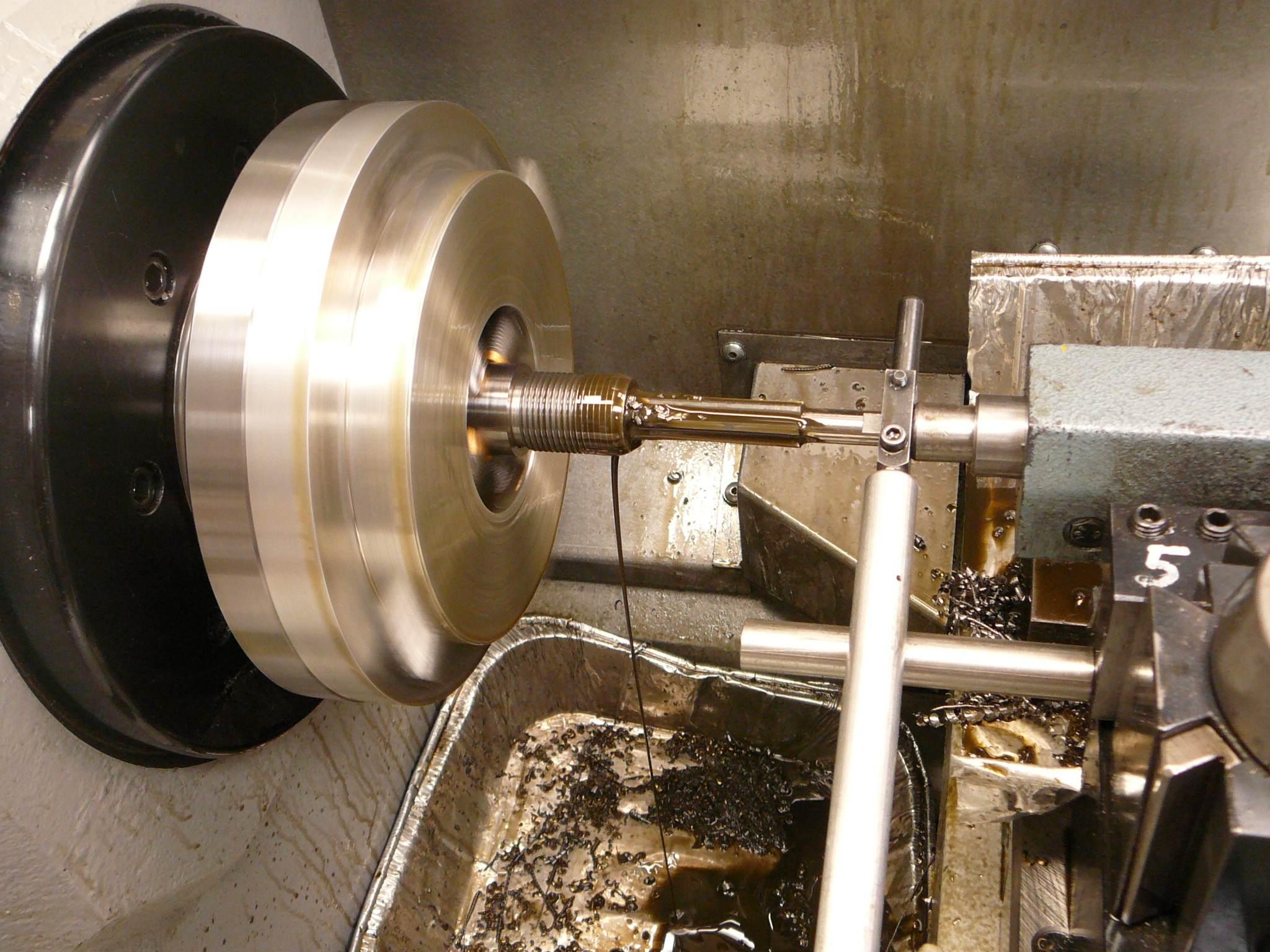

Here's a link to a friend of mine who put on paper the way to cut a chamber with a pusher. I was doing this for a number of years before we met. I like to tell the story that I taught him everything he knows. Doing the math that's been 30+ years for me. I still see no reason to change my methods. Attached pic is how I've done it since day one on my Haas.
http://www.bryantcustom.com/articles/rebarrel.htm
