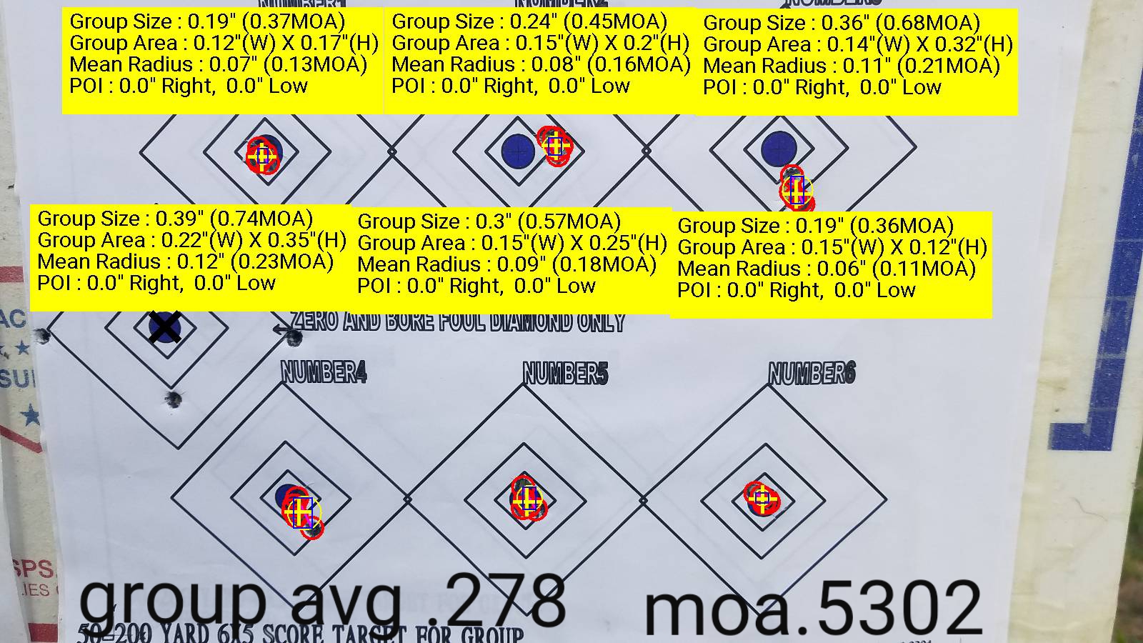

I run a 18 " proof for obstacle courses less then .5 groups at 50.
24 3/4" shilen 14 rachet .750 deg lead match chambered inhouse a ELR setup
25" GMB from Keystone I reworked the action tork settings on yesterday it ran 20 rounds under a .490 group at 50
The long Tom's are not barrier friendly but their es is more consistent then the shorties. I shoot far often.

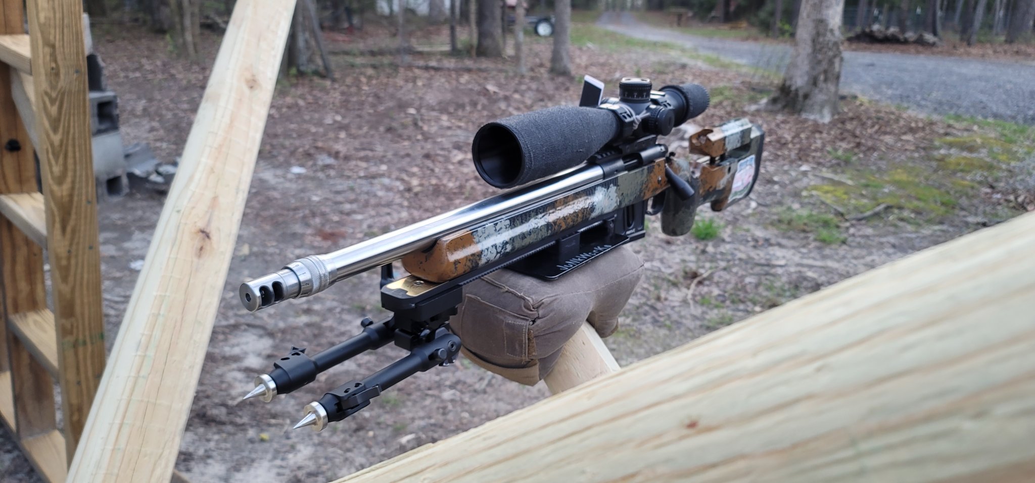

I’m on my second barrel with my RimX. First one was a 18” M24 contour Green Mountain with Padom’s chamber , second is a 21.5” 1.2” straight Green Mountain with a Nevius chamber. Both barrels both chambers shoot multiple brands .3-.2

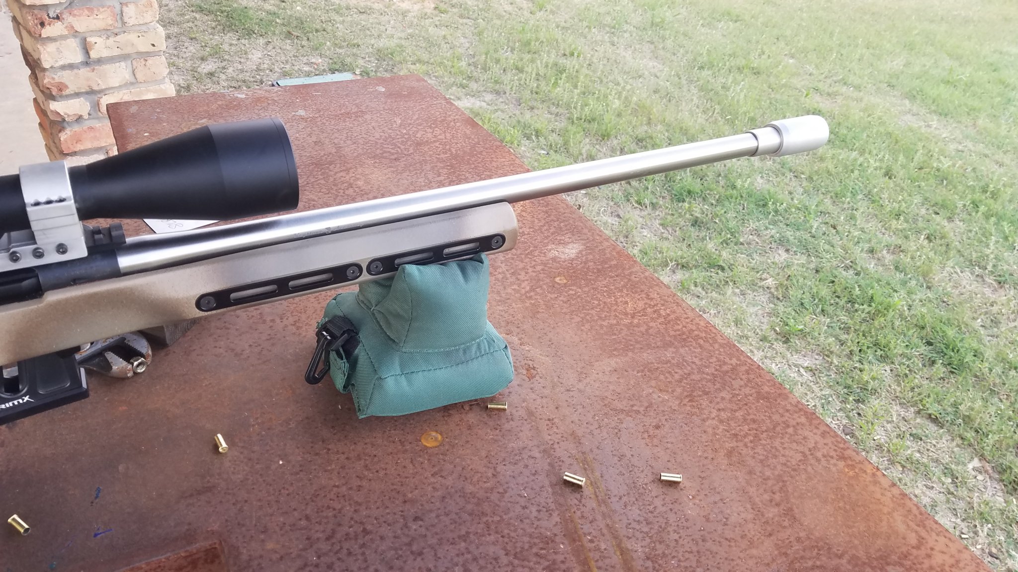

My first barrel was a 20” GM from Keystone. My second is a 26” benchmark from TS customs/primal rights. The 26” benchmark seems to shoot more ammo better as well as having better SD’s. It shoots at 1069fps avg with my lot of CX. If I were to do it again I would get the 26” by TS customs. The balance is so much better and the consistent groups has been well worth the change.

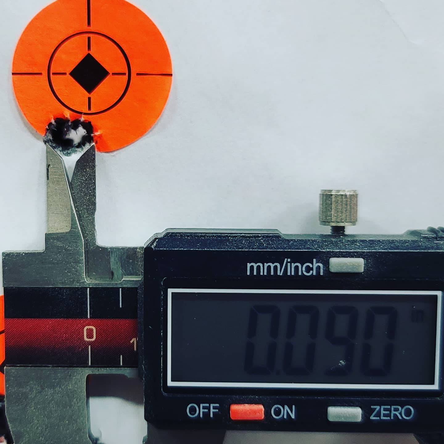

I have a 18" Straight Jacket Armory barrel. 1:14 twist and am shooting pretty decent groups a t 50 yards.
5 shot group at 50 yards using SK StandardPlus. Calipers zeroed at 0.022"

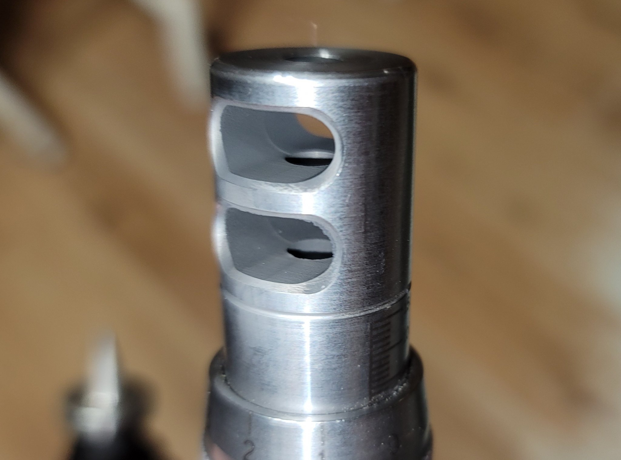

Using a Harrell's Precision tuner brake
