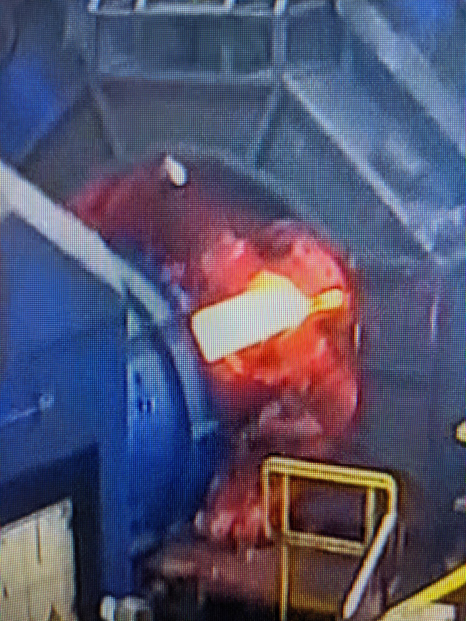

    I'll take a few barrels to work and throw them in our rotary forge and see if I can get a little choke on them😂
    Reactions: RTH1800
