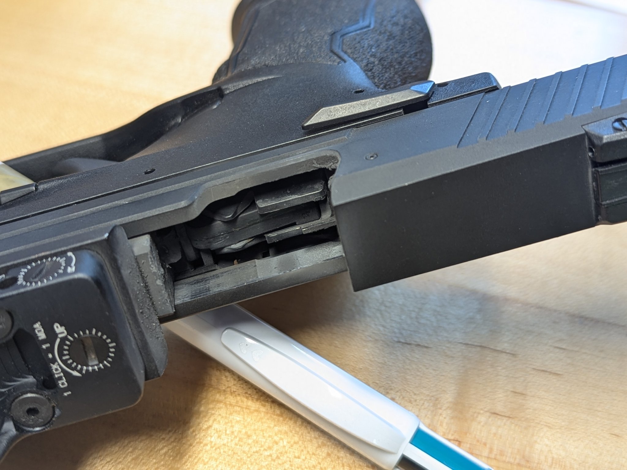

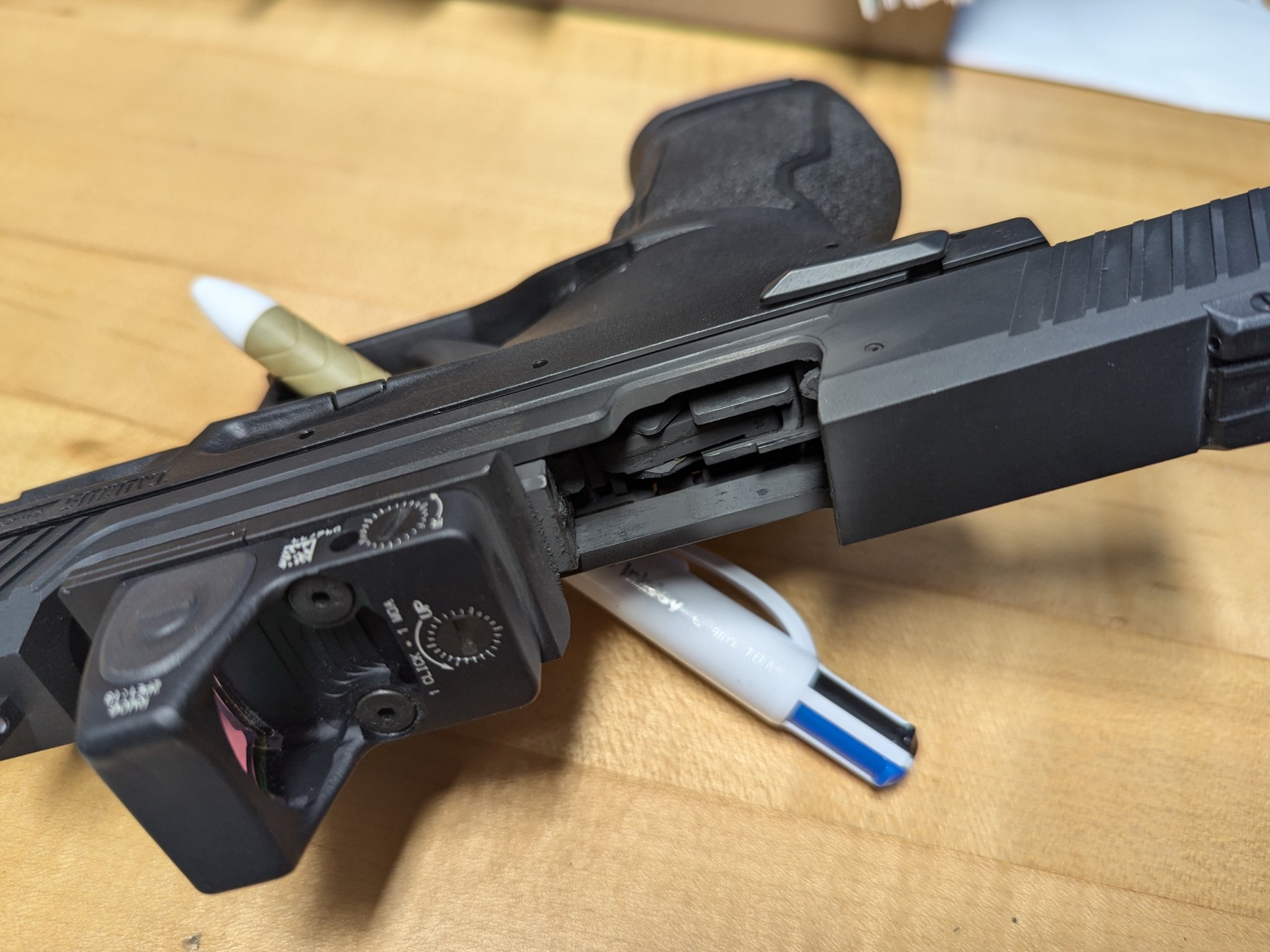

Looks almost new after almost 1000 rounds:
Action looks pretty clean, too:
See that bit of carbon on the interior of the slide, right where the case mouth would be? That's less build-up than I'd see with 100 rounds from a normal can.

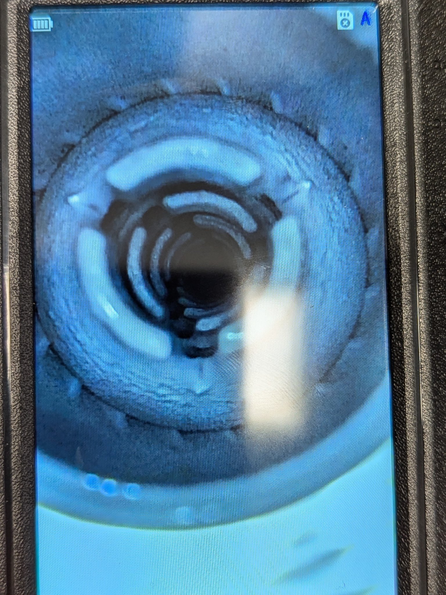

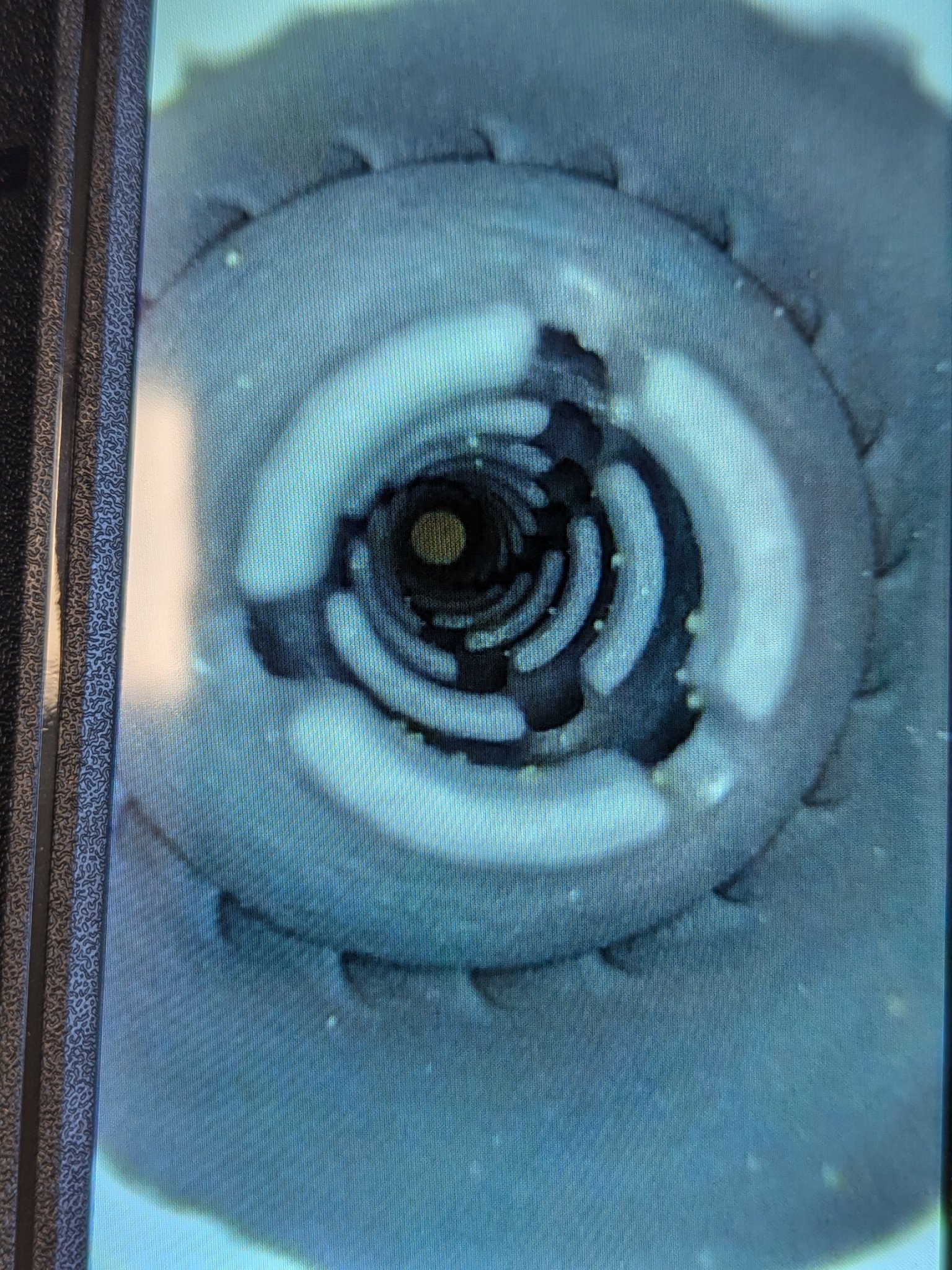

Quite possible that the printed nature of the can masks the fouling that is present. The baffles in my 22 can are polished like mirrors. Very easy to see the most minimal fouling.

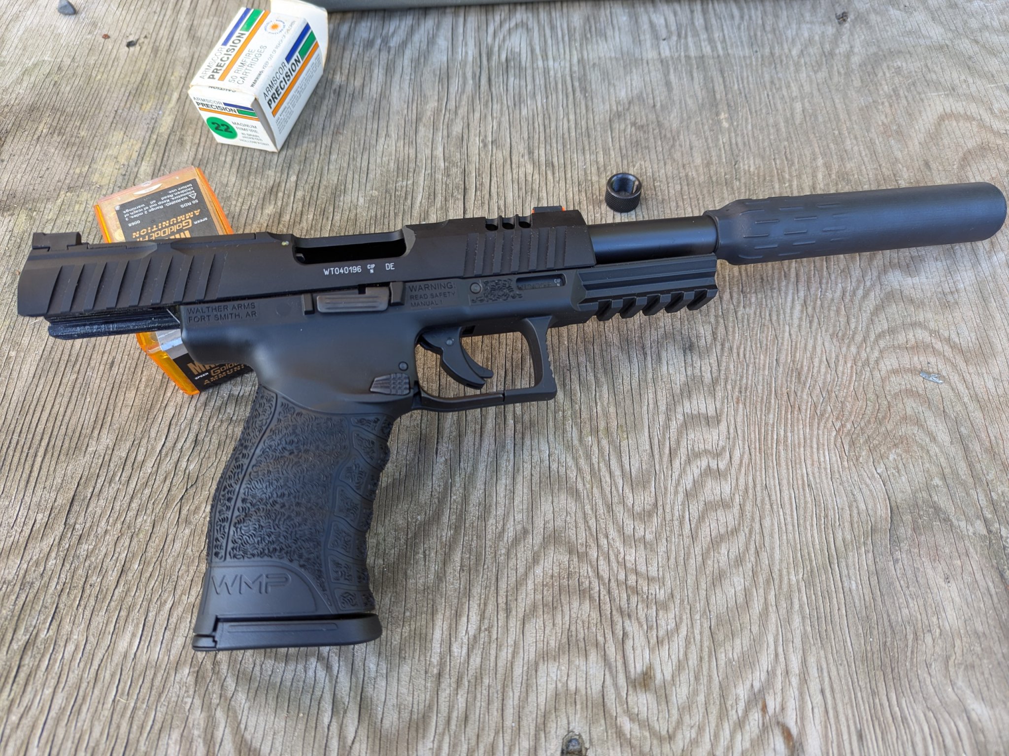

Been very happy with the Hux flow22 ti on a couple of my 22s. Can’t say I’ve seen a shift in poi with the flow. I use a da mask on the Vudoo. Yes shifted the JPRFX scope back to a spear and got a black one from EuroOptic.
Completely possible. I will suggest looking at not just the surface accumulation (or apparent lack thereof) but also the peripheral vents. Those are small features that would presumably be easy to clog.
