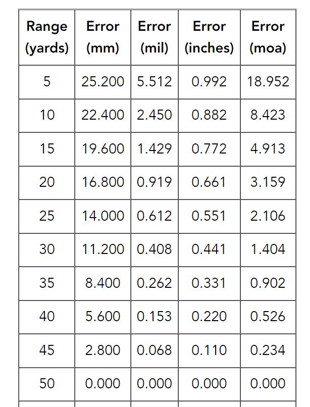

With a min parallax of 50 yards - you'll have a .6mil error at 25 yards in each direction. So about 1" of variance. It's a pretty high error percentage for a 1/4" steel which is common. Generally we hope to get parallax errors in the .2mil max.
Reactions: kthomas
