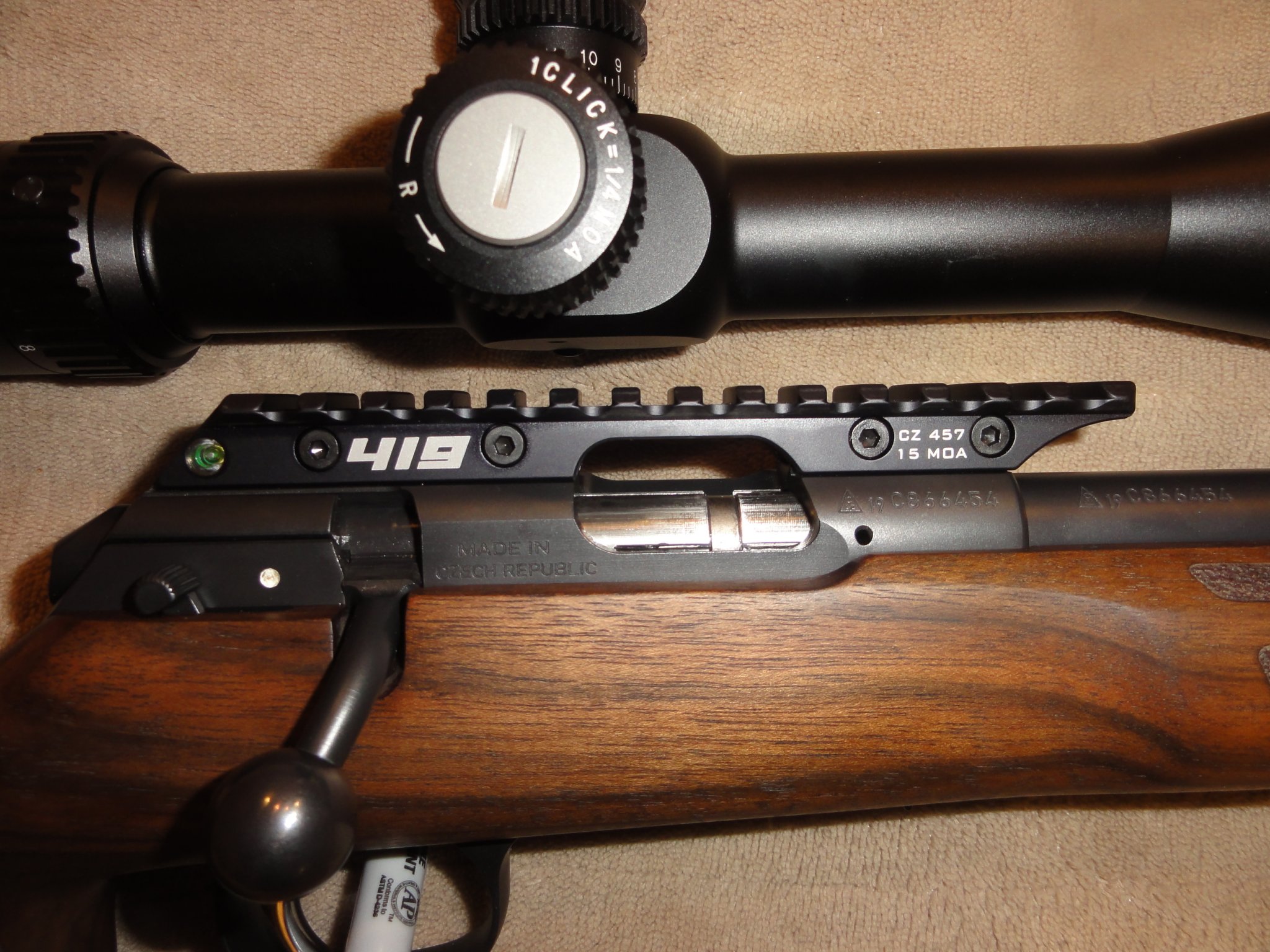

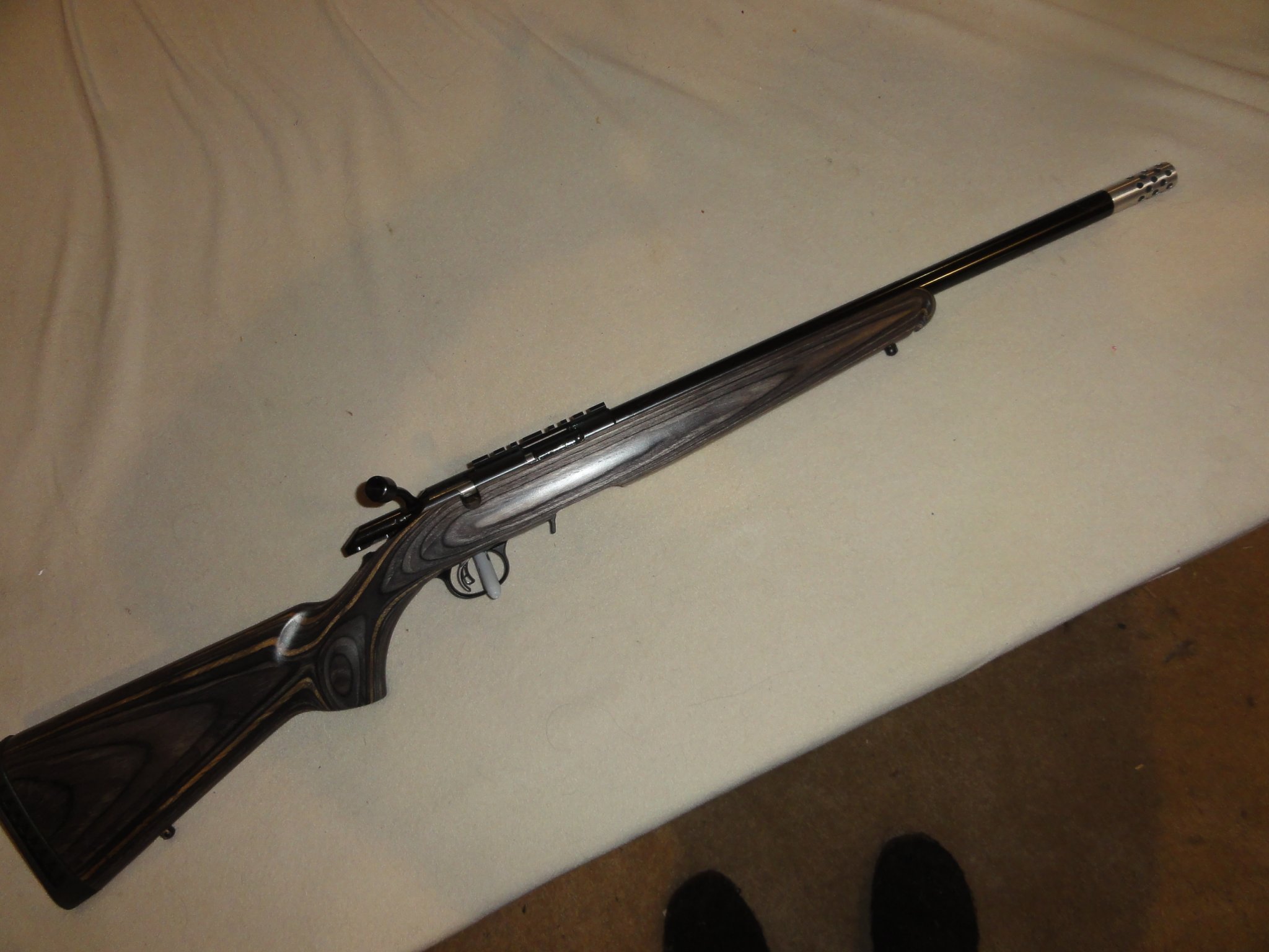

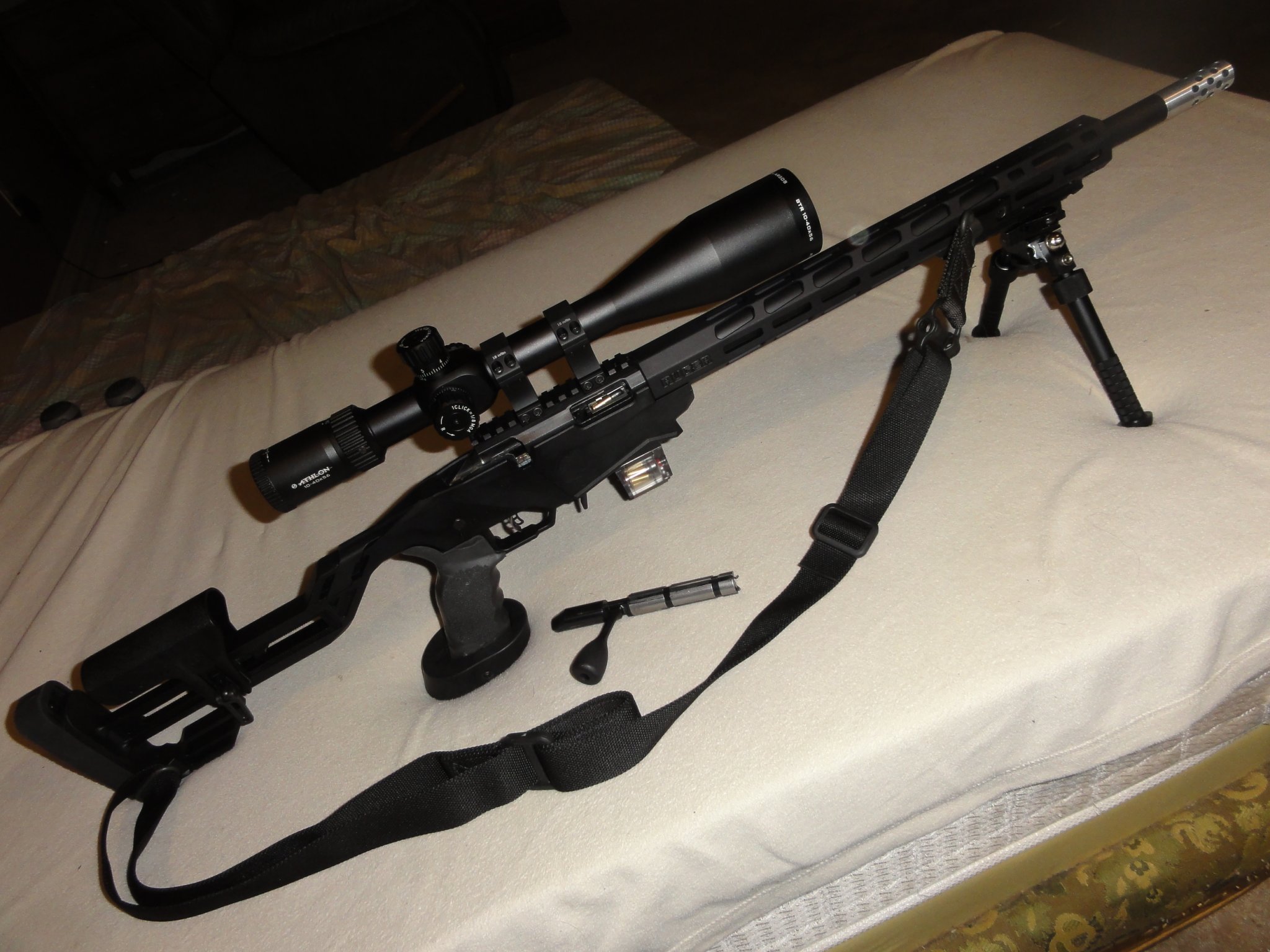

Great thread, my son (9) and I just started going together the range! He really loves it. Has a Ruger 10/22 takedown with a weaver scope. Glass is actually pretty nice, but I know upgrading him to a Vortex HST or an Athlon is the way I’m going to go.
Reading how you guys like the RPR, and I know I love my RPR in 6.5, it might be the next upgrade as well. Subscribing to this thread... always good times at the range with the kids!
I have a a VXII 3x9 on a Winchester 52 I shoot primarily at 100 and 200 yards and a Weaver 3x9 I shoot at varying distances out to 200 yards. Both are suitable for this purpose, though the Leupold mildly edges out the Weaver when it comes to a thinner cross hair and better clarity.

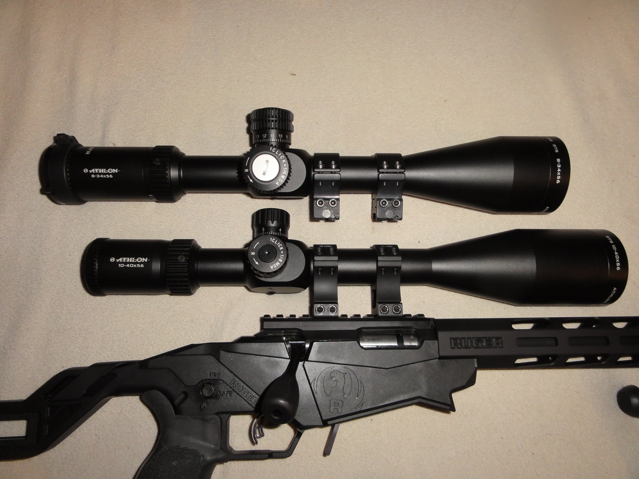

I built out an RPRR for my nephew with rifle, Athlon Argos BTR 6-24 scope, rings, M-lok swivel, and Harris S-BRM bipod (rings and bipod used but like-new from LGS) for a fraction over $900. Scope came from @gr8fuldoug at CameralandNY; he's on my permanent good-guy list. CALL him on TELEPHONE - its worth your while.
The Athlon’s are fantastic scopes. Just pick your budget and buy one. My son is 10 and competes with me in NRL22 matches and PRS matches. Both of his rifles wear a 6-24 Athlon Midas TAC. Absolutely fantastic scopes and relatively light which was one of the big requirements for me. Great glass and great 10 mil turrets. Give Doug a call and he will take care of you.
I too would shoot the bolt heads as it helps me focus. Aim small, Hit small. Try shooting aspirin. They are a lot of fun because they are dynamic like miniature skeet. We crazy glued the aspirin to vertical wires about 6" long and shot them with our pellet rifles at 50 yards. The pellet guns are FWB, Styer , Daystate etc. I was using a Leupold 6.5 x 20 x 40 EFR at the time that I took first place in Unlimited B class at the Worlds Field Target comp in 93. To place now you need more like a 50 power. IE: Sightron 10 x 50 x 60 at about 1300.00 USD. The blue gun is my FWB P-70 high power. You fill the lower tube with 3000 psi. air from my scuba tanks.
If aspirin are too small at 100 yards, any cheap candy like sweet tarts would work as well. They are closer to 5/8". I have never shot paper worth a cr#p because I just don't focus enough. I'm using an Athlon Helos BTR 8x34x56 IR on four guns. My trigger is 1 pound, 1 oz. on my RPR rim fire and my Ruger 8348 American. I pulled the trigger tension spring and lapped off the trigger sear with 1 micron lapping film with PSA backing. That is like 14,000 wet dry. There appears to be about 1mm of sear engagement which is more than I would like. Since the trigger has the accu-trigger like safety, I think I can reduce that with a build up of epoxy or low temp solder.

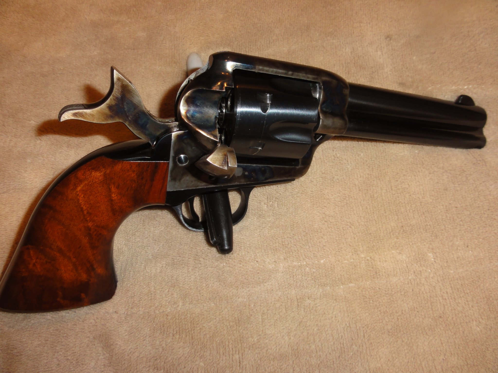

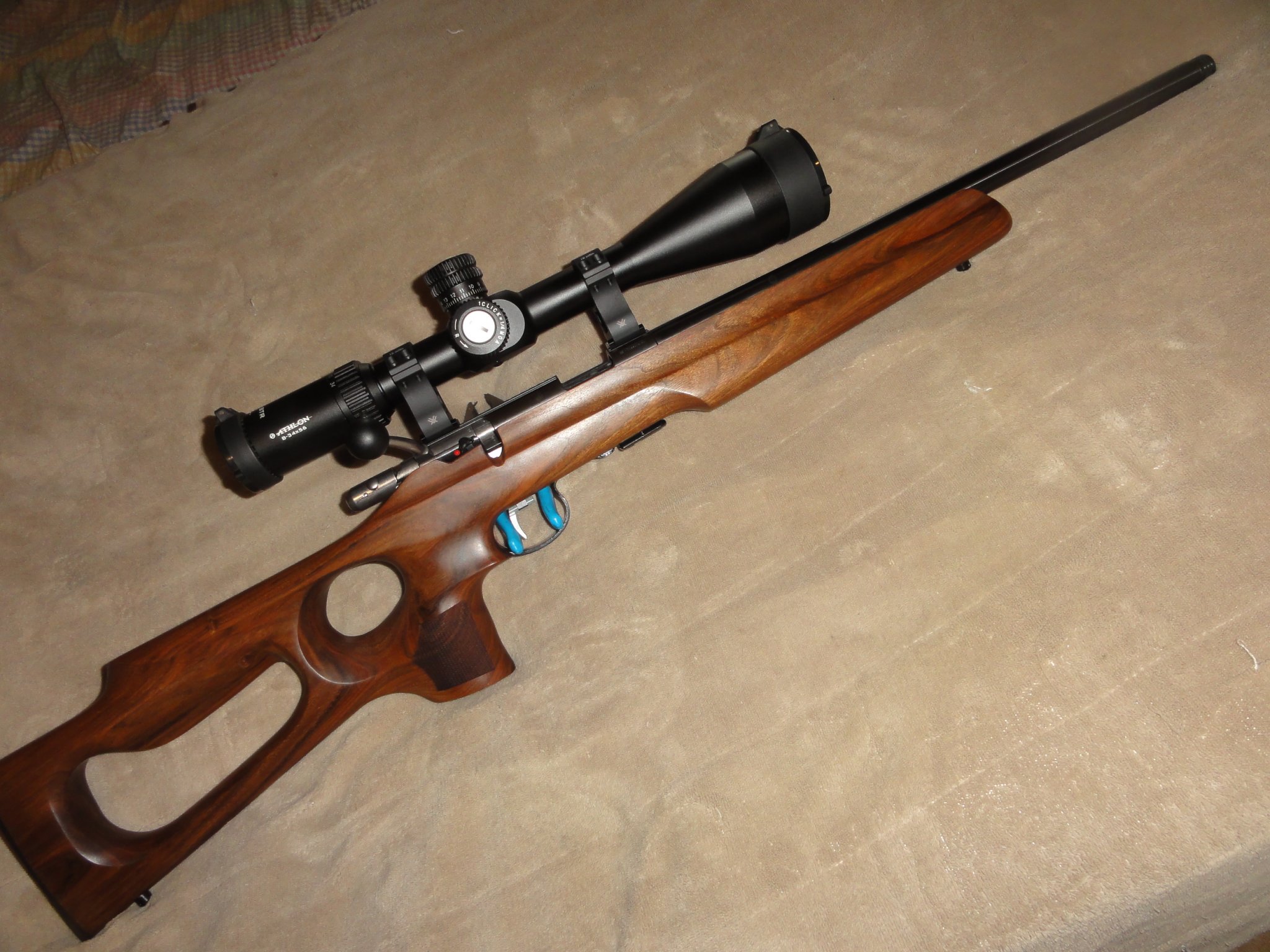

What are those blue thingy's in the trigger area?
Welcome to the Hide from a fellow PCP member!
LOL..... Those are the soft blue covered handles on my Channellock Slip joint Pliers. I do my best to protect my guns and keep them as close to LNIB as possible. I don't like to hide them in silicon socks, but I do. I would prefer to see my toy's. I pull the actions and WAX the metal and wood. Scroll down to about April 3. One of my first posts on the forum.

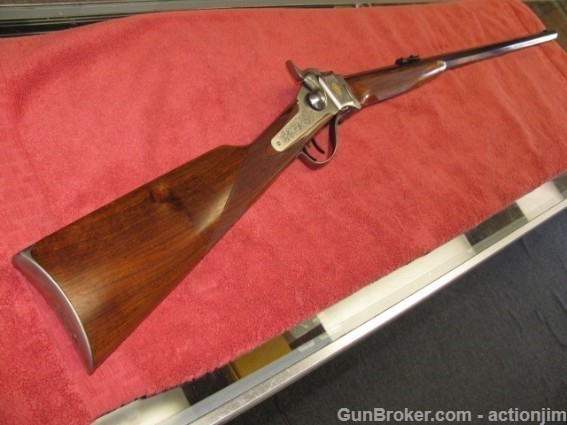

The photos of the 45-70 Sharps are from the guy I bought the rifle from, it looks the same to this day. I am new to the forum but not new to guns. I just got this rail for my CZ 457 MTR.... Is it worth 105.00 .... NO..... but I'm only going to buy it once and my stuff will be handed down to my niece. I failed to mention that I use MOS2 grease on my triggers and other sliding surfaces. It has a very low coefficient of friction.

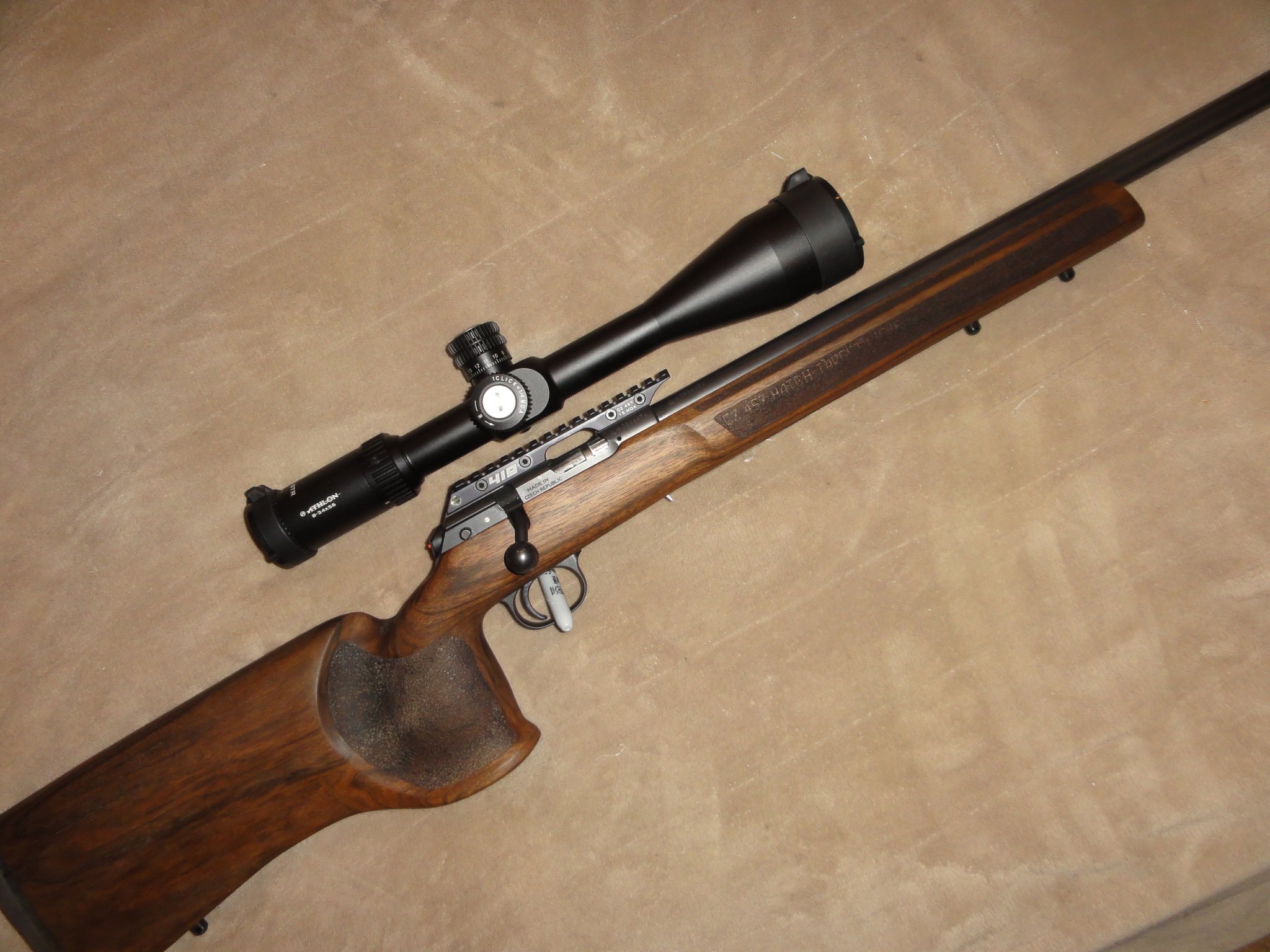

Nice guns! You must have a short neck - got that scope mounted way back on your RPRR.
I used a Athlon Argos BTR 6-24x50 on my MAC1 USFT the last 3 years in our local Field Target air rifle matches. Got me 1 state win then 1st in freestyle division the last two years. Darn good scopes for the money!

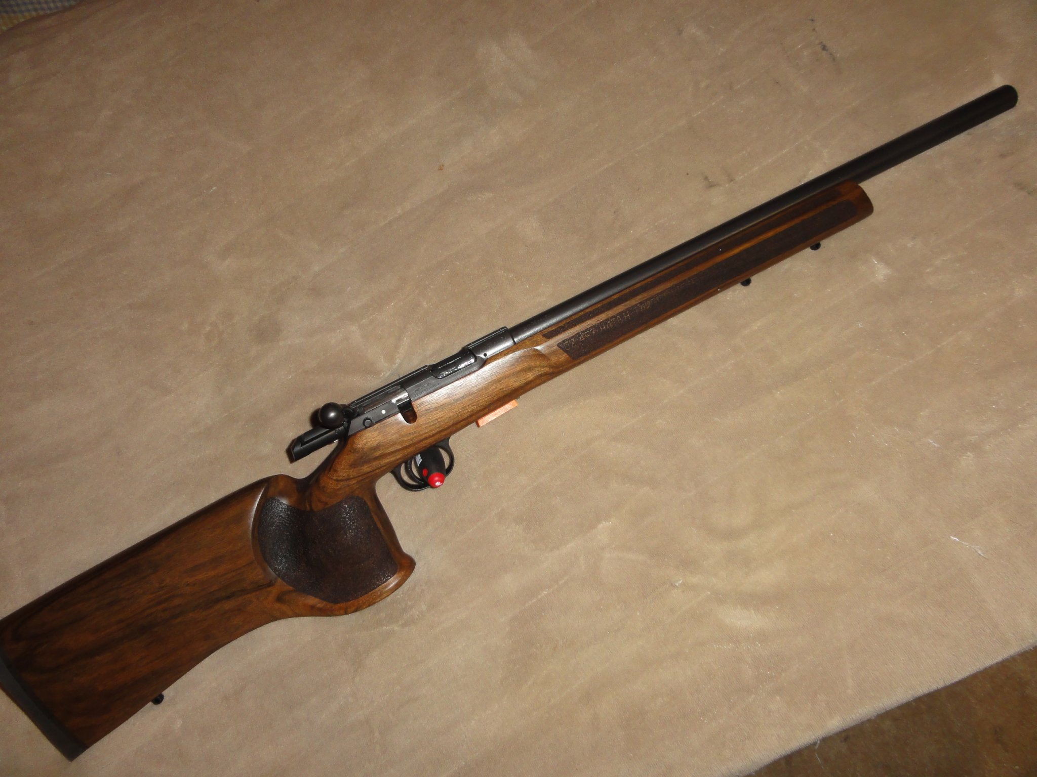

Because I have it, I use a S&B 5-25 on my Anschutz 1827F, since I use it more often, or I should say did use it more often, because our local NRL22 match has been cancelled the last three months, which sucks!!!
OMG.... Finally a FT guy...LOL ! All of the work done on the FWB was done by AZ. Sadly the closest FT venue is six hours away at Roz Sumpters place. As far as short neck.. I very well may have. I have had two surgeries at C5,C6C7. One front and one back. I'm in Paris Tn. so getting air is a 90 minute venture one way. That is why I just got these powder. Yes, for the money, they are nice scopes. I much prefer my Leupold glass quality. It is clear edge to edge. If I started buying a bunch of airguns at this point they would go to my niece and sit under the bed. they don't understand them and could not even pay someone to service them. Paris is a 25K town. I have an insert .22 LR for this 45-70, that is what I shoot most of the time. I have had plenty of people look down on me when I say " pellet gun " I try and convey the idea of "Shooting Enjoyment" but I'm certain they don't get it. They need to shoot manly caliber a these small southern deer. IE: 300 Win Mag. But hell... I don't get that.
