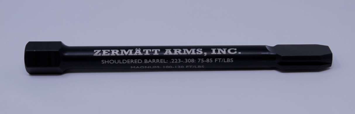

Allen wrenches and an action wrench are all you really need. You might be able to get away with tightening the barrel down without the action wrench since the torque spec isn't that high (I still prefer to use an action wrench). The action comes with a no-go gauge to verify fitment.

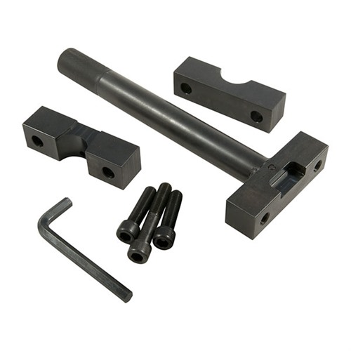

@Shootermagavin Barrel Vice and Action Wrench are all you should really need aside from common tools. I'm assuming you have a torque wrench seeing that you've done ARs in the past. You can get the Zermatt Arms TL3/Origin/RimX Action Wrench or one of the R700 ones that wraps around the action body. However I don't know how to get exact torque on one of those.
Zermatt Wrench:
R700 Wrench

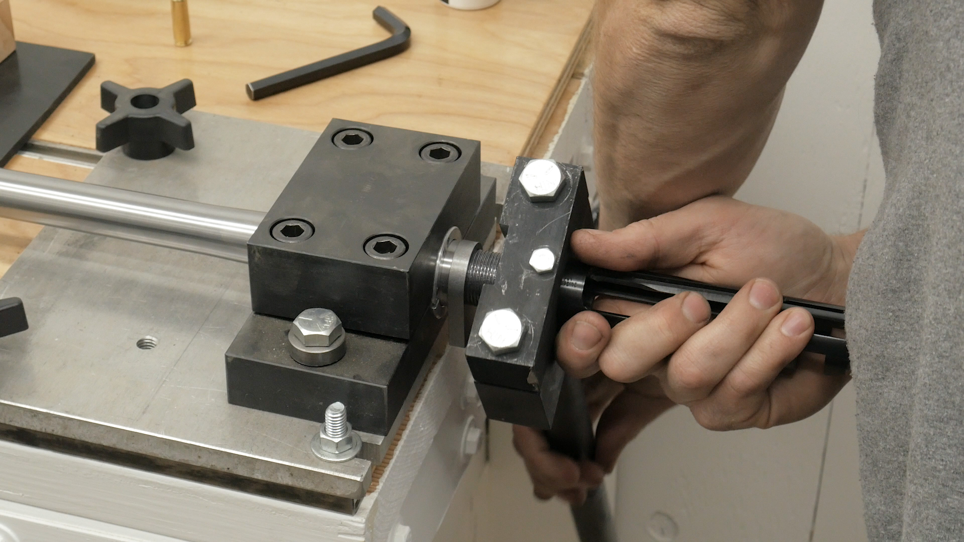

Blue Mountain did a video on it that I found helpful when I was looking at going the RimX route:
