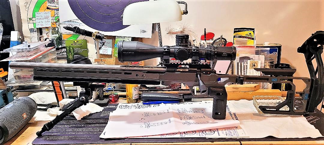

I'm LH also. MPA makes one ambi cut, Grey Birch makes a dedicated LH, PDC custom will make a nice LH model. Spoke with MDT last year about ordering one, they said unfortunately not at this time but we've had a few requests...maybe in the near future. The Grey Birch is well made but light, had to add 3lbs in the forend for good balance, otherwise it has all the features needed.
