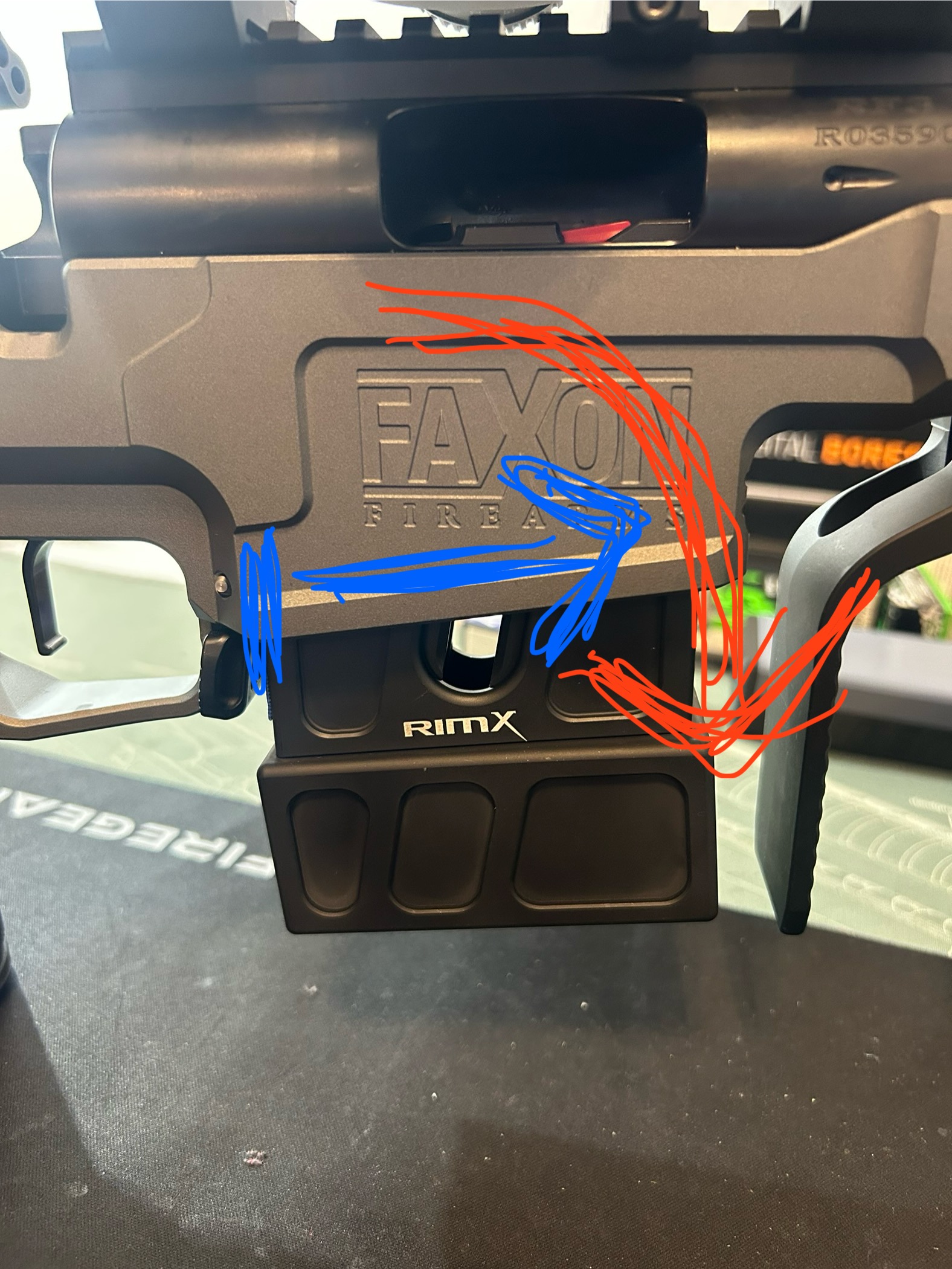

I just picked up a Rachel Precision Brux on a RimX action with the ModX bolt.
The guns shoot beautifully- tight groups at both 50 and 100 yards.

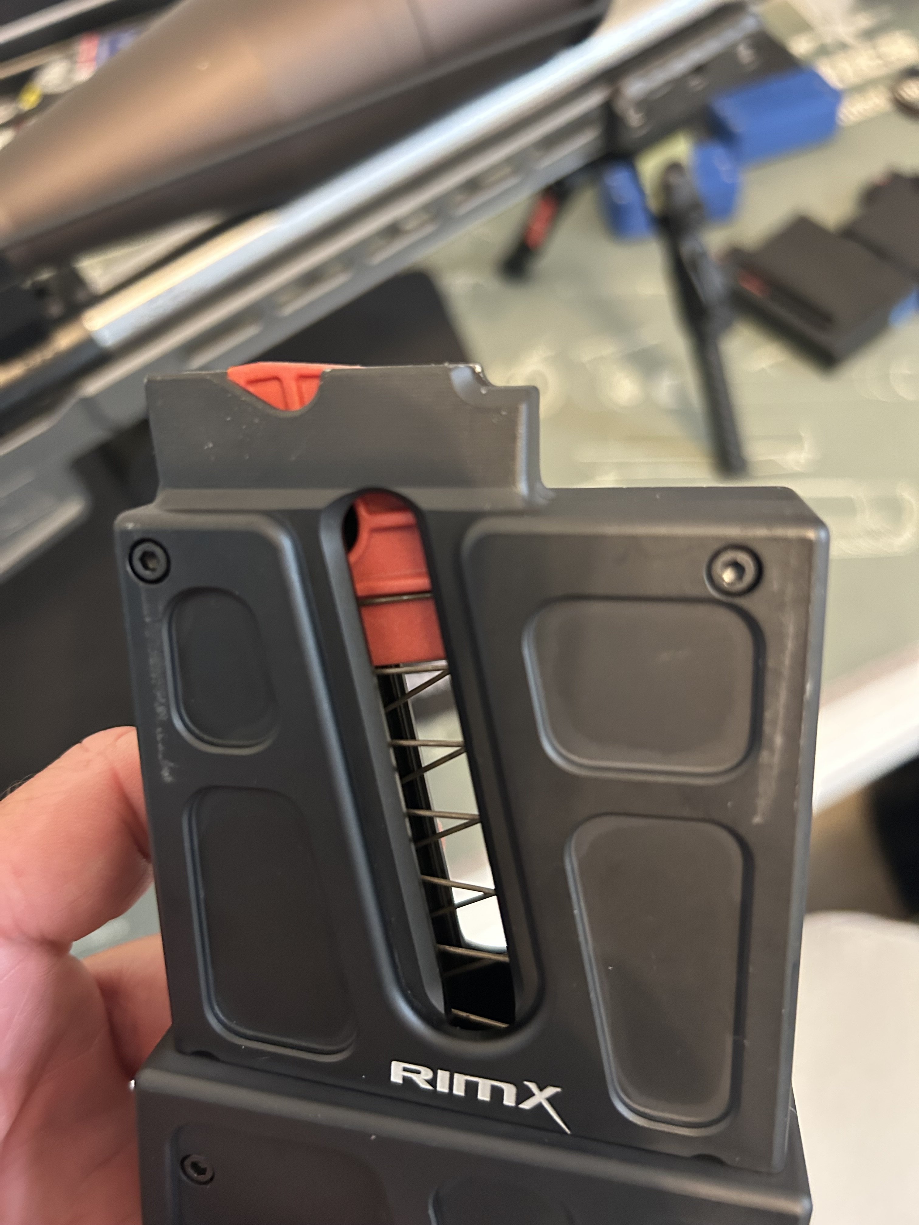

But here is the issue — I have 2 RimX mags with extensions and they are well built, but no matter how I adjust them, they do not feed consistently, so I decided to try a polymer Vudoo mag, as I had some with me and BINGO—- flawless feeding—— has anyone else experienced this.
When watching the rounds feed, it appears that the round hits the chamber a little low and shaves some lead and the cartridge hangs on the lower (6 o clock) aspect of the chamber. Probably about 1 in every 20 rounds does it. SO…… I adjusted the mag to sit as high as possible however that did not fix the problem— I believe the issue is the angle on the front edge of the rimx mag.
The Vudoo mag on the other hand feeds flawlessly over hundreds of rounds.
Thoughts??

Try taking the extensions off, assuming you have the original floor plates. I only experience feeding problems with my RimX with the Zermatt 5-round extension in place on one magazine, and it can happen anywhere in the cartridge stack. The round pops off the stack in front of the extractor and gets shoved into the chamber, requiring steel fingernails or a tool to pull it out.

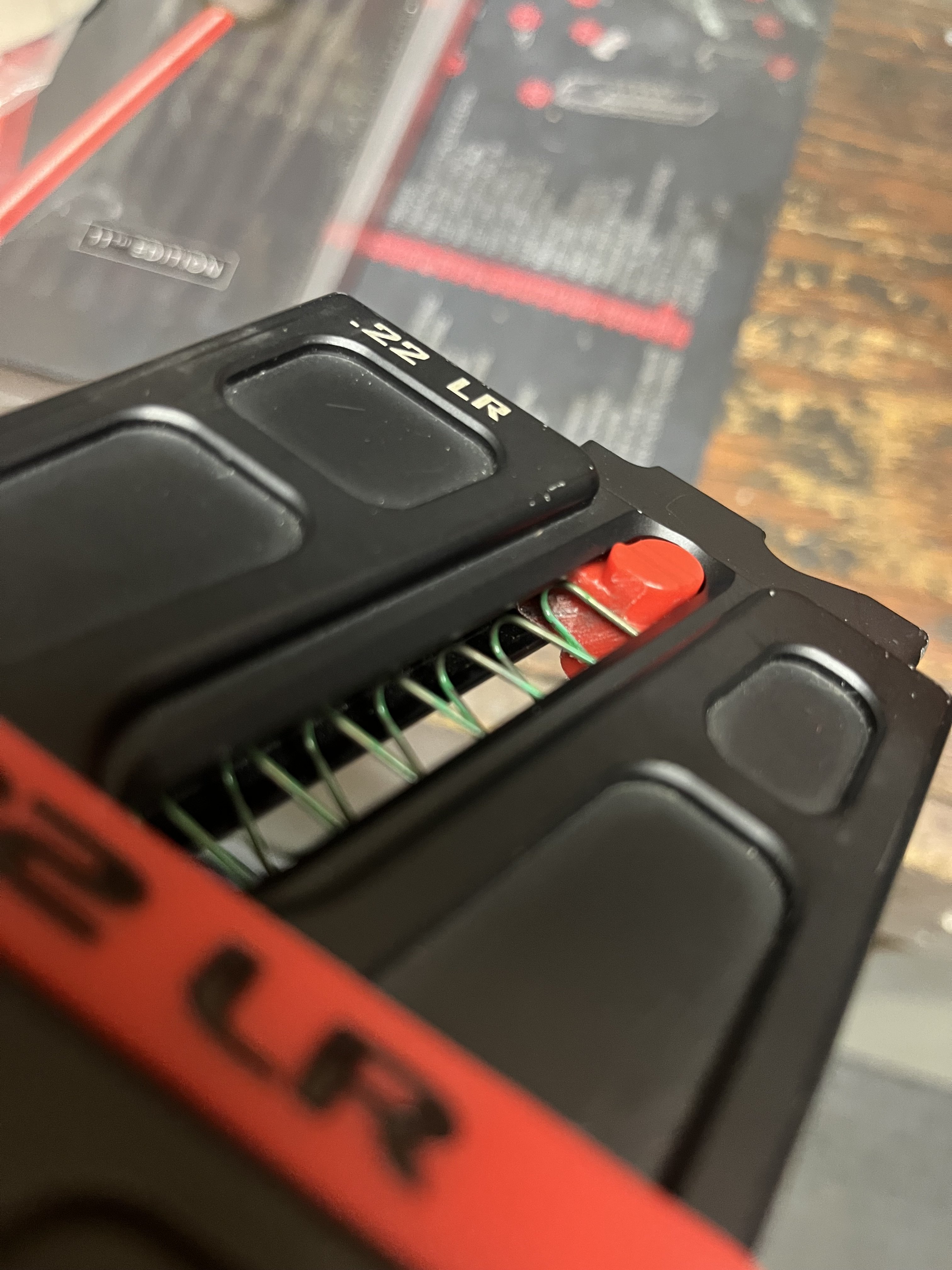

Update — so I was impatient while waiting for new stronger springs — so I modified a Vudoo follower (by cutting off the side tab) and it fits perfectly in the RimX mag, it allowed me to use a much heavier square spring and it changed the feeding angle enough to make it feed perfectly.
I spoke with Johnathan Elrod and he agreed the issue was spring pressure or feed angle in my particular chassis and the way the RimX mags sat in the mag well despite a nice snug fit with zero slop.
Where’d you get the new spring?
I can’t even remember — had 2 of them in my “spare” parts bin along with several different followers from Vudoo and MKM.
I’ve got a set of green springs coming from tandemkross — when I get those, I may try to modify the rimX followers and give them a shot with the new springs.

So here is my synopsis of everything to this point — the mag catch height on the rimX mag is set to be snug when the bolt is in the closed position. There is almost no lateral play in the mag. When I see the “problem” feeds the bullet orientation is slightly nose up as it enter the chamber and the rim is not fully seated into the bolt face. This can happen at any point throughout the magazine. Which makes me think it is not a spring pressure issue, but a timing problem based on the bullet presentation.
The bolt nose / face is ModX. I checked it’s function and geometry outside of the action to see that rounds will easily and fully seat in the face and sit appropriately between the face and extractors.
When I put a 10 round poly Vudoo mag in this chassis, I can see that the “lie angle” is about 10-15 degrees less nose up as compared to the RimX mag. So I tried to replicate the Vudoo mag presentation in the RimX mag — fully knowing this is likely a chassis issue, based on all the data acquired to this point.

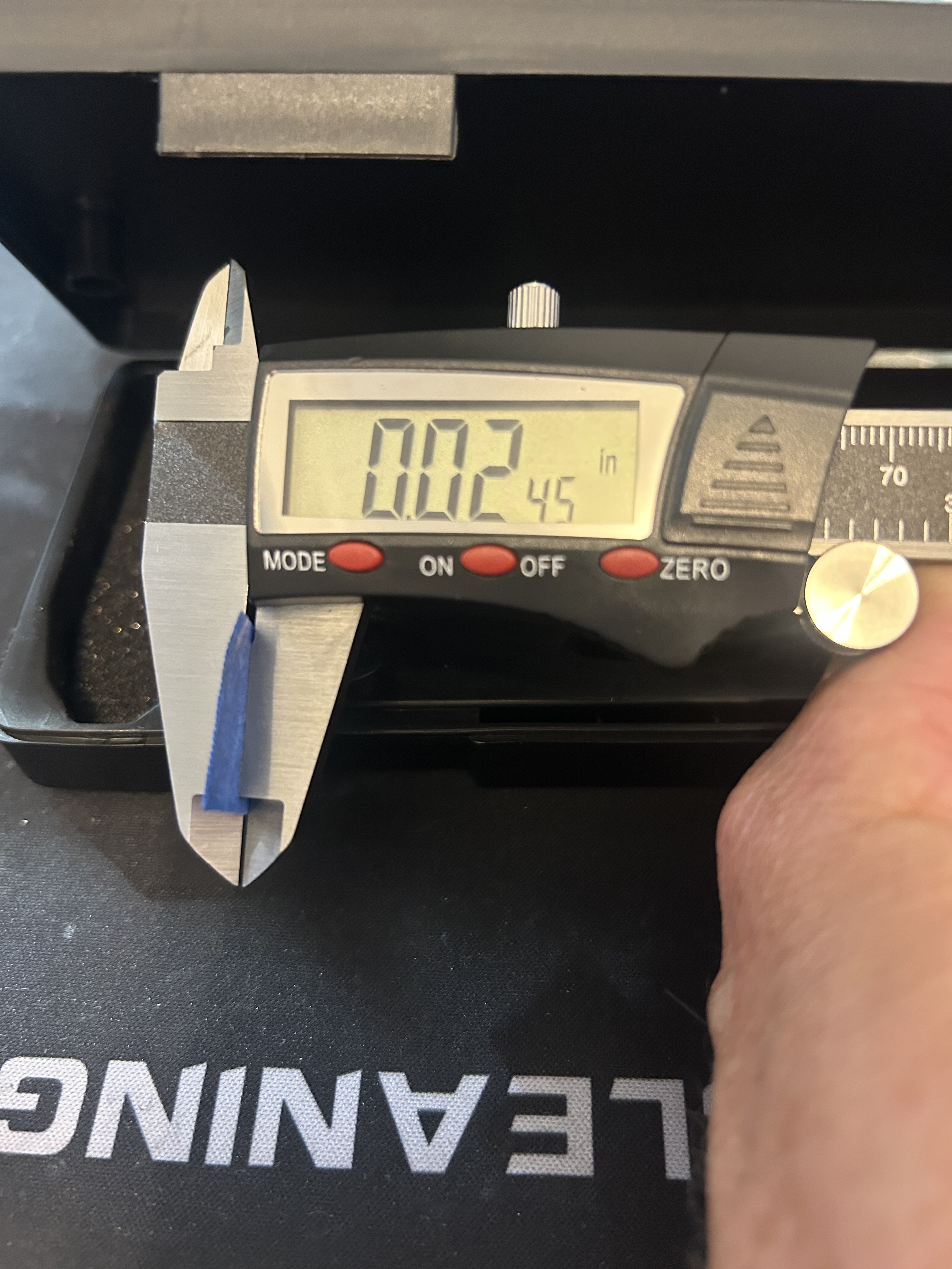

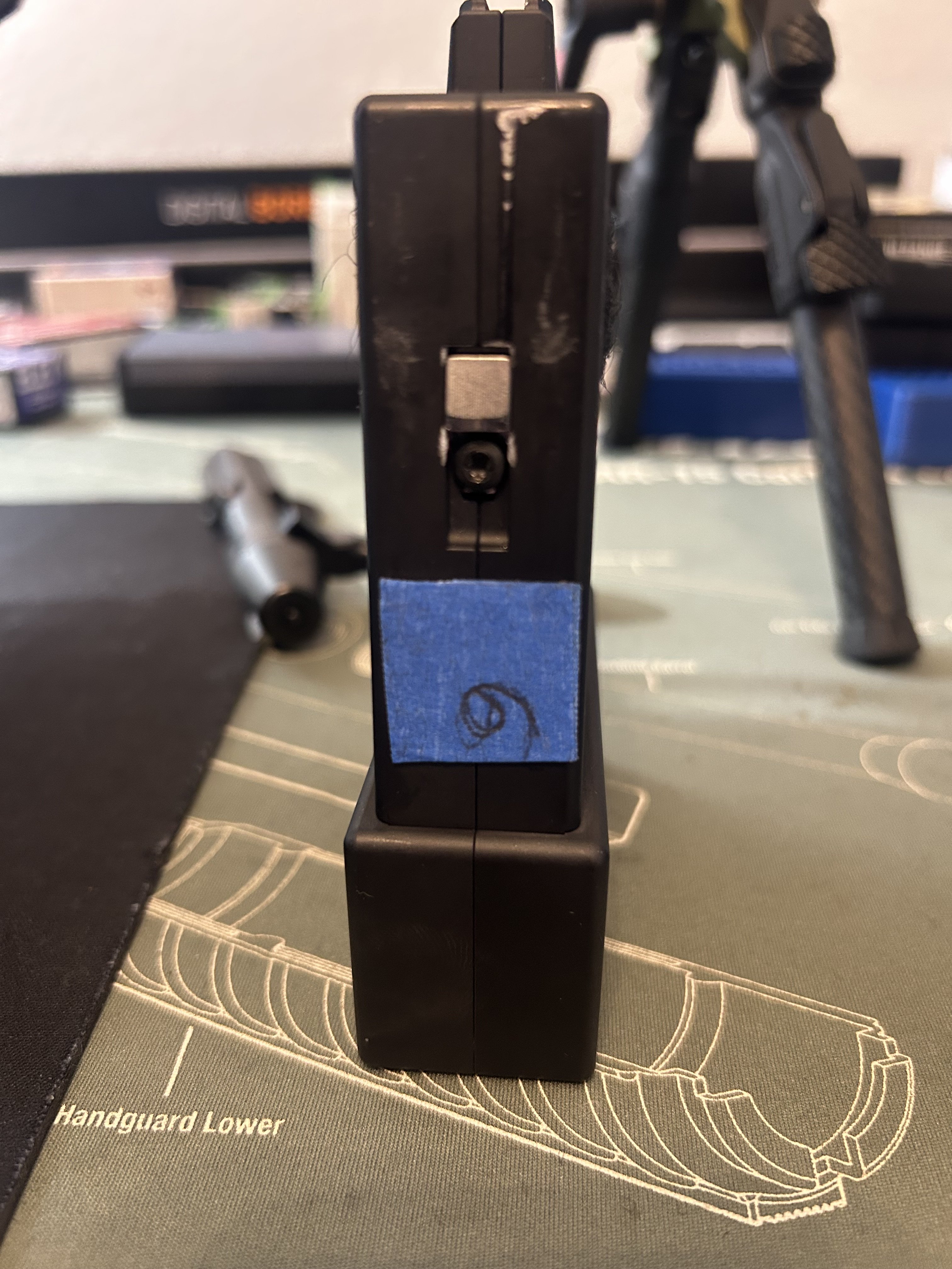

Yes — the green springs haven’t arrived yet but I’ve identified another issue and corrected that issue and makes it run with the rimX follower and regular springs
The magwell on my chassis has a bit more play than I realized — which allowed the front of the magazine to drop down in relation to the chamber despite the rear being totally snug from the mag catch adjustment. When I run the bolt, it causes a rotational type of motion I didn’t initially see until I had someone else shoot the gun while I watched the interaction between the bolt, magazine, bullet and the chamber.
After reading through some of @RAVAGE88 posts I realized my “nose up” scenario was the result of the mag fitment in my chassis and not the direct cause of the problem.
I added pieces of tape, 1 at a time until all play was gone and the magazine feed and shot well — 100 rounds this evening without a misfeed.
That 0.0245” made all of the difference— I ran it hard and fast and also very slowly — all good now.
Thanks for everyone’s help
Hopefully— I didn’t waste anyone’s time, but hopefully it’ll help out someone in the future.
Now I need to find a semipermanent shim at 0.0245” that is better than my tape solution. Any thoughts here would be great?
Thanks

That’s a real bummer, I had the same issue with my Vudoo and implemented an almost identical solution, although the issue only manifested when the front of the mag pressed into a bag and I needed a lot more tape.
I chewed on this for awhile, and the solution I wanted to pursue before I switched to a DPX build was to mill a dovetail in the back of the mag, then slide a 3D printed trapezoidal shim into it. The location of the shim (and the dovetail cutout needed) I believe are chassis-dependent, but it seemed a good way to handle it.
I also considered nylon screws threaded into tapped holes in the back of the mag to achieve the same purpose, but the shim seemed more durable and easier to control the critical dimension protruding above the rear spine of the mag.

Good to hear.
Velcro would be what I would use. The hook side. Get the really good stiff, and I would expect it to stay put.
I shoot with a guy who has the similar fix on his mags. He uses flashing tape. That stuff takes a lot of arm power to remove. Be warned.

I tried Velcro but it was too thick.
Flashing tape sounds like a reasonable idea.

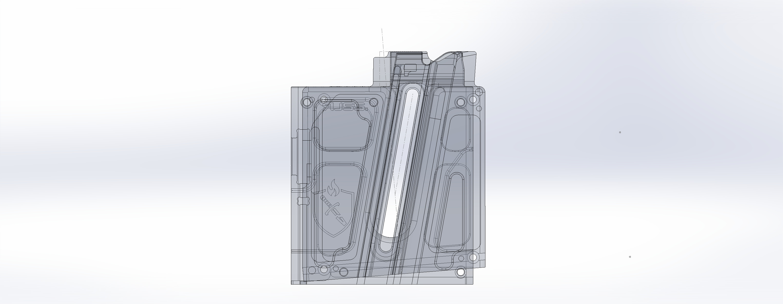

I'm doing a study that involves the major players for AICS style Rimfire Magazines, DBMs, Chassis Systems, Mag Releases, Catch Block Locations, Constraints, etc., to properly chart failure modes based on what has been shared about what has troubled many.
I purposely didn't start the RimX mag study until after I designed the feed stack in the new V-Series mags and I've noted quite a number of similarities between the RimX and my legacy Nylon magazine (the V-Series is depicted in the overlay below), although at first glance, they appear very different. So, it's not difficult to make the legacy Nylon mag work in a RimX, but it's pretty obvious why the RimX won't work in a V-22 without major changes to many V-22 components.
I'm pretty happy with what I'm seeing.
