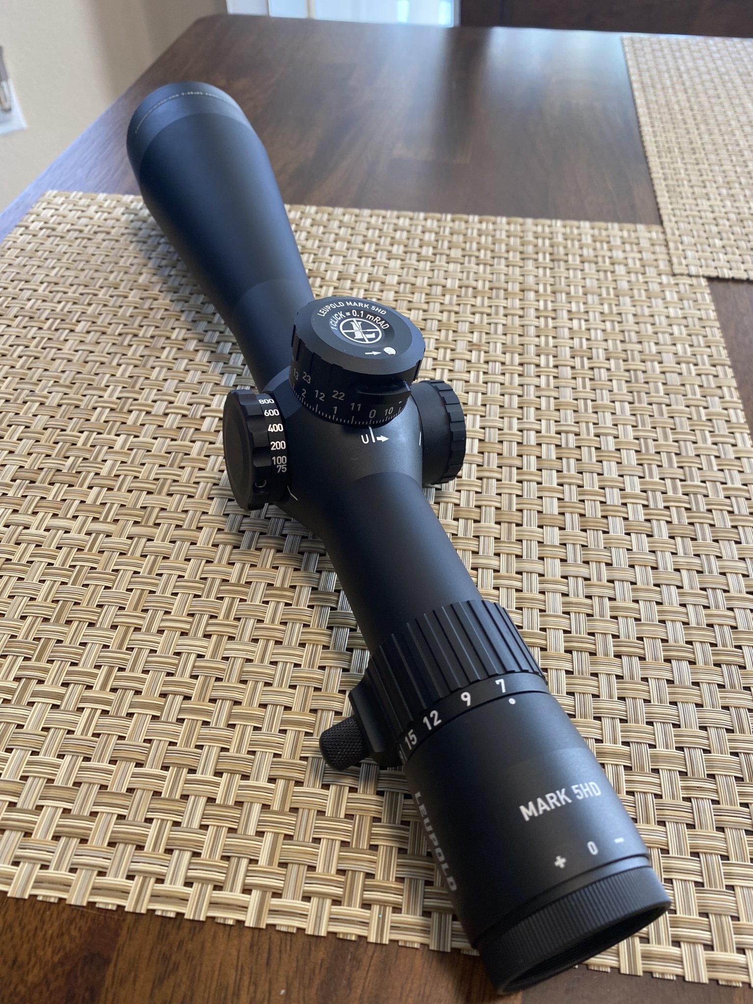

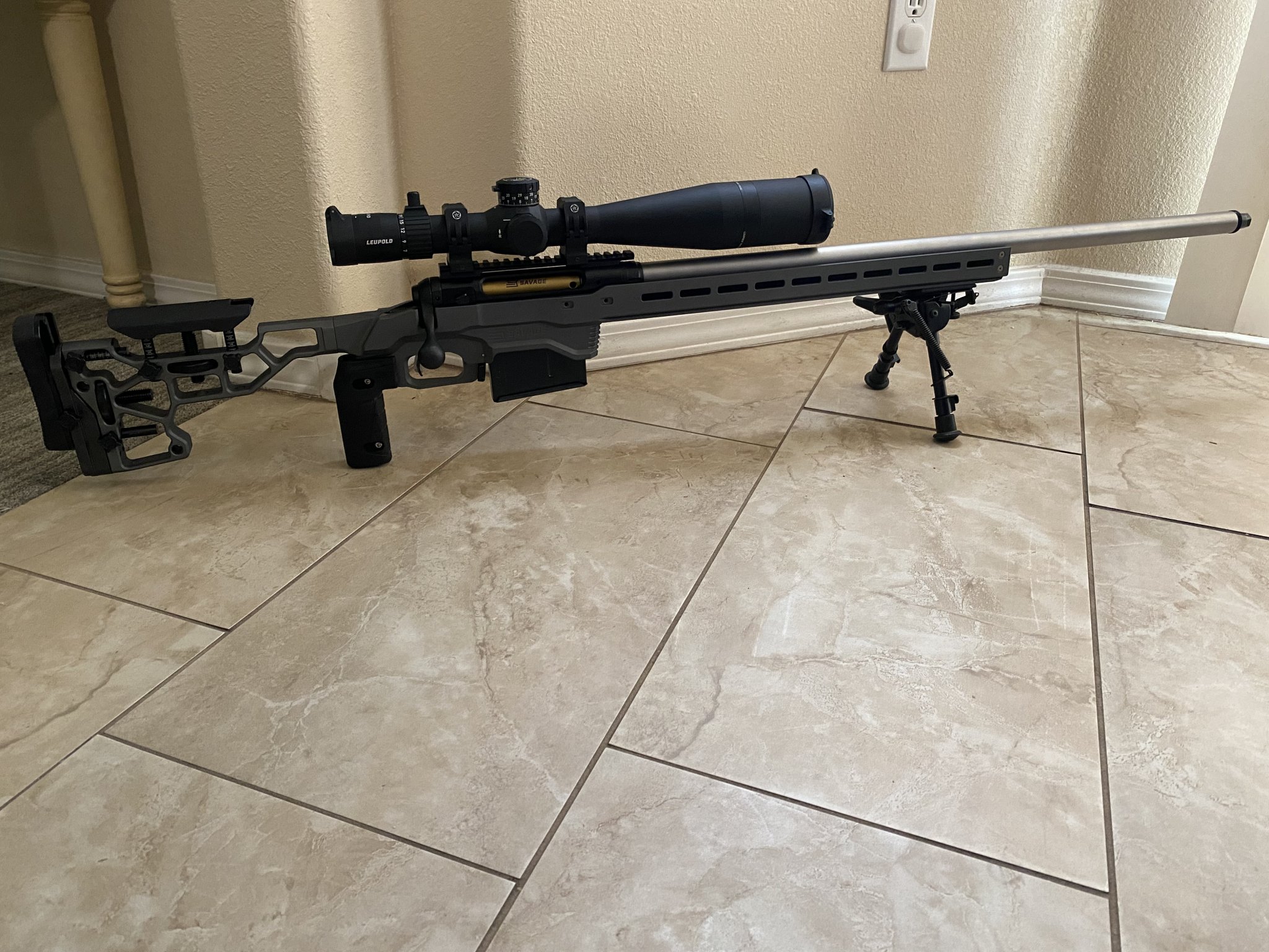

So, I just picked up a 110 Elite Precision in 338 LM, dies, 220 pieces of Lapua brass, Berger 300gr bullets, ammunition and a Silencerco 36M. After a lot of deliberation, I decided on a Mark 5HD 7-35x56 scope that will be here Wednesday. What does everyone prefer to mount something like this in (one piece, two)? Am I just overthinking it? I have looked at Spuhr, Tier One, Hawkins Precision, Leupold, F3R Machine, Badger, MDT and ARC just to name a few. The one piece mounts are quite a bit higher than a lot of the rings, perhaps this isn't as big a deal as I'm thinking, and anything I have listed will be fine. Right now, I am leaning toward the ARC M10.

i'm jealous
been eyeing and saving for the $2,000 sting of buying my first tier 1 optic, the Leupold Mark 5HD 5-25x56 M1C3 FFP PR1-MOA. Currently the most i've ever spent on a rifle scope is $600. This will be going on my 110FCP in 300PRC im currently building. Keeping the saying alive of buying an optic that cost as much as the rifle build. Just really hoping it can out do in every way, the vortex strike eagle i recently (regrettably) sold.
i'm jealous
So far I’m really impressed with it and will hopefully get it mounted this weekend (if the rings come in). Up to this point the best I have is a Zeiss V4 and a Burris XTRII. Have a few strike eagles too and they’ve always done what they’re told.
Reactions: Nathantc
