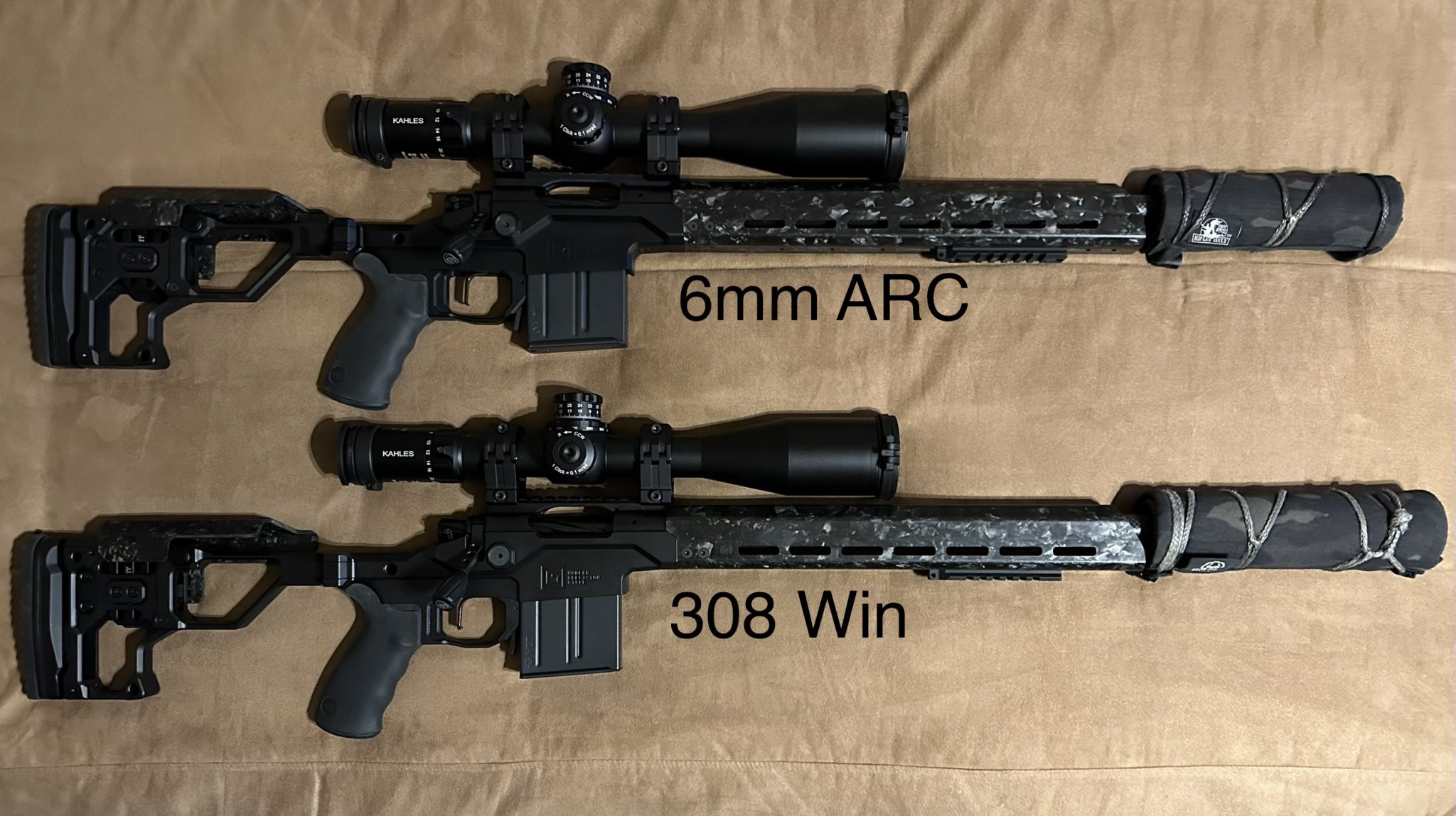

I love Seekins Precision rings, but those new ARC M-BRACE rings are stupid awesome! I have 3 sets (on all my Kahles K-series scopes) and I can literally mount, level, and bore-sight 2-3 scopes in the ARC rings with my Fix-It-Sticks, in the time it used to take me to do 1 with traditional capped-rings and a Wheeler FAT Wrench, having to constantly adjust it up and down and re-level the scope when it shifts, etc... Those ARC rings DO NOT shift once you get that scope leveled in them, because of the way they distribute the pressure evenly around the tube. Also, you only need a T-25 bit and a Fix-It-Sticks 55 in.lbs. limiter, and you're ready to rock & roll.

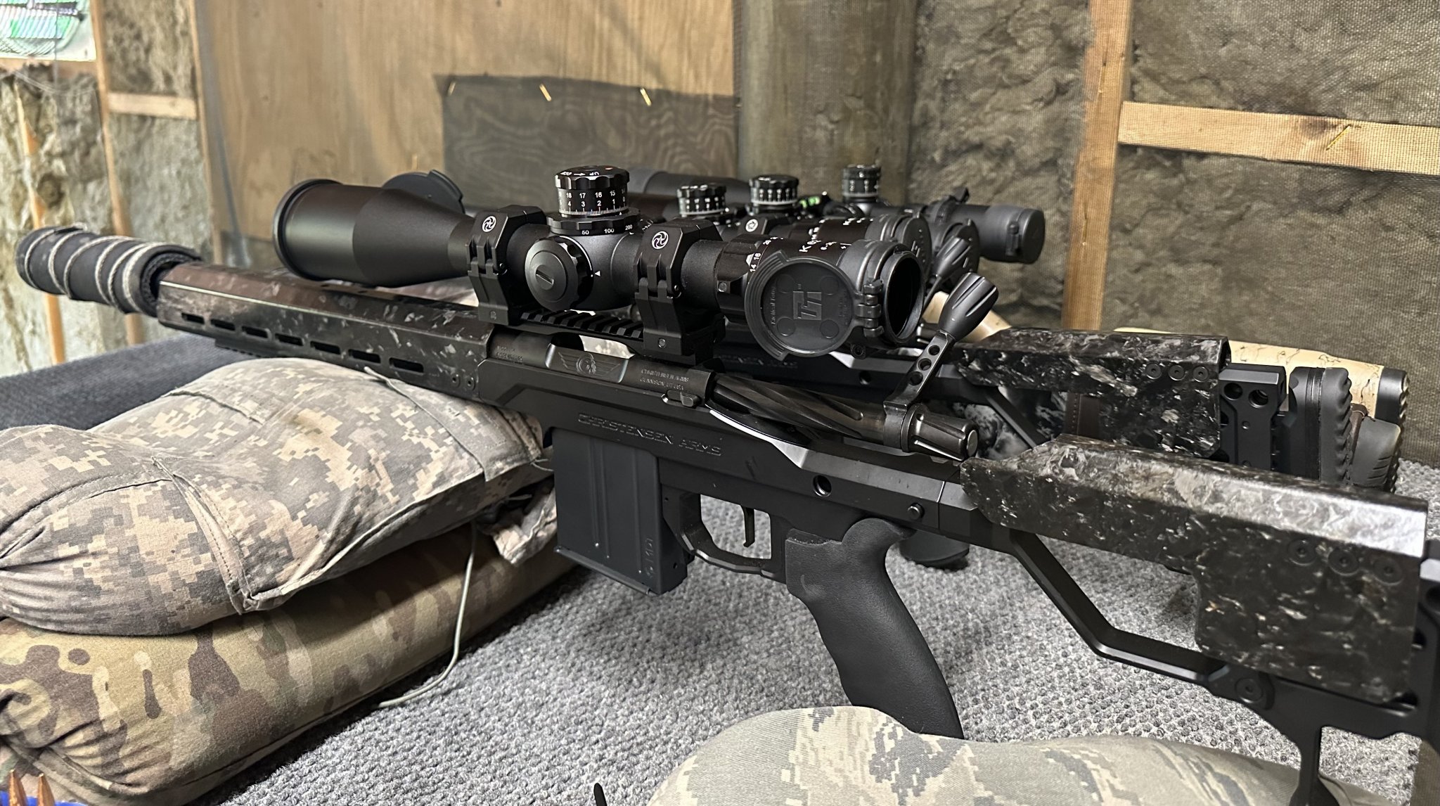

Did the penny trick when I got mine, stack Pennie’s on base front and back, measure with caliper. I used ARC Mlocks at .915” if not mistaken
