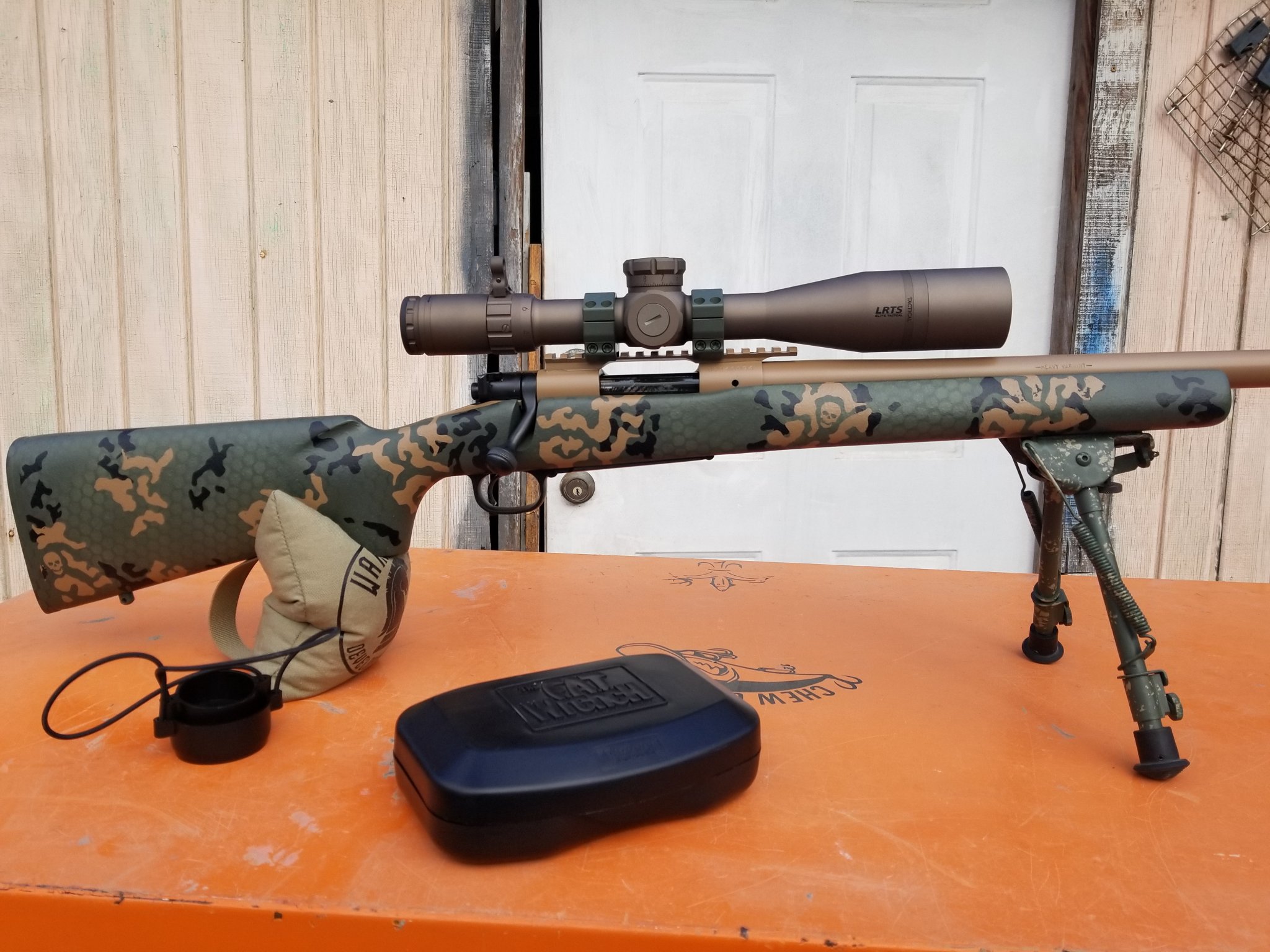

Centered?
You mean like this, closer to the erector housing?
Or centered as in each ring is centered on its individual mounting space of the tube?
I think the way I have it on the pictured rifle may cause parallax issues if over torqued a bit but I have not experienced such problems.

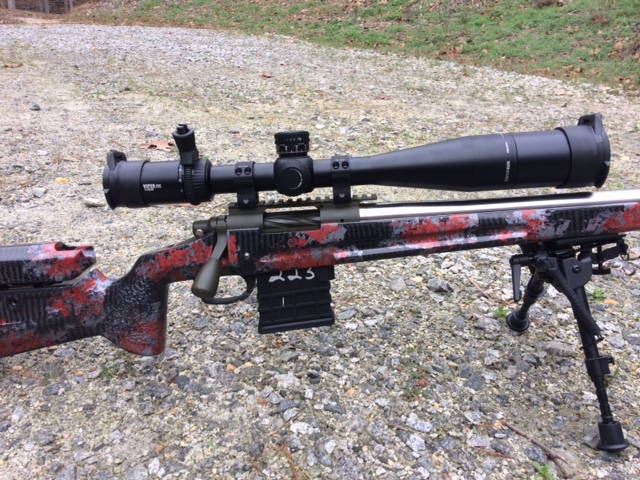

Centered like this is how I try to get them but being off a little is fine too. No set rules but no need to have them at the farthest points on the rail.
