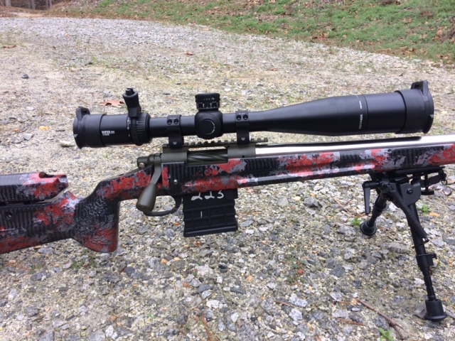

I think you will like the .97 rings. I have the same rings on my rem 700 with LV profile barrel. Good luck with your build.
Not the same rifle but the same scope in a set of 1" high rings on a 700 action and Seekins base with a barrel of similar profile to the one you are getting. I think the .97" height should be fine for you.

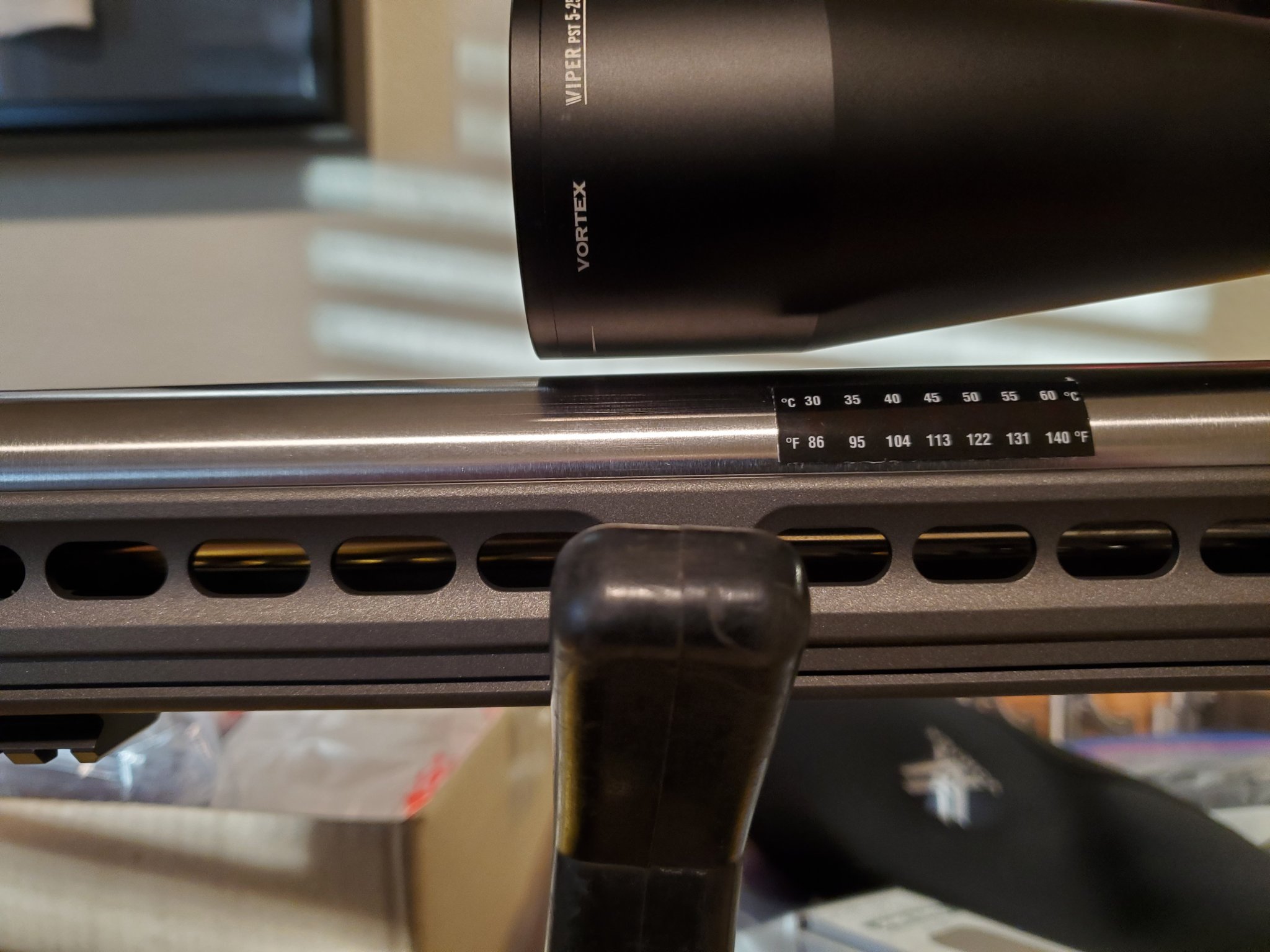

Here is a picture with the Seekins .97 rings, standard 20 MOA MPA base. Pretty tight- a hair short of 1/8 of an inch clearance. The M24 barrel is bigger than I expected. I think I need to go up. What do you guys think?
That’s fine for shooting. As mentioned scope caps would be the issue if they are thick enough to contact barrel.
Thanks. I do not run scope caps. I have a neoprene cover that does fit under the current setup. For the metric minded, the clearance is currently 3mm.
Unfortunately, the High Seekins rings go way up to 1.26 high (from .97) which would put the clearance at about 10.4 mm (3mm plus .29 inch/7.4 mm). I have seen scopes mounted a lot higher, but I will probably stick with what I have.
