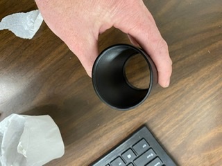

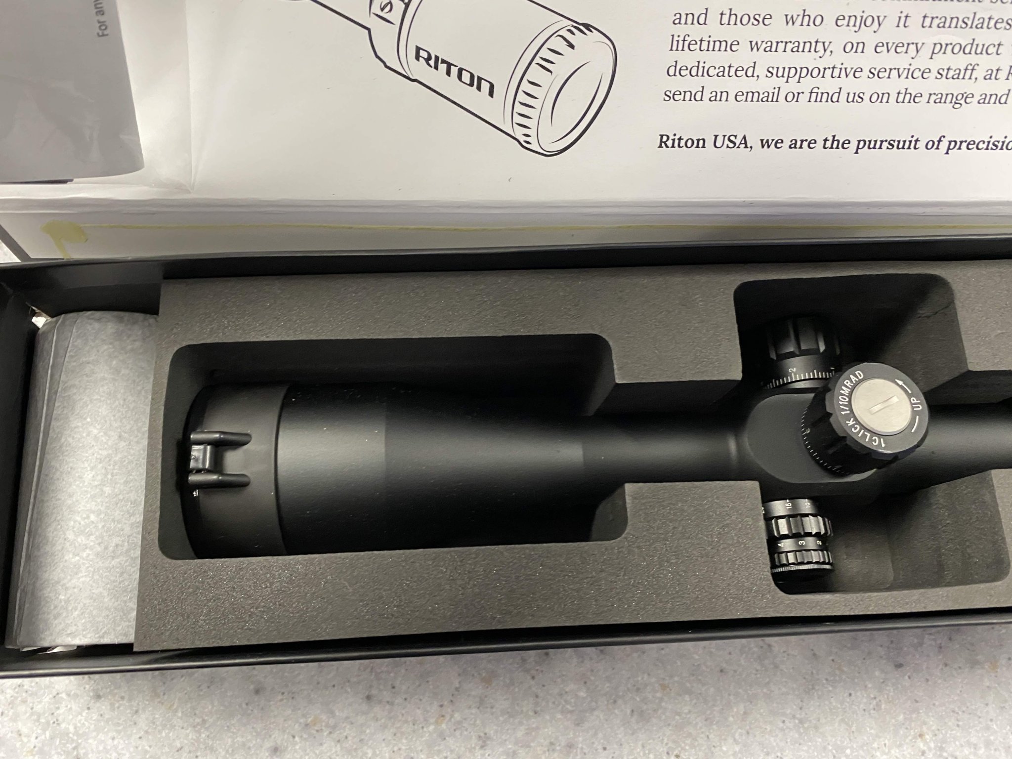

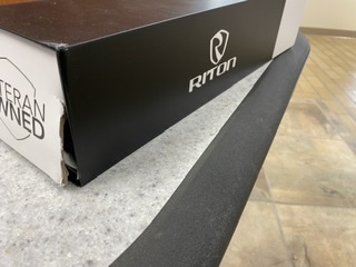

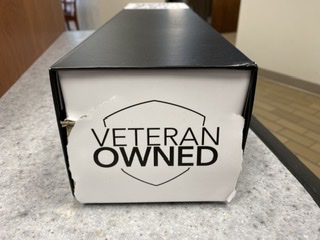

UPS f’ed up my box. Sunshade is oval but the rest of the scope looks fine. Crosshairs are heavier than I like at 25x and eyebox seems more critical than some of my other scope but on par with the Athlon at 27x (eyebox that is), but I will really be able to tell when I mount it and use it.
View attachment 7237725View attachment 7237726View attachment 7237727View attachment 7237728
