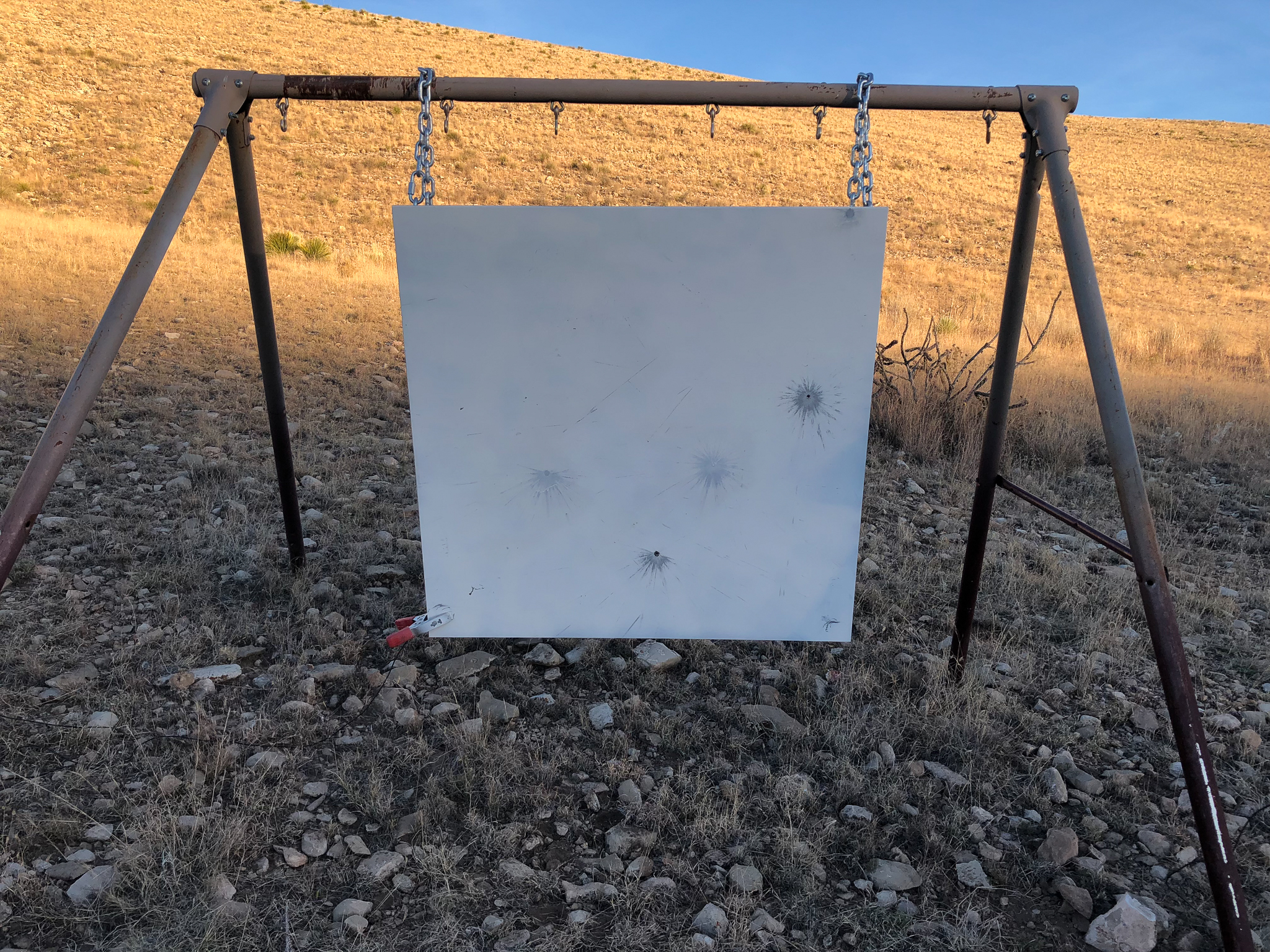

    The company Ritter & Stark is out of Austria and is looking to make their mark on the US Precision Rifle market. Entering the US market is not easy for a new company. My first meetings with them were at the famed Felix Canyon Ranch in New Mexico. Ritter & Stark hosted an ELR Event using their factory rifle to shoot factory ammo at ranges beyond 1 Mile.
Initially, they were off to an ambitious start, trying to tag at 40” plate at 4000 yards with this combination. While the conditions were not very favorable to the endeavor, we came awfully close with Ray Sanchez of Thunderbeast Arms showering the Target with debris. Moving into more practical ranges through, the SX-1 proved itself very capable with factory 300gr 338LM Prime Ammo.

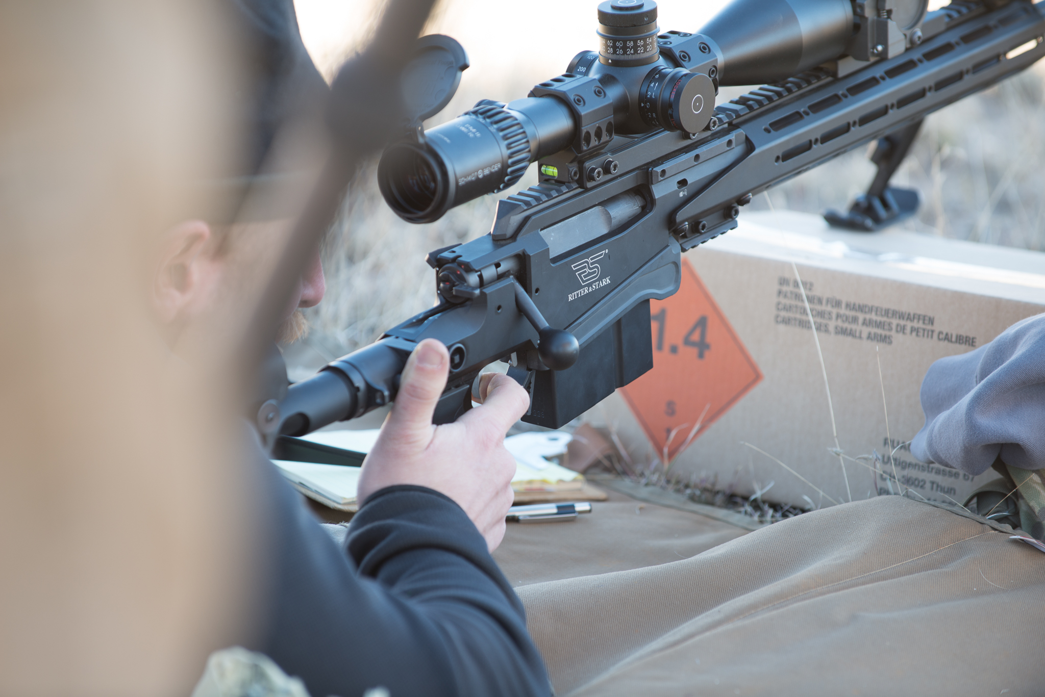

The nice thing about this rifle is, it uses Remington 700 style triggers. This particular rifle had a Bix & Andy trigger in it. Others had Huber Triggers. This gives the end user a familiar feel and allows for future upgrades.
    3 Position Safety typical of most military grade sniper rifles.
    The Handguard is an MLOK variant and lets you choose a variety of mounting options.
The folding stock locks up strong and has both a release button as well as an unlock button. So you know you have positive engagement.

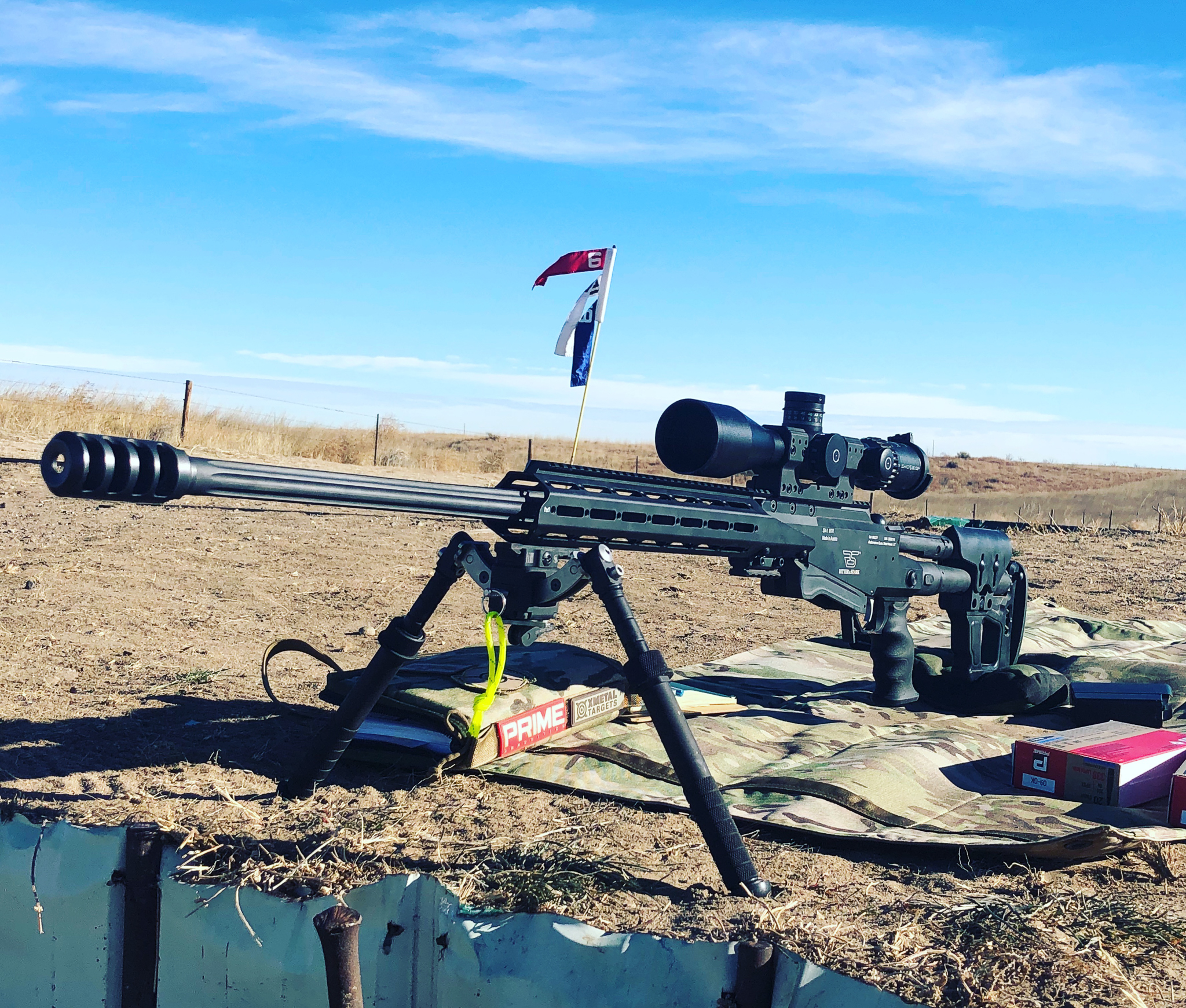

In the video above, there is a combination of shots both locally and at Felix Canyon Ranch. I successfully engaged targets from 1500 to 2600 yards using factory Prime Ammo. In my mind, because Factory Ammo tends to run a bit slow, it was my only limitation.
At the supersonic range, the rifle was easily sub MOA accurate. In the transonic and subsonic regions, I did notice a bit of vertical. I attribute this to the spin rate of the factory barrels. They need to add the bit to the twist rate.
The 338LM Is a 1 - 11 Twist, the 30WM is a 1-10, and the 308 is a 1-11. Moving the 338 to a 1-9 would be a better option, and the R&S crew was very open to this idea.
    I have no complaints regarding accuracy. For a uniquely built barrel, it performs well given the bullet vs. twist limitation. Guys saw much better results with the 250gr Bullets out of this combination, but they did work with 300gr pills.
