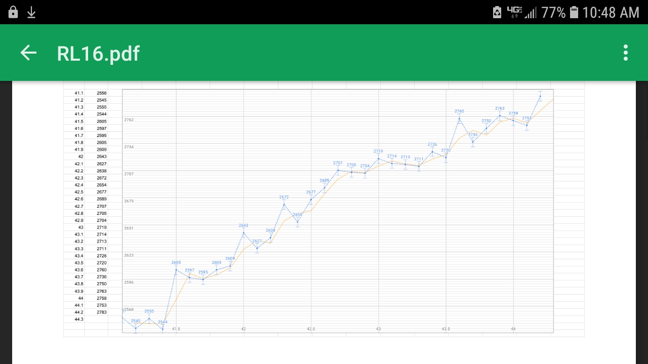

Hello, I have the same rifle and am close to the end of load development. I am using RL16, 140gr eldm, hornady brass and cci BR 2 primers. I found two accuracy nodes. One at 42.0 grains @2706 avg fps. SD of 12.1. The second is 43.5 grains @ 2834 avg fps. 11.3 SD. Both loads are one hole 5 shot groups under 1/2".
