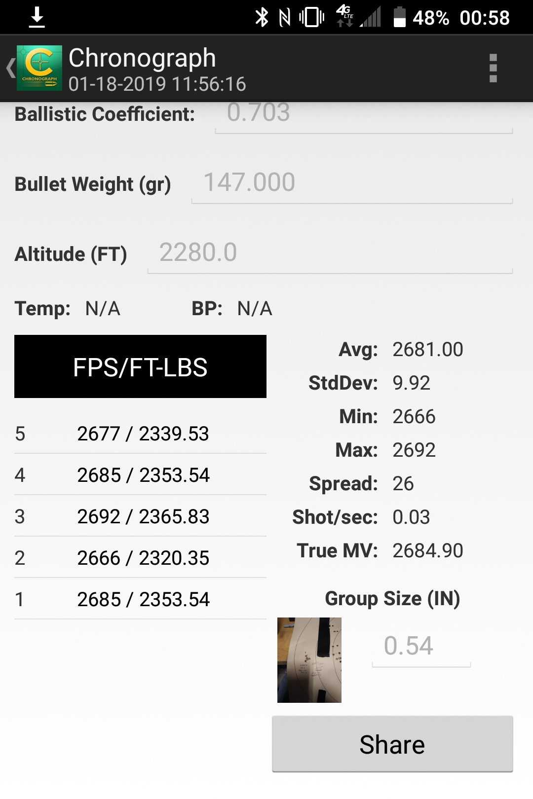

With 41.6 of H4350, I was able to do 2680, SD 10, ES 25, and just over .5 MOA group. Was at 2.84" COAL (.010" jammed into lands). Gonna tune seating depth and probably go .2g in both directions to see if I can do better. Very likely will.

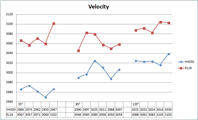

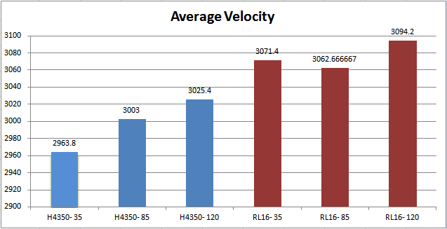

How are the velocity swings with ambient temperature work rl16 for you guys that run it?
I believe (don't quote me) Team area 419 did a test comparing H4350 and RL16 in different temperatures. Although H4350 has been said to have the most stability in temp swings of all Extreme powders, Area 419's results showed RL16 to have much less velocity spread. I'll try and find the link to the post I read and get it up here.
I saw very little shift, honestly. I tested on a 55 degree day, again a few months later on a 78 degree day and again on a hot ass 92 degree day. I saw a difference around 17 fps (55 to 92)? I would have to look at my data book to know the number. Between that, the accuracy and the availability I don't even look for H4350.

How are the velocity swings with ambient temperature with rl16 for you guys that run it?
My tests also showed it was slightly better than h4350.

Its in a 6xc using 105s, 39.4 gr H4350 and 39.7 gr RL16 as those are my loads I developed that shoot best
Ammo at 35, 85 and 120 degrees, 5 shot samples.
