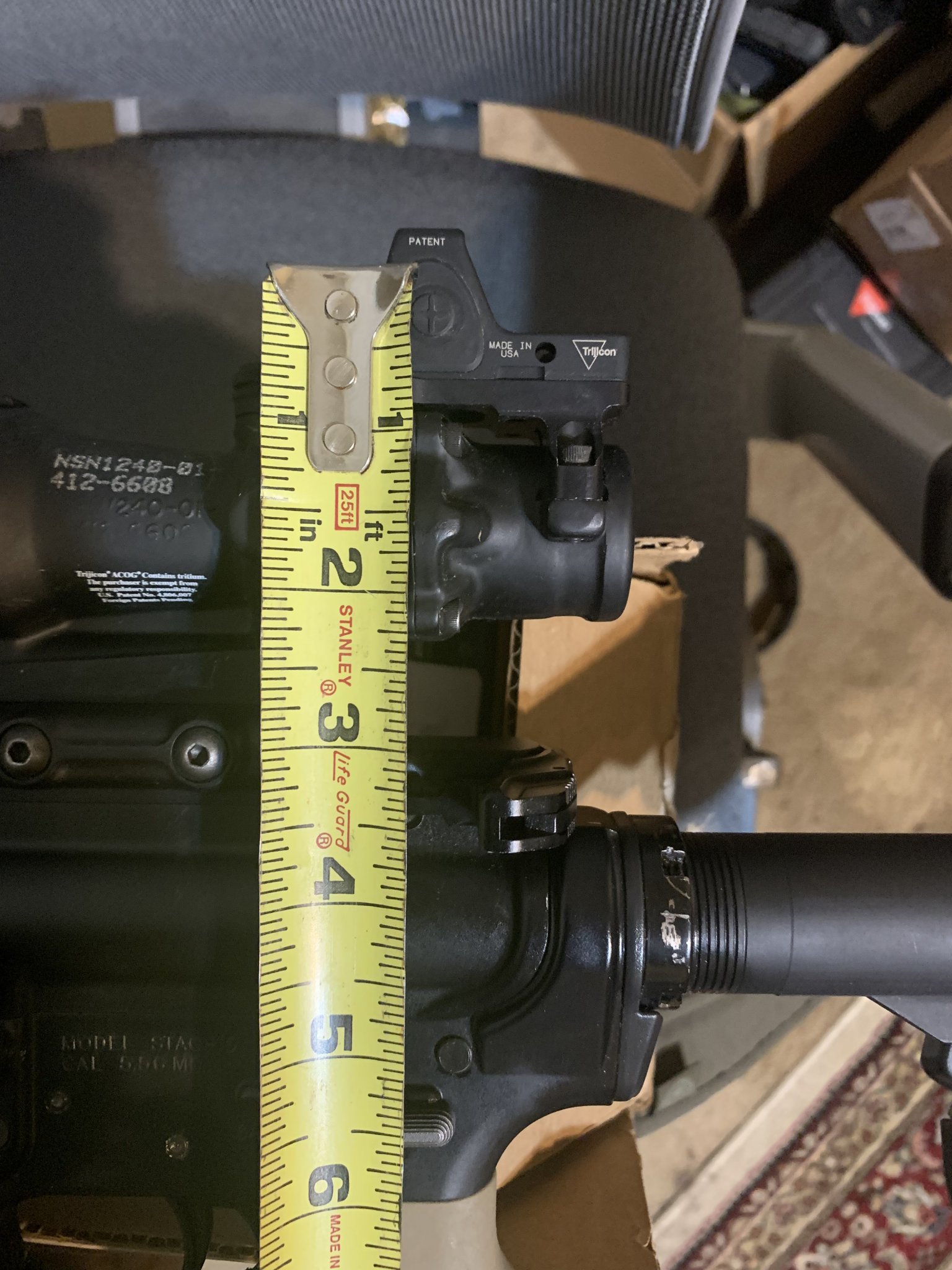

A friend has the Reptilia 1.54 mount but in 30mm with the RMR front cap. I don't know what the exact height is, but after shooting it this past weekend it felt to be close to the Unity Aimpoint micro height to me.

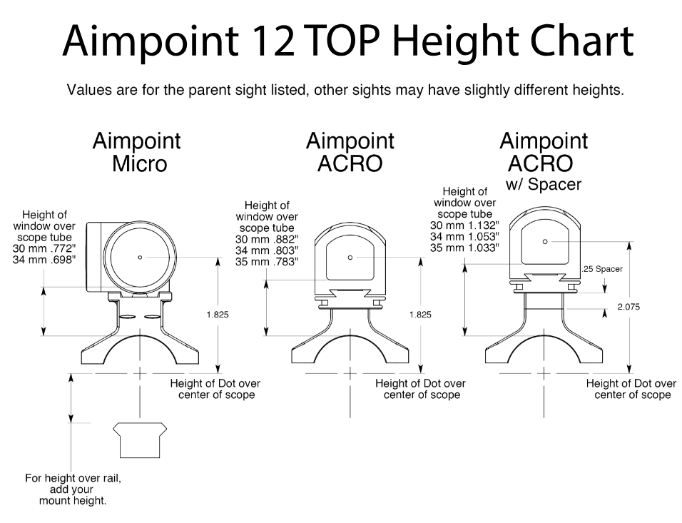

I'm not sure why manufacturers don't make this information more accessible in the same way their other ring and mount heights are. I've played hell trying to find info on the heights of the NF Multimount ring cap, Larue ring mount, and others'. Anyway, in my perusings I found this thread on TOS that applies to the Reptilia mount, albeit for 30mm scope tube but it's easy to adjust the dimensions for a 34mm tube:
Basicaly, it appears the 12:00 mount will add about 1.4" to your height over bore so in a 1.54" mount you're looking at 2.94" and 3.1" for a 1.70" mount.

So, “assuming” a 1.2” height from bore to top of pic rail, if I add the 2.96” or so to centerline of RMR with 1.54” rail I’d be at around 4.15”, give it take .1”. Current ACOG setup is about 4.25” with the Schaffer Machine mount so it’s gonna be so close I don’t know that I’ll notice a difference.

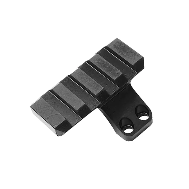

Are you looking for a Badger ring cap with a pic rail like this one?

RE: ring cap. I think that may be it. I don’t think they made one for an RMR for 4 or 6 screw rings? The RMR pic base is going to add a lot of height though, which I had not considered.

I don't recall seeing a ring cap from Badger that was specific to a RMR or Aimpoint, only the pic rail caps. Wilcox may have done one for the Badger mounts since they did one for the Nightforce rings but I'm not sure, all that stuff has been discontinued unfortunately. I tried the Badger pic rail cap with my NXS 2.5-10 and didn't like it, it was pretty high.

Nightforce does carry a pic rail cap, but same deal. It’s not so much the cap as it is the red dot plate adapter raising the dot.
