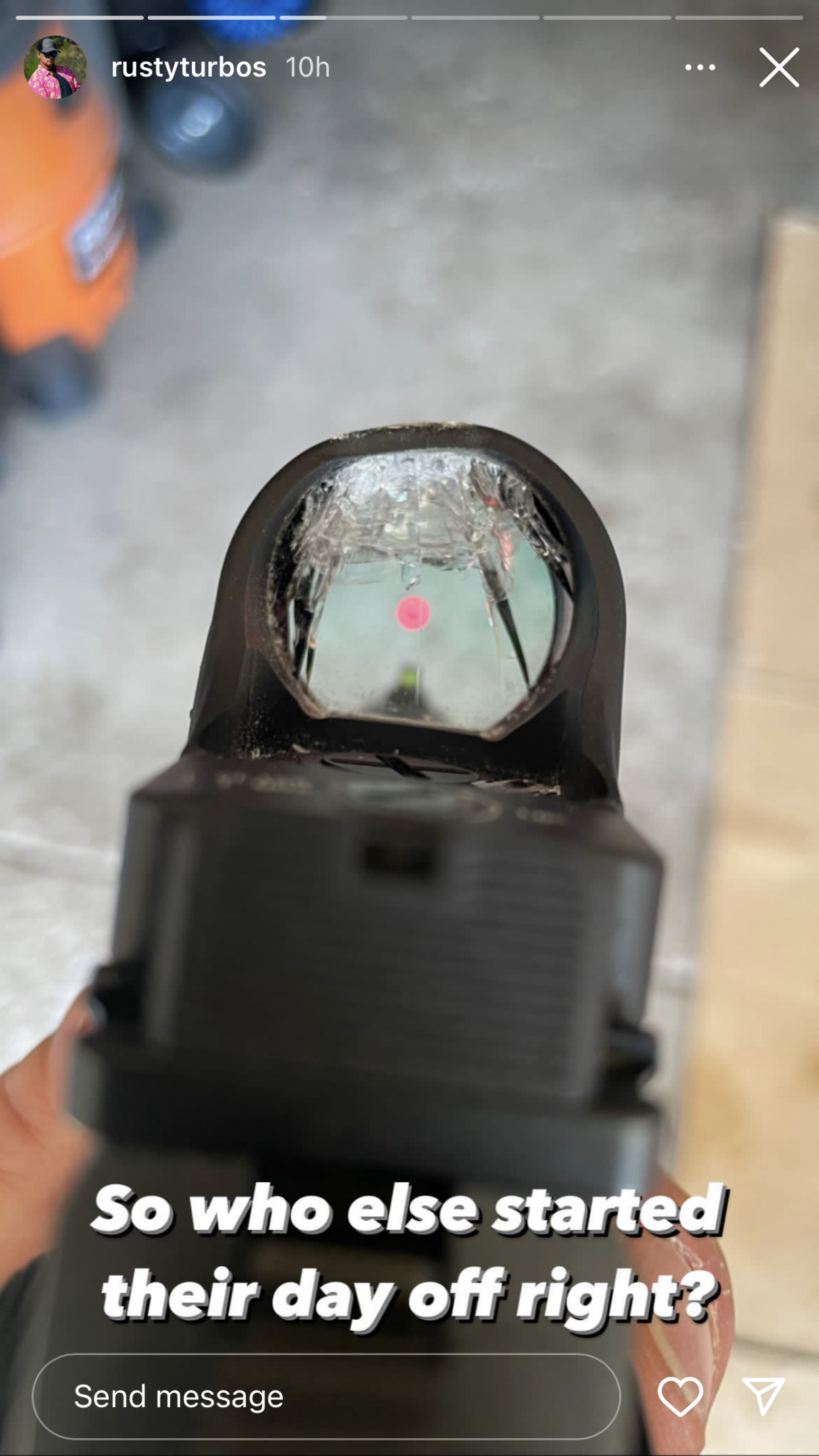

A) Not a cop
B) I've dropped a pistol with an SRO pretty hard. Pistol did not land with the SRO pointing down, but it did land on gravel. SRO didn't break, didn't even lose zero.
C) I prefer plate systems for their versatility but they have to be designed with cross-wise interlocking features between the slide and the bottom of the plate to take the shear forces generated by recoil so the screws don't bear that load. Screws are designed to take tension loads, not shear (sideways) loads. CZ, Beretta, and Walter have plate systems that meet my criteria. Glock MOS and SIG do not.
D) I'm both a regular USPSA Carry Optics competitor and a mechanical engineer
From Trijicon's website:
The Trijicon SRO® (Specialized Reflex Optic) is designed with a maximized field of view and a clean, crisp red dot that deliver improved pistol accuracy in competitive-shooting and target-shooting applications.
Notice that Triji doesn't mention duty applications.
I personally know a guy whos SRO crapped out on him after a drop, and have heard similar tales from other via various forums. I had to make this same decision several months ago and opted for the RMR even though I'd have preferred to have the larger view from the SRO.
Reactions: Giraffecaster
Some examples of all optics will fail eventually. Samples of one mean nothing. Your buddy's broken SRO is cancelled out by mine that didn't.
Doesn't matter what Trijicon says on their ad copy.
You’re mostly just using it to brandish, guess the SRO looks more scary
Draw both in front of a mirror 🤷‍♂️
If you’re trying to get home safe, save the money and get a LED safety vest, based on the numbers you’re much more likely to get hit by a car
As far as brandishing, a very big weapon light (looks scary and you can flash it in people faces) and big dot XS night sights would work better and cost less

I personally think the RMR is the stronger/more robust optic but I’m not sure it is a big enough difference that I’d choose it over the SRO for anything stateside, regular LEO type duties.
I think the only way it’s more prone to breakage is a direct hit on hard ground with force or from height. That being said, the 3 times I’ve seen it the dot was still working and useable. Look up Sage Dynamics test on the SRO. He even shoots with it after it busts the glass. If that concerns you and you still want to use the SRO, just get in line for a Jagerwerks BROS. I have one and they’re pretty sweet.
I would prefer direct mount for rigidity and getting the optic as low as possible.
Here is a picture of a fellow shooter who busted his SRO recently. This was on a staccato that fell off the top of his truck directly on the SRO full force.

Thank you for your educational reply. I figured the SRO would function about like you said. The other replies brought to mind something I'd forgotten about - dot size. I agree with @308pirate that the larger dot would be more appropriate for a handgun. However, the SRO does have the round window which might be a human factors plus. I'll have to look at both in person. Store near me would have them mounted on a blue gun. Glock that is. What I carry. Not the blue model.
