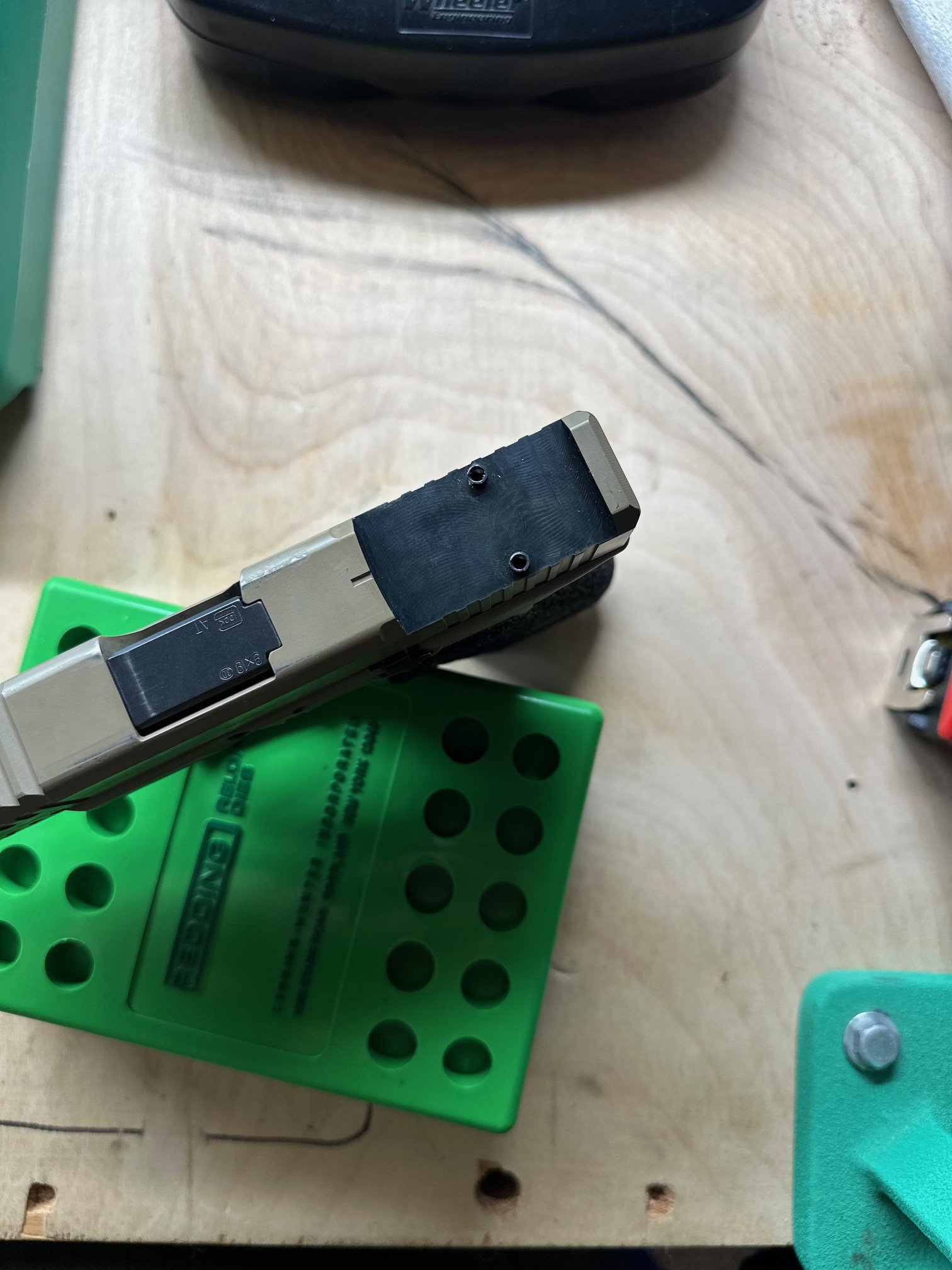

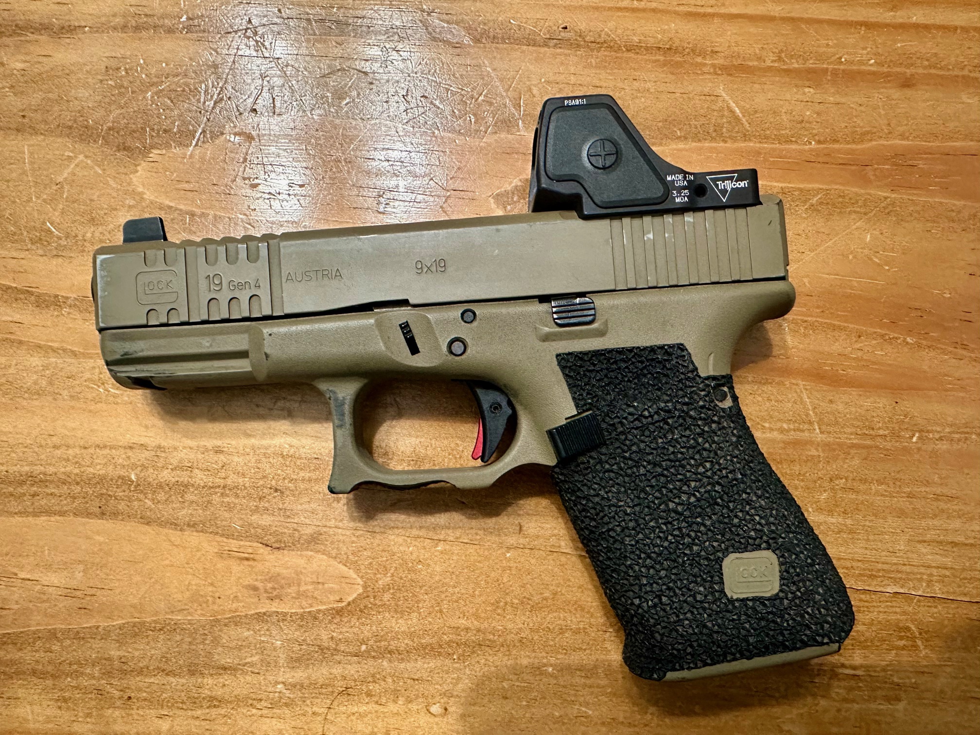

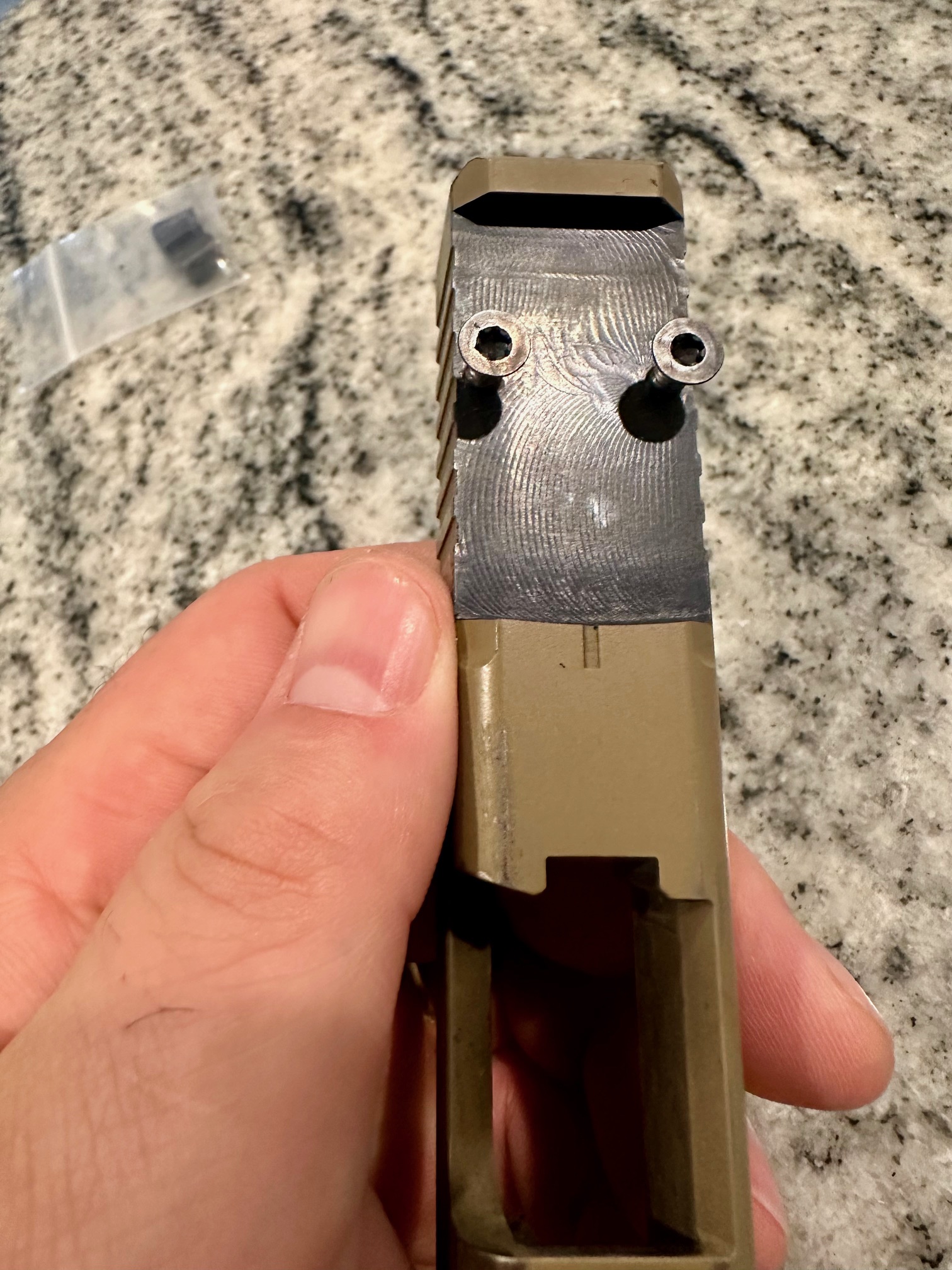

The host pistol is a G19 Gen4 that has about 5k rounds on it before it was sent off to be milled. I choose to use a pistol that has a track record of being dead bang reliable for me. The pistol was milled by Mod 1 Firearms. http://mod1firearms.com/ Some guys commented that the milling lacked bosses, or that the bosses are in the wrong spot or that bosses are good or that bosses are bad, some guys have pistols done by Mod 1 and no issues. It's the internet you decide if you like bosses or not, this pistol has bosses at the screw holes and came supplied with screws. I attached the optic with a little blue lock tight and torqued to 12 inch pounds, we'll see how she holds.
Initial impressions of the optic are all positive. The dot is easy to pick up, I like the eotech style reticle, top load battery seems like a massive improvement over the previous style, not having to use a sealing plate is nice and most importantly to me the auto brightness is FAST. When you turn on a surefire X300 the reticle almost instantly is bright and doesn't wash out. Soon as you kill the light it's right back to dimmer, pretty impressive and kinda of a no shitter moment that the sensor should be target facing.

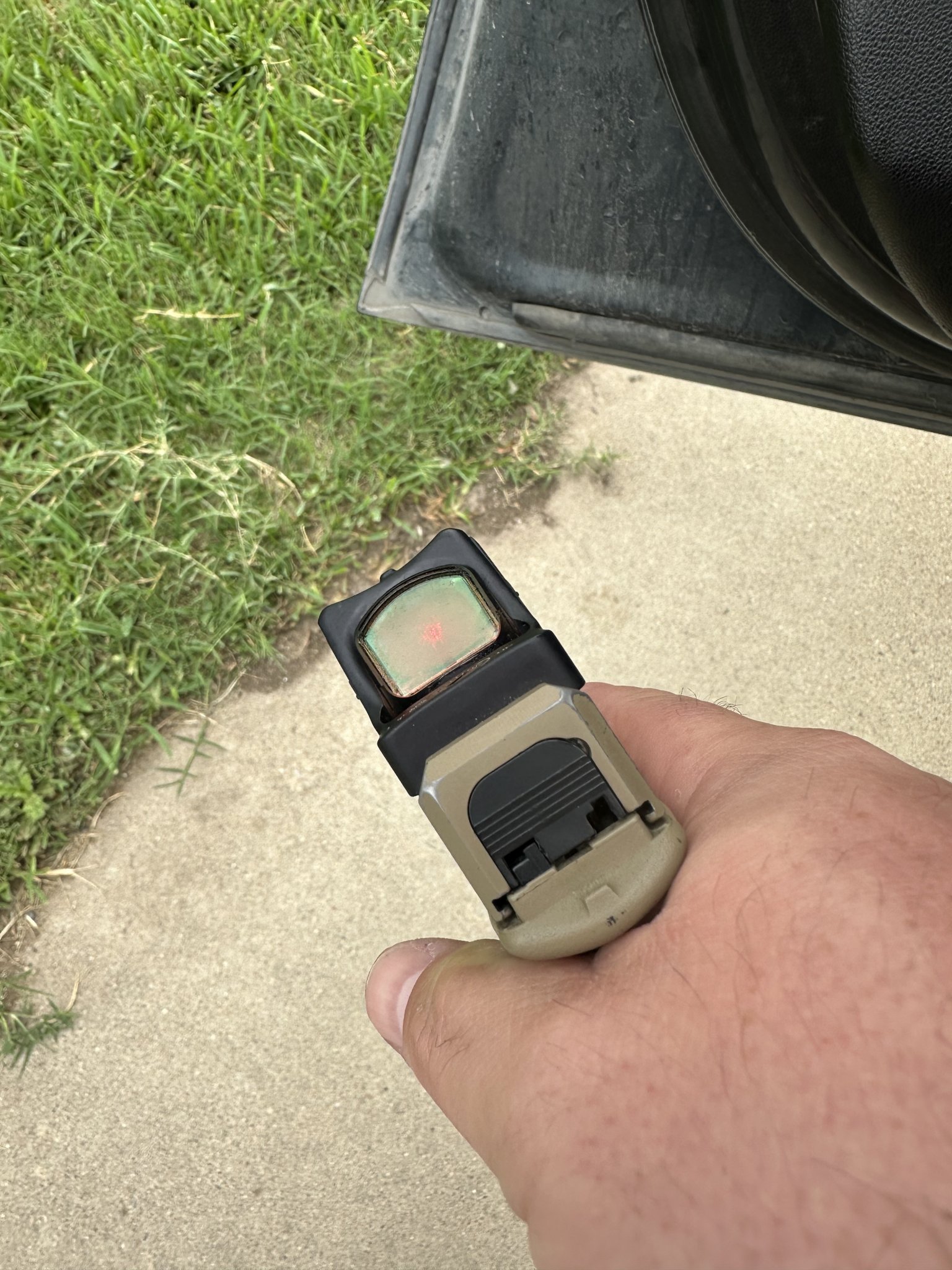

Noticed something interesting as I left the house, optic was completely fogged over….it’s 90° 99% humidity outside and 70° in the house.
The picture doesn’t do the reticle justice, it was clearly displayed against the glass, but the glass was essentially frosted. Well that’s fucking interesting was all I could think. I sat the pistol infront of the AC vent on my center console so my first few shots it would be fogged up.
I got down to the steel, painted it, exited the truck, holstered the gun and drew from 15 and just kind of sent it into the center. Optic was fully fogged out but the reticle was displayed clearly on the fogged glass. The double tap was within 6” of where I intended. The optic was 80-90% opaque, but it didn’t seem to matter.
I spent the rest of the next hour or so from 15 to 50 plinking and having a few cold ones. No issues to report other than the fogging, I’ll probably run the glass with some cat crap to see if it fixes the cold to humid/ hot fogging. https://tnvc.com/shop/tnvc-field-cleaning-kit-cleaning-kit-accessories/ I run it on my nods and it really helped with going from a cool truck to a humid field.

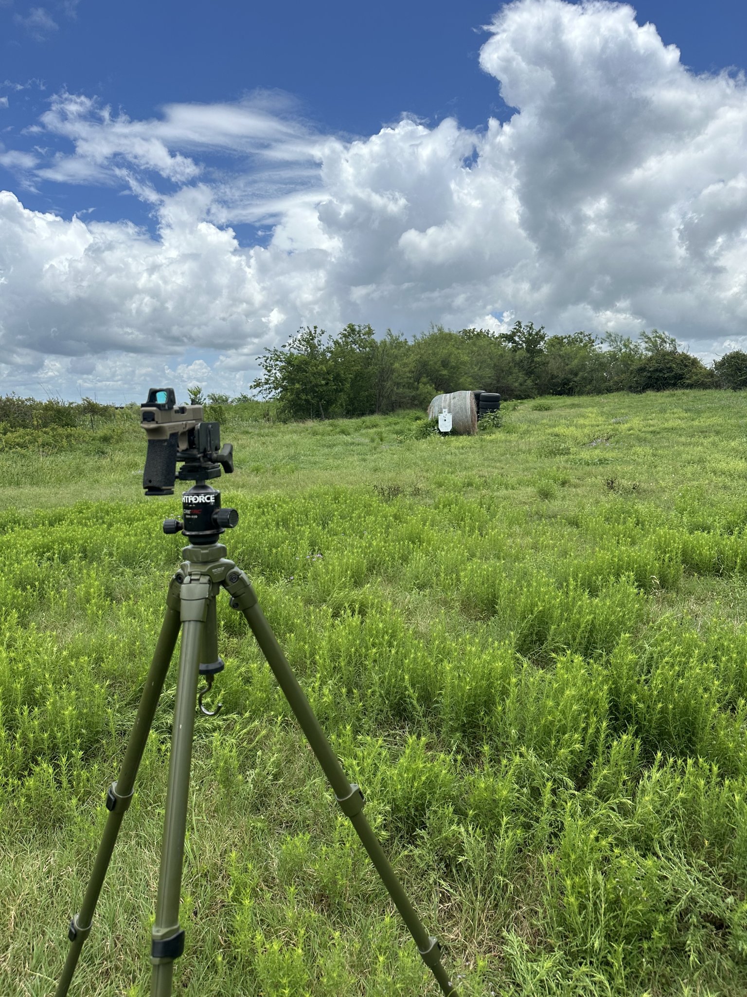

Started off with the redneck ransom rest at 25 yards- note this was with the 15 yard zero. Gun was consistently high.
Rezeored at 25- I figure those groups are about as accurate as I'm going to get with WWB and a stock barrel. POA was the top of the black triangle, bottom was shot with the gun off the tripod.

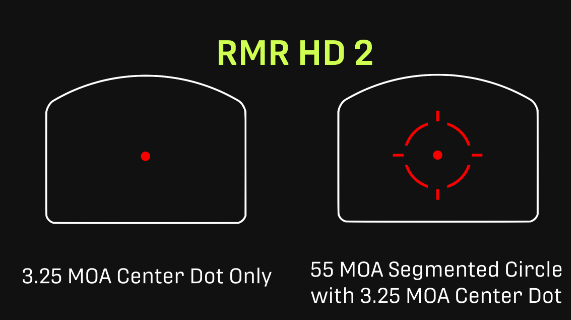

Swapped the reticle from the eotech style reticle to the dot this weekend.
At this point I'd clocked 1300 rounds and change with the reticle so I just wanted to see if I had got acclimated enough to swap to dot alone and it was as game changer. I was much more precise and able to be more target focused. I don't know how to describe it other than that sensation when your a kid and you ride a bike without training wheels for the first time and you mentally go "holy shit I get it".
It was that kind of epiphany, the dot just appeared and blam the plate is down. I do think using the eotech reticle was great for retaining my brain...kinda hard to miss a 55 MOA reticle on the draw, but swapping over the the 3.25MOA dot only I really saw an increase in precision and speed.
The auto brightness with just the dot was just as easy to pick up and adjusted just as fast.

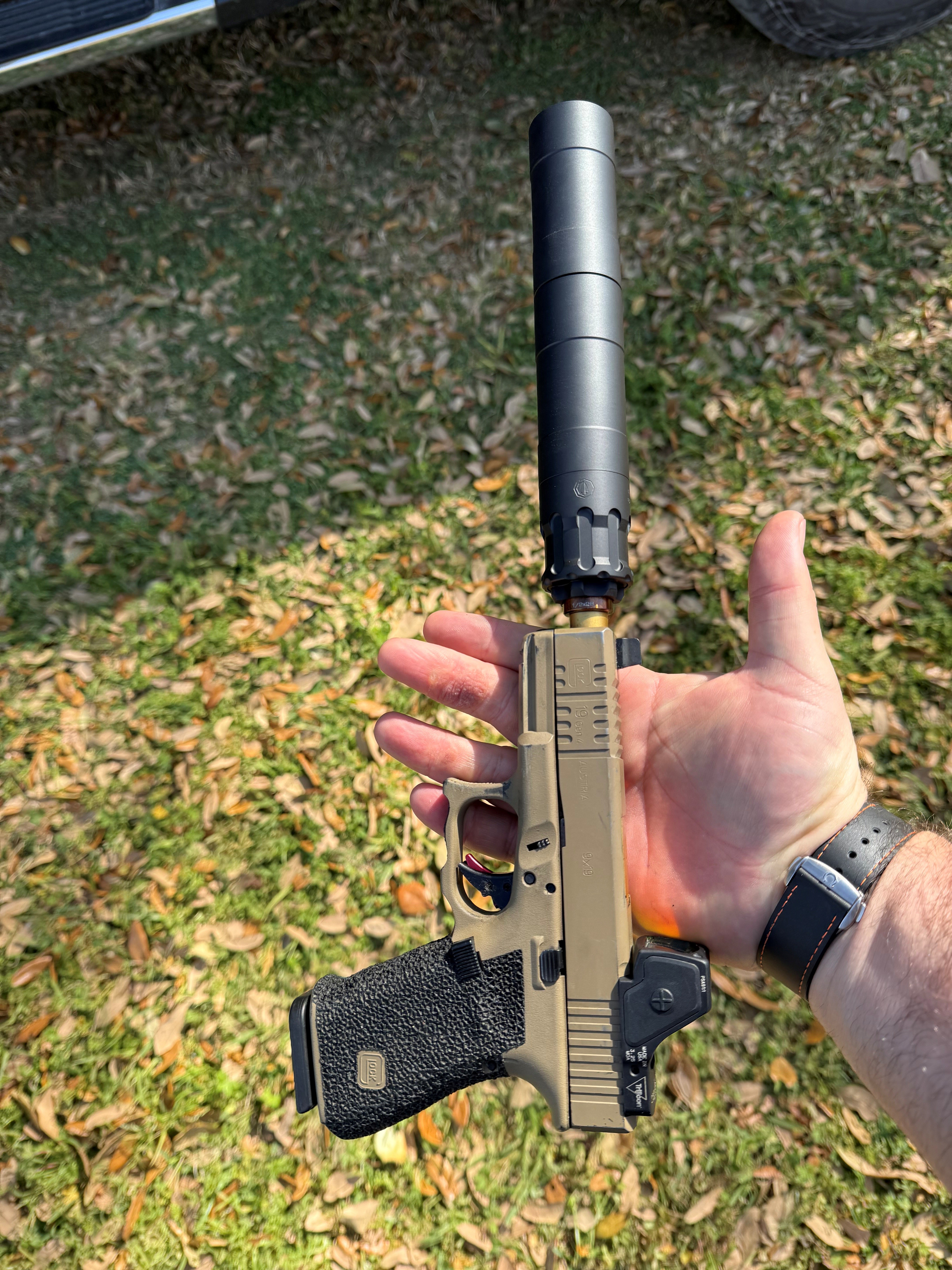

Still ticking along, but did have one minor issue the other day- oddly enough suppressor induced.
At this point I have no idea how many rounds are through the optic, a shit load, 9 is like 250 a case delivered and I have a plate rack in my back yard....it gets shot several times a week. Since NFA stamps are running as fast as they are I went ahead and picked up a Rugged Obsidian 9mm can. Overall great can, not practical for much other than screwing around at the house, but it's awesome at that. Shooting a plate rack at night...under nods....with a red dot....on a suppressed pistol is pretty damn fun, impractical as shit, but fun.

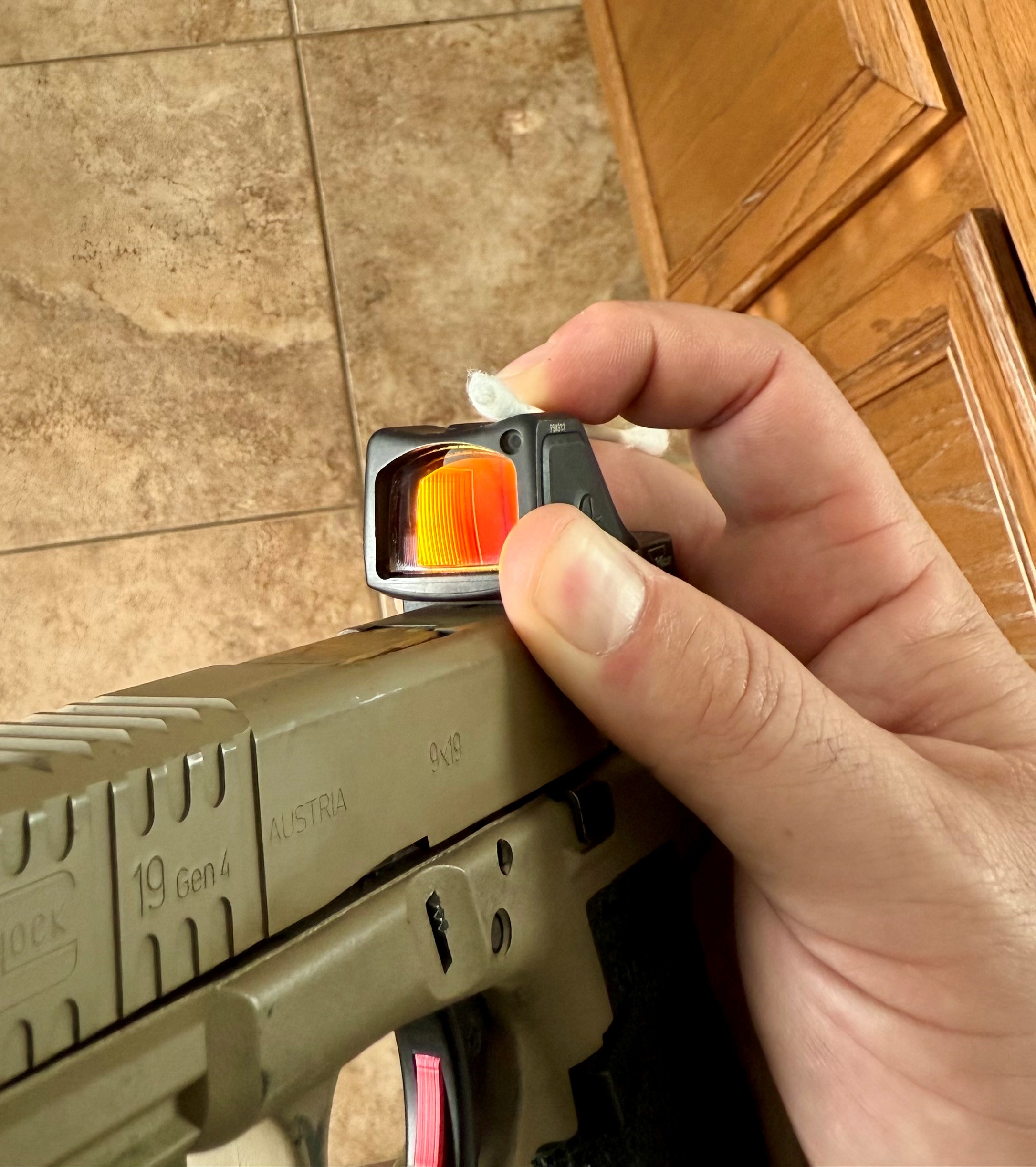

I noticed one afternoon that the dot was extremely dim in full sunlight. Initially I though I had inadvertently turned off the auto feature or had a dead battery, but both theories were wrong. Gunk from the suppressor had obscured the forward facing light sensor, making the optic think it was in a low light environment. Hit it with a qtip and back to normal function. Doesn't look like a lot of gunk, but the picture is kind of washed out. It was a surprising amount.
To date I haven't done anything to clean the RMR other than apply cat crap to stop fogging, but I didn't apply it to the light sensor. Addressing the light sensor on cleaning will just become part of the routine, easy enough. Probably not an issue unless your running a suppressor alot, wasn't an issue until I started running a can.
