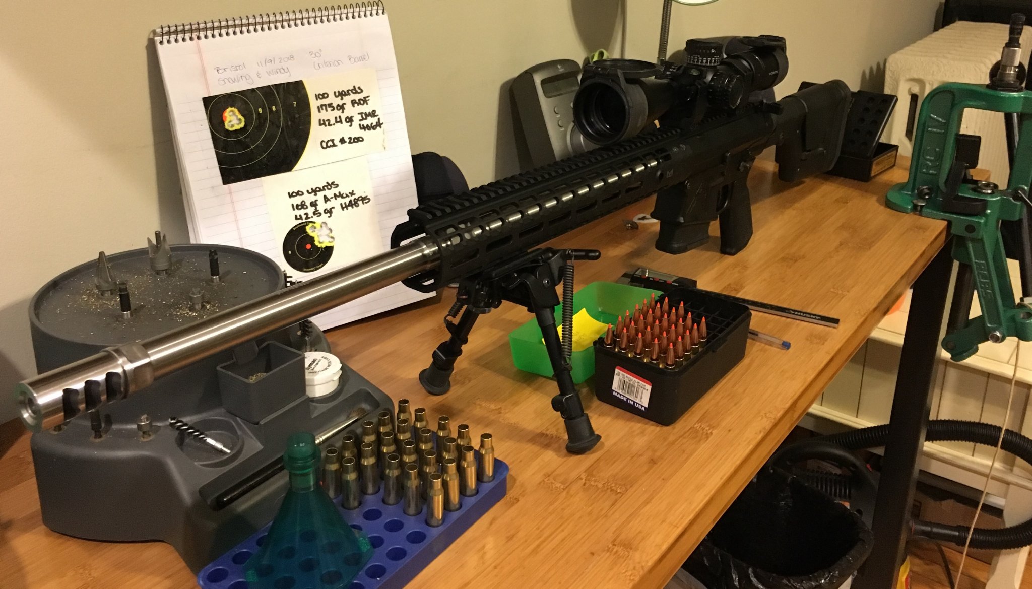

I have a 24-inch Criterion Barrel from Fulton Armory on my LR-308 in 308 Winchester. It's certainly not as accurate as my PRS match rifle, which is a 1/4 or 3/8 MOA shooter consistently, but I am able to shoot 3/4 to .9 MOA groups for 5 shots.
The rifle is an M5E1 Aero Precision build. It has a Larue MBT-2S trigger, Toolcraft NiB BCG, H2 Buffer, Superlative arms adjustable gas block, and it's toppied with a Vortex Gen II Viper 3-15x. In hindsight, I probably would've saved the money and gone with a cut rifle barrel from a top barrel maker. I'll be honest in that I wasn't able to shoot sub-moa with this rifle for quite some time. Shooting a gas gun with precision was really hard for me and it took me a lot of practice and trouble shooting, but after about 1,000 rounds down the tube I got the hang of it.
Photo below is some of the best groups I've shot. Bottom group is 168gr A-max with H4895 for 10 shots, however I did run into pressure with this load and stopped using it. I also miraculously shot a few 1.5 inch groups at 300 yards with the top load which is basically a 175gr FGMM clone. I use 41.8gr of IMR 4064 with a 175gr SMK and 210M primer in LC brass.
