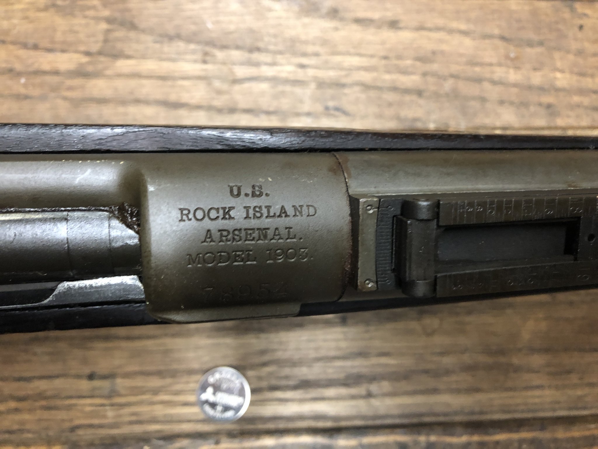

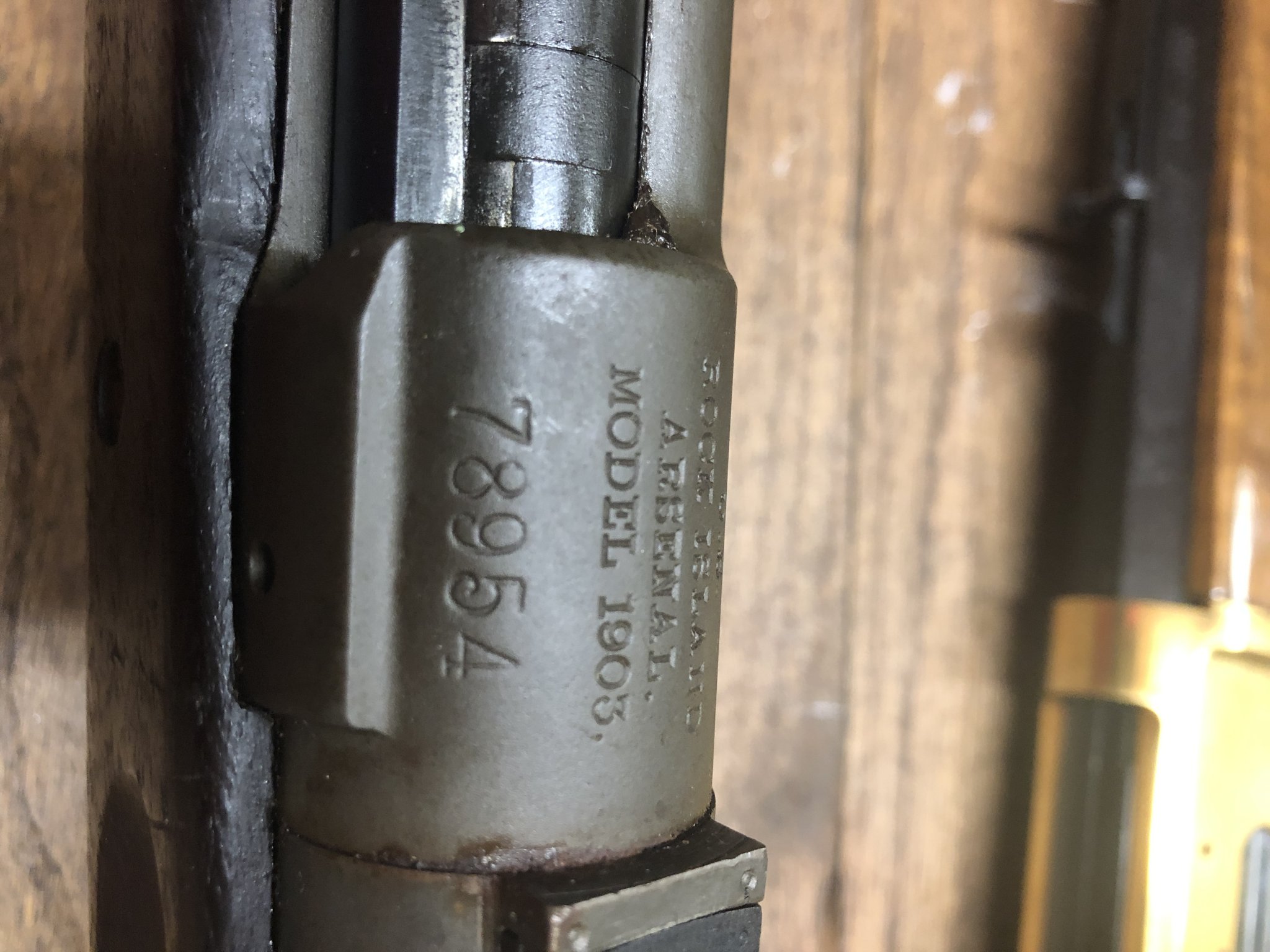

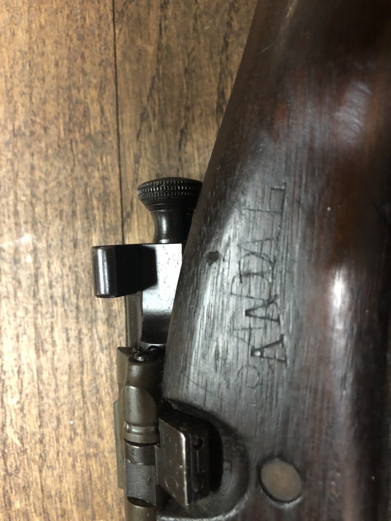

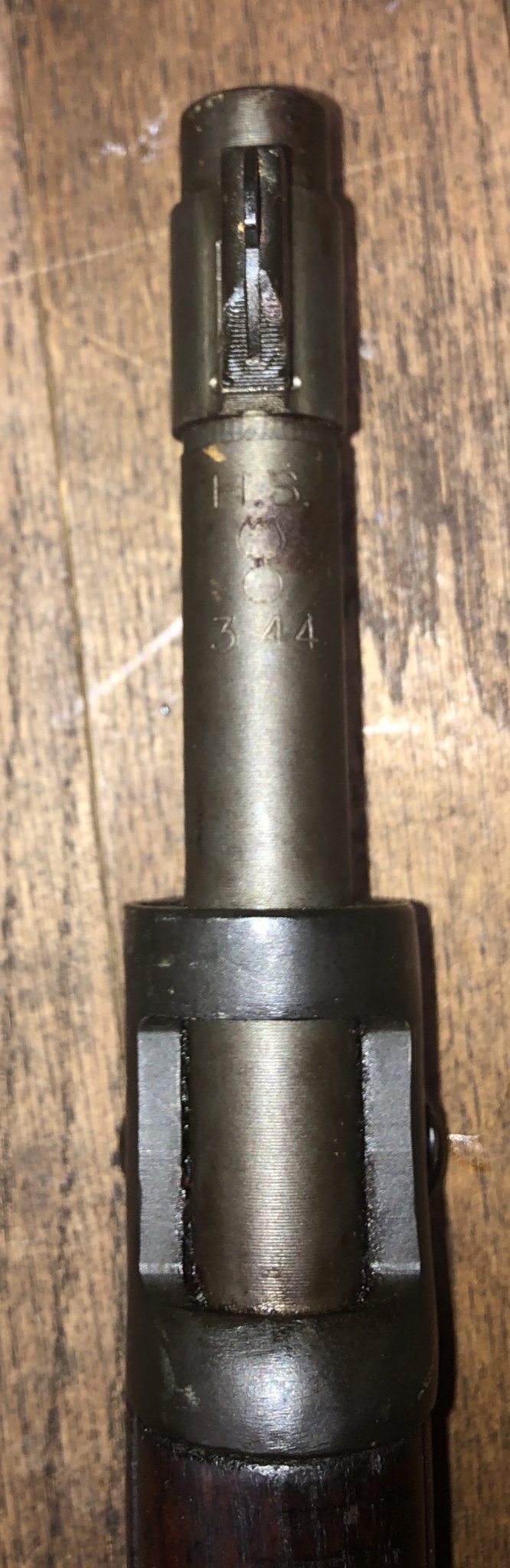

Rock Island 1903 help.
trauma1
May 23, 2012
737
32
I have a Rock Island Arsenal 1903. I am not educated about these rifles other than What I can get from google. Could you guys help me understand the history and value of this weapon thanks for your time.

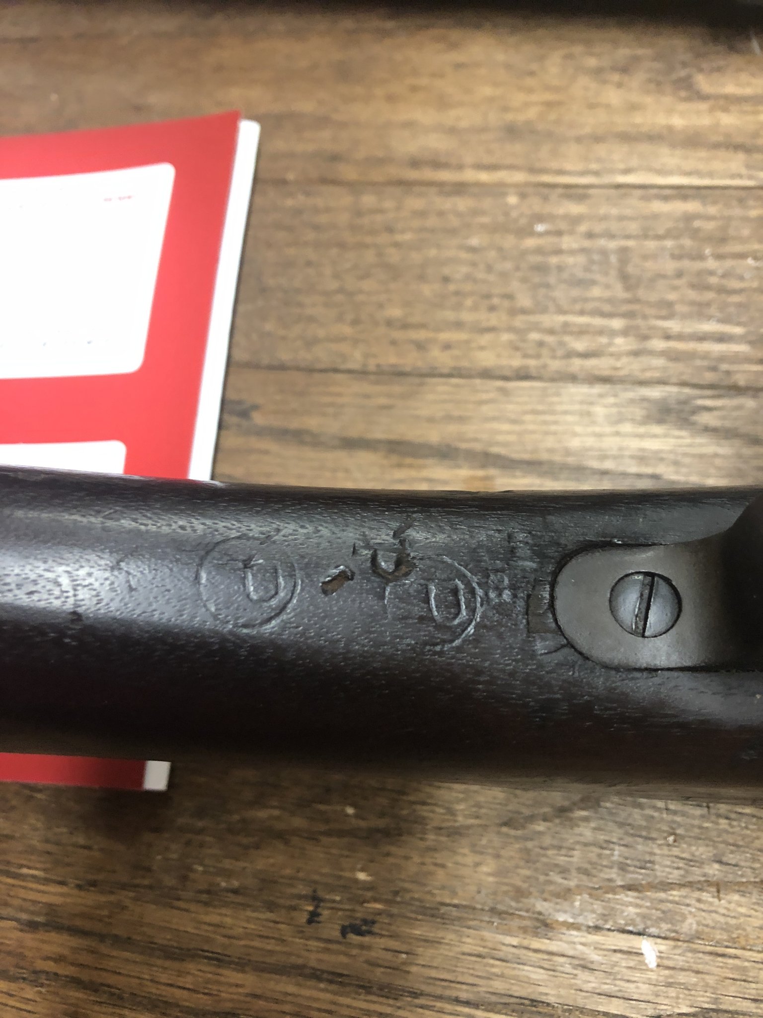

Lots of history on that rifle.
Few rebuild marks. Three proof fires. High Standard 1944 used for rebarrel.
Likely it saw two wars.
The green parkerizing intrigues me as its kind of a signature of Navy/Marine rifles.

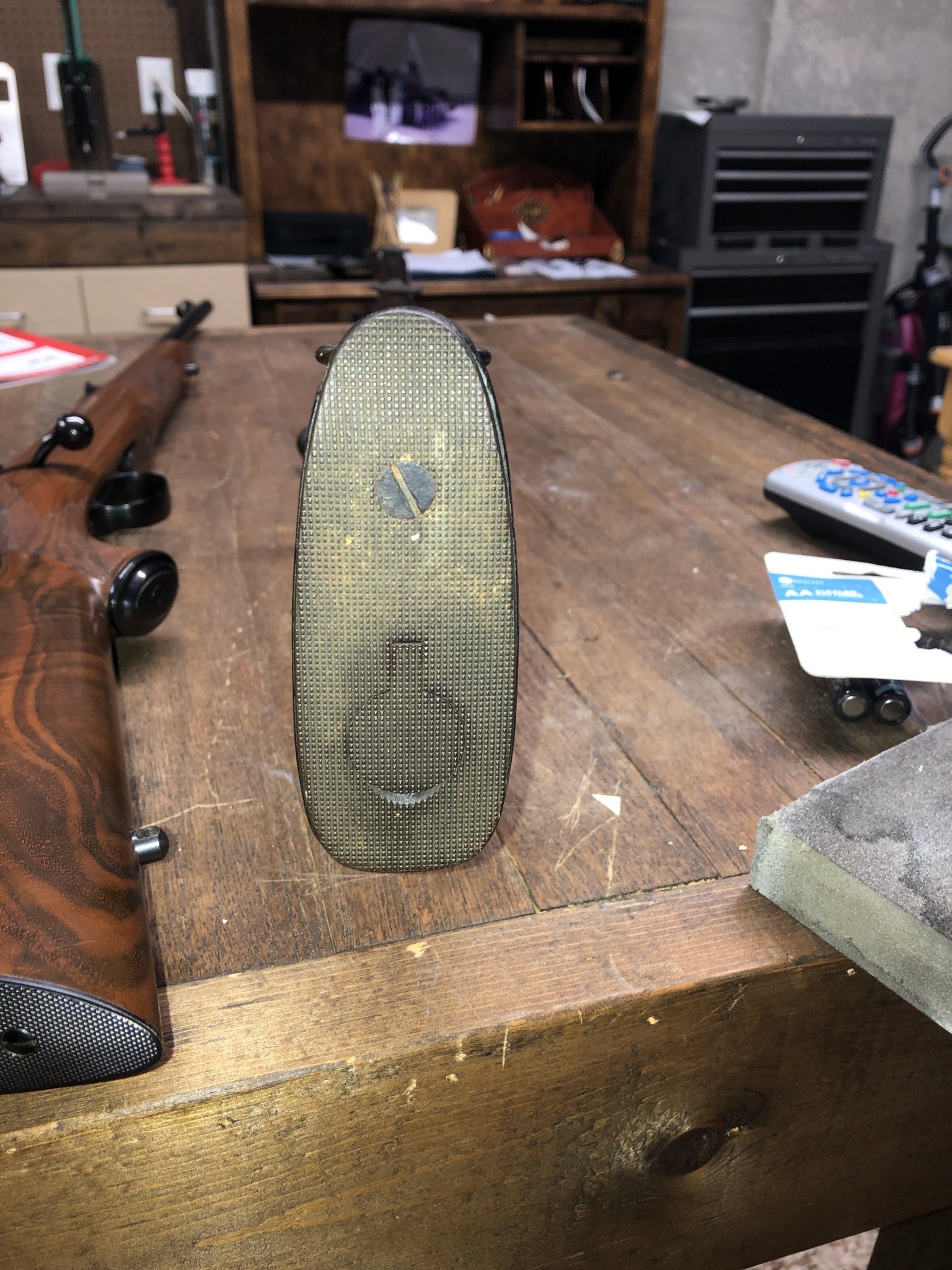

What does the butt plate look like?
Do you have any pictures of the barrel under the handguard?

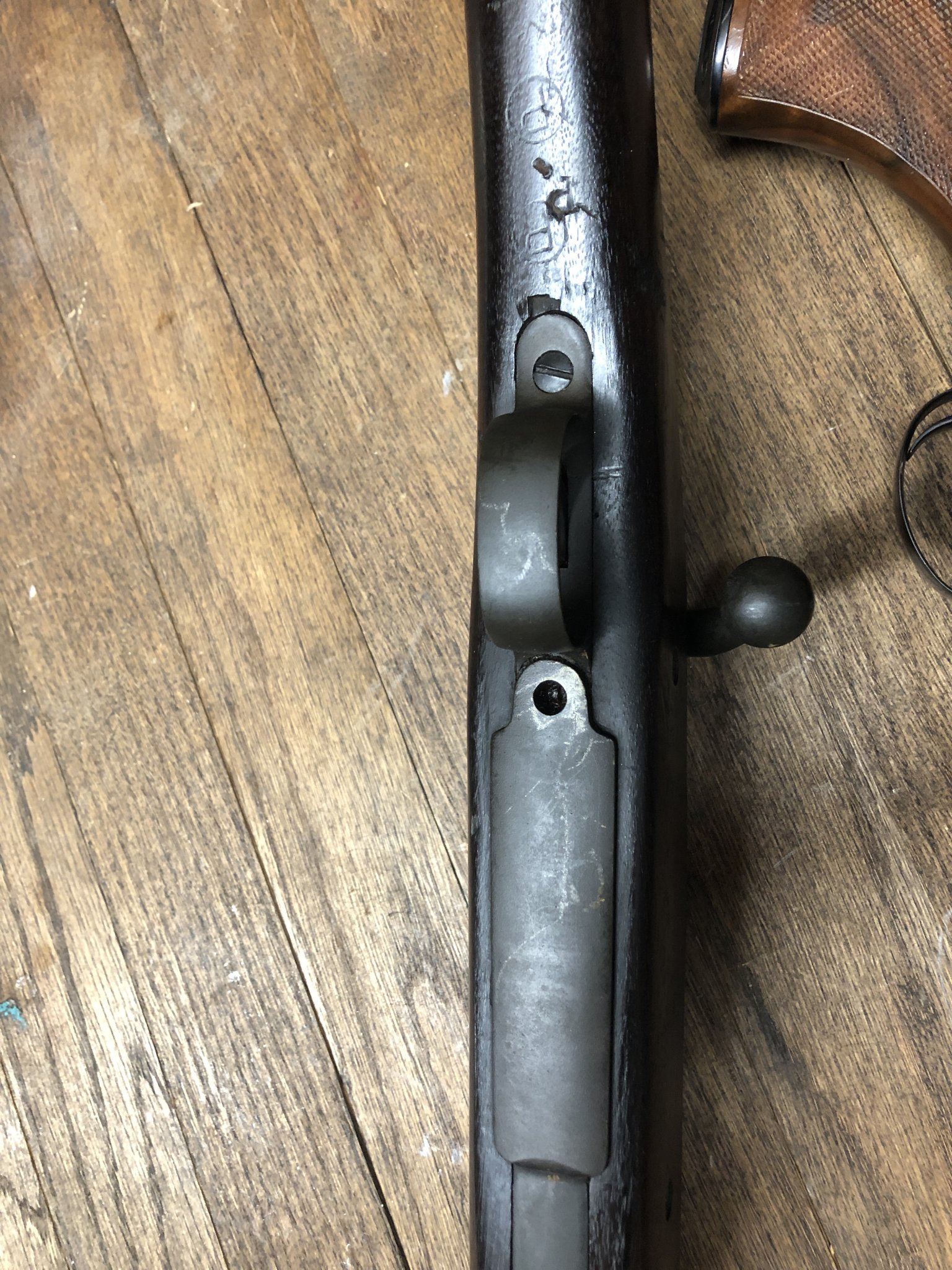

How about a picture of the action screws?
@cplnorton might have some SRS info on your serial number to possibly find some detailed history.
Thats a good looking honorable rifle. Dont mess with it please.
Reactions: camocorvette
The 3 P stamps suggests at least 2 re-barrels and the "AAD" rebuild stamp on left suggests it was rebuilt at Augusta Arsenal in GA during WWII or immediately after WWII, which is likely where it got it's 1944 barrel. So lots of US military history there, but its a very non-original rifle that has been re-barreled twice and refinished, but what hurts its value is the "low serial" range, thus is not recommended for shooting.
Reactions: trauma1
Looked at pics again.
Not likely to be Marine/Navy.
Surprised its never been modified for added gas relief, formerly known as a Hatcher hole, now going by a new nomenclature.
No signs screws were ever staked.
Interesting rifle.
The 3 P stamps suggests at least 2 re-barrels and the "AAD" rebuild stamp on left suggests it was rebuilt at Augusta Arsenal in GA during WWII or immediately after WWII, which is likely where it got is 1944 barrel. So lots of US military history there, but its a very non-original rifle that has been re-barreled twice and refinished, but what hurts its value is the "low serial" range, thus is not recommended for shooting.
The "low number" warnings are being given less emphasis these days amongst scholars but thats a gamble each owner has to take on his own.
Death or maiming being the result of guessing wrong.
Thank you, what is the other stamp underneath the AAD? I think it is SADAL

Every rebuild I've seen (or own) out of Augusta has that green park.
The rebuilds I have from Springfield are gray park.
So far.
SADAL best guess is Springfield Arsenal Daniel A. Leary.
Stock stamped DAL best of my education are Daniel A. Leary who we know did work for SA.

At the Archives I found a lot of info on the low number receivers.
But in a nutshell there were about 30 failures total that caused the low number receivers to be condemned. Over half of them were actually during WWI. Almost all 30 were defective ammo related. There were hangfires that would wreck the rifle as the user would open the bolt after hearing just a click and it would explode, some lots of ammo had excessive pressure that was past the 70,000 PSI safety limit of the receiver, then some soldiers were shooting German ammo out of them.
This one to me looks like a traditional WWII Army rebuild. But it's sort of an interesting story of how a low number came to be rebuilt in WWII. The Army never pulled low number receivers from service as what is the common held belief. They actually didn't do anything to the low number rifles unless the barrels were worn out and the rifle went in for rebuild.
So if the low number rifle never needed rebuilt, it stayed in service the whole time. Many tens of thousands if not hundreds of thousands served the whole time. But between 1928 and 1940, any low number receiver for the Army that went in for rebuild was replaced with a high number receiver. The low number receiver was either put into storage for war reserve or was destroyed.
The Marines never pulled low number receivers at any point. All they did was not fire rifle grenades out of them. That was the only restriction and that too was even lifted by 1938.
But in 1940 the Army lifted the ban on using low number receivers in rebuild, probably because they needed rifles for the upcoming war. So they started to assemble low number rifles for the war effort.
There is not one documented failure of a low number receiver in the Army past 1927. In fact they discussed this around 1944 detailing that no one had seen any fail after the last of the surplus WWI defective ammo was used up. Rock Island which was the main rebuild depot for the Army, and had rebuilt hundreds of thousands of M1903's, actually declared low numbers safe in 1944 and argued that point to Ordnance.
Ordnance followed suite declaring the same, saying they were entirely safe as long as they headspaced correctly and could fire a proof round. Ordnance continued this same stance even as late as 1952 declaring low numbers safe.
The Army even in 1927 at the height of their worries on the low numbers, weren't concerned with the receiver just failing on it's own. They were concerned how it would react to defective ammo. So the decision to pull the receivers for rebuilds, wasn't because they felt the receivers would just grenade under normal circumstances. They were concerned how they would react to excessive pressure or defective primers.
It is interesting to note too, they still had the same heat treatment issues with high number receivers. One of the biggest misconceptions are just because you have a high number, people think they are entirely safe. They had many problems with high numbers heat treatment being too brittle, which is dangerous. So that is one take away I preach about. Everyone has a false sense of security on high number receivers, which that is not what the documents state.
In fact the funny thing. The Service rife with the most failures and most soldiers and Marines injured, wasn't a M1903 at all. It was a M1 Garand. lol A lot of M1's were not safe at all. In fact the main engineer at SA stated he couldn't sleep at night because of all the safety issues with the M1 Garand.
There is a huge story on the safety of the M1 Garand that would crack people up if it ever came out.
But It's really a roll of the dice anytime you pull that trigger on a low number, high number, or really any rifle in general. Make sure your headspace is correct, as it's more likely to survive intact if you encounter a defetive round. But please do not be fooled into a false sense of security just because you have a high number receiver. It can fail just the same as a low number if the if the conditions are right.
The additional gas relief hole in the side of the receiver, which is a safety measure, has always been called the Hatcher Hole. Nicknamed because everyone thinks Julian Hatcher came up with it. But that doesn't seem to be the case at all. I honestly cannot find any real involvement of Julian Hatcher with the low numbers. His brother was on the 4 man panel that decided because of ammo safety concerns they should replace low number receivers in 1927/28. But Julian Hatcher which is so famous for low numbers today is entirely MIA in anything official I see. He simply wasn't a integral part of it like we all believe he was. He's mostly famous becuase he wrote a book on this topic, which some is completely opposite of Ordnance's stance on the subject. Then he was also a editor at the American Rifleman Magazine which made his opinion back in the day seem more authoritative.
But the actual guy who was involved in the research of the "Hatcher Hole" was a LtCol Borden. So I have been calling it the Borden hole lately as it seems he is really the one who should get the credit.
The Army did drill "Borden holes." They started to do it on all new manufacture and rebuilds post the spring of 1937. But only Springfield Armory did it. So if the rifle was rebuilt at any depot other than SA, it never got one.
It also looks like SA only drill the Borden hole in rebuilds from the spring of 1937 to the start of the war. I really can't find any mentions of the drilling any during the actual war.
But SA drilled tens of thousands of them on rebuilds so they are not entirely rare to see on Army rifles.
This rifle is basically in its as built WWI configuration. It's not "original" as it first came out of the Armory, as it has been through arsenal reconditioning. What is interesting and unique is its a long serving military item unmolested since leaving service. It might not be pristine WWI era condition but its collectible, value if any, is that it's a real long serving rifle in its intended condition. My advice don't mess with it.
