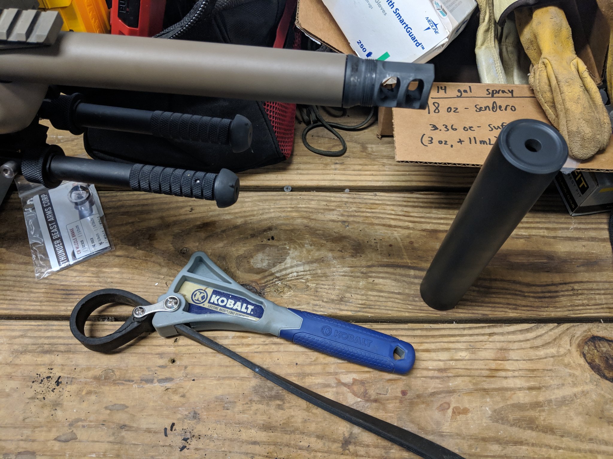

I used some Rocksett to mount a 30CB brake on a bolt gun in December. I have shot it a few times after that, but not long strings of fire, or more than about 20 rounds before removing the can.
Then recently, i shot quite a bit, about 150 rounds in a two day time without removing the suppressor, and when i did, the brake came off with it. So my brake is stuck in my can, and i needed both the rest of the week, so i just used it like a direct thread.
anyway, when i went and looked at my rocksett bottle, there is quite a bit of white particulate that has settled out of it but i went ahead and tried to put the brake back on with rocksett again, so hopefully itll set up and i can remove the can.
If the bottle has gone bad, id assume its not going to hold the brake this time either. I was disappointed because the brake came of with such an easy twist.
I guess im going to chunk that rocksett out and maybe just try locktite?

My experience is that although Rocksett is heat resistant it doesn't take a lot of torque to break it. I use high temp red Loctite for TOMB and it hasn't failed me yet.
Reactions: HansohnBrothers
Rocksett is about the same strength as blue loctite, but it's rated for much higher temps. The key to rocksett (or any thread locker) is making sure both parts are very clean and degreased. It also doesn't replace the appropriate application of torque as that is the primary method of keeping the muzzle device on the barrel.
To get the muzzle device off, I'd clean the barrel threads and brake very well, load up on rocksett and torque it down as much as I can, let it set for 24+ hours and see if you can remove the silencer. If you shake up the rocksett enough, the particulates will desolve back into the solution, but eventually, it will separate out and go bad. I have a bottle that's just about completely white and solid at this point.
Red for me on all my bolt gun muzzle devices. Little goes a long way.
Rocksett has a break strength about the same as blue loctite does. Any supprrssor mounts like the TB CB do not get rocksett. Just a few drops of red. Never an issue.
If you got a mount stuck in a can, you will need to clean the surfaces. Apply some red locktite. Thread it on. Leave it for 24 hours. Then take the can off. Then you can remove the suppressor and then the muzzle device after. You will need to heat up the MD though. I use a small torch, but know when to stop so it doesn't get too hot.
i reapplied the rocksett i have and its going to sit for 24 hours. ive already hit on the side of can around the break with a non-metalic mallet. Hopefully that will break up the carbon lock enough to remove it.
Not sure I saw an answer to the question. I have a bottle of rocksett that is doing the same thing-- there is a white precipitant forming on the bottom. Still seems to work fine, I just figured it was just kind of "drying" slowly and that's just how it happens. Can anyone confirm?
-Stooxie
Update: the 300° red loctite worked. Cured for 24 hours, used a strap wrench to pull the can off. Little heat, untwisted brake, cleaned up, and reinstalled with extra shim, loctite 272 and some torque

i had almost forgot about my strap wrenches and went diving around in the shop to find one. hanging right in front of my face!
lets just say there was a LOT of carbon build up. Shot almost 400 round through it last week. i use EWL 2000 on most everything but im not sure it wont just cook off immediately, which is basically what i would think the CLP would do also after about 20 rounds.
