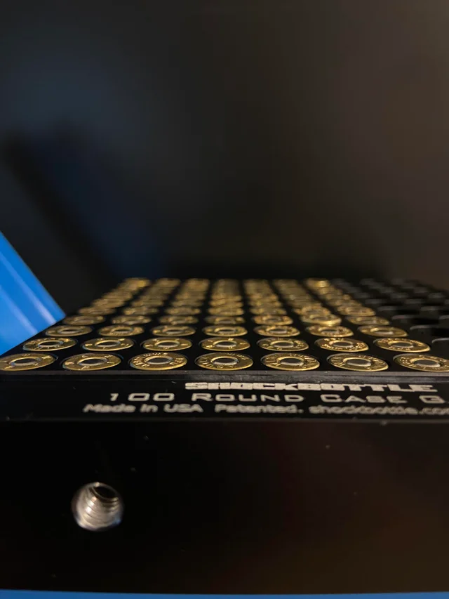

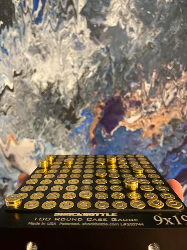

Before:
After running those that failed through Lee Factory Crimp:
Before:
Yep, the good ol' FCD is pragmatic... just know it's only treating the problem, it's not the cure. The FCD gets the rounds to pass the gauge by basically squashing them, which messes with seating depth and isn't the greatest for the bullet. Having to use an FCD works, but it also means there's something going on earlier in the production line that can be dialed in better, then there's no real need for an FCD.
That said, for a lot of shooters/reloaders (many of them good ones too), if it's usually only a few rounds that don't pass the gauge, then just using an FCD may be a better option than dicking around with the press and dies in order to not need to use one. I mean it's 9mm for ~25yrds, not precision rifle stuff.
I've used one quite a bit and know plenty of guys who still use 'em, the thing is: if like ~10 of your rounds out of 100 are failing the gauge before seeing an FCD, it's no bueno, something isn't right.
For a casual shooter/reloader: fuck yeah, buy an FCD.
