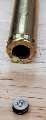

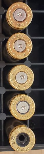

I prepared two loads today and had two primer blowouts. I am trying to keep it simple, so please bear with me.
I am using a Zermatt TL3 action with a 26” Shilen ratchet barrel. The barrel has a twist of 1:9.
I am using brand new Starline brass in .223 Rem. with CCI 400 small rifle primers. The bullets are Sierra 69 grain TMK’s (boat tail).
The distance from the head to the ogive is 1.92”, touching the leads.
While my first handload using the 1.92” seating depth was better than the factory ammo, it had a lot of room for improvement.
The Geco factory load measures 1.851” (Ogive to head).
So decided to start there, I loaded the minimum charge of 18.3 grains of IMR 4198 and seated the bullet at 1.857”. The last of the four rounds pushed out the primer (I lost it).
Next, I tried one round of the same load using 18.9 grains of IMR 4198 (that is halfway between minimum and maximum charge. The first round blew out the primer, the shell and primer came out of the action separately.
I know I didn’t over charge as I used either the minimum charge or stayed between the minimum and maximum allowed.
My only explanation would be that the bullet was seated too deep causing too much pressure in the shell before the bullet could exit. Should the bullet ever extend down past the neck of the cartridge?
I only sized the shells full length, no crimp.
I will pull the bullets from the remaining loads until I figure out what I need to do differently. All input is appreciated. Thanks

Rather than change powder. You might first want to try a different primer. CCI-400's have pretty thin cups making them more susceptible to being pierced or blown depending on various conditions. You might want to try something like Remington's 6 1/2's or better yet the 7 1/2's, which have thicker cups.
The base of that case in picture "Primer Out" appears to have pressure sign, where too much pressure can certainly blow out a primer.

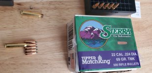

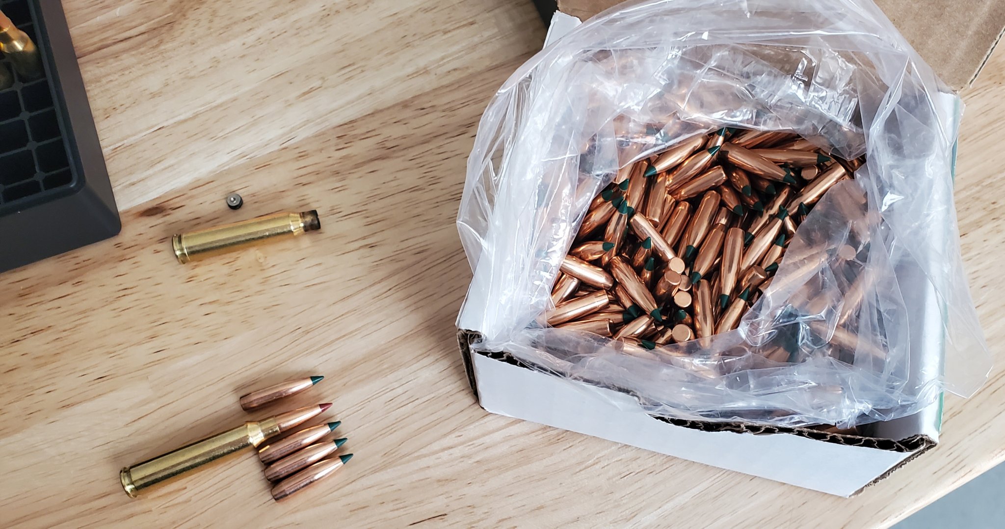

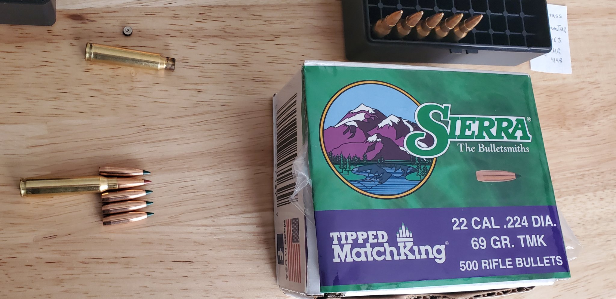

Here are pictures with some more bullets out and the box open and closed.
My question is about the bullet seating depth. The picture shows that the bottom of the bullet extends past the neck and well into the shoulder of the shell. That means that the pressure does not only build up on the base of the bullet but also around the bottom of that bullet inside the shoulder of the shell. Should a bullet ever go below the neck of the cartridge?
I will also measure the exterior dims of the spent shells to see what kind of expansion took place (if any). If the cartridge is still within factory specs, I would think that the primer might be the issue. As Straightshooter1 says above, the CCI 400 primer walls are thin. The brass is brand new, it might take less pressure for these primers to slip out of their pockets. Just a thought.
That red tip bullet did not come out of that box. If it did then someone messed with that box and i would talk to wherever you bought it.
Yes the boattail can go below the neck. Will not cause pressure by itself.
Thank you for your reply on the seating depth, it was a concern I had.

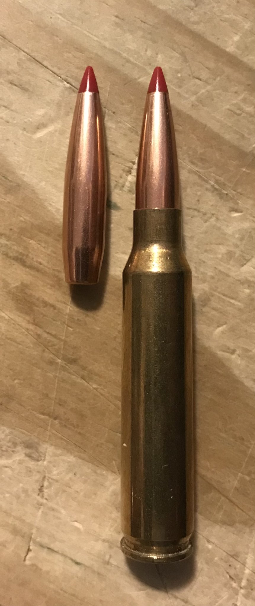

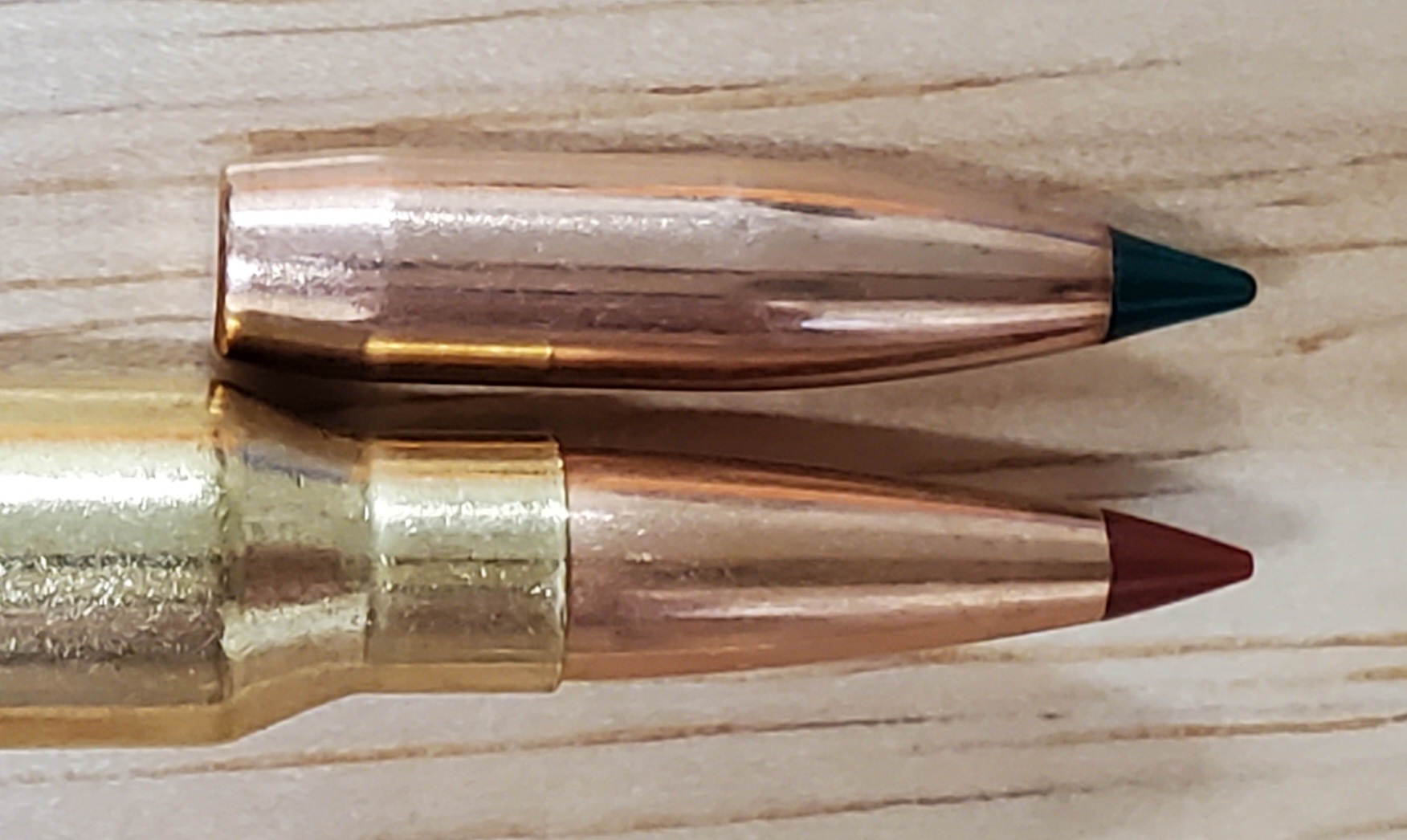

OP here is a pic of my .223 75 ELD-M load with the bullet next to case. As you can see the boattail is in a similar place as your picture although your pic does not show the same bullets. It does not cause pressure. Your powder choice is most likely cause of your issues. I would get a different powder.
I have CFE223 and BL-(C) 2, I believe these powders should be more suitable for 69 gr bullets?
Good comparison, thank you. I just wanted to make sure the that the seating depth was not causing a problem.

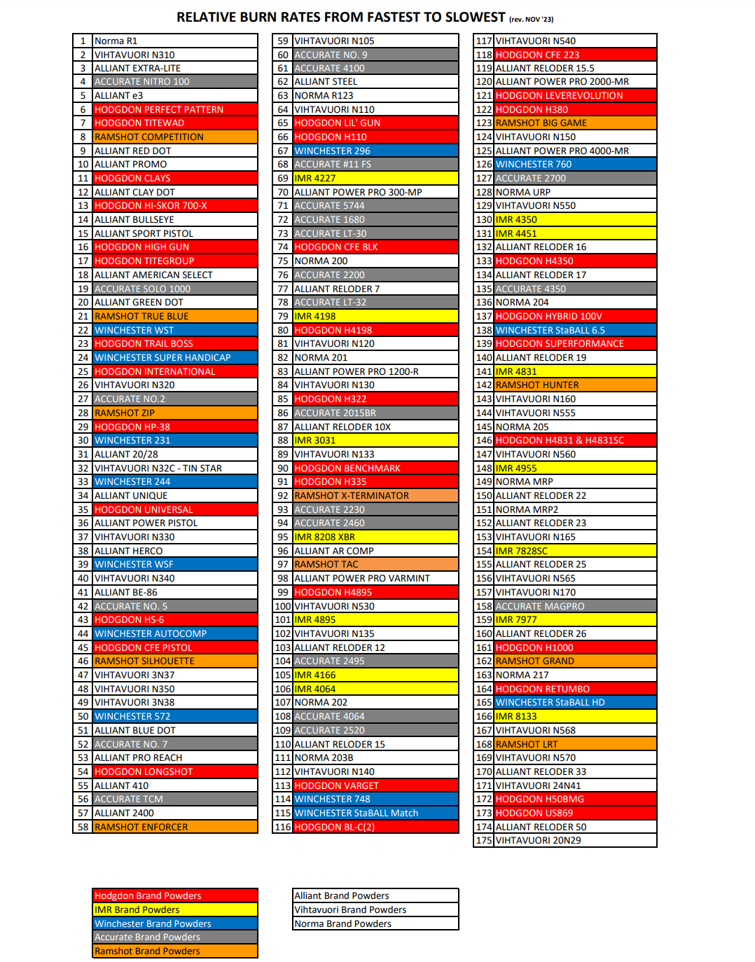

I am still trying to find a good way to choose the right powder. I am looking at the Hodgdon on-line manual and I see a burn rate chart that seems to put IMR 4198 right into the middle. What criteria can I use to determine my powder? Hodgdon says I can load 18.3 to 19.5 gr with 4198 but yet my primers blow out at the starting load of 18.3 grain. Varget, XBR8208 and N135/140 was suggested earlier but how do I arrive at those same choices without understanding the criteria?
Look at the burn rate chart and see where 4198 is and then look at the other powders. See how fast 4198 is and why they only recommend 18-19grns. You want powders starting about XBR8208 up to CFE223. That's the burn area that works well with the 69-80grn bullets.
Awesome, I get it now. I copied loaddata.com as well. I appreciate all the help and will move on from here. Thank You.
Pistol and shotgun powders burn far faster than rifle powders. They're in burn charts too. (I haven't seen the Hodgdon chart)
It’s in the middle of all powders, but on the fast side of rifle powders. On the above chart 1-70 are handgun/shotgun powders and everything else is for rifles. 4198 in 223 is like Bullseye in 357 Mag. It’s a fast burning rifle powder.

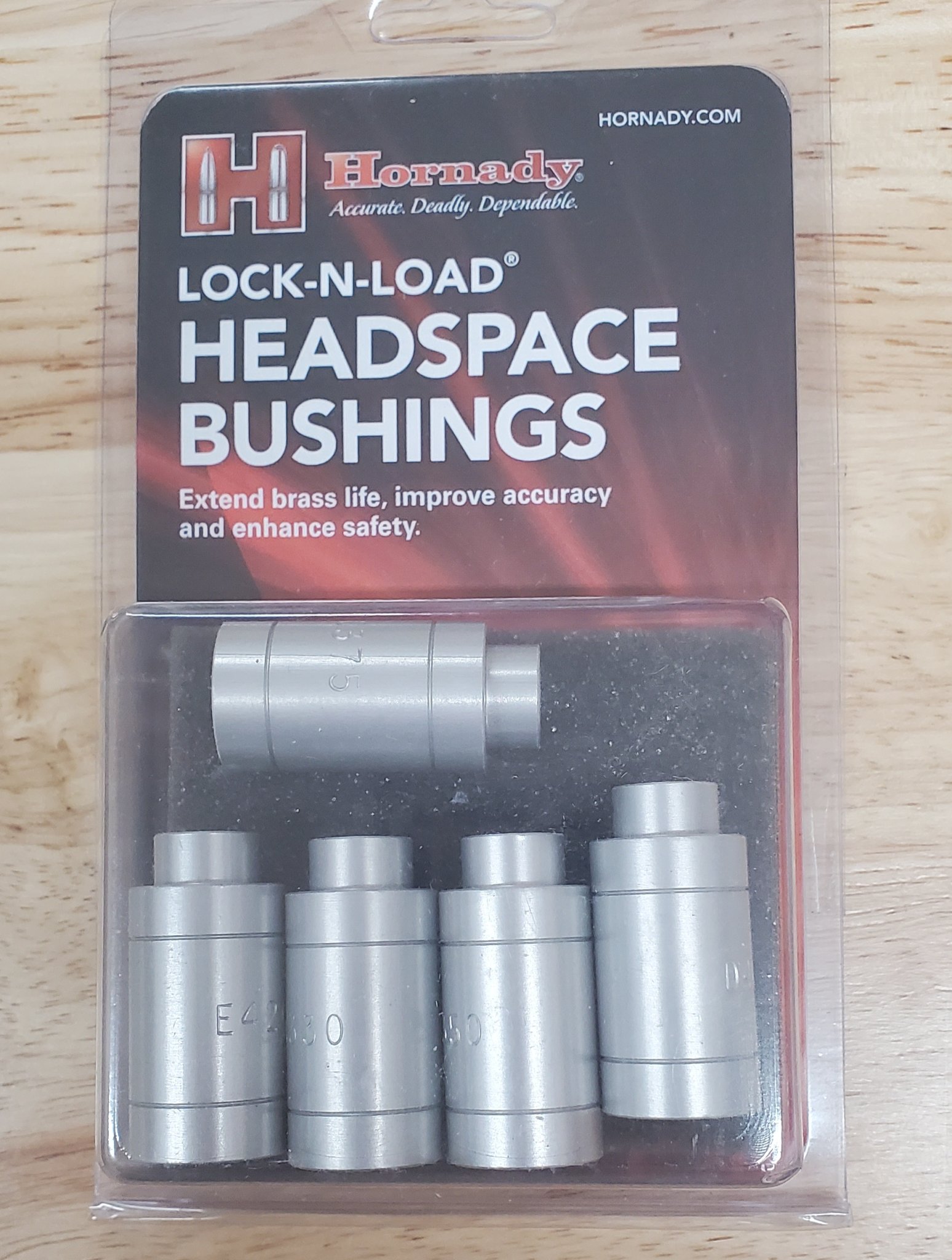

The Hornady headspace gauge is what I have used for years to measure shoulder bump.
Thanks, I am using that. New brass fits perfectly, the blown primer shell sticks out about 3/8", unlike my used factory loads that fit almost entirely in the gauge (before resizing).
Yeah I am not sure you are using that tool as nothing "sticks out" or "fits in" when using it. It's not a case gauge but measures the shoulder movement at the datum line of the case. Below is what it looks like in use. It allows you to see ow much the shoulder is moving forward and when setting up your dies for only a .001" shoulder bump so you are not over working your brass.

I thought you were referring to a case gauge. I do have this headspace bushing set. I have not used it yet as I expected to only need it until after I reload to verify correct shoulder bump.

I have one but mostly use the Whidden case gauge to measure before/after shoulder bump. I do note that with a tool like the Whidden its important to keep it perfectly (and consistently) vertical when tightening as a bit of an angle changes the measurement some.
