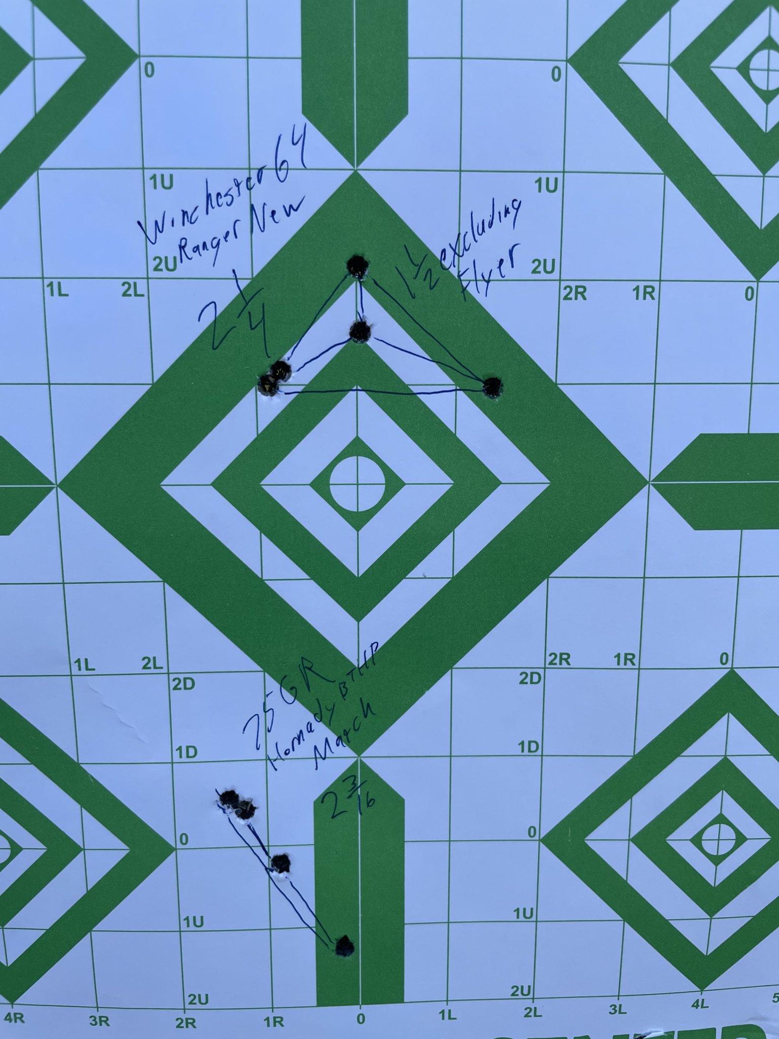

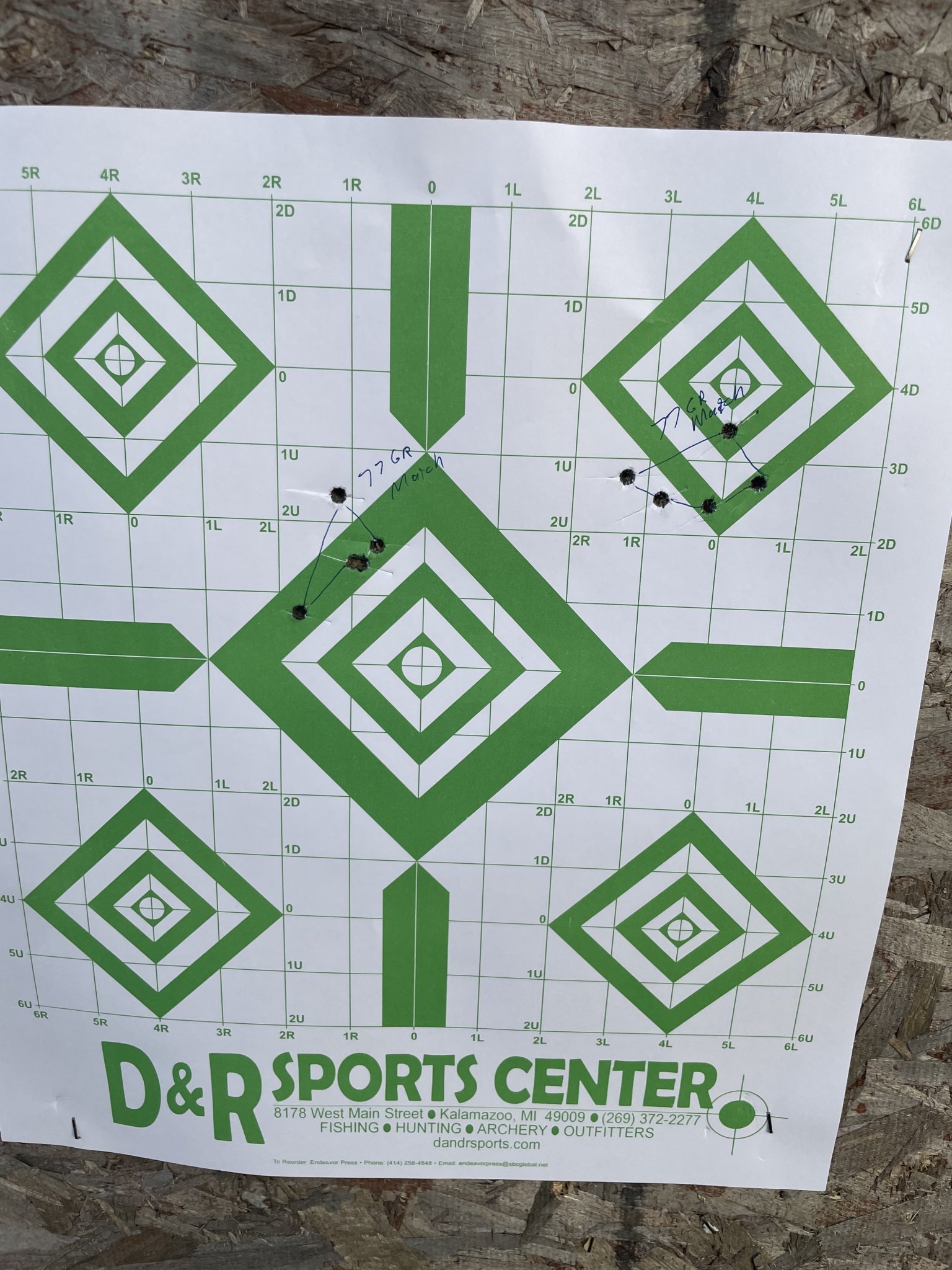

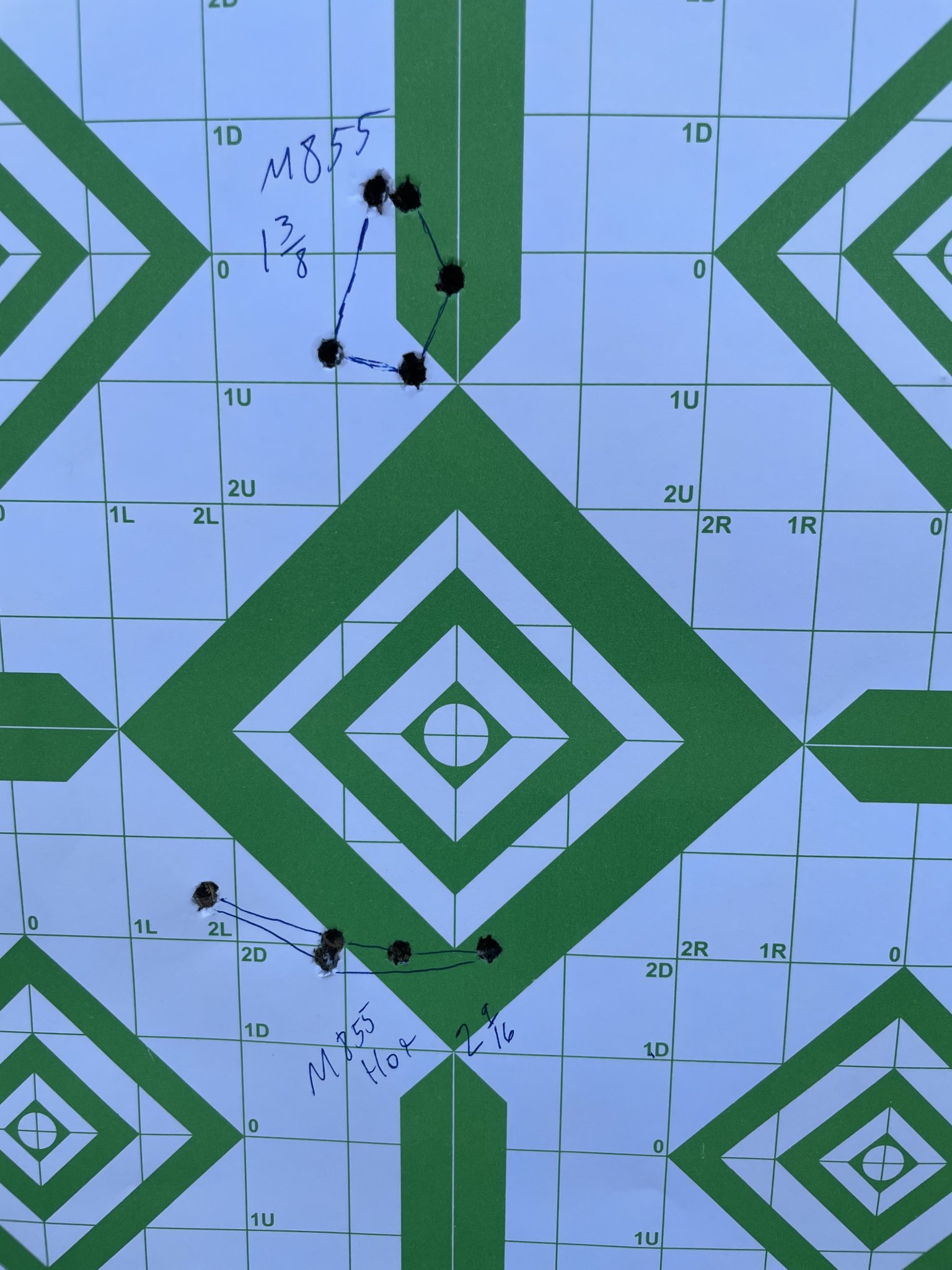

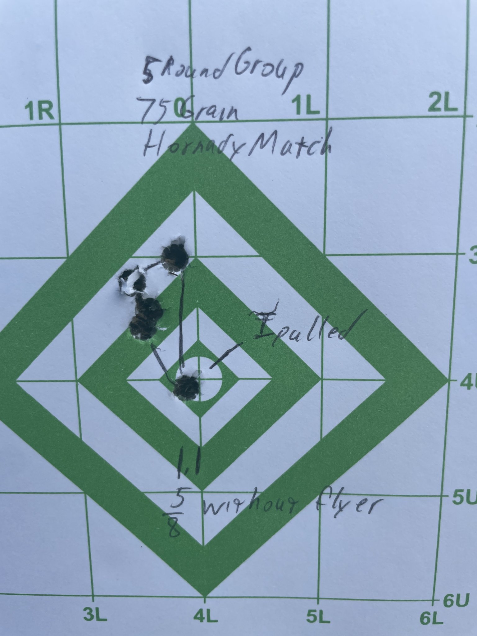

I switched my barrel to a 16 inch Rosco stray dog 1/7 socom profile barrel.
I had been running an hbar 1/9 twist bushmaster barrel that came with the rifle originally
My groups went from roughly 1 in to 2 inch plus groups.
I even bought some match grade 77 grain Hornady ammo to compare to the other ammo I was shooting, and even that was only shooting one and three-quarter inch groups.
Is this the best I should be able to expect from a Rosco barrel. I have never had a rifle that I could not shoot 1 MOA with.
The barrel has some visible defects, just passed the chamber.

I think you are expecting too much from a Rosco. Actual experience varies, but they make a rock solid infantry grade 2 MOA barrel. Colt uses a lot of Rosco's with Chrome Lining, and they are fantastic at what they do, but it is not a match barrel. Yes, moving to a heavier bullet can help. And maybe you have some hot lapping you can do. Just because you moved from 1:9 to 1:7 does not mean your 77 Grain is now going to shoot great out of an average barrel.
this
end thread
Reach out to Rosco. I suspect they'll take care of you if you're unhappy.
what? take of him for what; a rack grade barrel that shoots better than the standard? they will laugh at him
If he had a lothar, CLE, craddock barrel sure but this is a rosco production rack grade and getting 2ish moa. that's a good barrel for what it is
OP, those older Bushmaster barrels are fking lasers
Exchange it for something else. Either one that doesn't have the defects he observed past the chamber or possibly that K9 16 which should give 1 MOA-Ish accuracy based upon the specs.

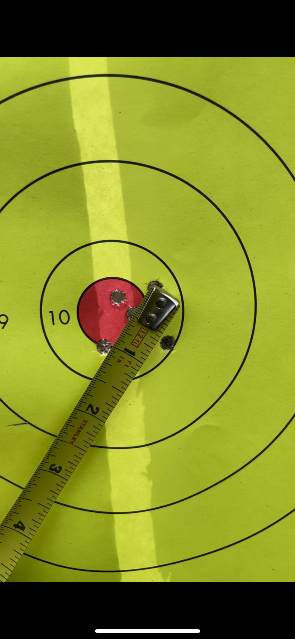

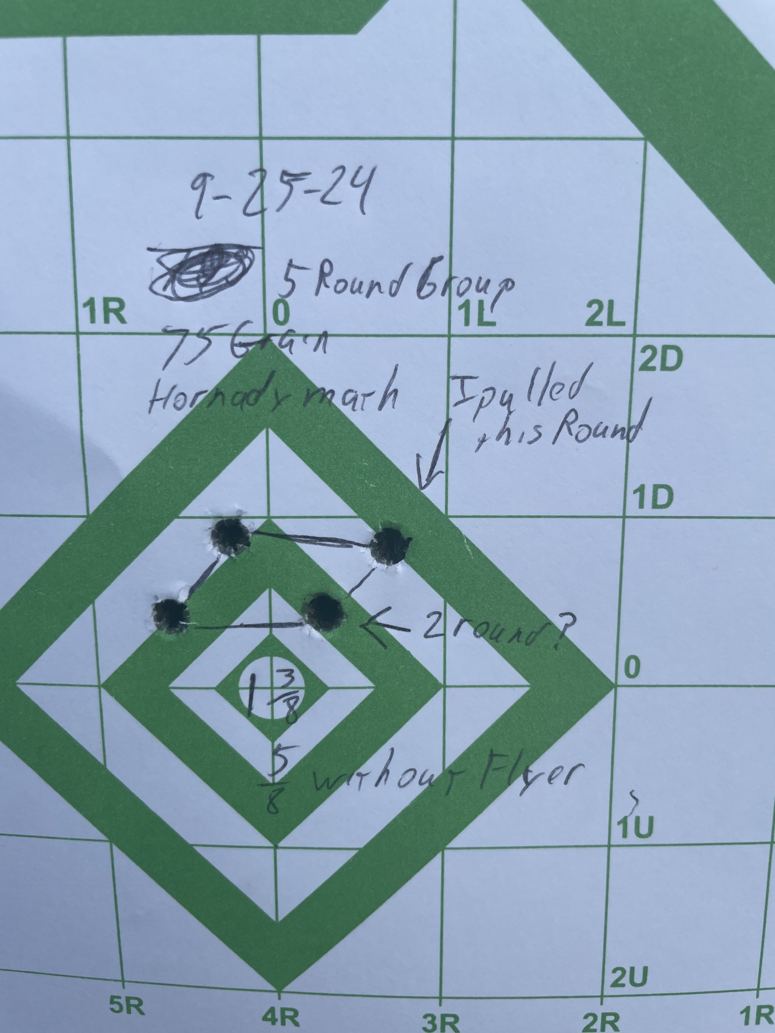

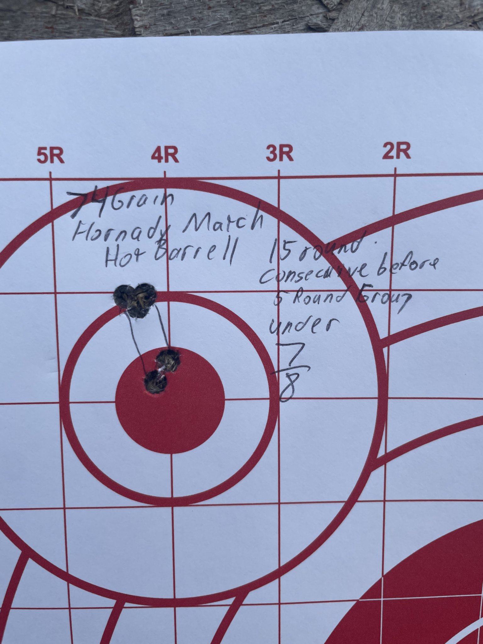

So I threw on the Nightforce Atacr 4-16. Got out the rear bag cleaned the barrel good and tried a fresh day. Trying to take out as must human error as possible. Here are the results.

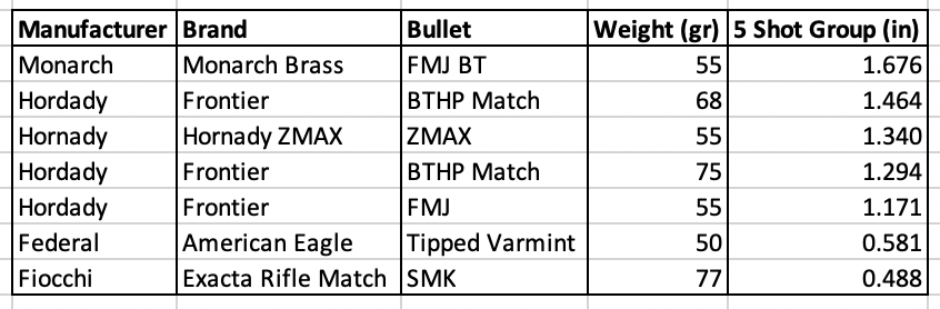

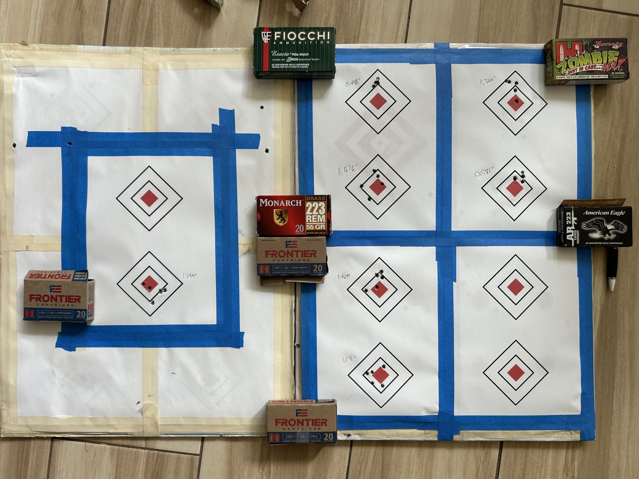

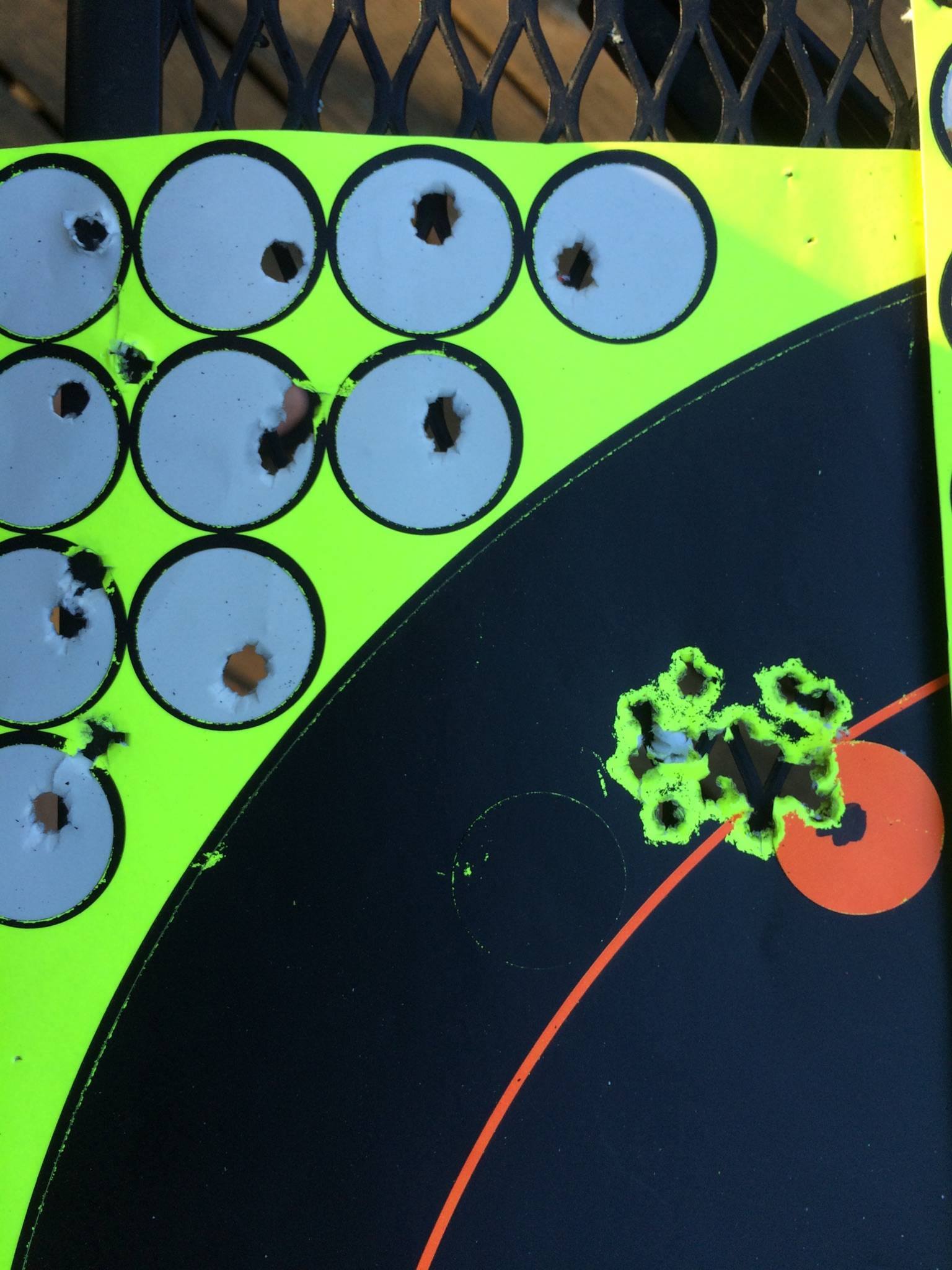

I have one Roscoe barrel, bought on the recommendation of @TonyTheTiger. I had robbed the scope from that rifle for another project, but this thread inspired me to mount a scope and head to the range. Full disclosure, the rifle was built for run and gun competitions, and is an 18" rifle gas length barrel, on an Aero M4E1 Enhanced upper/lower set. It is from Roscoe's Pureblood line, and came as a package with their bolt and carrier. The rifle has a magpul PRS Lite stock in the rear, and a MDT GRND pod in the front. It has an SLR gas block, but I did not touch the settings for this outing. On top, the rifle wears a Vortex Viper PST Gen ii 5-25x scope. Gisele SD-E trigger.
I shot a few rounds to get the optic zeroed (you can see the impacts spread across the upper part of target 1, and then settled in to groups. I shot the groups at a reasonable pace(3-5 sec between shots), and only paused between groups long enough to load the next magazine. The ammunition chosen is just what I happen to have on hand. Groups are all 5 shots.
For the cost of the barrel, and for the shooting that I do with it, none of these groups are going to hold me back. The said, if I were taking it to the deer blind, where I typically look for head/upper neck shots, I would be sourcing more of that Fiocchi ammo. As a matter of fact, I'll be doing that just 'cuz...
The moral of the story is that sometimes you need to find the ammunition that the gun likes...

Thank you for the write up. I have only been able to test four or five types of ammo so far and none of them did as well as your worst group almost.
Also, we have to use ranger 64 Grain Winchester ammo for work. And it seem to hate that the most.

( No Offense intended at all... ) But, no fair with the Fed TV 50gr load... that stuff flat out shoots well in every barrel I have seen it fired from.
Darned near a perfect 100yd factory load... cheap, ( $5.29 / 20rds back in the day ) , crazy consistent.. just above 1 MOA, all day long.
Why Fed discontinued it ( and never listed it in a catolog / webpage ) is beyond me.
Pic is from my 20" SS FN CHF PSA upper. 100yds , scoped, benched... 20rd group, left hand upper corner is kinda like Molon's "Quarter MOA" target ( 10 quarters, 2 rows of 5 across a 8 1/2" x 11" sheet of paper.
The white dots and orange dot is 1".

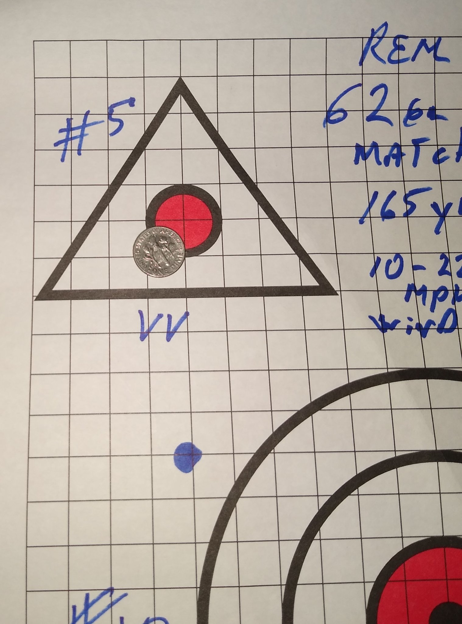

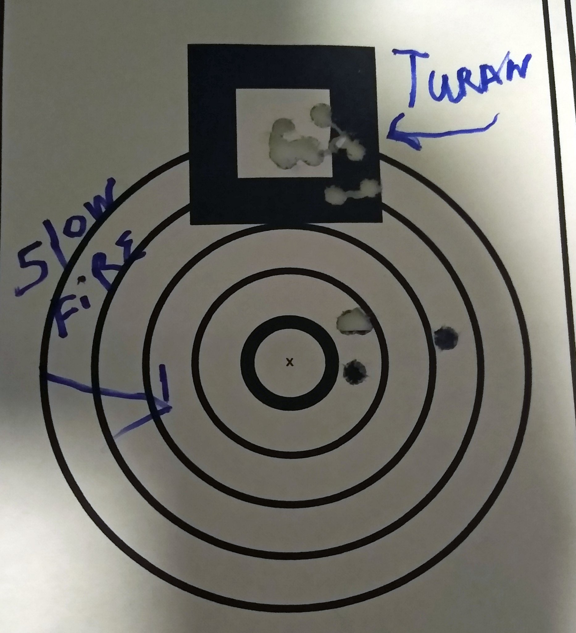

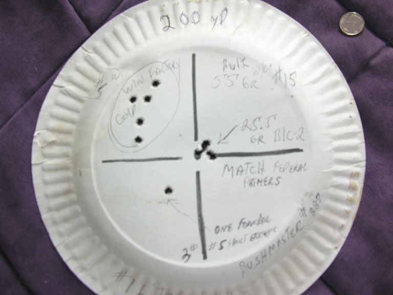

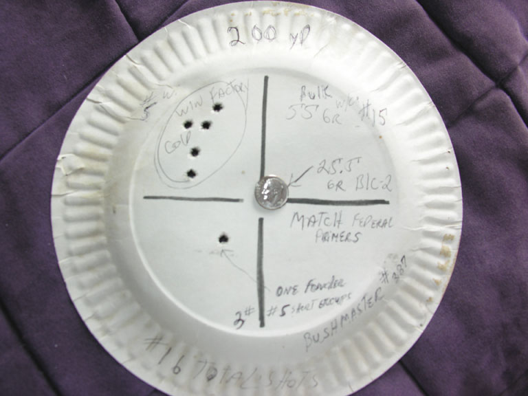

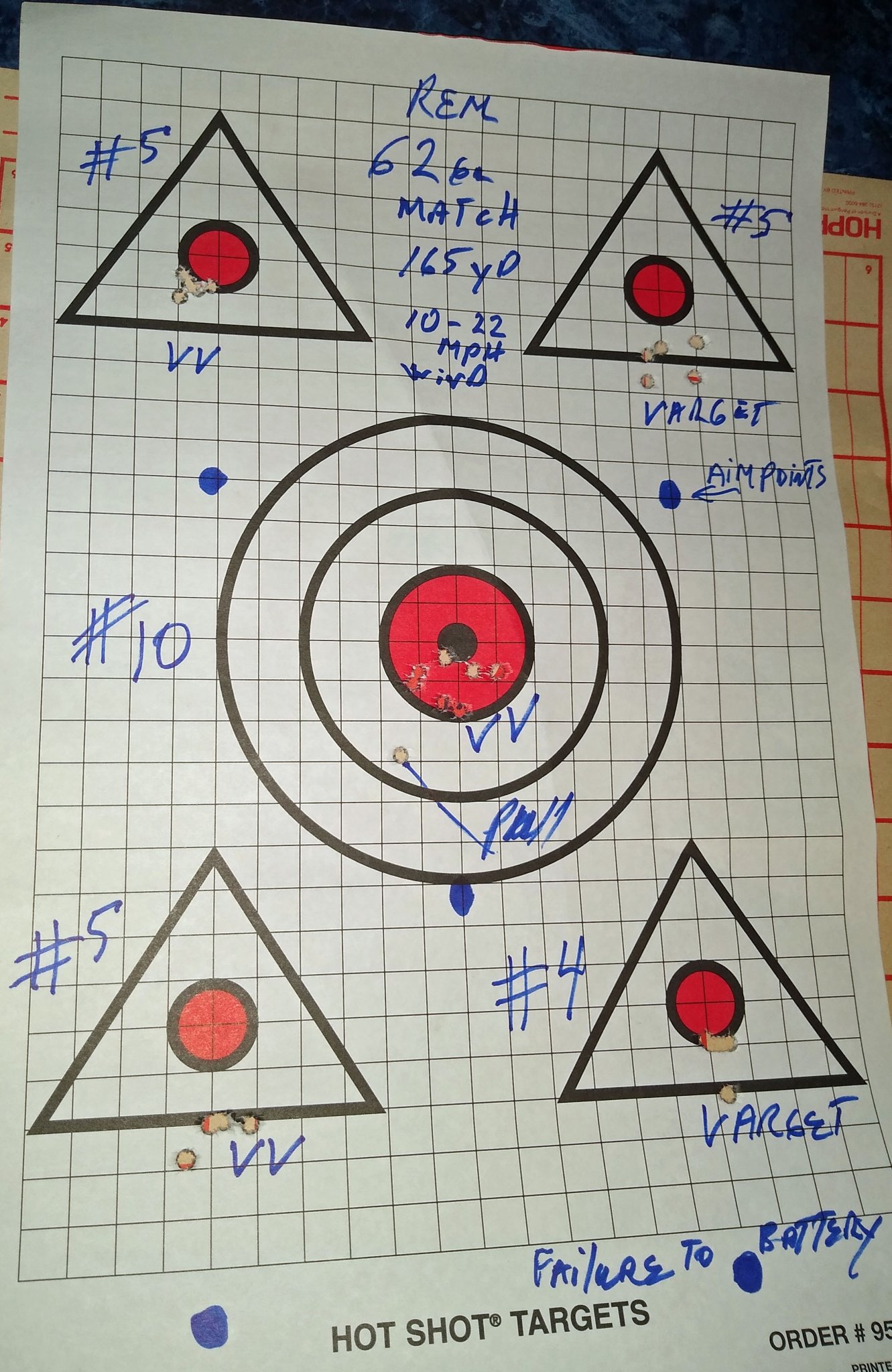

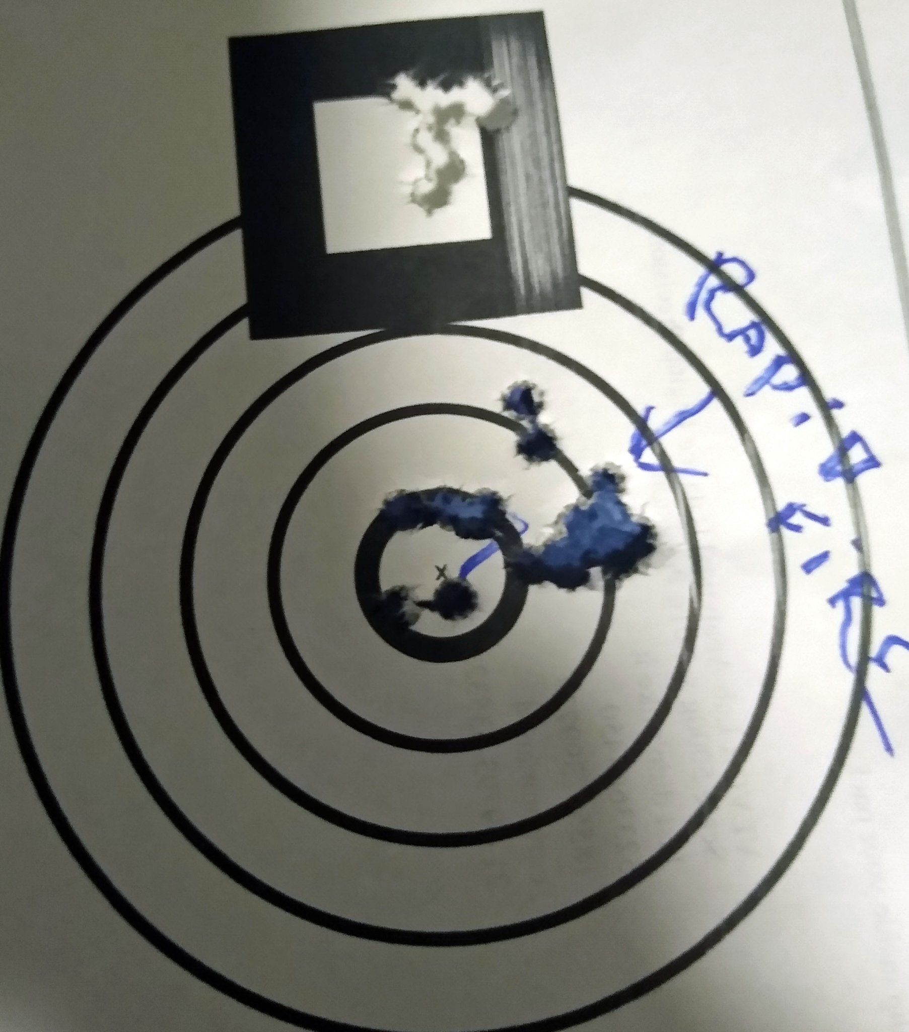

The purpose of the barrel swap was for accuracy ?.
Old BushMaster barrels as accurate as they come , Aero Precision aka Ballistics barrel ditto . Lilja and Schneider Rifle Barrels are outstanding but PRICEY ,however Precision is their trademark .
A Bone stock early 90's BushMaster XM15-E2s 20" 1:7 putting #15 shots under a dime size group at 200 Yd. . Original Nikon Monarch 4-12-44 using BLC-2 25.5 Gr. with Bulk Winchester 55 gr. W/ cannelure no less . Note Winchester white box stock crap vertical string ,same POA . Sometimes it's the AMMO . Shot that Mid 90's at LEO exhibition off the dirt No matt .
Aero Platform Powder evaluation with 62 gr. on 5.56X45mm VV over Varget . Turan Turkish ammo evaluation ( accurate for mass loading ) however WON'T cycle any AR I own . Nice cases and reloadable but WRONG powder for any gas gun I know of . Yet is marked M193 spec and I suspect powder is too fast . Rapid fire using MY BLC-2 load out of an Aero Precision platform .

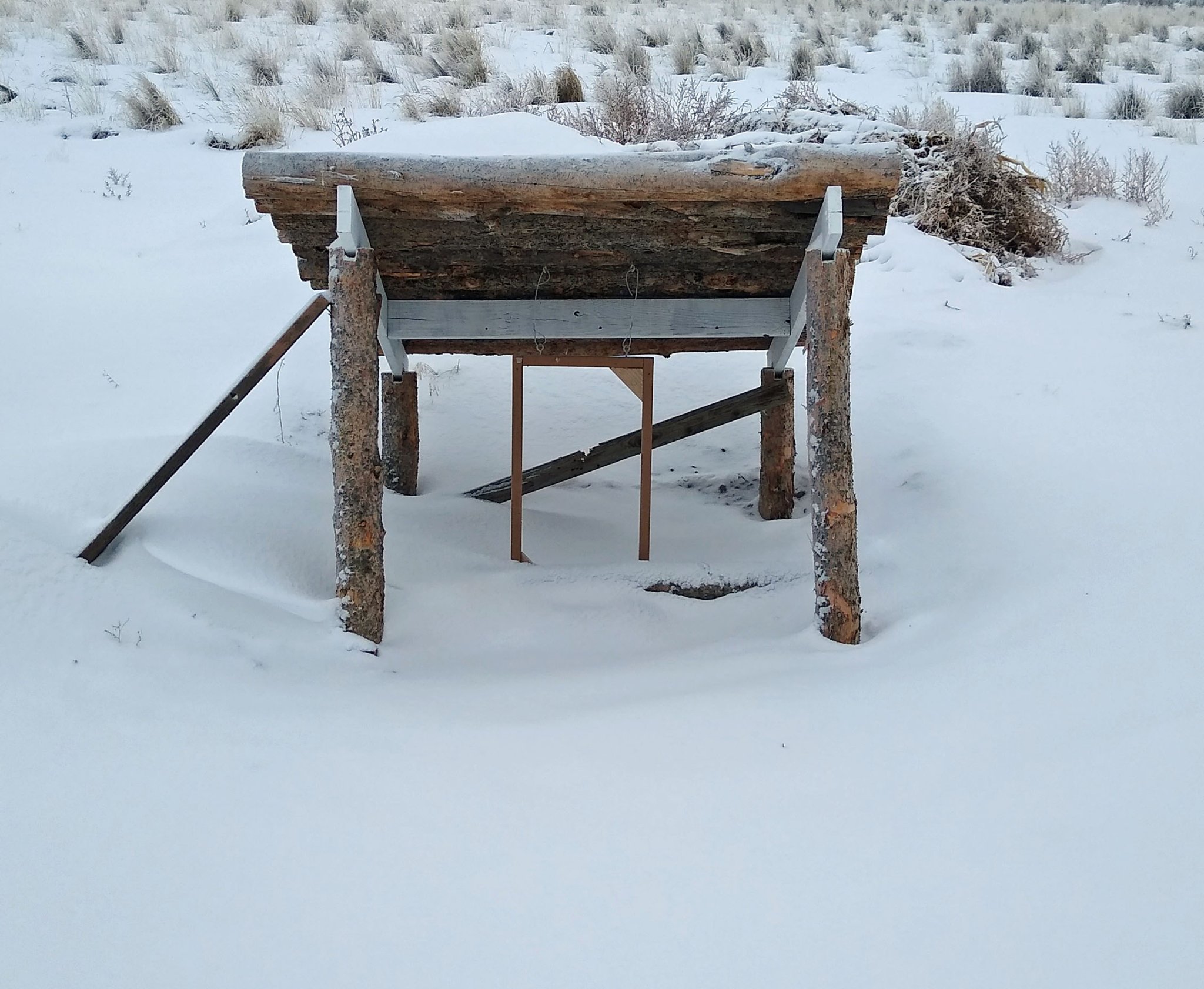

In case any of you were wondering , I own My own Rifle and Pistol range and don't have a 100 Yd. target shed . As our terrain is undulated with gorges a # of gully's and one canyon . So I shoot from West to East across a sloping terrain . High point South diminishing downward too the North . These are Target sheds ,which I constructed at the first #4 yardages . I don't own a rifle rest and have never even used one ,I have sand bags as well as a shooting bag .
I have 165 yd. 278 yd. 340 yd. 635 yd. and steel plates at 1044 yd. and 1175 yd. Pistol range is flatter and opposite direction 0-75 yd. . The Wife and I also belong to a decent club range with all the amenities about 30 minutes from our place .

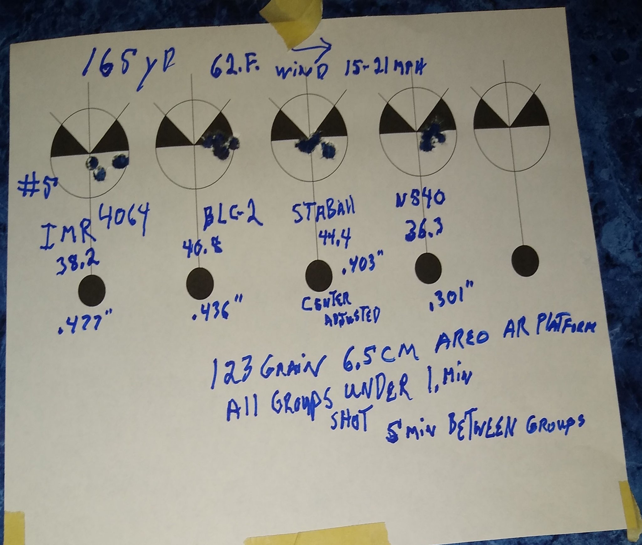

Below powder evaluation ; All groups shot under a minute , with 5 minutes between groups . Accurate enough for ME . Sometimes one gets Quality components and sometimes apparently some don't ;)
