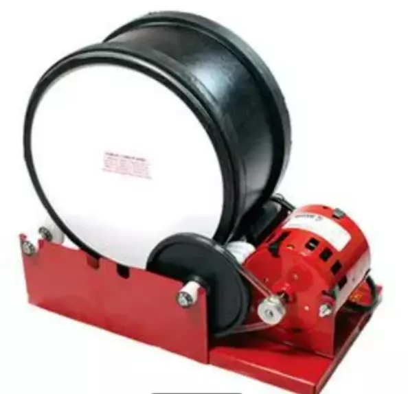

Thumlers Tumbler, if I ever go the route of stainless pins and wet tumbling this will be it.
Already figured out it will be a purchase for the wife for polishing rocks wich will be a past time that would last about one or two batches then I have a tumbler that will last me a lifetime for polishing brass.
Think smarter not harder 😁

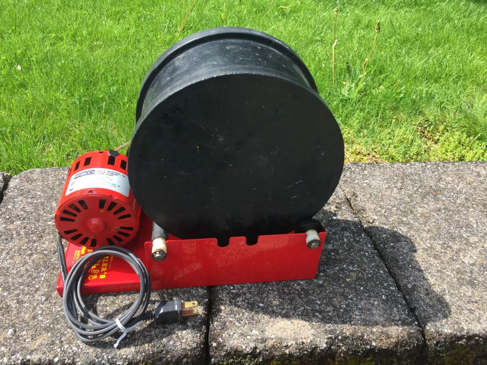

I used an Extreme tumbler for years. Then I decided to upgrade the drive and roller system. I found a fellow who was working on the project, but he decided to go another route. So I jumped at this.
I can fit two of the drums from my Extreme unit on the rollers. So if I have a lot to clean, I can run both drums. This gives me a capacity of 30#’s of brass at once. The motor is a 1/3HP unit.

I have the Extreme 17 and it is sturdy and works well. It is the higher speed version designed for tumbling brass - Not sure how the low speed version would work for brass. Maybe e-mail the manufacturer for that info.
I have no experience with the FA or RCBS.
