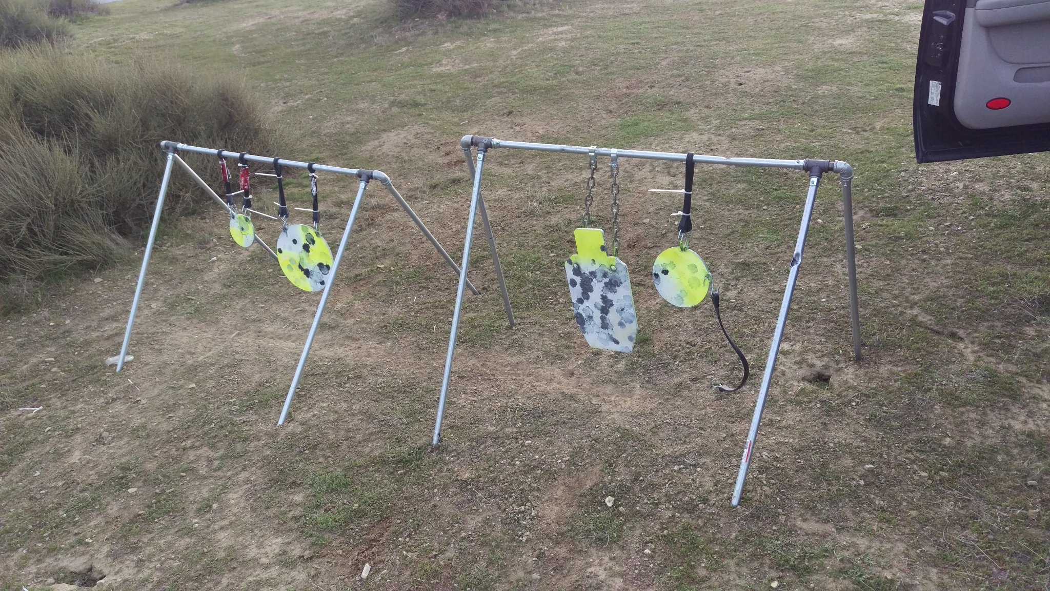

My DYI hangers.
3/4" emt conduit
3/4" screw connectors for emt
3/4" emt hanger
A couple rigid pipe T and emt 90
Carriage bolts & chain for hanging.
Can buy in bulk at Home Depot for cheap to make multiple hangers for different distances and spare parts.

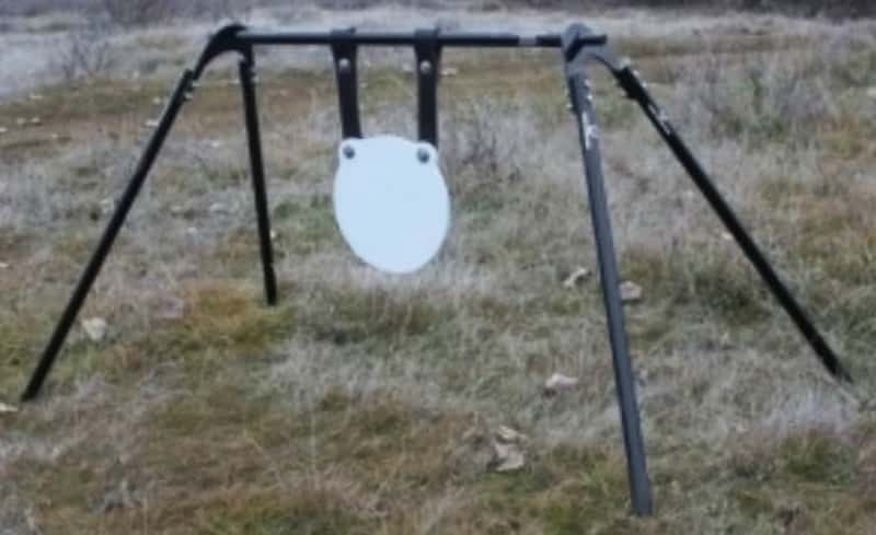

I have two sets of JC Steel stand brackets, 1/2” and 3/4”. I use the 1/2” with 1/2” rebar and the 3/4” with 5/8” rebar. Both work well but the 5/8” rebar is better for heavier steel. I have been using mine for years including for matches and any steel 6” or larger, I hang with two straps.

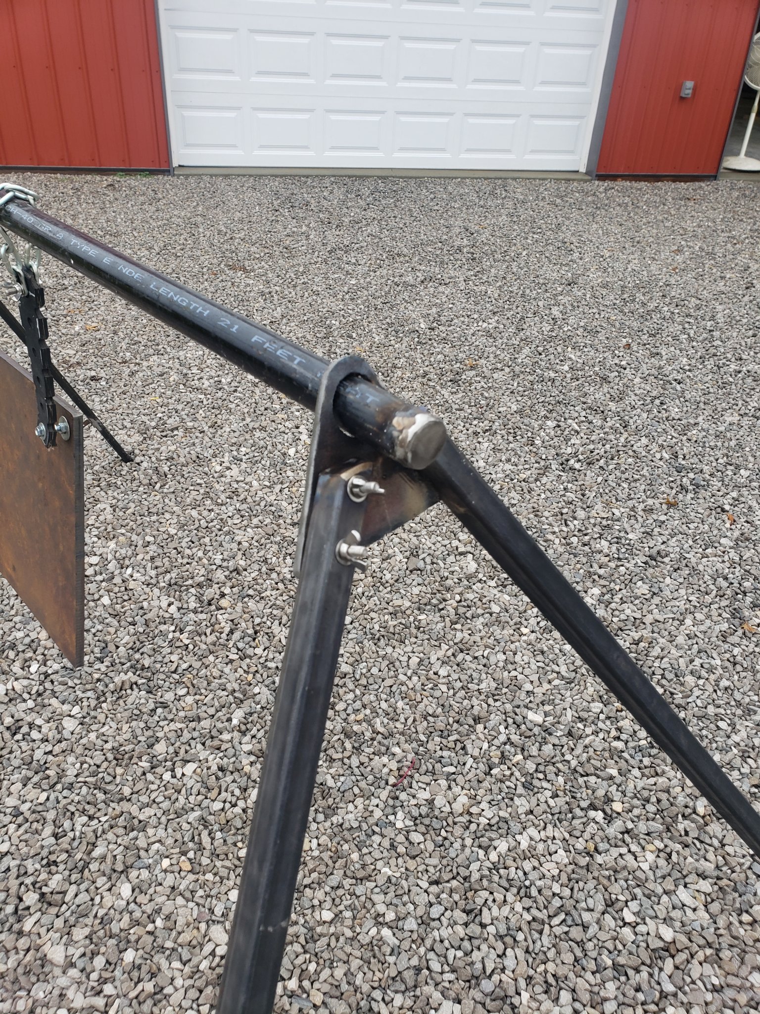

Here are the hangers that I'm in the process building. They work good but I ended up bending "S" hooks from 5/16 round stock to hang it by because it's hard to hold the target and bolt the chain on. Its 1" 11ga square tubing, 1" sch 40 black pipe, and 3/16 plate and stainless hardware. I also capped all the ends to keep mud and wasps out it.

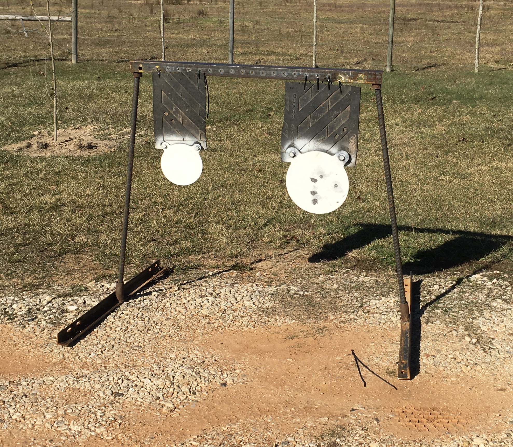

When I ran precision rifle matches for my gun club (6 Years worth) we would buy aluminum bracket from JCsteel targets that would allow us to use whatever length of half inch rebar we wanted. We would use 4 legs and one cross piece to hang targets and it worked great. Unless someone clipped the rebar at just the right place, the parts would last a very long time. We rarely had bullets hit the rebar to where they would wreck them...the rebar would get scuffed up, but I only remember a few being destroyed...considering we used them for monthly matches for over 6 years, I would say it was a very durable system.
The system is cheap, durable, and versatile....what's not to like about that?
Wow!!!!! The mud flaps are brilliant!

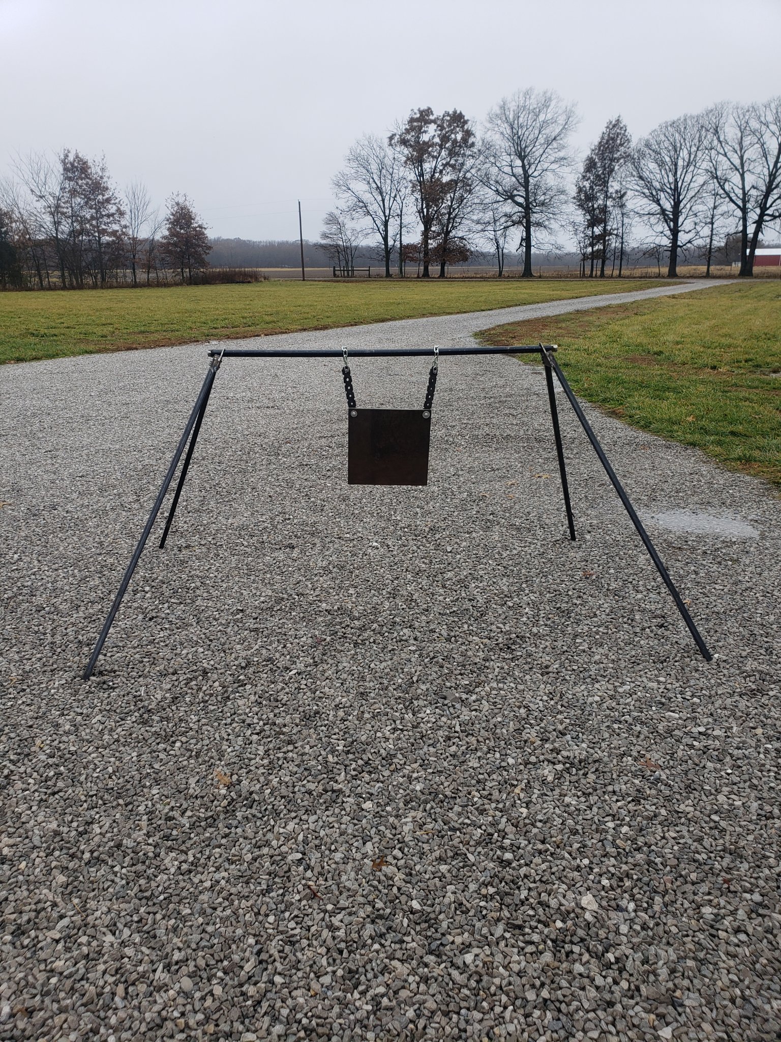

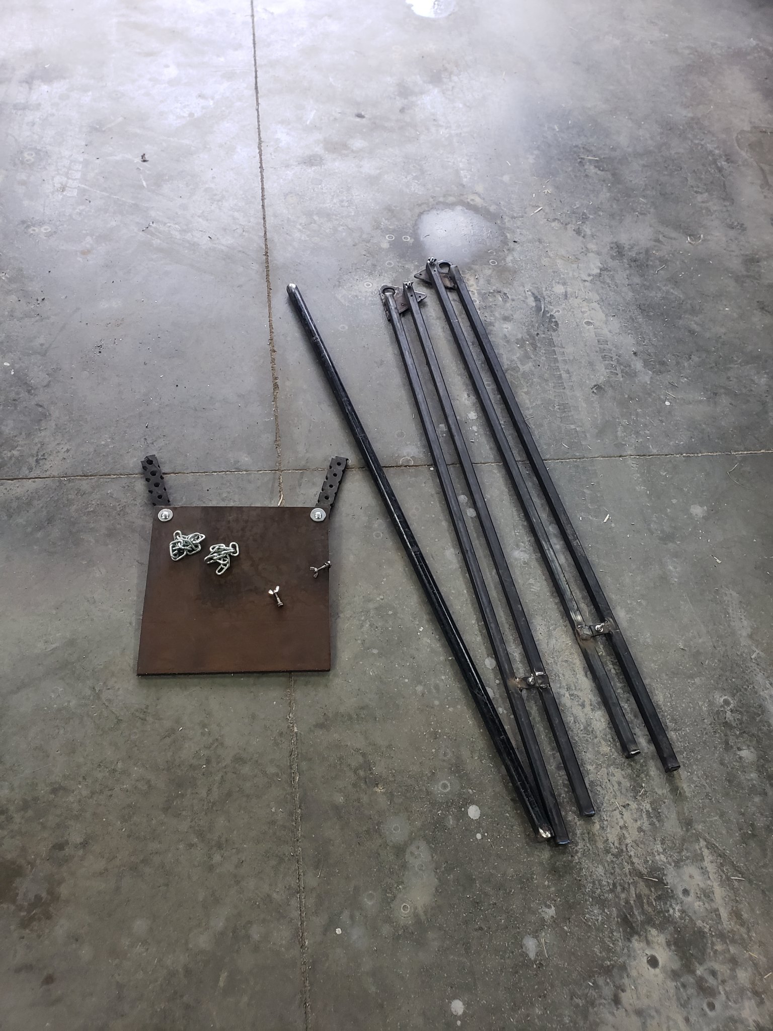

This last summer I was helping the father in-law work on his baler and we ended up replacing a some of the belting. The belts are 7” wide and 20+ feet long and reinforced like conveyor belt. I used this to hang most of my targets. To hang them I used steel u posts pounded into the ground but they are permanent at my range.
