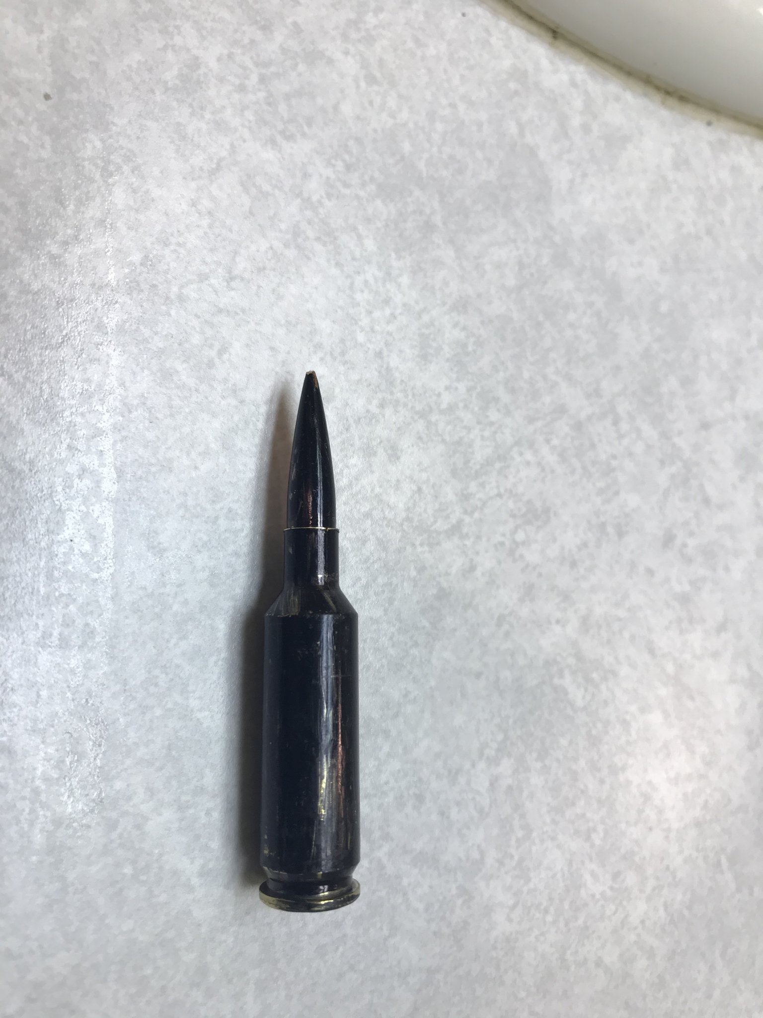

    Can we get the darn picture already of your entire case painted with sharpie. We want to see where it binds.

    No. I just tried again and can push a billet into them. Guess I didn’t really try hard enough last time. I’ll attach a picture of the painted round below. As menstioned above it seems like it’s rubbing along the base but that still doesn’t explain why a empty round chambers and a loaded one doesn’t.

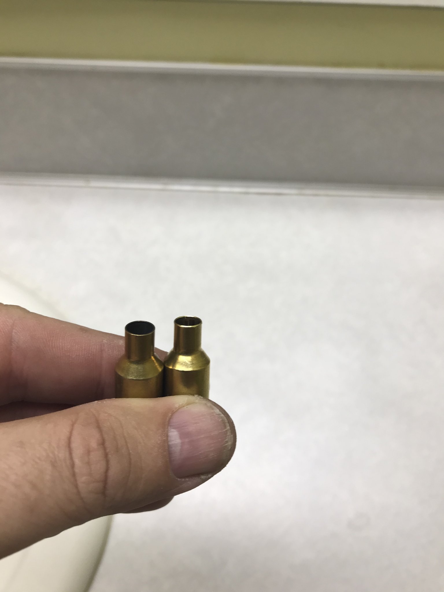

    The sharpie pic....there is clearly something going on to the mouth if that case was nice when it started. I agree that it looks like it's probably too long.

    Try trimming a case that won't go and see if it goes. Even if you gotta trash a case and take it below spec. I'd go down in increments and see if/when it's short enough to go.
    Reactions: Darkside-Six
    Ok. So I just trimmed them down quite a bit and had no issues. So it seems like that is what is causing it.
    The trim length for 6GT is supposed to be 1.720 according to George but even virgin Hornady cases are inky 1.716-1.717. So that is what I’ve been trimming too. I just trimmed down to 1.70 and they closed like butter so that seems to be the culprit. Now I need to adjust my trimmer a little better so they’re not so far and go from there.
