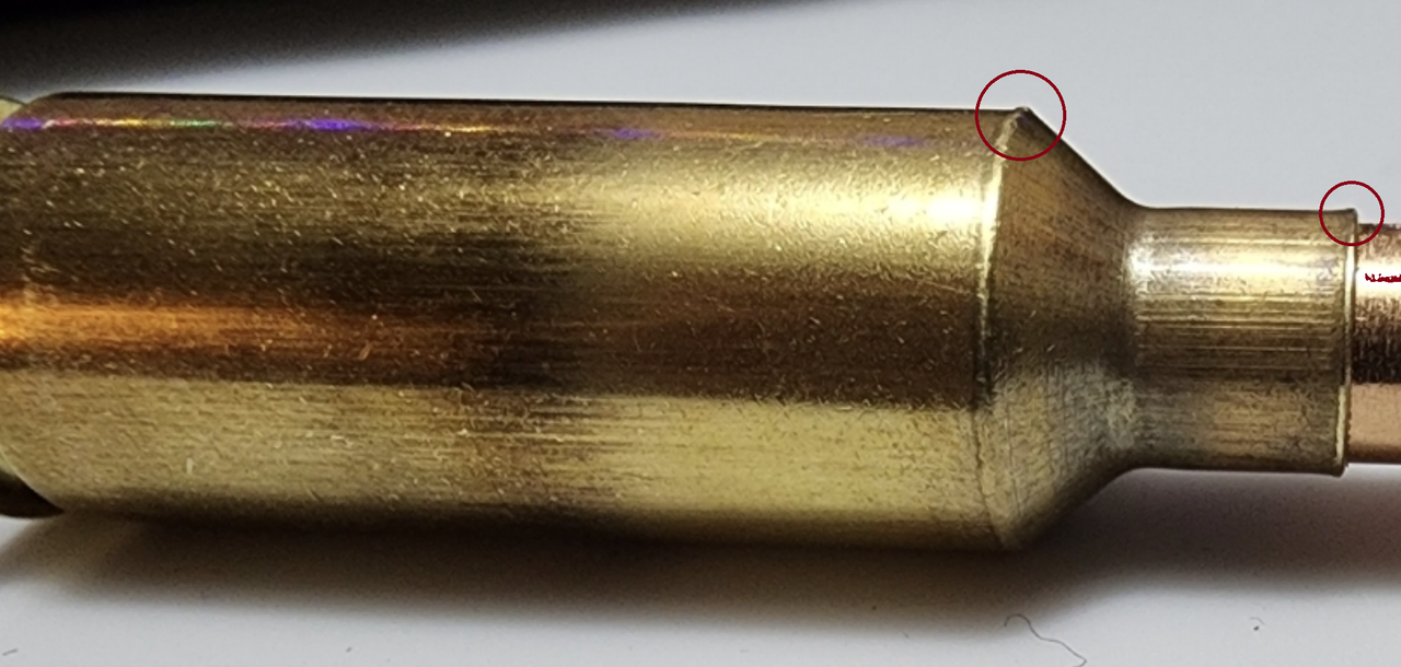

The case lips may cause an odd feeling while chambering, but what's happening at the shoulder might cause a failure to chamber.

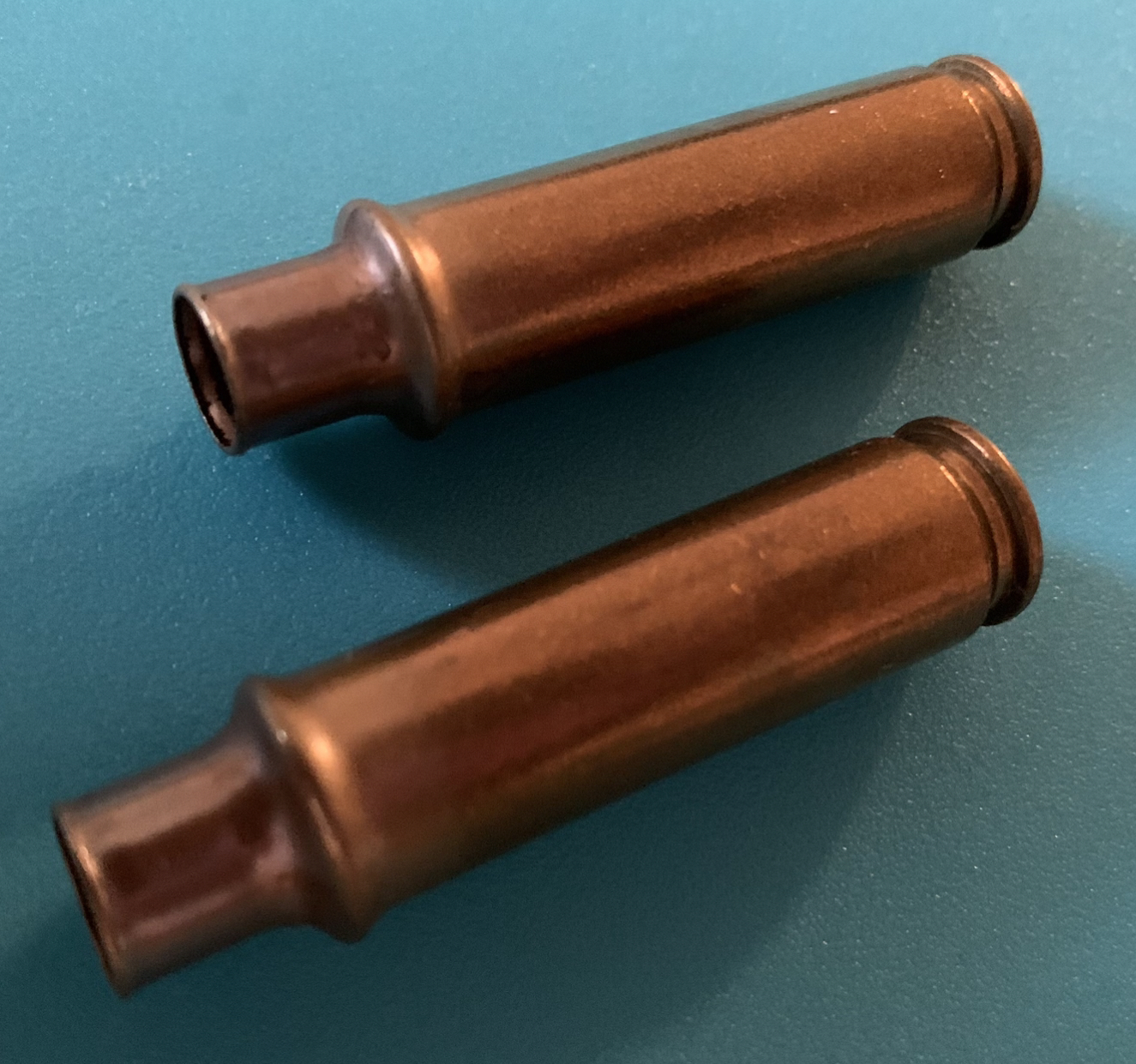

Any chance the brass was excessively annealed (subjected to waaay too much heat)?
The second picture is the reason I ask.
That's what happened after excessive annealing, when the necks were to be dilated with a mandrel - similar forces to seating a bullet. Mandrel didn't even get past the case lips, and crushed the shoulders.

Edsel has magnified two problem areas. I'd bet it's the very weird lip on the shoulder (What in your resizing and seating is doing this???). The lip on the neck, while it shouldn't be there, should be OK unless you have a very tight necked chambering (you need to deburr/chamfer your case mouths). I'd suggest taking a few rounds and "painting" them black with magic marker and then chambering and removing them. This should clearly ID the problem area. I doubt it is the scuff marks on the bullet as while you might feel this deep "into the lands" seating, you should still be able to chamber a round.

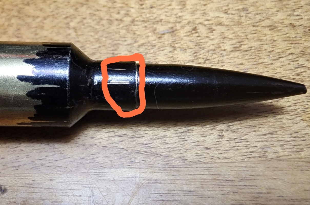

The scuffs on the bullet say carbon ring to me, as does the observation that brass with no projectile chambers just fine. I'd go ahead and put an outside chamfer on the case mouth as well in case there's a lip there that's big enough to snag in the chamber once a bullet is seated...but I think it's a carbon issue.

Wait, you say the bullet got stuck? That narrows it down, I'd say. This is either a carbon problem, you're seating the bullets out too far, or there's some other restriction where the bullet lives. Because the scuffing on your bullet in the photo above appears to be symmetrical and all the way around (correct?), I don't think it's a huge runout issue, which would've been my other guess.

This picture is key . Measure the diameter with a caliper of the areas circled on an empty case that chambers. Then measure the same areas on one that won't chamber. Somehow in the seating operation you are collapsing the shoulder like you would if you over-crimped with a seatng die.

The "scuff marks" on the bullet do not really look like they were made by engraving the lands, which would likely show discreet land marks, not a full circumference of scuff, unless you chambered this round more than once.

Once again, paint a few of the loaded rounds with a black magic marker. This includes the bullet. Then attempt to chamber, and then remove. Where the issue is should be clearly visible and the people attempting to help you will have the proper info. Photograph and post the results.
What did you do differently to get the result shown on the "Edit:" in your initial post?

Thanks for your latest post with images.
Did this round chamber properly? Has your chambering problem gone away?
- No sign of the previously observed "scuff band" on the bullet.
- The circled scratch close to the bullet tip is from when the round is chambered from the magazine or feed ramp? Should not be from deep in the chamber.
- The circled deep scratch on the case neck is concerning, unless this too is from some contact before the case neck is in the neck portion of your chamber. If it is from when the neck of the case slides into the neck portion of the chamber, there is an issue, as this should not happen. Is there a burr or some kind of obstruction here? (Your .243" borescope should allow you to see into your chamber?)
- Also visible is magic marker missing from the outside rim of the case neck, end even some missing from the shoulder, suggesting too close contact at both locations.
The images are for the one that couldn't be chambered. I put this round by hand, without a magazine or sled.
Scuff on th neck, I am not sure what can I cause this? Wasn't there prior to trying to chamber and again no magazine used.
When you say too close contact, should I be sizing it further down and then try again?
For the crimp, the die I am using is a Forster Ultra seating die. I am not sure if this die crimps? I am played with the seating die setup, unscrewing it more out.
I am not sure about the "recommended max length", but the case overall length is under the max overall length.
I’ve you have the body of the die screwed down too far, you can get rolled necks. If this turned out to be the issue, back the body of the die up and screw the seating micrometer further down to achieve your target seating depth.
Adjusting your seating die is probably the simplest thing in the equation. Put a round of sized brass (no bullet) in the shell holder and run it to the top of the press stroke. Leave it there. Back the seating stem out of the seating die a LOT to insure it will never reach the brass. Screw the seating die body down until it touches the empty brass. Now UNSCREW the die upward at least 1 round, 3 or 4 rounds won't hurt. Lock it down in that position. NOW you can adjust the seating stem through trial and error to reach your desired seating depth for the bullet. After this, you KNOW the seating die is not contacting the brass and cannot be the problem.
If you do not own a micrometer or at least a dial or digital caliper and know how to use them, get some. Measurements have been requested here several times and all I've seen is crickets rubbing their legs together. Something is happening to your brass that should not be happening, most likely during the seating process. It's very hard for any of us to help you without some meaningful feedback. I'm not being mean, just trying to get you to help us help you.
