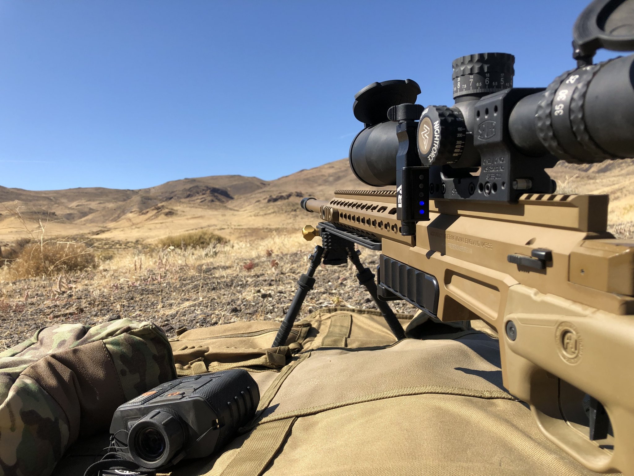

Ignore the photo that was on a 1000+ yard range I was shooting steel on in Silver Springs Nevada. I think the paralax was fine because I had been shooting for 30 mins at a 200 yard target. That being said I seem to use Parallax as a focus and as close to the distance as possible. At what point does parallax made a difference? 20 yards? 100 yards?
The issue with parallax being off is that you can shoot perfectly fine for one string (because your head isn't moving), get up and move, then come back and shoot off just like you were doing - off by a bit, but still grouping. To play with this, purposefully set your parallax off, then move your head and see how much the reticle moves with respect to the target. It doesn't take much to be off by quite a bit. I always get it set, then move my head side to side and up and down to see if the reticle moves.

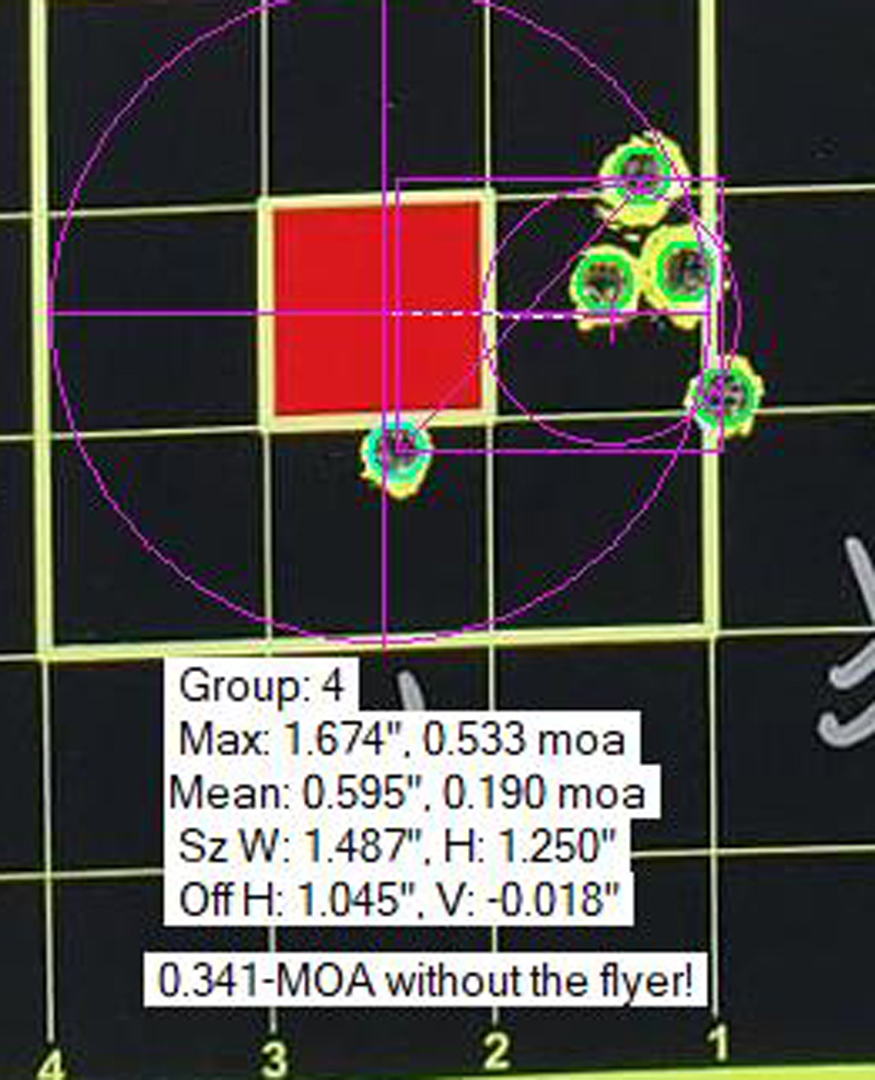

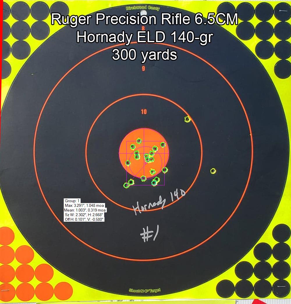

2900 rounds through my original RPR barrel and shot this at 300 yards a little over a week ago.
First target of the day. The two shots on the right were sighters.
Third target of the day. 5-shot groups.
Guess I'll keep the barrel for a bit longer. :)
