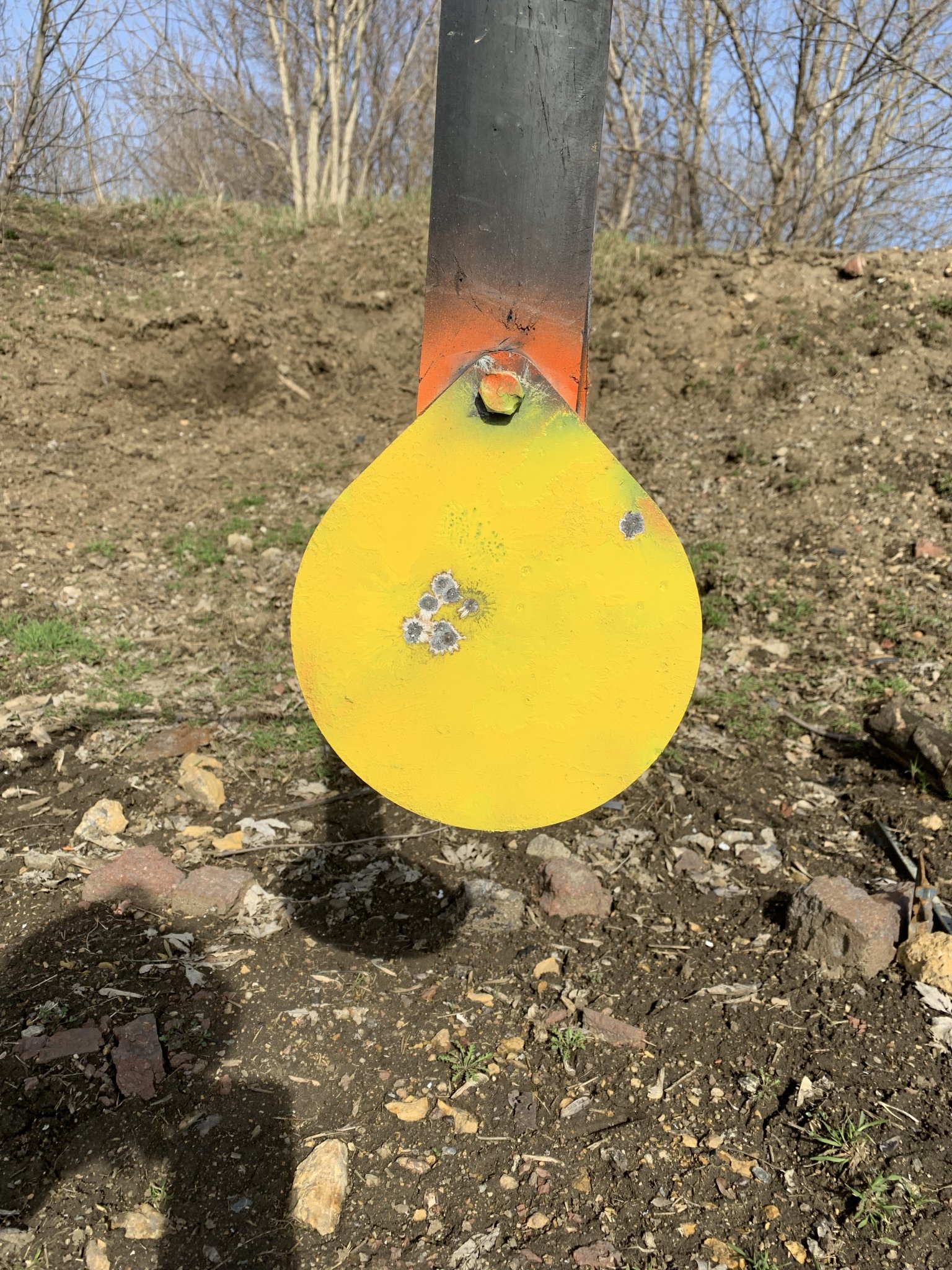

I have not quite 500rds through mine and have shot 1 match with it out to 200yds all using CCI standard Non-sorted. It shoots great with nothing but cleaning out of the box. Shot this at 100yds in a 10-15 mph fishtailing wind in between storms. First shot was high right to get a wind call, next 9 were near center. Prone with bipod and bag.
7079725
The match was a mini-prs match prone and positional. Smallest target was 1/4”. There were a handfull of other Ruger shooters and all of them did well too.

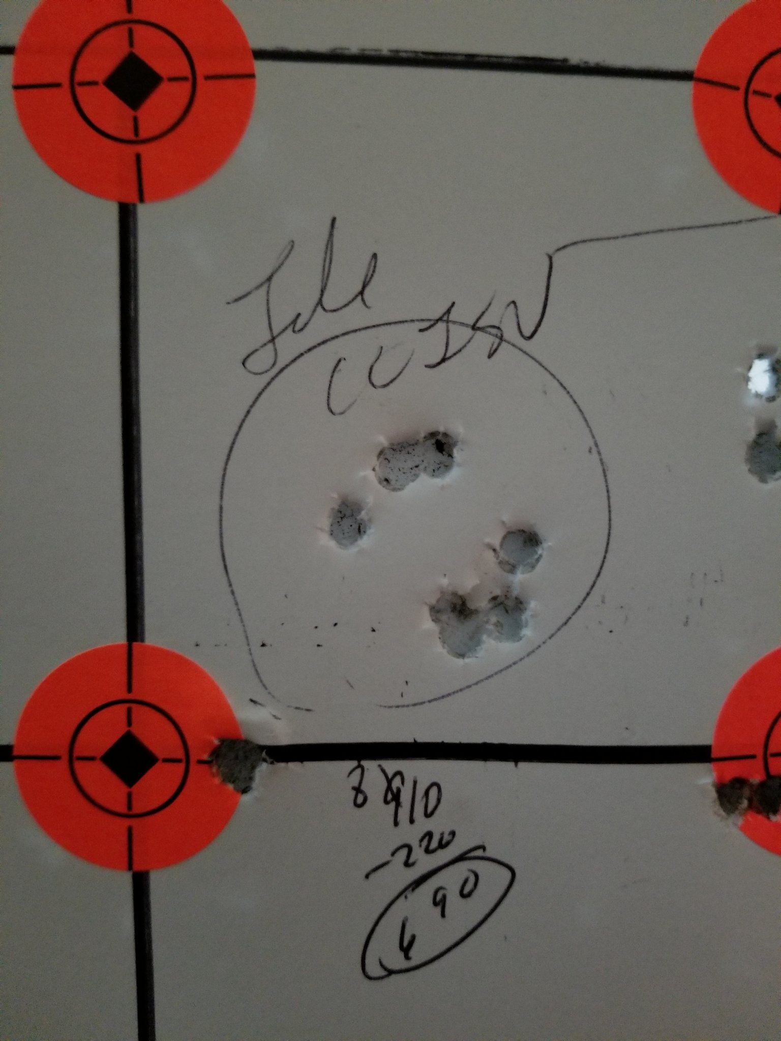

This is my sons RPRR at 100 yds. Have another group just a bit bigger. This is with CCISV. Seems to shoot the best for the cost effective ammo. Ore than happy despite the non ejection issue I sent it back for originally. 10 shots. The only mod was the aluminum bedding
