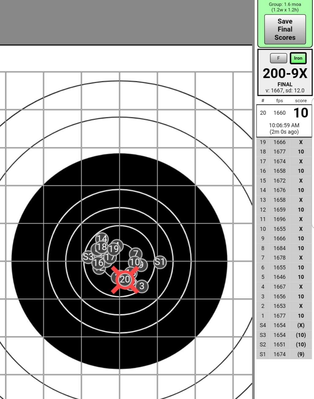

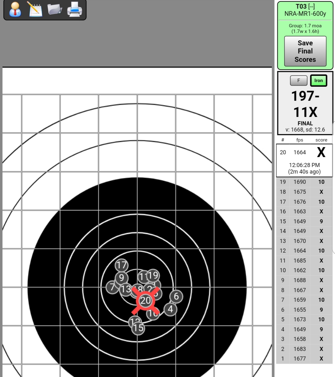

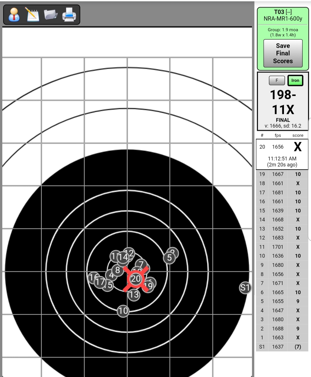

    I picked one up used for $775 last year as a high power/ across the course match rifle. The only modification I made to it was a White Oak match rifle handguard that accepts a handstop for shooting from the sling.
    It's a hammer with 69 and 80 SMK's, although I do get primer cratering like others have mentioned. I'm planning on getting the bolt bushed this fall after the shooting season is over.
    Last time I had it out, I shot a 595-31X at a 3x600 prone match. Dang good score for a $800 rifle.
    If the rain holds off this weekend, I'm going to try to keep some 90's in the black at 1000. The few I loaded up as a trial run at 600 yards show some promise.

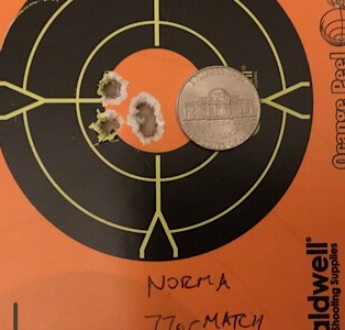

    Not yet I only have around 75rds through it. After the barrel breaks in I plan on stretching it out I am going to use it for a trainer and the local 600yd PRS/NRL club matches. The group shot above was rds 11-15.
    Well I am happy with mine it appears it will do exactly what I want which is a midrange trainer. Only mod so far is an Arca rail.
    This was rounds 16-20 during break in off bipod and rear bag.
    7097402
    Yes I shagged one it was not the rifle. If it ever stops raining here I will shoot it out to 600yds this weekend.

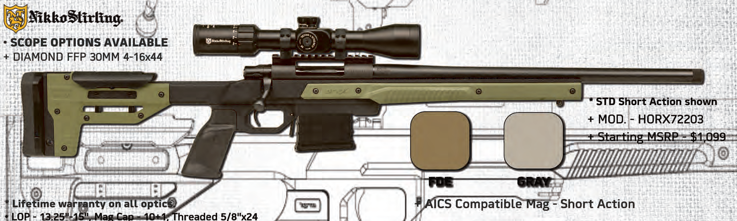

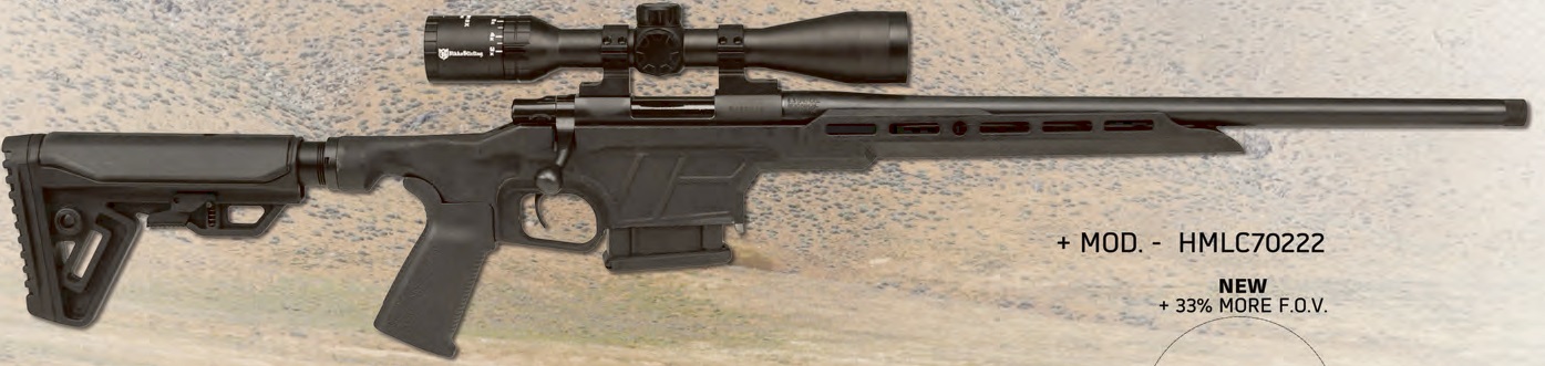

    Since you're asking about alternatives.....you could go with a Ruger American Predator or a Howa 1500 barreled action and an Oryx chassis for less $ than the RPR.

    The Howa 1500 mini-action is also a 1:8 (and is available from Howa in an Oryx chassis -MSRP $1,050).

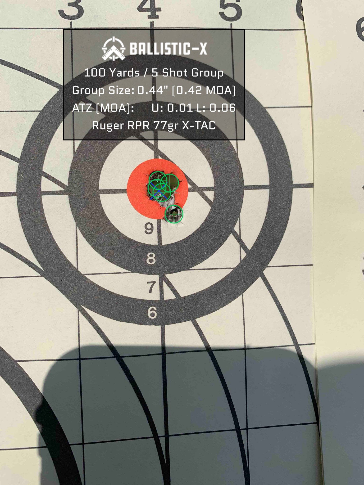

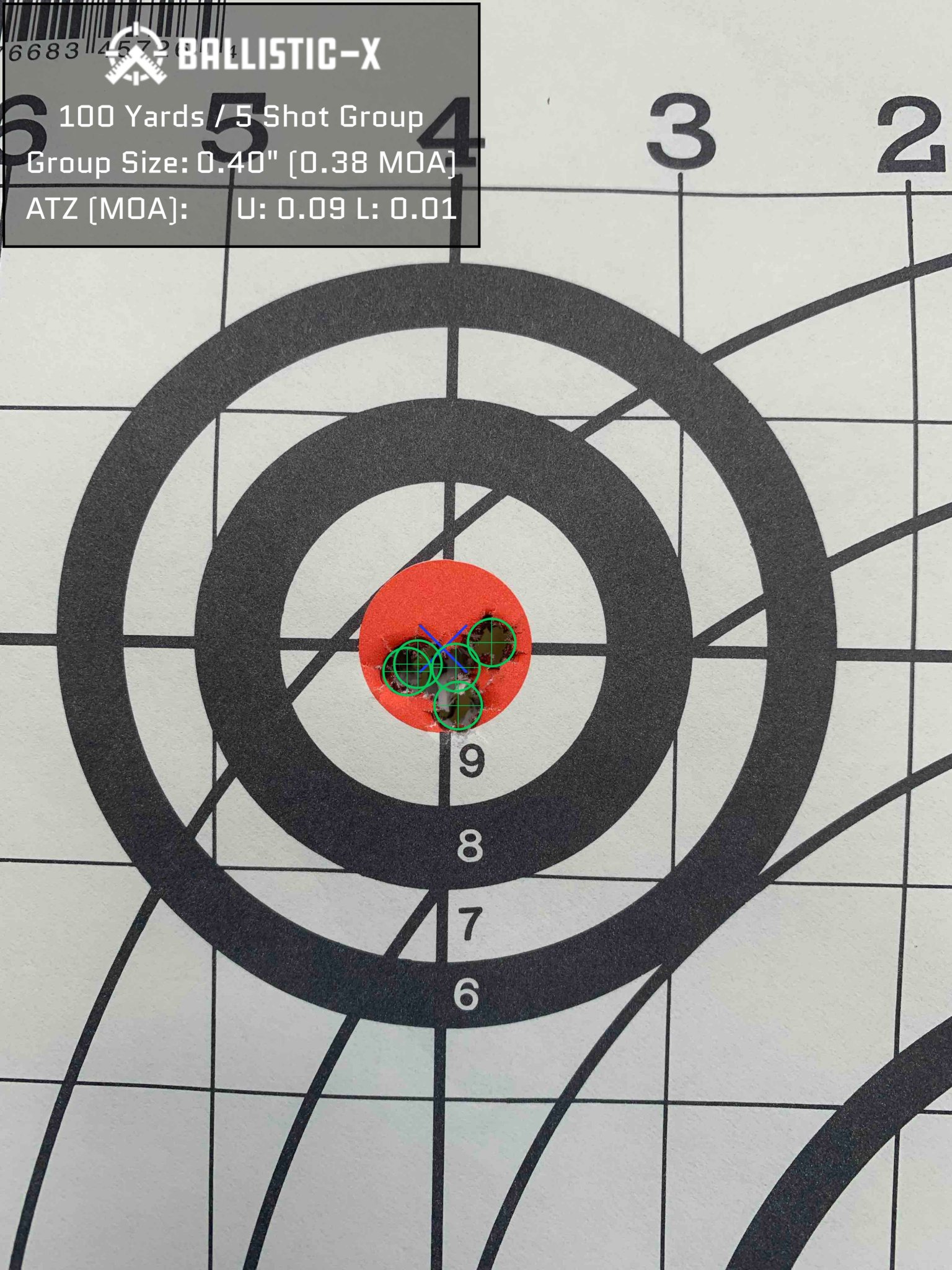

    I bought one a year ago for $800 as a donor rifle. I think what slowed down the sales was the factory barrel length. The action, twist, and magazine allow for nearly 2.6" 223 and they put a 20" barrel on it?
    I chambered a 26" 1:7 Bartein for it and absolutely love the gun. Slickest feeding 223 bolt gun I've tried. I shoot the 75 ELDm at 3030 fps. Had a few primers blank at 3060 fps when the gun was new, but it's gtg now.
    I picked one up when they first came out and have had the issue with cratered primers. I sent it back to Ruger and while I was extremely satisfied with their level of customer service, I wasn’t so impressed with their ability to solve the problem. I just sent out my bolt to get bushed. Overall I love the rifle. I’ve had it out to 1000 yds using 80 go eld’s running about 2830 fps and it would make consistent hits. Guys I was shooting with didn’t think the 223 could do it until they saw the magnetospeed hit indicator light up, shot after shot. This is a group from shighting it in using Norma 77gr match. The new barrel from Ruger is more accurate than the first. For the price they go for I would buy one in a heart beat, even with bushing the bolt.
    7100785
