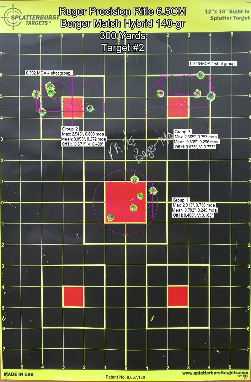

First... a 7/8" 5-shot group at 300 yards is 0.2785 MOA, which is a super-impressive group. When you say you're not getting 7/8" groups anymore... what ARE you getting? What kind of groups are you achieving on a REGULAR basis at this point?
That said... 1200 rounds is nothing for a 6.5CM barrel. My original factory barrel passed the 3500 round mark last weekend. Granted this was at only 100 yards, and I wasn't trying super hard.... 0.6 MOA 5-shot group.
7 weeks ago at 300 yards. Barrel was over 3,000 rounds at this point. Those pesky 5th shot fliers! But, still pretty good, I'd say. They're not 0.278-MOA groups like your 7/8" 5-shot group at 300. But, any time I'm sub-MOA at 300 yards or farther, I'm a happy camper. BTW, I only shoot factory ammo.

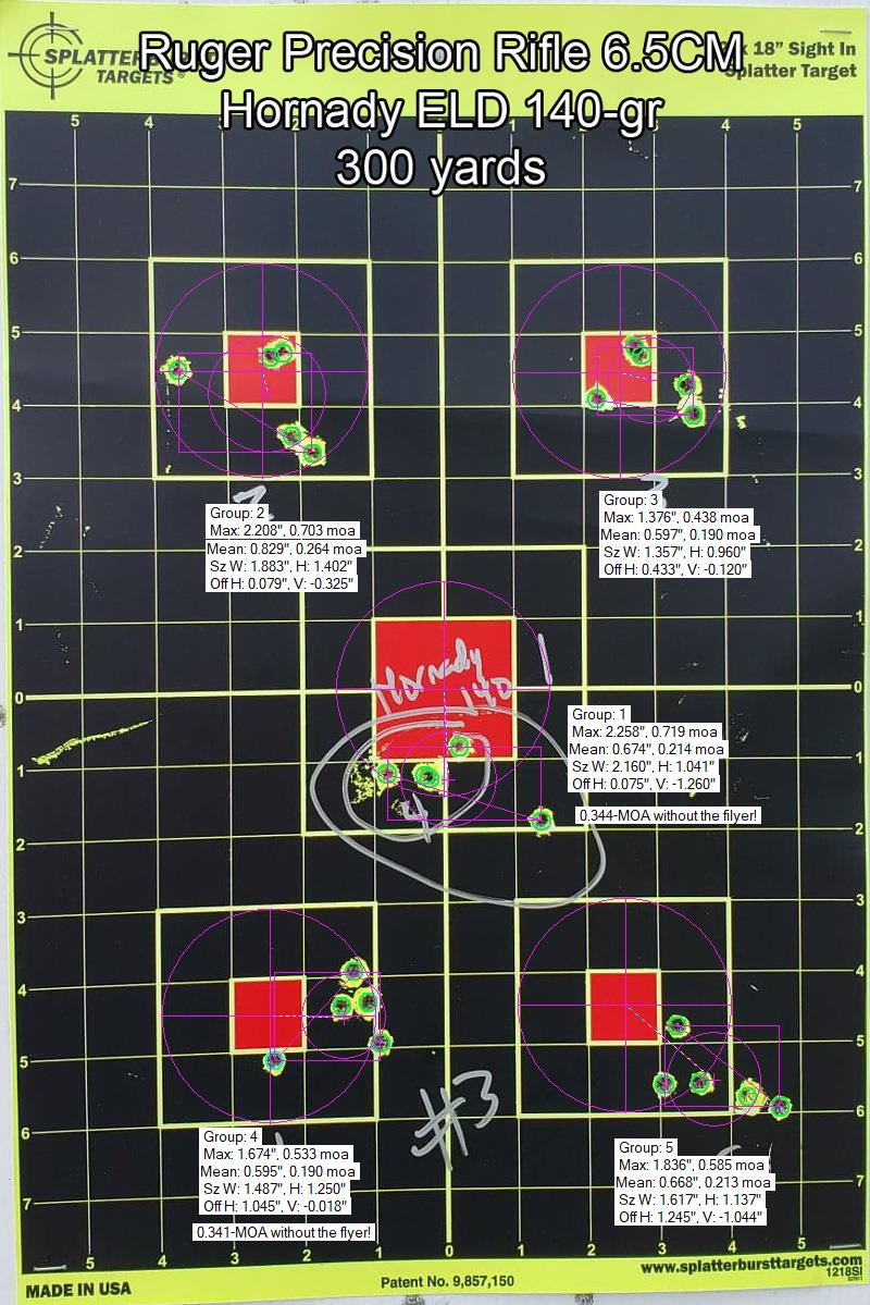

Some more 300 yard targets from September of last year. Round count was at about 2800 rounds at this point. Three out of five groups hovering around the 1/2 MOA mark. Factory Hornady ELD-Match ammo.

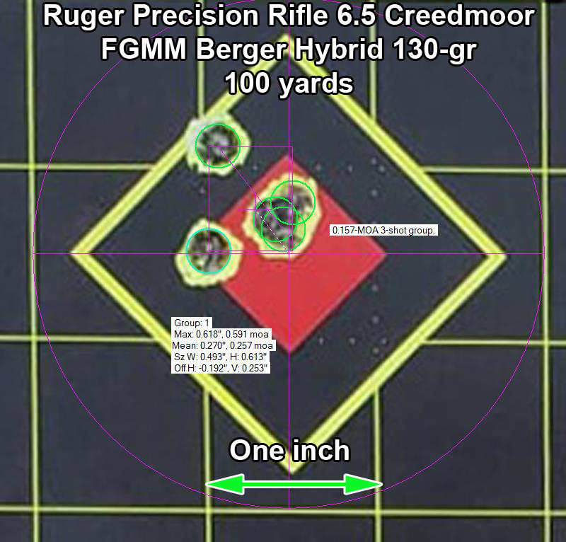

BTW, I'm eyeballing an off-the-shelf Krieger barrel, too. But, I'm waiting until my barrel finally starts showing signs of being shot out. So far... I keep shooting sub-MOA with it! 3,500 and counting! ?

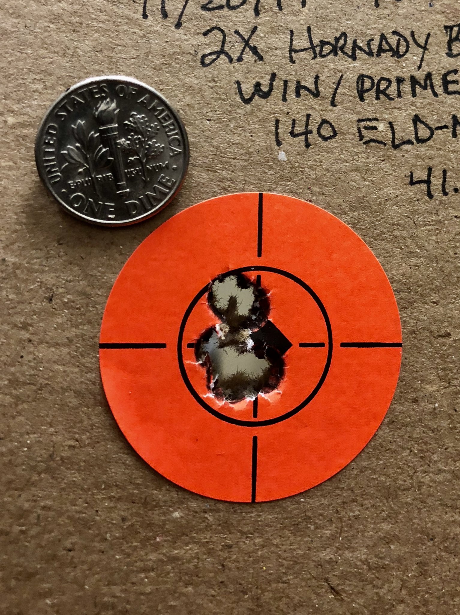

That made me think I should remeasure mine... out of curiosity. I've got measurements from close to when it was new. I measured it when I was playing around with some custom ammo from Copper Creek. I wonder how much it's changed, now that I've got over 3,500 rounds through it. :)
