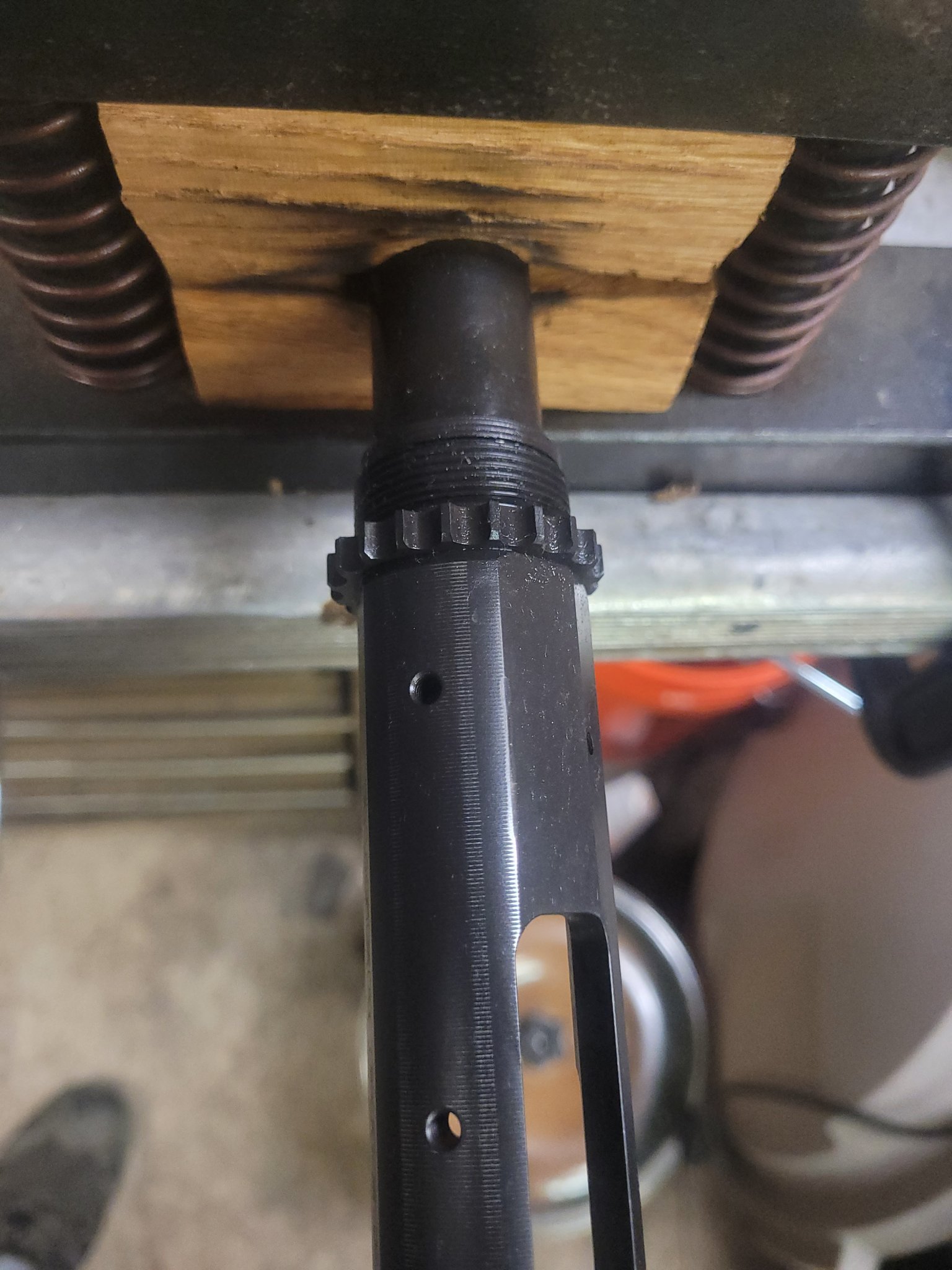

    I am trying to swap the barrel on my RPR. I have heated it with a torch, wacked on the armorers wrench with a mallet, and used a 3 ft cheater bar each direction to try to budge that damn barrel nut. Do I need a action wrench for this thing. I have the barrel in a vise and it is fucking tight around the barrel and when I use the cheater bar I just spin the barrel in the vise.
    Any advice?

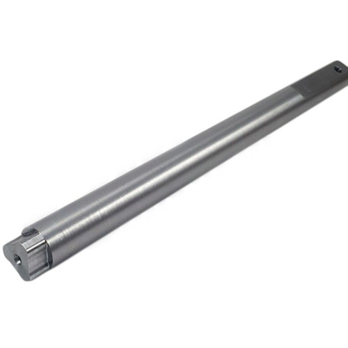

    I've pulled 2 of them and never had the dreaded gorilla torque issue. I'm surprised the cheater bar isn't working. You can buy a reaction rod for the chamber from Anarchy Arms. May be helpful.
    Do I wrench on the receiver itself first or just on the barrel nut AR style thing? It looks like this.
    The reaction rod goes in the receiver and locks in the chamber.
    26430f95-cd45-5196-ab44-f2f6fcd64468__64525.1551221446__10322.1563901380.1280.1280__87382.1648...jpg
    The barrel nut is what you need to wrench on. Make sure you're going counterclockwise as if you were looking down the barrel.
    Just to clarify, that is an action wrench available from anarchy outdoors. A reaction rod is made by Geissele and is for AR’s.

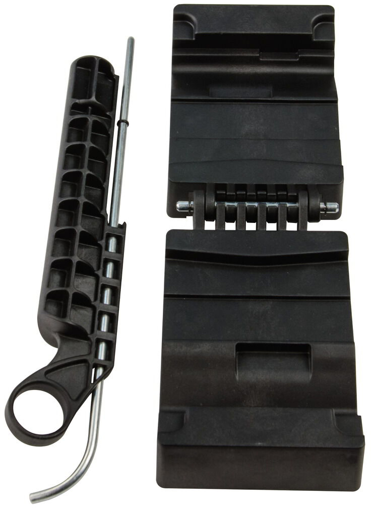

    Hi, this is my first post. I too am interested in changing my .308 RPR's barrel. Is this the Wheeler Delta Series AR-15 Upper Vise Block that will work with the RPR receiver? Thank you!
    Am I the only one that puts the action into the vise with leather as padding? I then put a cheap fucking NcStar AR wrench on the barrel nut and whacked a couple times with a dead blow. Zero issues.
    If you put just the barrel in the vise, the action may be spinning with the barrel nut.
    In my opinion, you need to isolate the receiver from moving, not the barrel.
    I have done a couple and never had had the action spin. While your method probably works just fine, for most knuckleheads clamping the barrel is safer than crushing or warping the receiver.
