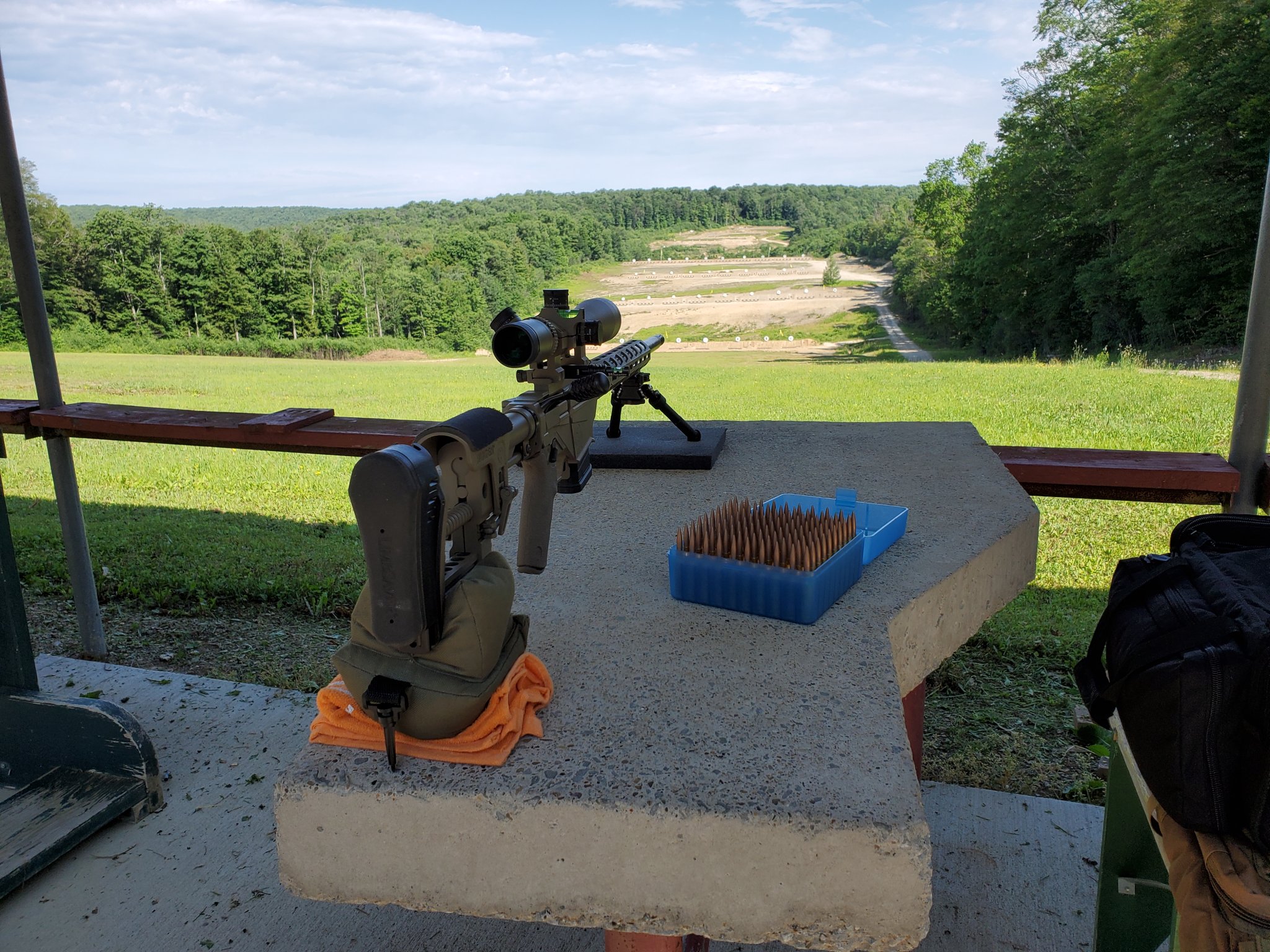

Forgot I was a member here and have little experience in "Precision Rifle" world. Definitely a noob.
I’m mainly a milsurp collector/shooter. Love DMRs and scope what I can for my old eyes. A couple years ago my wife got me a Ruger Precision Rifle in .308. Finally spent some time with it after breaking in the barrel with a buddy. Not being accustomed to modern “precision shooting“ equipment it really did impress surpassing all else I have. Has printed sub 1 inch groups, can easily hit 12” steel at 400yds and not hard to take out clays laying on a 200yd berm using some old 168gr match ammo from Georgia Arms.
I am REALLY not nuts about the butt-stock. I’m 6’3” (a bit chubby) with pretty long arms. The locking levers for adjustments are a bit kludgy and it’s just uncomfortable overall. I’m very happy with the scope I’m using but would like to make some minor upgrades. Read a bit on the phone this morning and found a video of some custom shop guys talking about some basic upgrades.

There is an entire RPR thread. It’s pinned in the bolt action section. I suggest reading the whole thing.
having said that, if you have big gangly arms the magpul prs gen 3 is a fine choice. I have it on my RPR. Pistol grip is subjective. The bolt problem you deal with can’t be changed by changing the handle, it’s a function of how the bolt works and the gun is designed. You’ll just need to practice running it. All brakes are noise monsters. Some worse than others. Get a silencer.

Since my OP I was out to the range last weekend and I have decided to order a Precision Rifle Stock from Magpul. The stock stock is just not for me. Kludgy and not getting LOP I think I need.
I like the trigger but I also prefer a 2-stage experience so I also ordered a Timney trigger - just because.
I’m fine with the bolt handle for the time being. Not ramming my wrist into the scope.

Presently I am using ARMS #22 low throw rings. I have no problem achieving a site picture with riser set lowest but is there any advantage in getting the scope a little higher up? I believe I have some higher rings laying around.
Upright more comfortable/natural head posture which would then position your eyeballs/pupil more centered in your orbital socket theoretically creating better alignment between your eyeball and the scope lenses.
With rings that are too low on the RPR, you end up tilting your head down and then using your eyeballs to "look up" in order to see through the optic.
It all depends on your skull shape but generally AR height scope rings (1.40" to 1.55" base to center) work better on an RPR than typical low or medium rings.

I did order a Magpul PRS for my wife (to give me for Christmas - LOL). I forgot where but I think I read I'm going to have to get a buffer tube and spring for it ? True? Which to get. Doesn't mention on the Magpul site.
You can use a carbine buffer tube or a full length rifle tube. No spring necessary.
