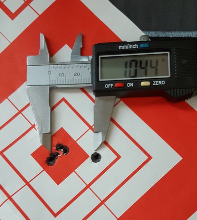

I should clarify, it's not a sudden occurrence. It shoots just under MOA on average I guess. I'm frustrated when I call a shot that I know should be right there, and it's far enough off where I say to myself, no way that was me.
This picture is perfect example of what I mean. This is not an isolated occurrence....not always this far out, enough to piss me off though.

I don't reload, using Hornady 140gr ELD. I don't think its me.....I can usually tell if I pull one or screw up the shot. When it's a good call and I see the impact 1 inch out of the cluster, something gives. If it were a rest issue I would expect to see a shotgun pattern with little consistency. I guess my first instinct is to blame a factory barrel. Scope is a new AMG and rings/mount is solid. I guess theres a chance it could be that but again, I go to barrel as likely offender.
