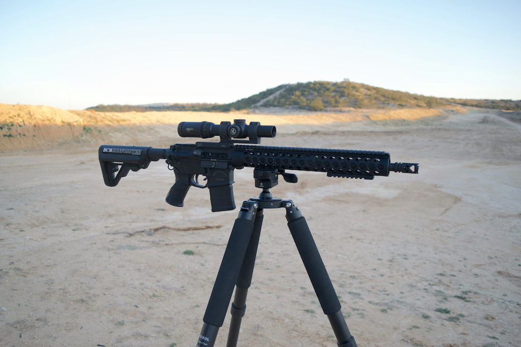

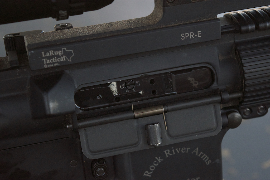

Received the Bootleg Adjustable Bolt Carrier Group from Rainier Arms the other day. Threw it in the gun on tuesday, and proceeded to run 75gr PPU Match (20rds), 50gr AE Varmint (30rds), Monarch steel case FMJ (40rds). My rock river must not be too overgassed, because it would not function correctly on the second notch with any ammo. Ran flawlessly on the "U" unsuppressed setting. There was no change in accuracy (although I didn't expect there to be). This RRA 1:9 barrel seems to like anything I run in it with 75gr and 50gr making equal amount of hits at 500 yards on an 8" plate. I'm pretty dang happy compared to getting an AGB because I can switch from unsuppressed to suppressed on the fly. Since I'll only have one can for the next year or so, I'll be moving the suppressor around on my rifles so this set up works for me.
I also took the opportunity to install the SSS forward assist gas vent, and RTV sealed my BCM Gunfighter CH with Permatex Ultra Black. Now, just waiting in purgatory for my Q Thunderchicken. May run grab my Cherry Bomb out of the box and install it when my Rocksett arrives so I'm ready to quick attach and go shoot when the stamp arrives.
Thanks for yalls input! I appreciate it. I'll post a new thread with pics when the suppressor arrives.
