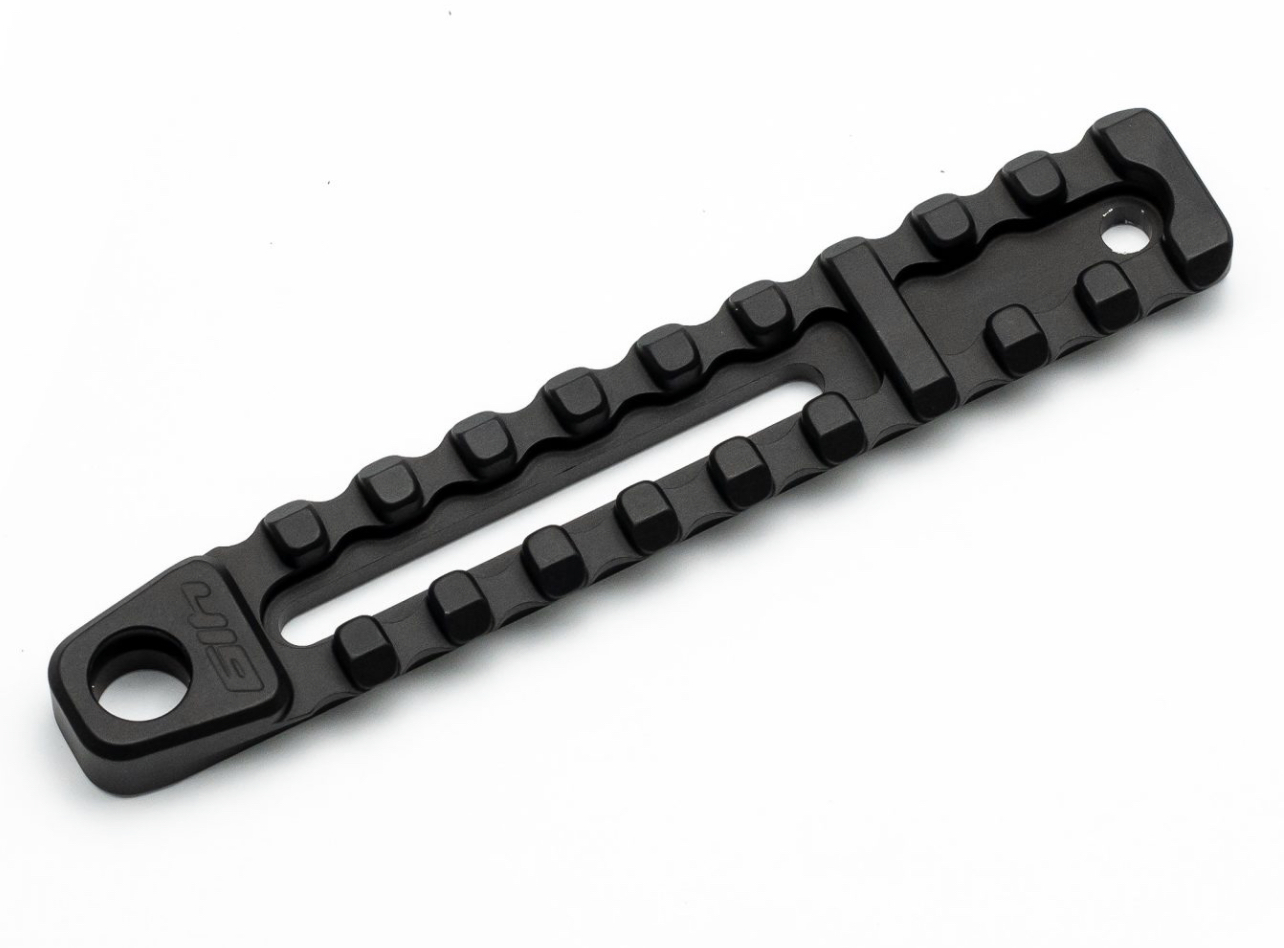

I agree most pic rails are stupid sharp. But look at this pic rail. Radiused edges abound. That’s what I’m talking about. Later I thought of a new (to me) idea, a pic rail without notches (or maybe just one)…just like an Arca plate except narrower. Would have to mod the RRS clamp if zero notches, obv

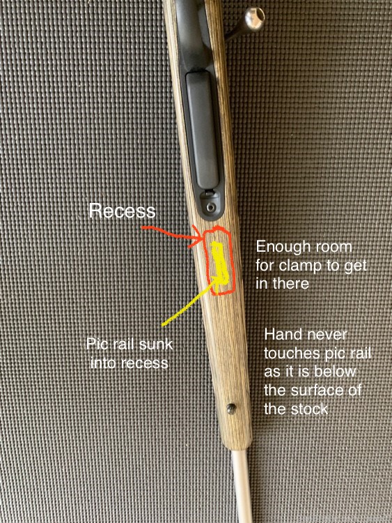

And finally, ideally, the pic rail would be in a recessed area right in front of the magwell with enough space for the ballhead’s clamp to attach around it. Probably requires a new, skinny, slightly taller clamp to get in there while still allowing the stock to look untouched from the side. The rifle looks normal and handles normally.

Put a pic rail where indicated.
Carry with hand around mag.
Thats where I carry my tikka when I hand carry it, its my main hunting rifle.
Good point. This does work when you have a flush-ish mag. As a colony varmint shooter, I tend to use higher cap mags or in the case of CZ 527’s, the 5-rounder always sticks down (only size for most calibers).
