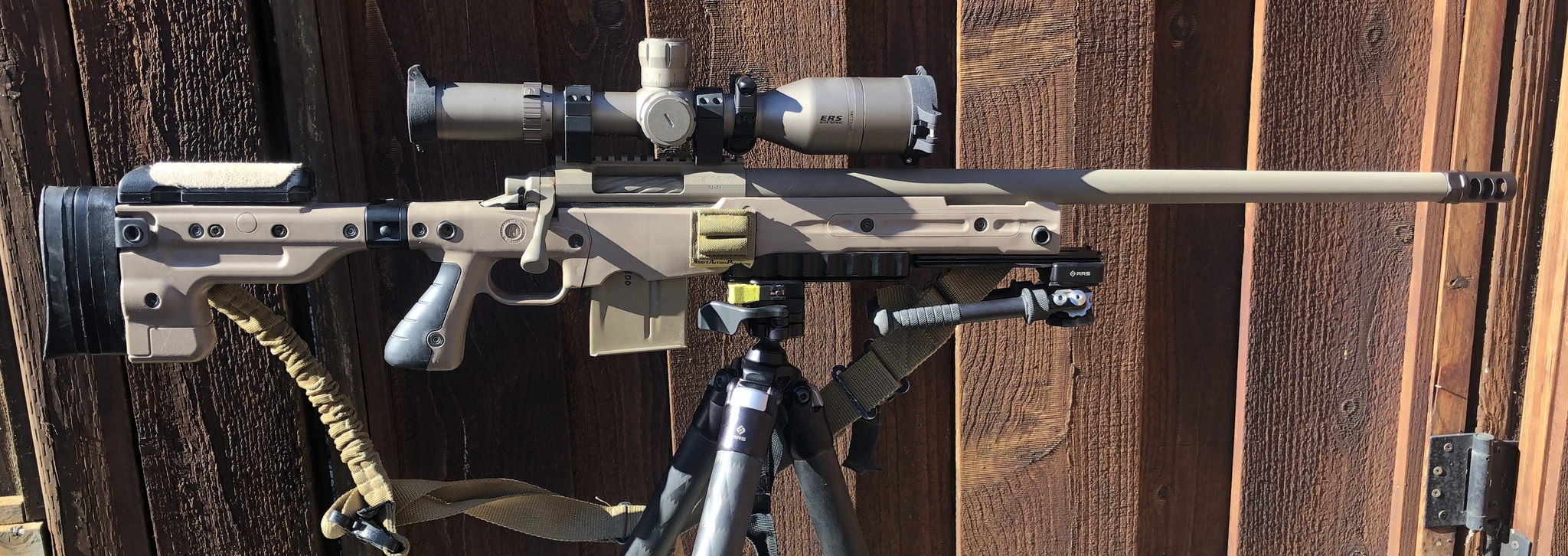

My intent here is to add a few images comparing the setup of the RRS TVC-33 with the TA-3 to the TA-3 used on the 3372 and add a couple of comments about the TA-UL on the 3372 and 3342. Plus, a quick note after a ton of time on the RRS Anvil 30, my overview of the different RRS head options.
First, let me toss of the difference in stability between the RRS head offerings BH55, TA-UL-LC, ANVIL 30, and TA-3. I am comparing the best of the best for shooting, so the negative comments are splitting hairs amongst the very best devices we have to shoot from in this category. Here are my antidotal takeaways after way more shots than I'd like to admit to.
It should go without saying that as far as the "system goes," the more stable the better, but for some, weight can be a huge issue, and compromises need to be made. At $1 -$5 plus a round, it might make sense for people NOT to skimp so much on rifle tripods.

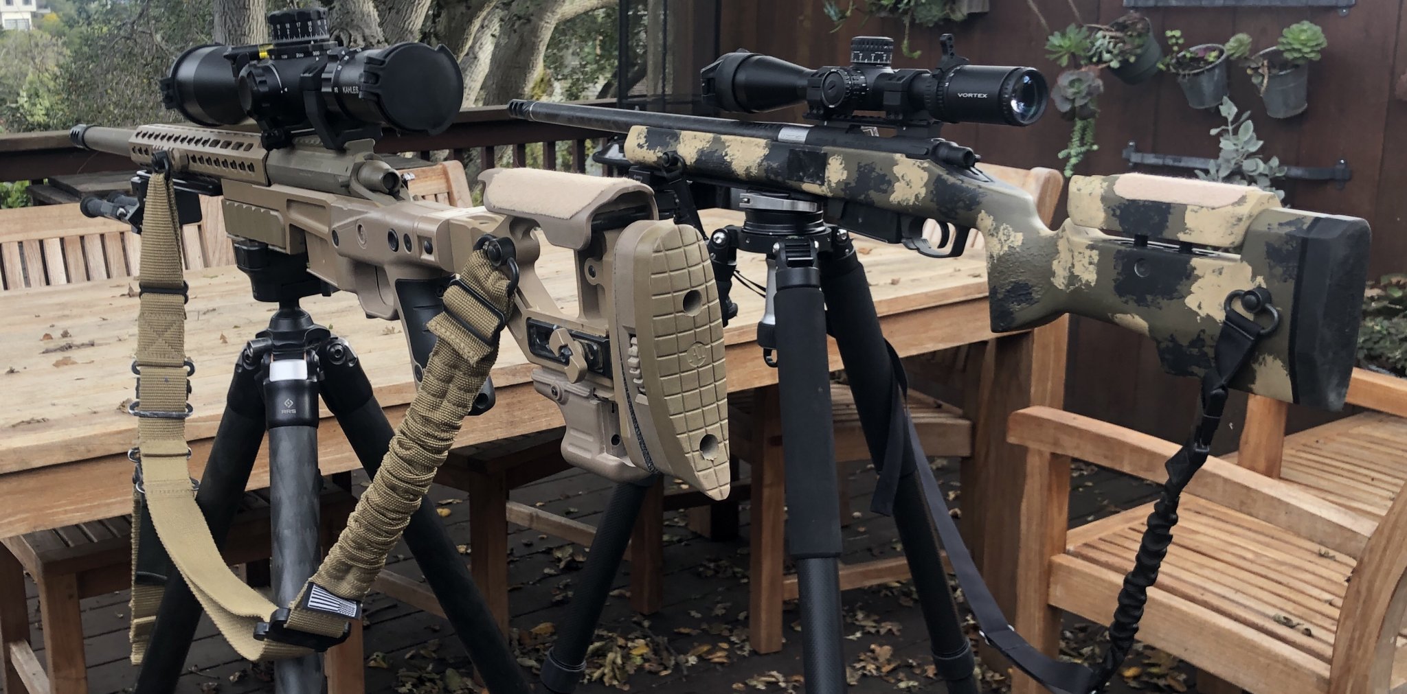

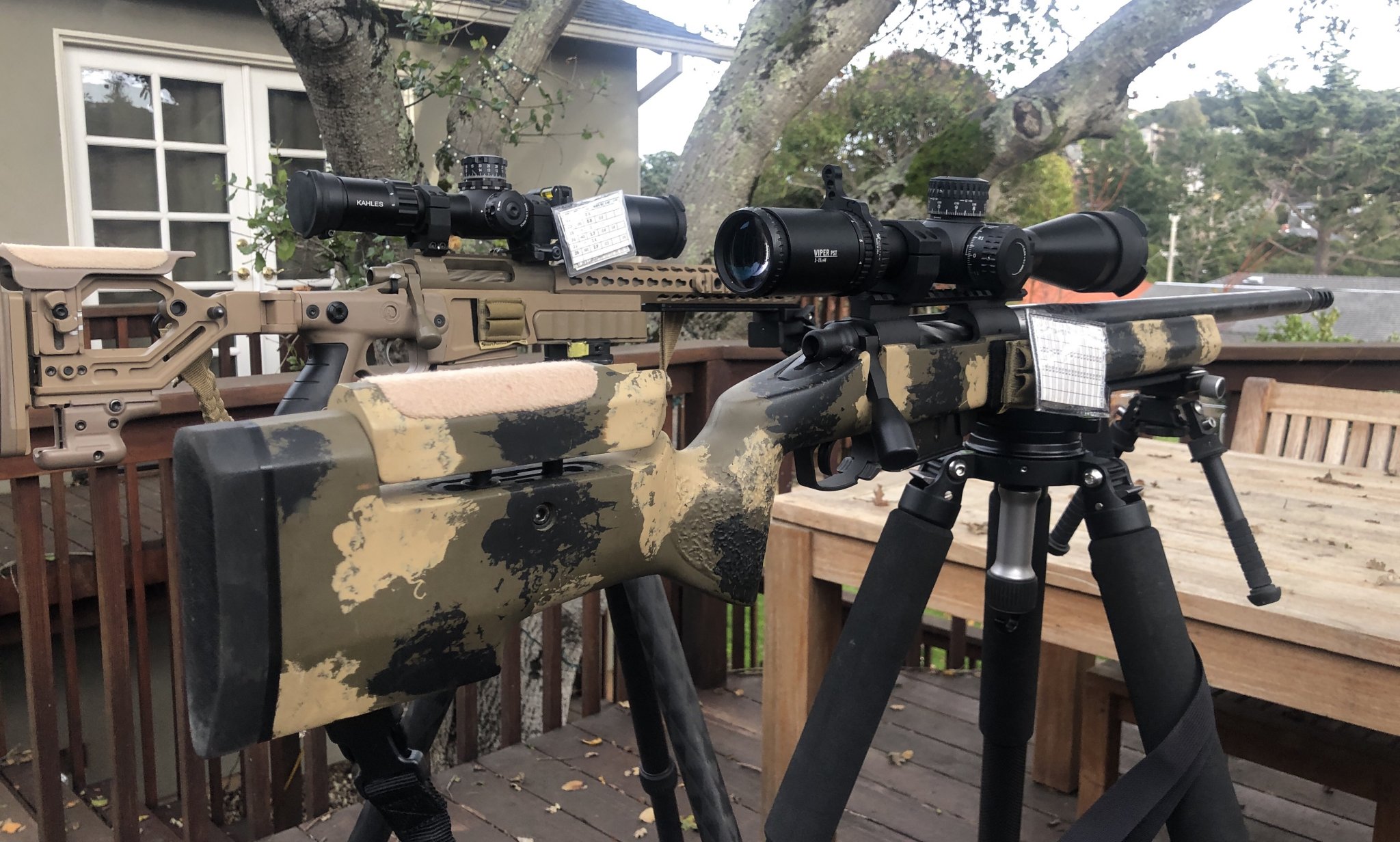

The RRS TVC-33 with TA-3 on the left, Feisol 3372 with the RRS TA-UL middle, and the Feisol 3342 with hog, on the right.
I can not tell the difference with the TA-UL on either of the two tripods on the left. Honestly, I find the 3372, legs a bit faster and easier to use. However, the TA-UL does flex 2x more than the TA-3 on either set of legs. However, this movement is minimal. At 600y, you can "force flex" or "intentionally move" while locked, a bit more than a doorway, were as the TA-3 is about half. It is important to note that the flex difference is not in either of the legs but in the leveling heads.

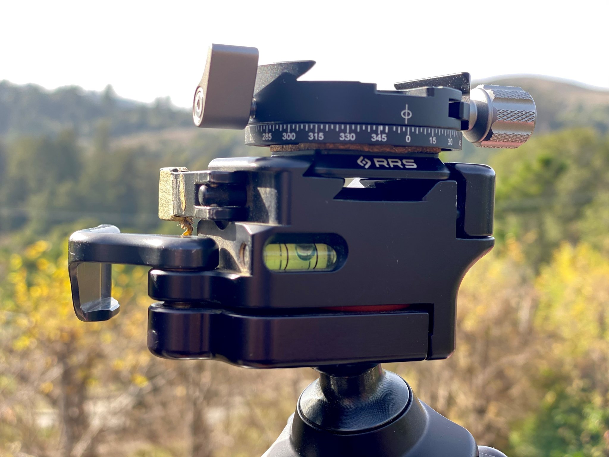

Here are the two leveling heads. The RRS TA-UL on the left already spun down onto the Feisol 3372's Apex top plate with groves for the locking set screws.
There does seem to be an option to add the Anvil 30 to your Feisol, or similar were the TA-3 would work. I have not tried it, but it is the same base plate diameter at the TA-3 or the standard top cap for the apex on the TV-33.

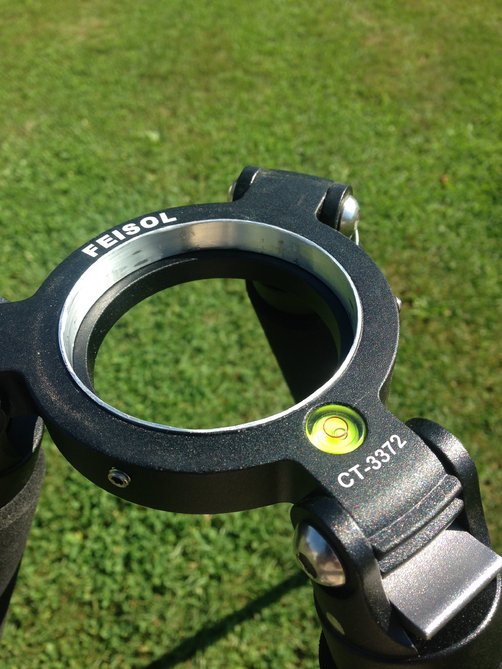

The Feisol 3372 is 1.5mm or so wider than the TVC-33, but it will install and is stable in the Feisol 3372 (best with a tiny shim from a soda can).

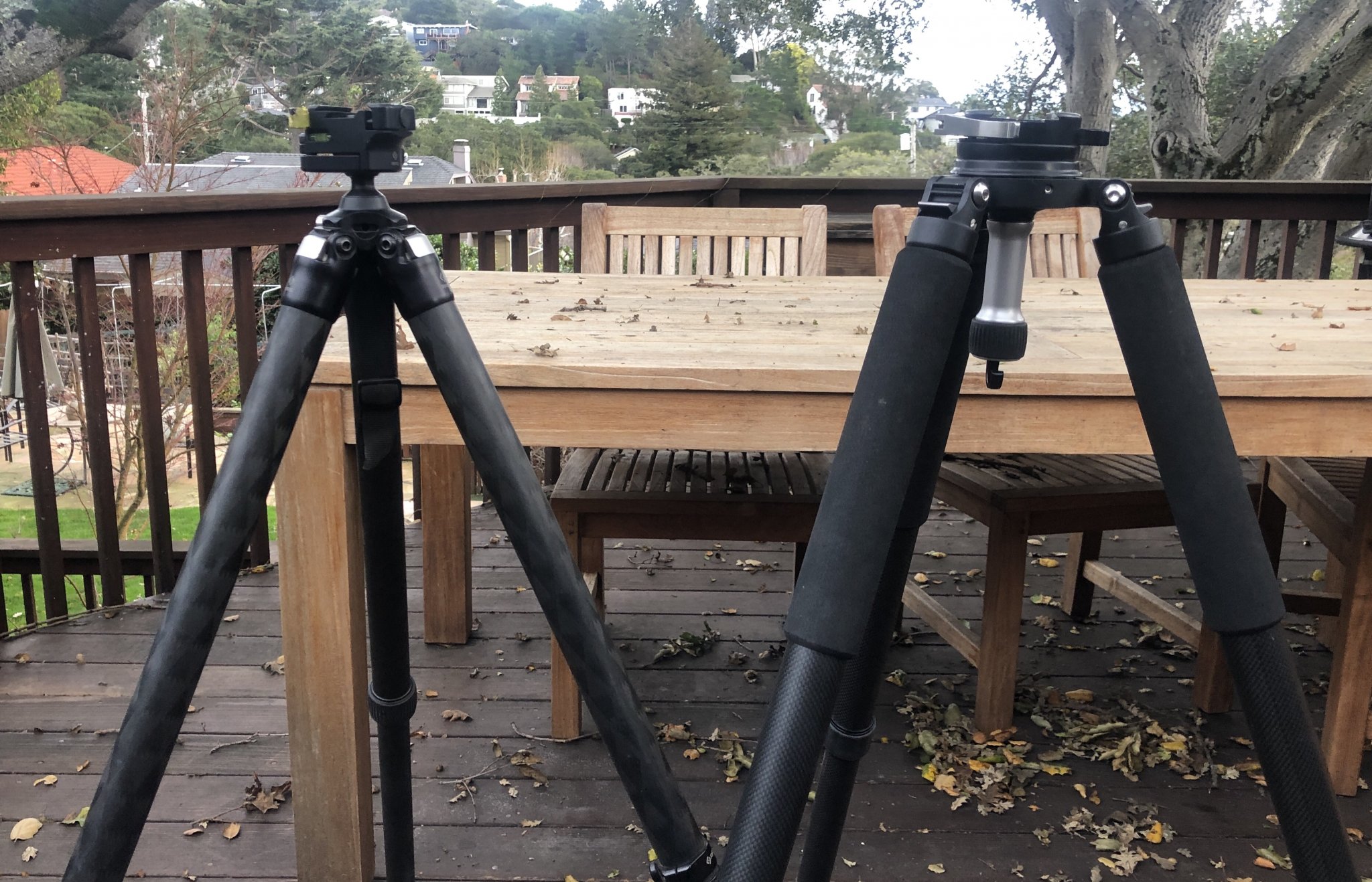

RRS TVC-33
Feisol 3372
The apex on the RRS TVC 33 is way more complex than the Feisol. The leg connections are obvious, but look inside the RRS's retention system might really make sense as to why you're paying more[- an expansion lock ring very secure!
RRS TA-3 installed in Feisol 3372.. very solid.
Here is where you would think about shimming the Feisol ( or maybe spent the extra coin) - legs shown are actually RRS
For comparison, the uber light Feisol 3342 next to the RRS TVC-33. The more Flexi, 3342 is 1.4LBS lighter than the RRS TVC-33, when both are set up as shown. In fairness, RRS has the TVC-23, weight-wise; it is between the two shown. NOTE: That with 10 round mags and high angle shooting (up only), the mag can contact the apex limiting the travel if you have the gun pushed forward in the QR on the TA-3. The TA-UL actually is a bit more forging in that area. That said, it simple to mount the rifle correctly to avoid the contact.
Notice on the lower weight class tripods you do give up some size that ends us, resulting in a bit more twist with the rifle—the lightweight 3342 on the right.

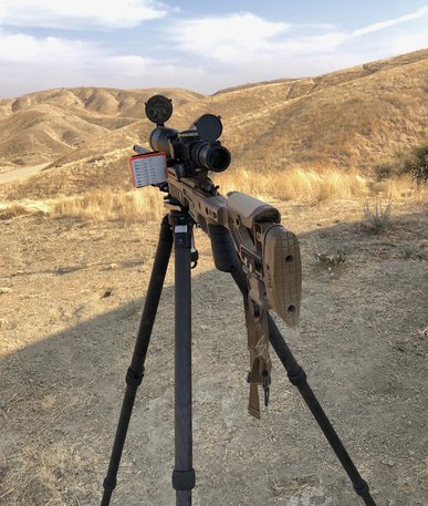

Edited to add images of TA-3 2.5" handle verse 4.5". It might be worth noting that handle swaps are fast and easy. Just loosen until it unscrews and replace.
The 4.5's hook can be unscrewed, providing a net difference of 1". The 4.5 provides a touch more leverage to make smooth moves when on the rifle and feels more comfortable.
Note that with the 4.5 you can get very stable prone even if the leg is not locked, or you can clearance a tiny bit of dirt if you think you need it locked. The image is just short of full lock (but stable anyway).
Below 4.5 with the hook removed, it is as low as most bipods.
Here is the 2.5 with legs locked. The 4.5 again will do the same if you make clearance.
The Feisol lacks horizontal lockout, so it is a bit higher unless you disengage a leg or two.
Here is a photo showing the one reversed non-locked leg position needed on the Feisol, to get as low as the leveling base on the RRS TV-33 legs. But you have to be honest with yourself, why wouldn't you use your bipod? Just saying...

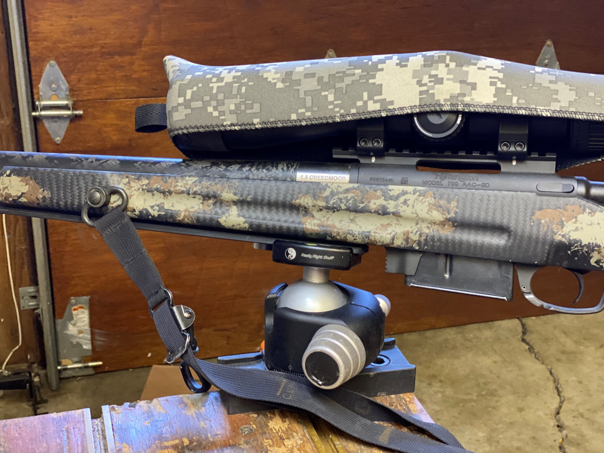

Here is what I use my BH-55 for the most today. I mount it the dovetail of my SAC barrel vice and use it as a gun vice.

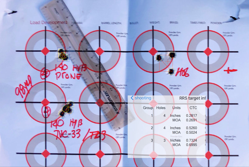

Superfast entry/attachment for a dovetail device. It ties for the lightest solution with the Anvil 30 but is the most solid platform available. If tiny groups are your thing or your shooting in high winds, you will notice the stability difference over the other offerings. This is especially true if you tighten the internal tension nut. It also seems to hold tension and manage tension a bit better with the larger bowl than the Anvil 30. The three downsides to the newer Anvil 30 are, extreme angles mandates leg adjustments, it is not pic/dovetail dual purpose, and it does not pack as small.
