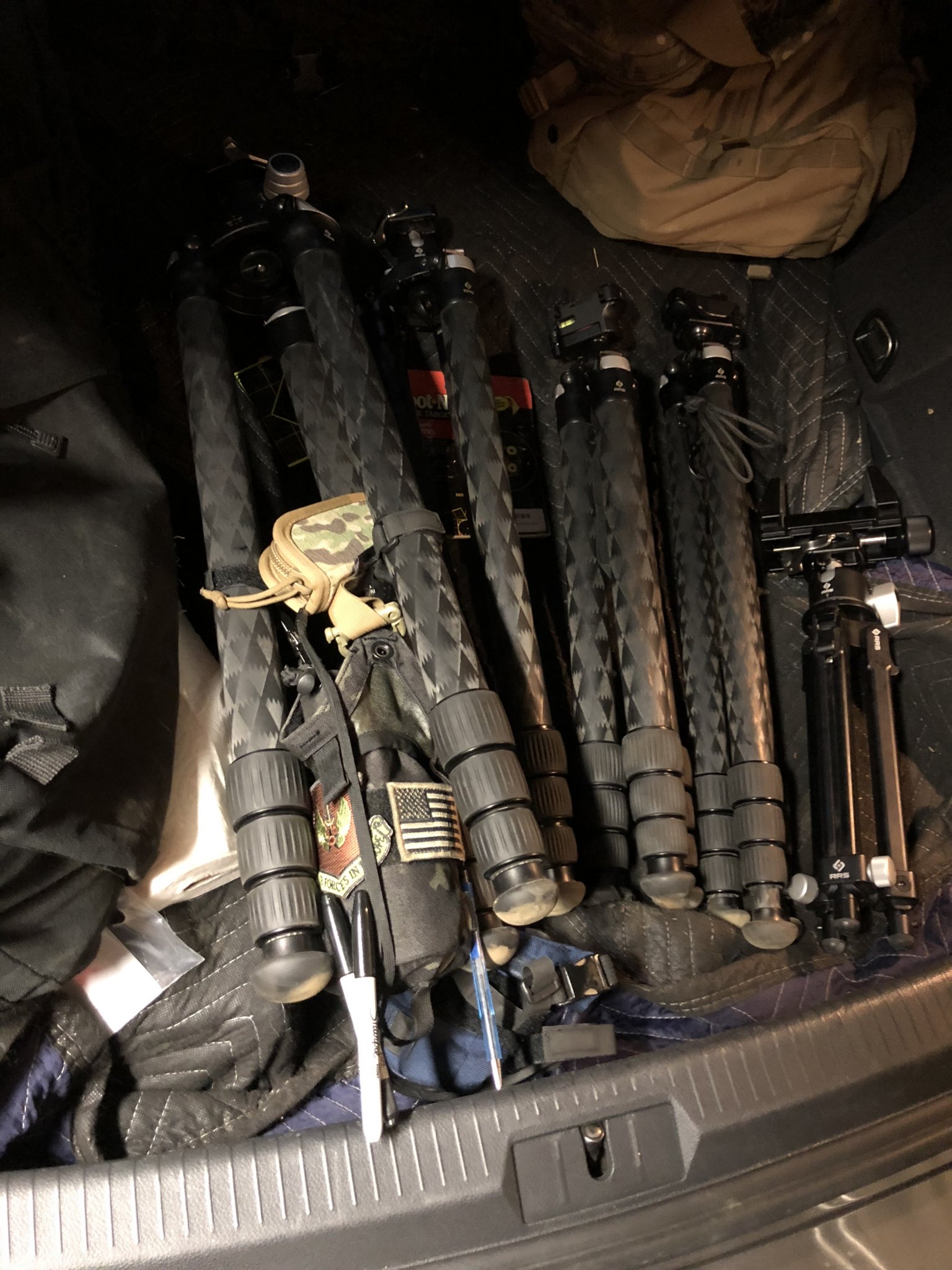

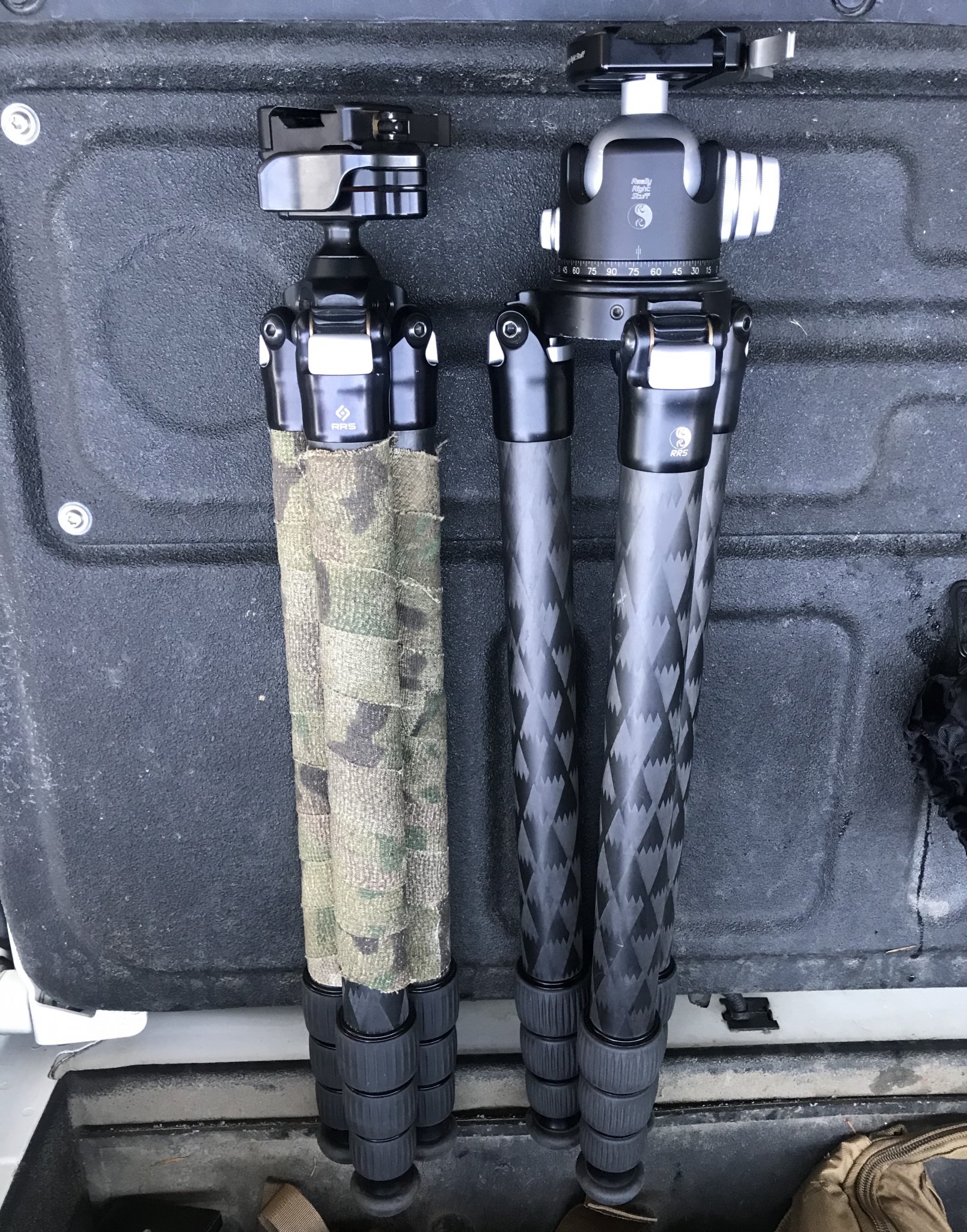

I have shoot off both, personally run a RRS 34L with the Apex head and Anvil-30.
I think both are about the same for stability. But I like the RRS apex head better since it folds up more compact for carry and is lighter. And I like the Anvil-30 more then the leveling base on the Crux I find having the knob under the head sometimes a pita if you are setup at an angle..

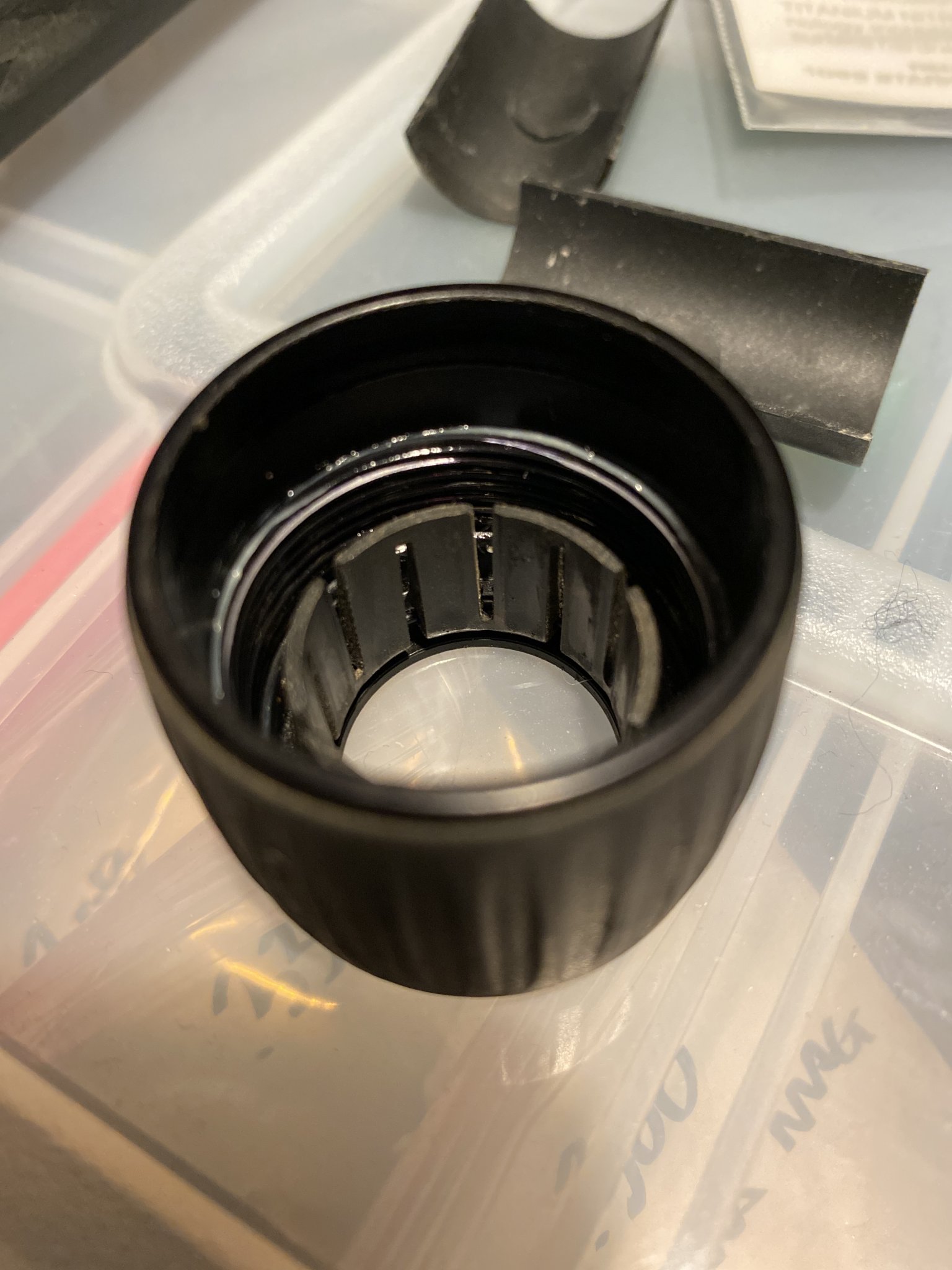

RRS has no rubber inside the locking mechanism. It’s all plastic, my guess would be delrin

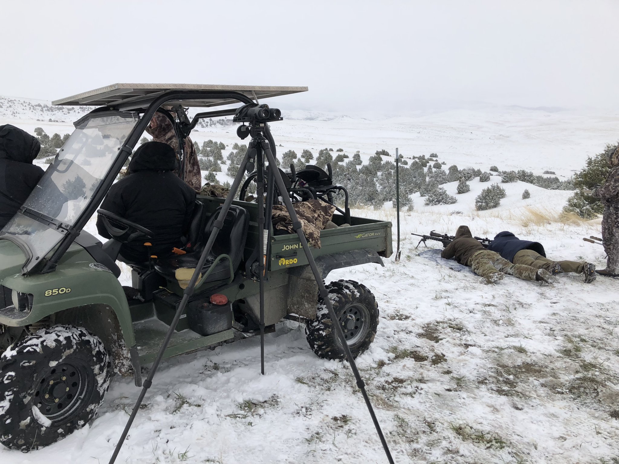

I’ve used mine in freezing snow with 20+ mph winds and not a single issue burring it in ice and snow. Also have had it in semi freezing Wyoming mud.
that pic was the short amount of time it was clear.

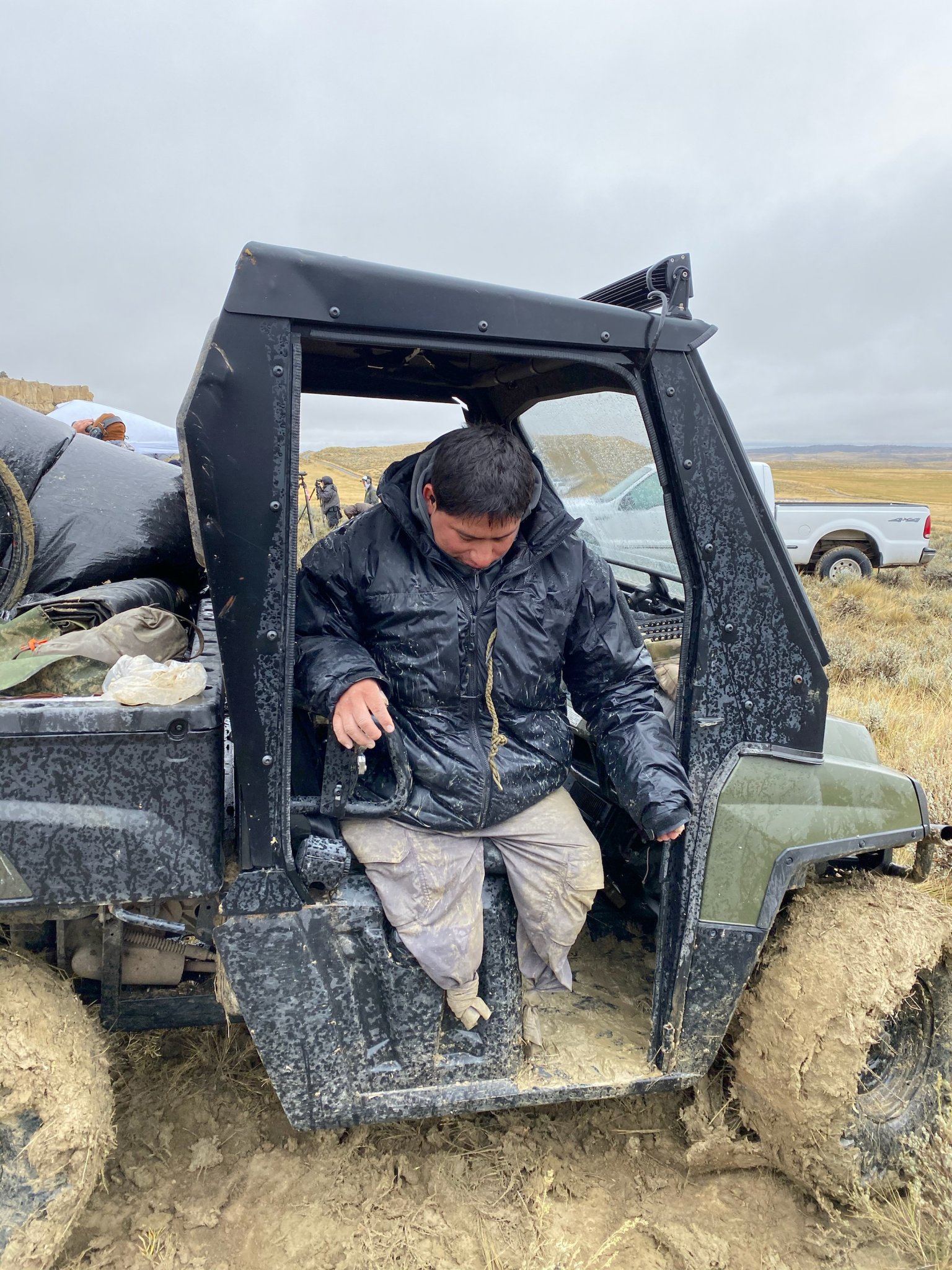

No tripod In the pic but it was so cold and muddy, Jorge lost his legs

Shot off both, own 2 RRS. Honestly the larger Crux are more stable IMO. However in your OP you stated you want to hunt with it. The Crux’s I've used are freakin huge and heavy. If hunting truely is important than look no further than the RRS Anvil 33 or 34. There is no more stable and SMALL shooting tripod available.
