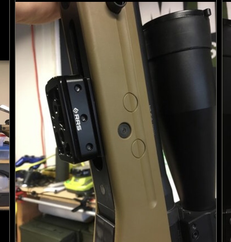

This is the Alamo rail with the RRS nato rail installed. I cut the rail so it would be the same length. The Nato mount takes up 5 pic rail slots and the Alamo pic rail is 8 or 9.

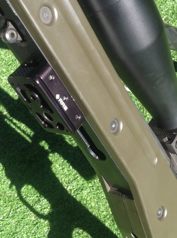

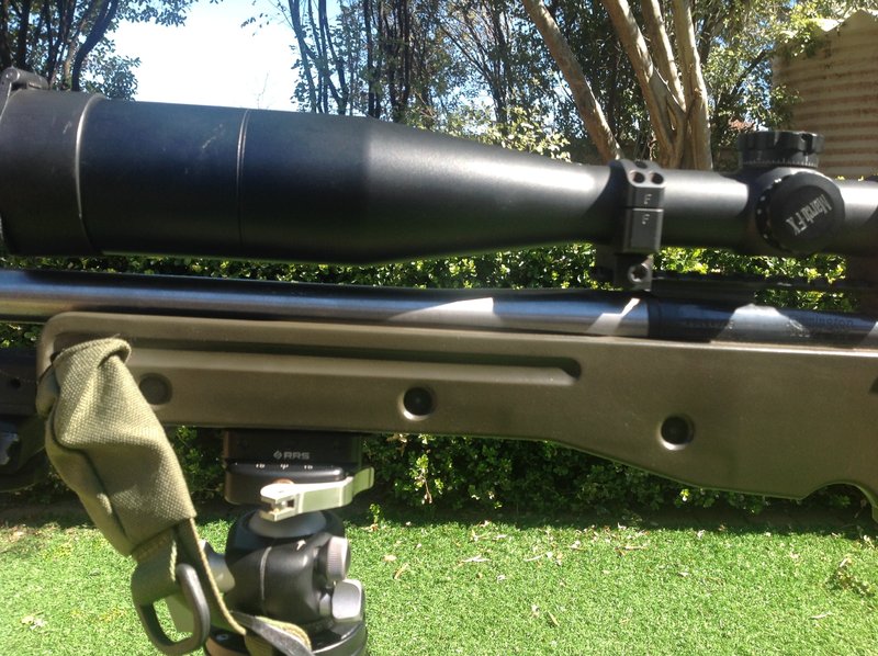

The NATO attachment has arrived and has been installed without fuss and bother.
Dry firing from multiple positions in the backyard (all Xs of course) tested the gear and the next step is seeing what works/does not work under recoil.
A good news story.

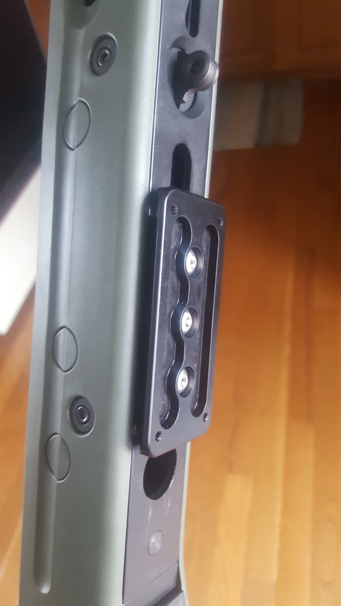

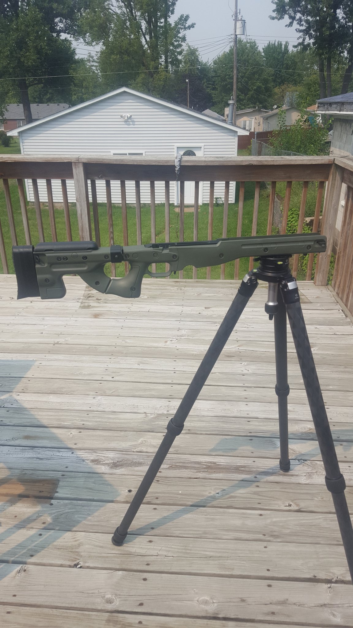

I already had the Anschutz rail adapter on my work bench when this thread was started so I modified it to work. It turned out pretty good and was good practice since I'm still learning on the mill.
I think you will have to find a used one at this point, I stumbled across one last year but they don't pop up very often. You could get a universal rail from mile high that will work as well. Here is one way to do it as well, I bought the anschutz rail adapter and made a new backing plate out of aluminum.
