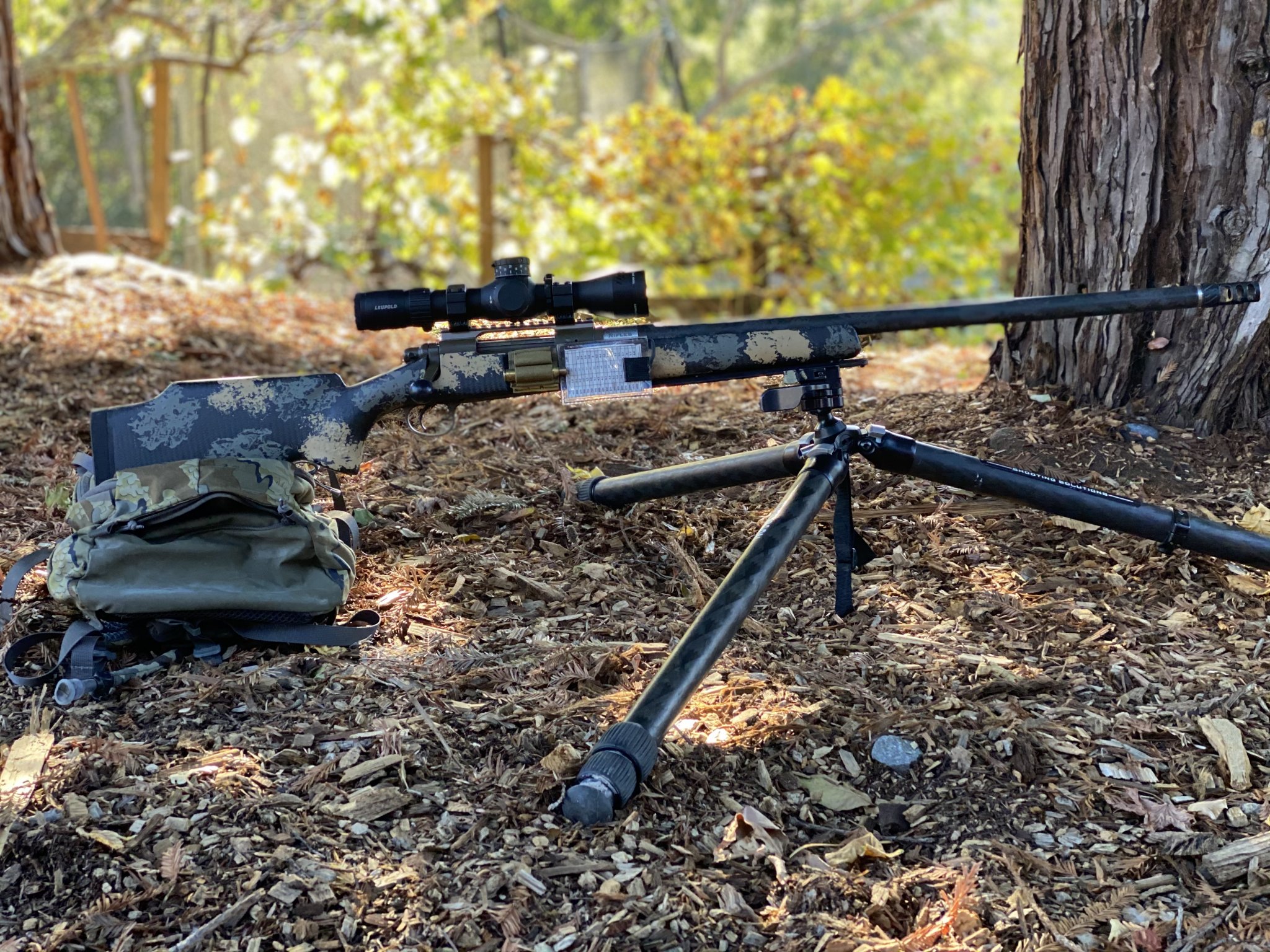

Here's my AAR. This tripod is awesome!!! It is rock solid. The Anvil 30 ball head is great. It was easy to get used to managing the tension to aim the rifle, then when you're ready to lock it down it clamps tight without moving at all. I have shot 3 rifles off of it, and used it for my spotting scope at the range. I couldn't be happier with this gear!!! Thanks!!!

I want to add to this and reinforce what Mike said.
I love the stability of the video bowl leveling heads as a pure shooting platform, even more than the universal; however, in the feild you will give up a lot of flexibility and speed in how you can use your legs if you choose a leveling base over the Anvil.
For instance high prone as in the image above, you might need one apex leg lock opened up. The head must have enough range or you can not accomplish this. This is also true for steep slopes or if you want to experiment with a lower front leg for more recoil assistance when using a lightweight hunting magnum.
this thread might help illustrate some of the Scenarios I mention; it is at 17k views already.
