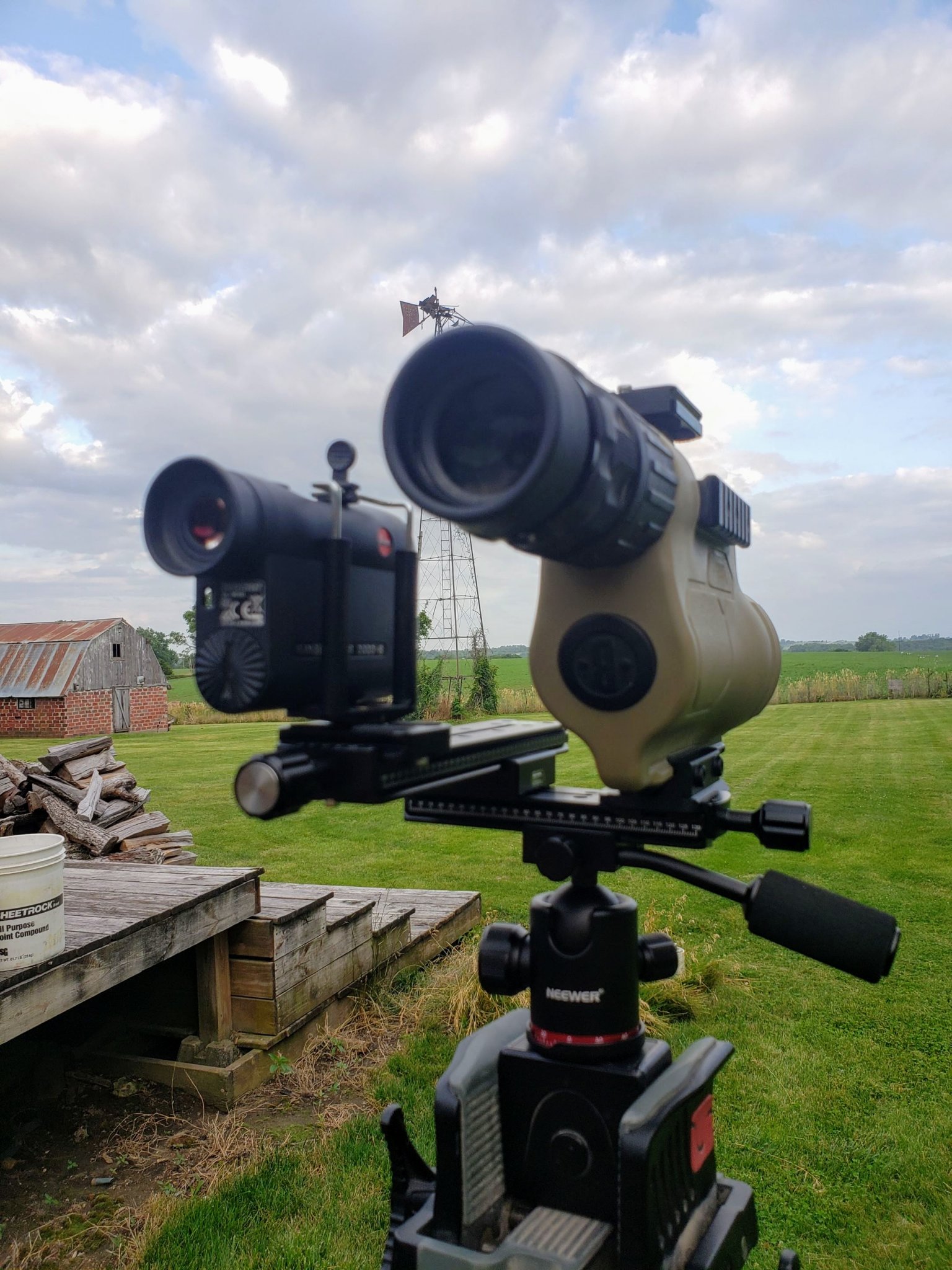

    I don't have an expensive tripod (wish I could) but here is a photo showing how I managed to get my spotting gear onto my hog saddle. I clamp a window mount in the saddle and the camera ball head is above the window clamp.
    You could add a $13 arca clamp to the bottom of a $50 camera ball head so you can clamp the ball head to the anvil30 and then the spotter on top of the ball head. Just a thought to have the best of both worlds.

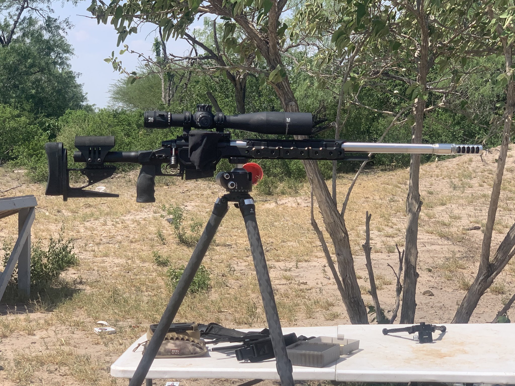

    So is the TA-2U-SC good to go for a tac table + game changer + match rifle on top? In general, the rifle would be put with the center of gravity directly atop the GC, so there shouldn't be too much torque on the head itself.
    That’s why I have the 55 ballhead you set the tensions you want, then use the large knob to lock/unlock.
    Is that on the series-3 tripod?
    What's drawing me to the TA-2U-SC is the fact that it's designed for the series-2 tripod, so it saves a little weight and is a little more compact that a series-3, especially with the versa apex. The 24L seems like a great compromise between length, weight, and stiffness. The BH-55 ballhead is 2#, and the 34L is another 3/4 pound heavier than the 24L.
    Like I mentioned above, I don't hunt, and in my past 4 matches there has been 1 stage shot off a tripod, and a tac-table + GC was definitely the way to go. I've read that the series-3 tripods are better for shooting due to the ability to handle our heavy rifles and dampen after-shot vibration. But if the vast majority of the time the tripod is sitting with a bino on top, or in a pack walking to the next stage, I don't know that the 34L makes sense.

    @samb300 , yes the TA-2U-SC is strong enough for your example equipment.
