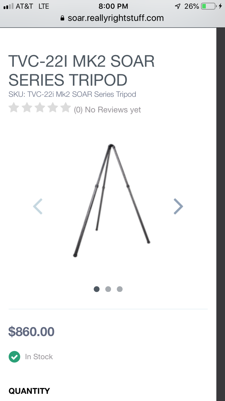

    Anyone using one for hunting? Or PRS? Thoughts?
    I'm strongly considering one of these myself. My only question is if I can get it down to a sitting shooting height with an Anvil-30. As far as the advertised specs go, kneeling is completely doable with legs collapsed and in 2nd position. However, this height would be too tall for shooting while sitting. What I would like to find out is the height at the top of a leveled Anvil if one leg was placed forward in 3rd position with the 2 legs in the rear in the 2nd position for seated shooting.

    i would think it is the same as another tripod with legs extended to that length.
    says folded length is 38.2" and if i extend my legs to that length when folded, and then set up like you say 2+2+3 i get ~20" to the top on the anvil 30.

    With the 2+2+3 setup, do you still have some useful angular range left over in the Anvil for a slight uphill shot angle?
    Thank you very much! Your picture and height measurement has helped me out considerably in order to feel confident getting the 22i with the Anvil.
