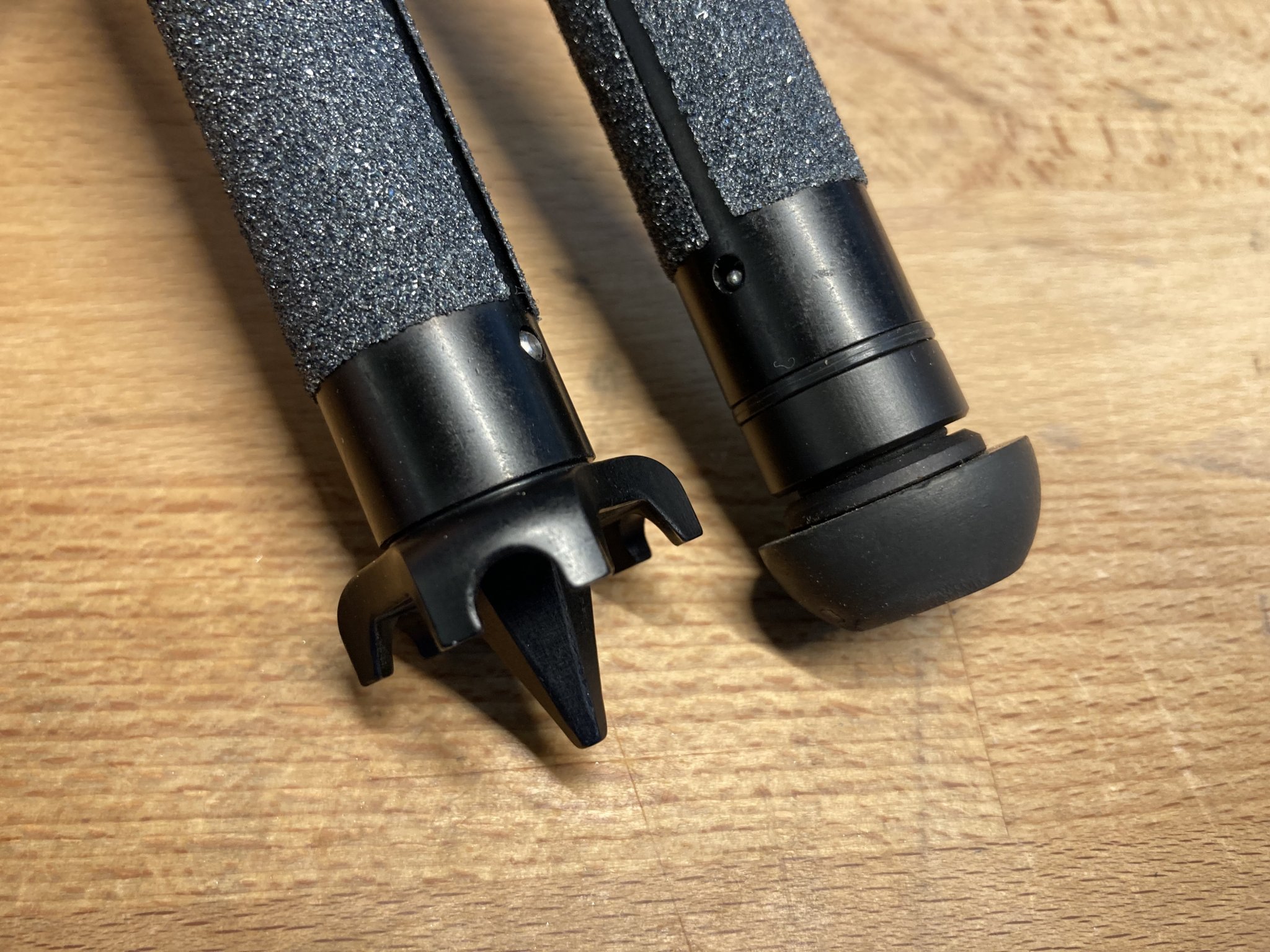

Please aggressively @@@@@@@@@@ me when it happens.I got a double and triple pull ckye pod this black friday, and once I receive it I plan to make some adapters for it. So now just patiently waiting for it to be shipped & delivered.

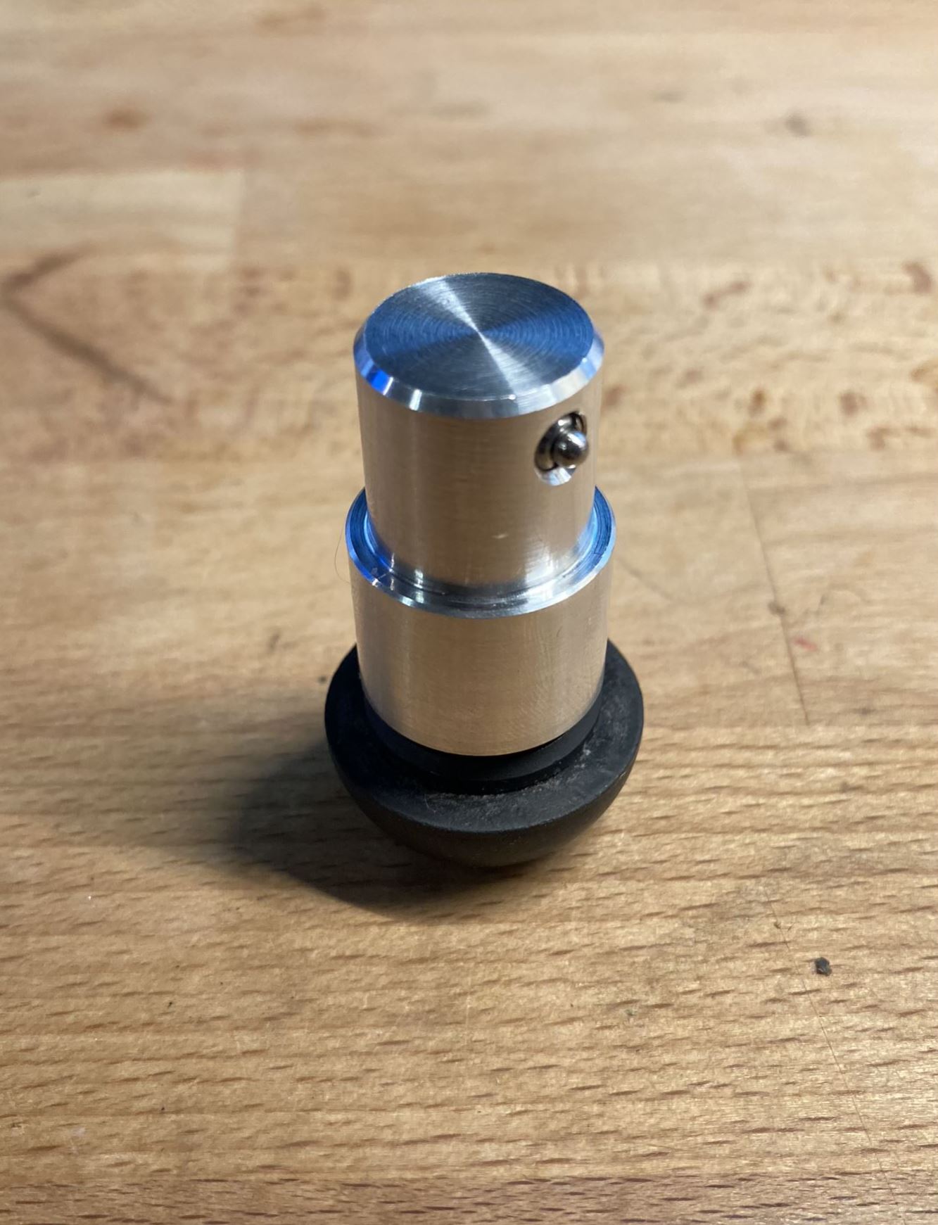

I don't have the triple pull, but here are measurements for the double pull:If anyone can help me do some measurement in the meantime, that'd be awesome:
On the double/triple pull feet: outside diameter, size of the plunger, center of the plunger to top of the feet.
On the double/triple pull leg: inside diameter, size of the plunger hole, center of the plunger hole to the bottom of the leg.

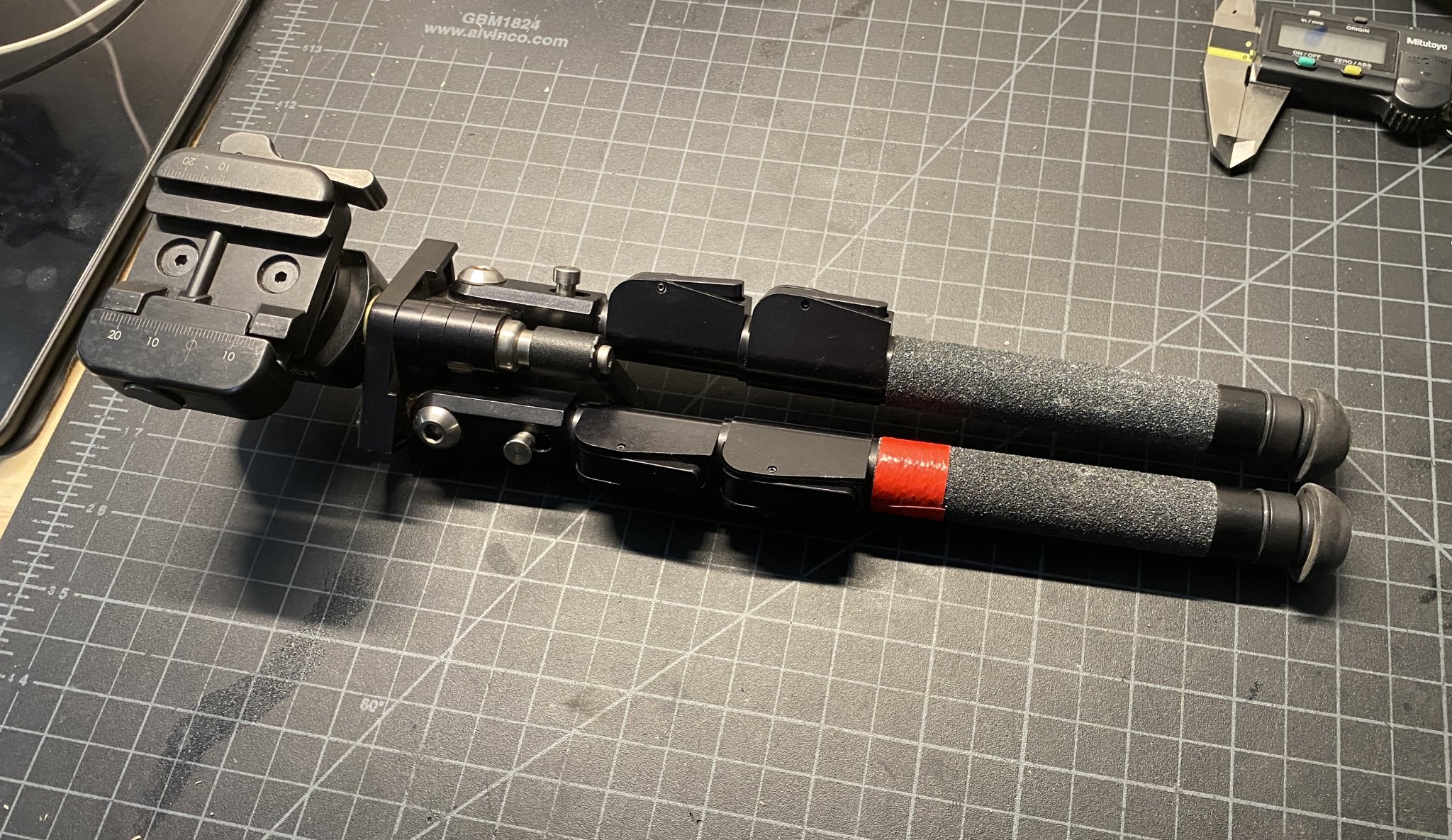

But with help from @acourvil I made some for test fitting, here's what it looks like:

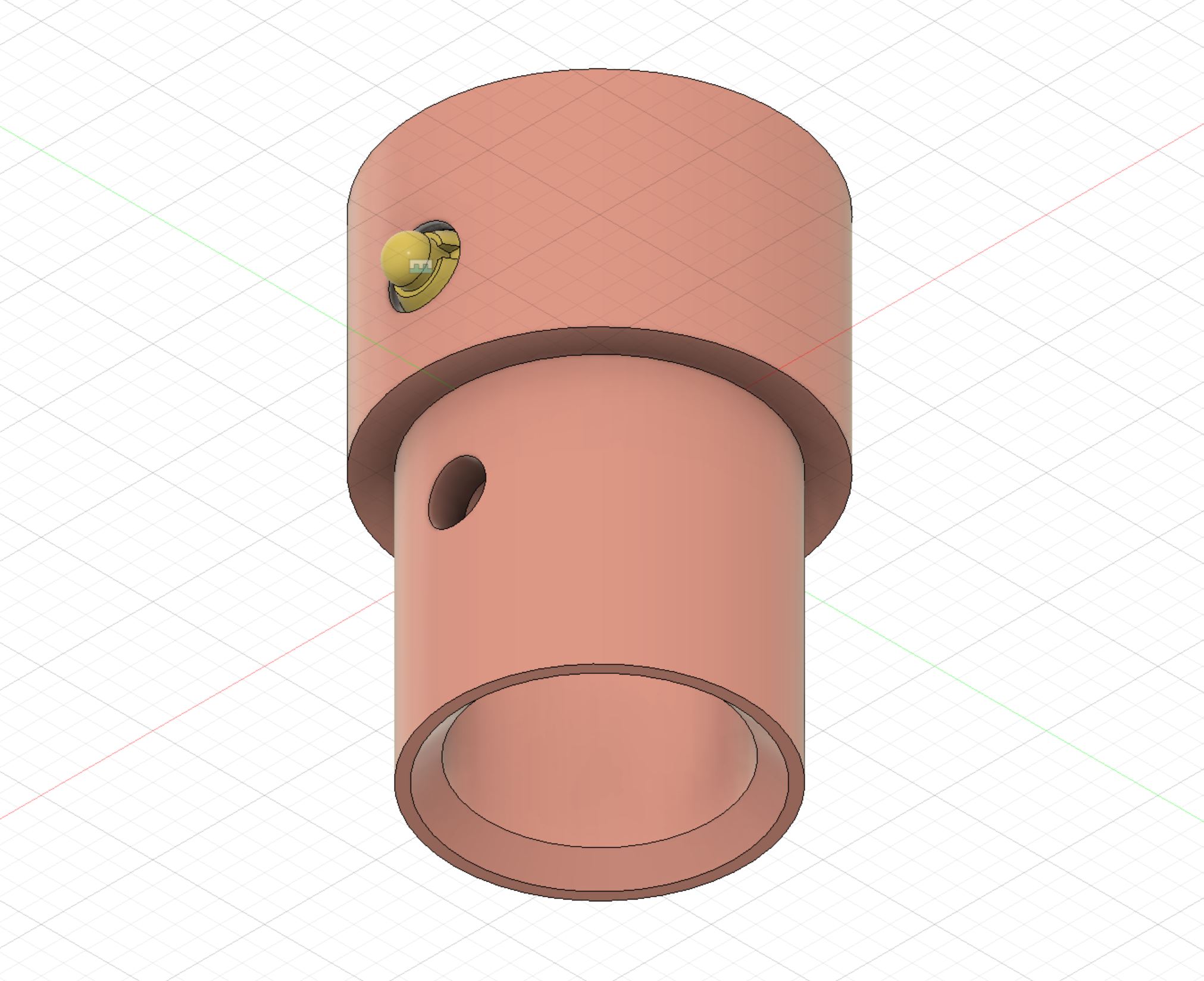

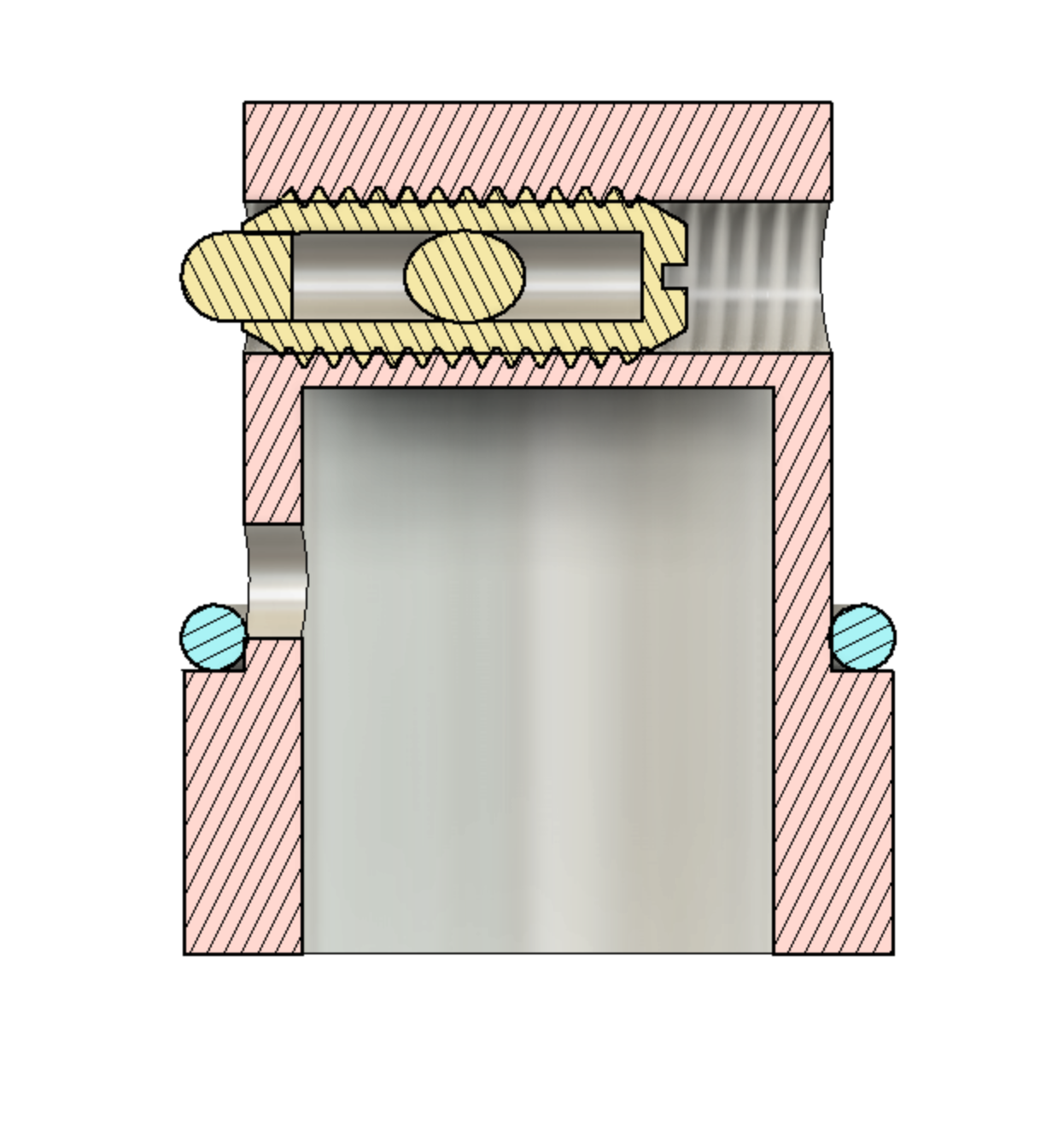

What I was thinking as well, and here's the updated version, now it only adds 0.3" to the OAL.My double pull got delayed as they oversold. At least I'll get a new one. Goal would be to minimize the height of the feet as in get it as deep into the bipod as possible given the bipod is already really tall, if the feet cause it to be even taller that would make it a little cumbersome to shoot prone.
That silver portion that sticks out what challenge in the design makes it not be able to be flush?View attachment 7773447Works great!
Where do you get the rubber part?What I was thinking as well, and here's the updated version, now it only adds 0.3" to the OAL.
Not having the double pull in hand make test fit difficult, so I will be sending a set out to @acourvil to try out first, and hope to make these available in January.
The rubber feet would otherwise run into the detent plunger.That silver portion that sticks out what challenge in the design makes it not be able to be flush?

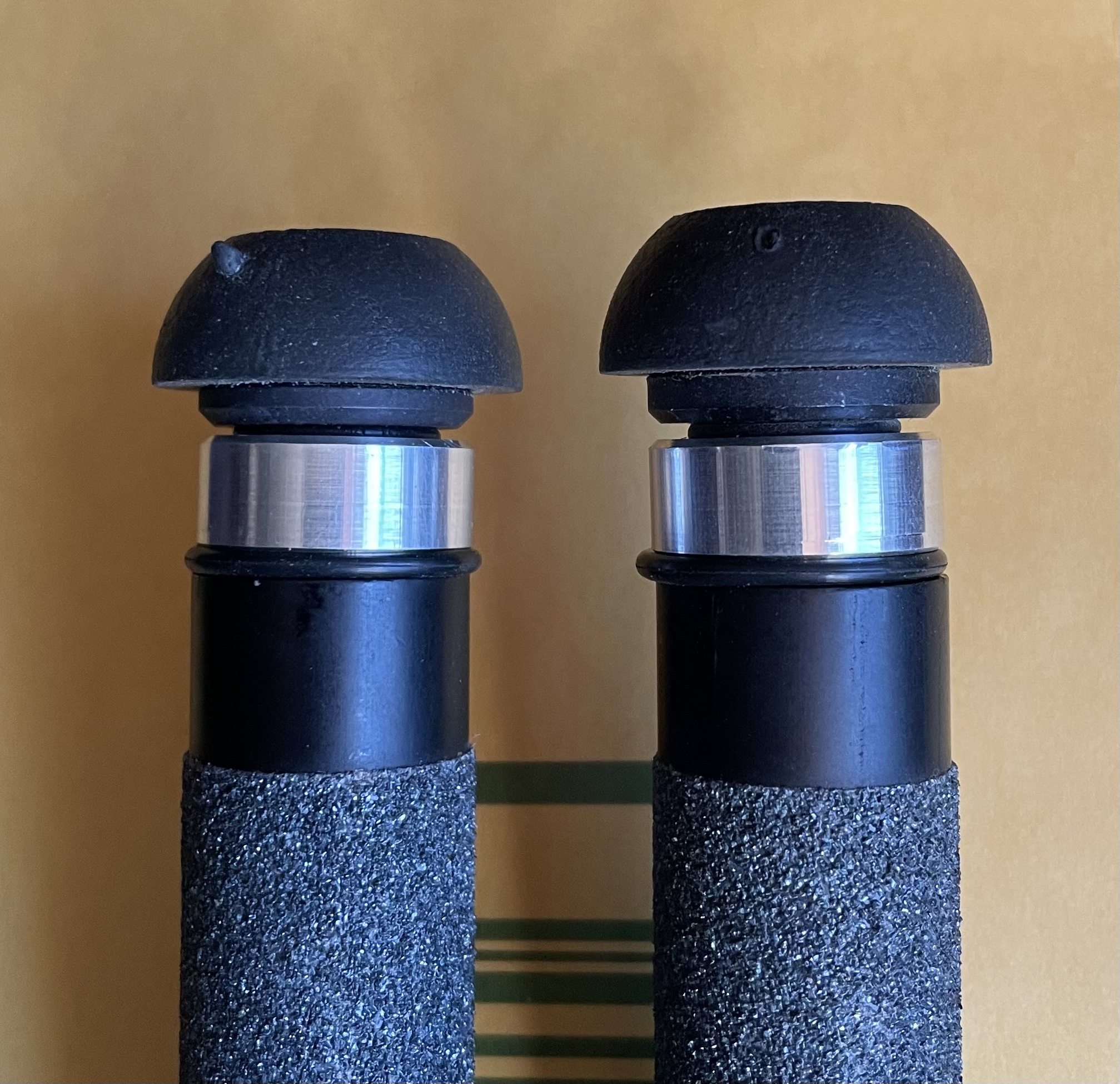

Hi, I’m late to this discussion but I’d like the rubber feet for my double pull Ckye-pod. How can I get a pair? ThanksView attachment 7783173Also received mine, really quality product with a nice tight fit, zero slop whatsoever. Turned some other buddies onto the product as well.

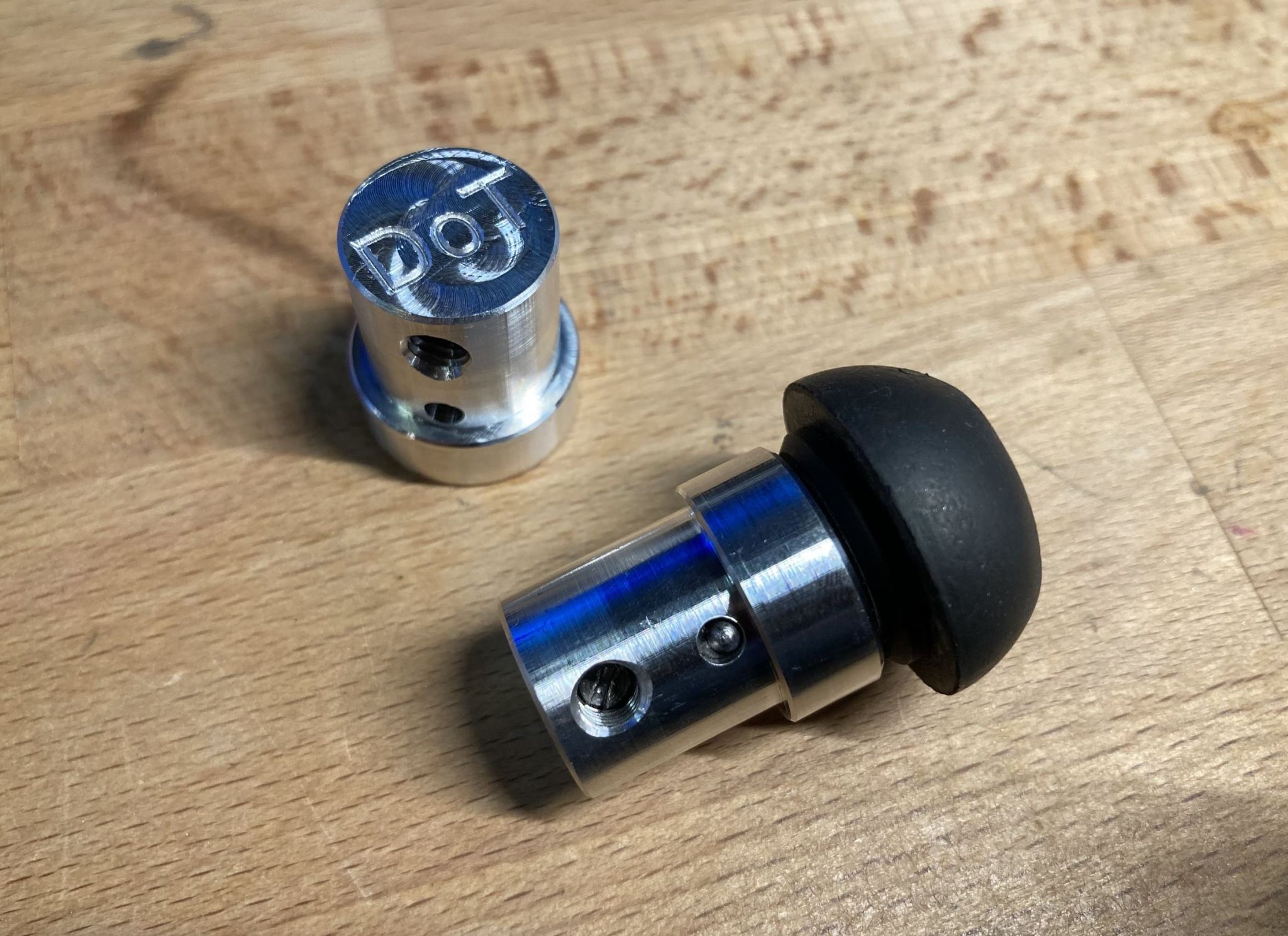

Hello I would be interested in buying a set of adapters. I am in Nor calFinally got my double pulls in from MDT. Here's a photo of the adapter with a latest change - I'm now using squared o-ring which works & looks better than the standard o-ring.
