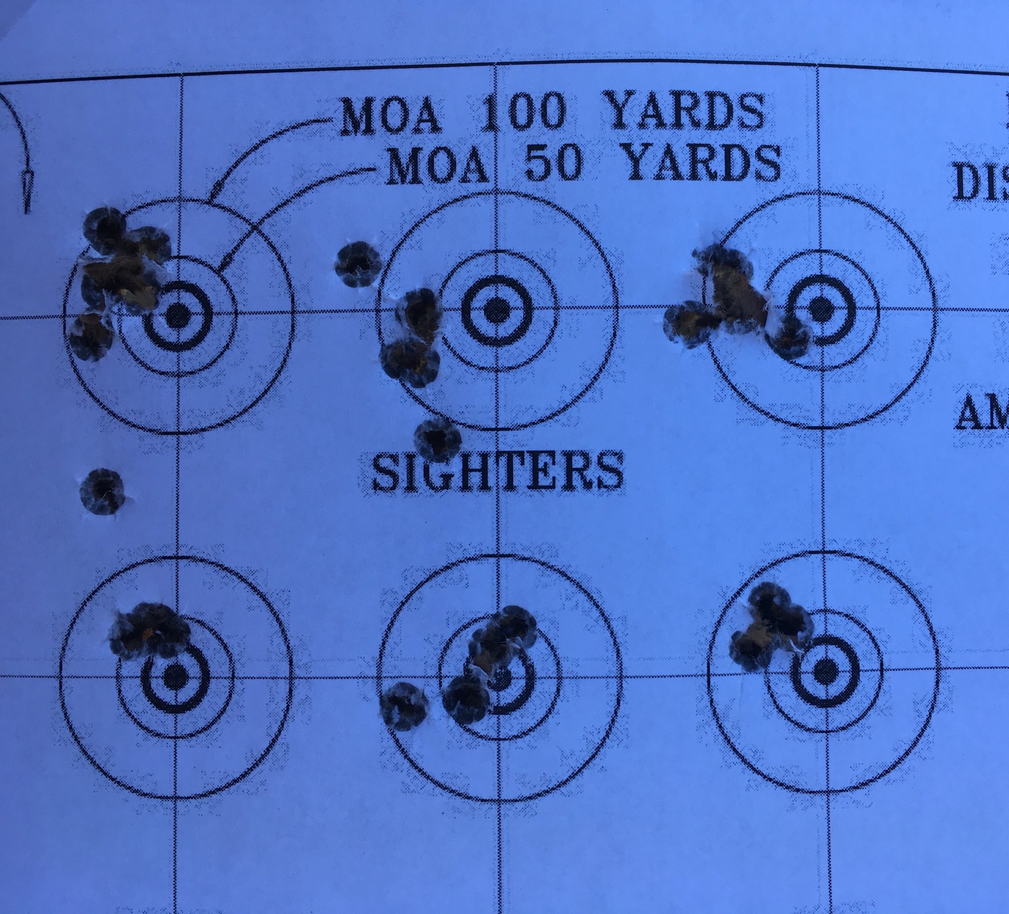

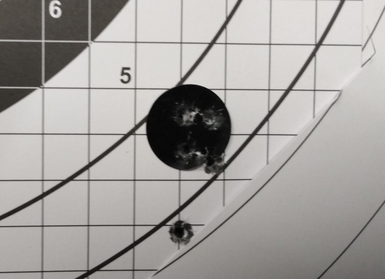

I have a more or less off the shelf Ruger 10/22 as a fun rifle. It sits in an Archangel Stock and in my ammo testing settled on the Stinger since it got the best results. (See the 5 shot groups attached -as a comparison 2 10 shot groups with CCI HV HP - groups not shot with the Holosun an Athlon now sits on it)
I also played around with different torque values with the action screw and this is the best result i got.
So basically I am asking if I should be happy with the result or if the regular 10/22 is capable of more than that?

Oh sorry, target distance is 50 meters.
So far I have only tried high velocity ammo, (every brand I can get around here RWS, CCI, etc) so it cycles properly but good point might be worth a try to test slower ammo for accuracy.
Reactions: ESBVader
Personally, without knowing weather conditions or shooter skill, I think I would generally say that you can pull better accuracy out of a 10/22.
If you can get any higher quality subsonic ammo, I would try that and see how that affects your group size.

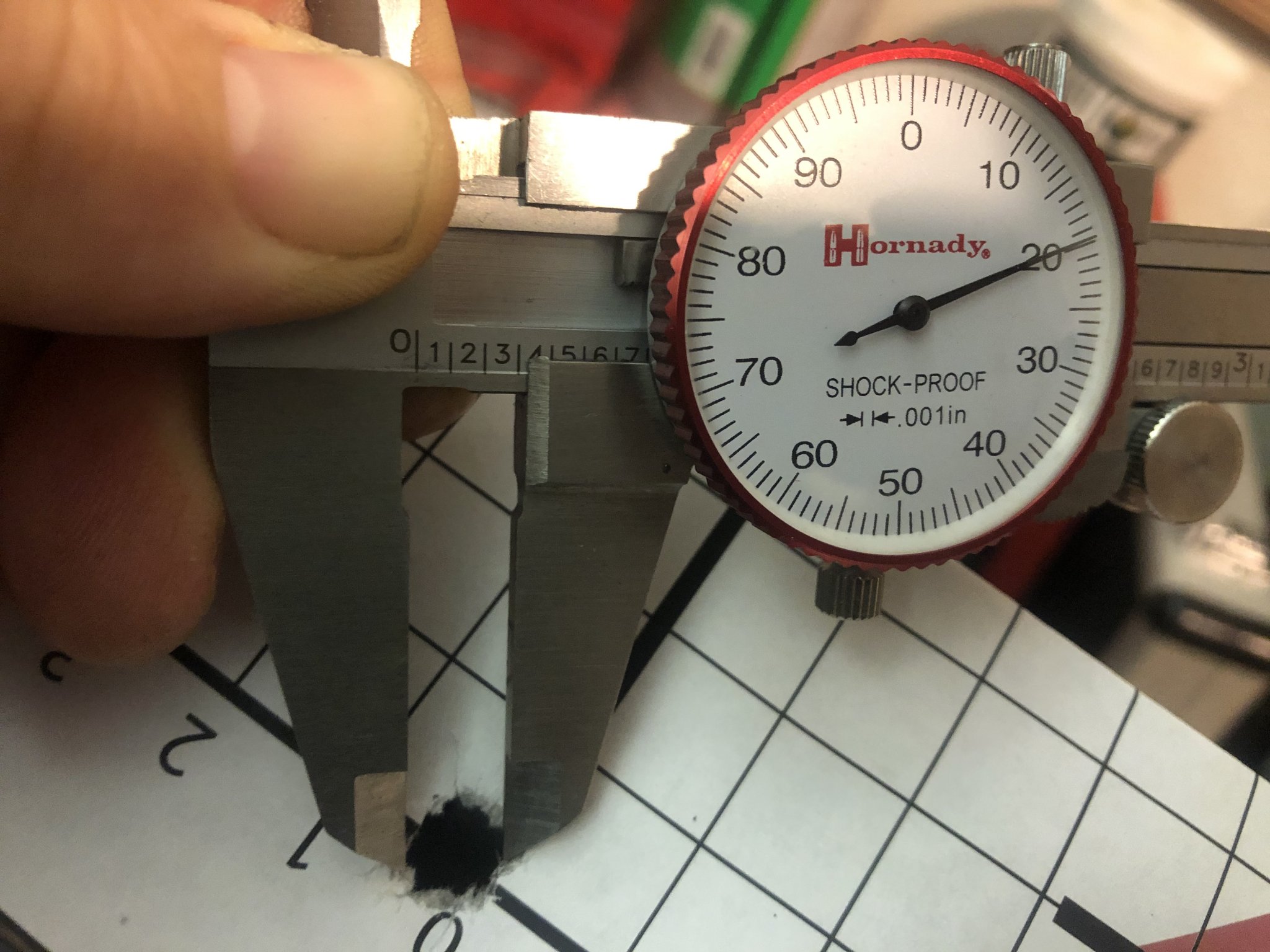

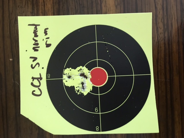

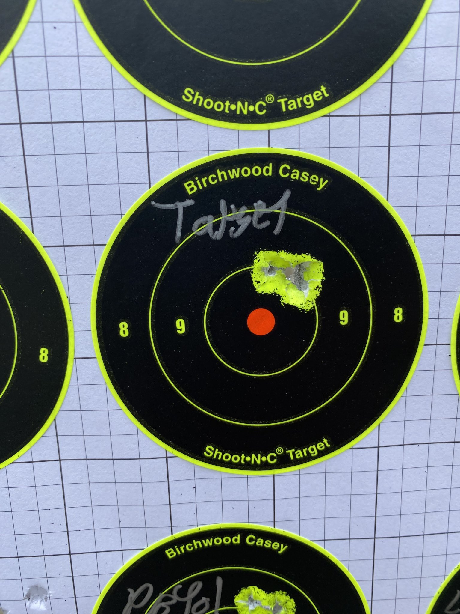

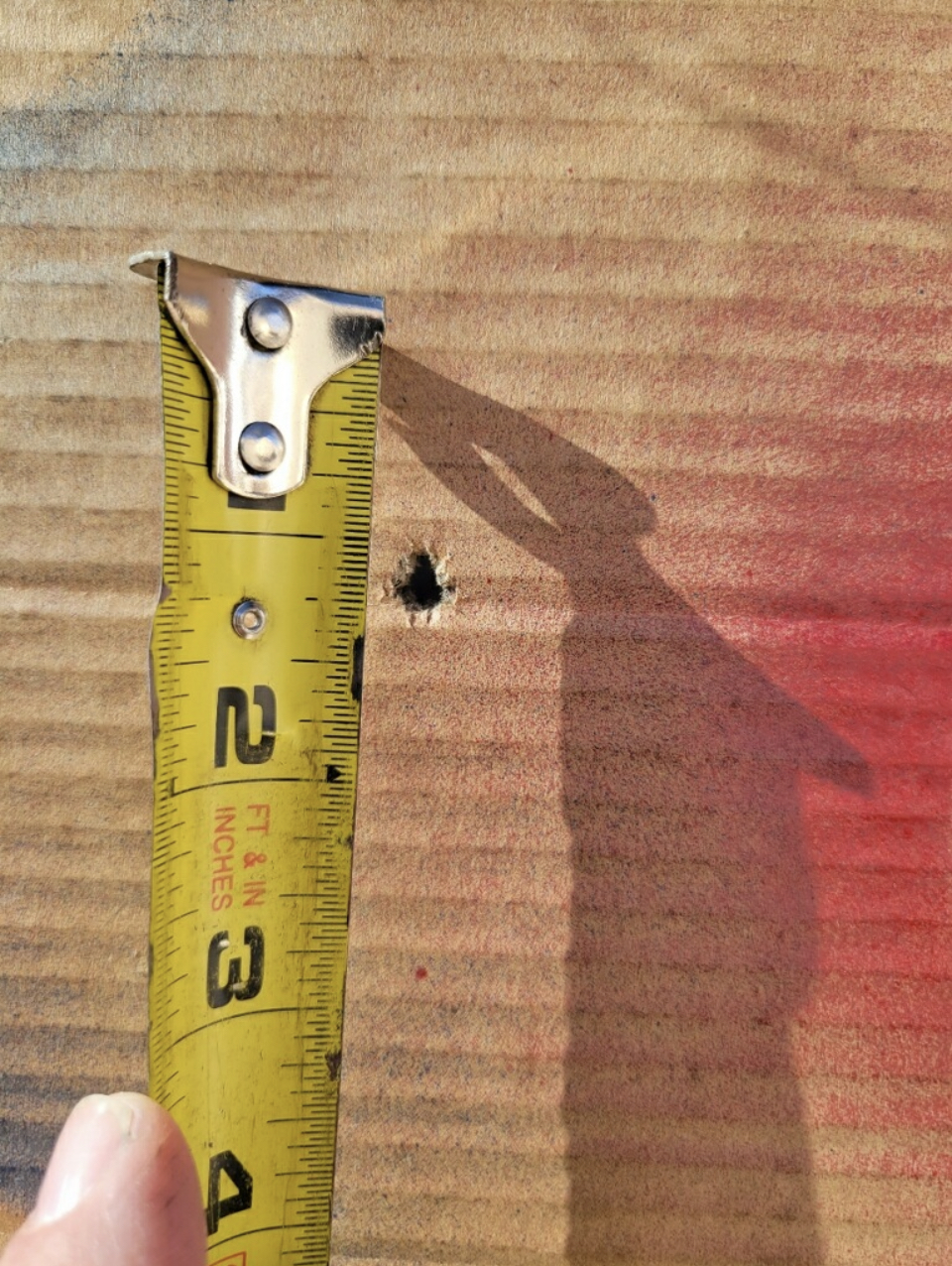

Thanks guys for the suggestions. I spent 1 and half hours at the range today and tried different ammo and torque setting again (with and without muzzle device) and I found a good setup with RWS Rifle Match. (previosly I only tested with the RWS Match Target) With one exception it also had no problem feeding.
The groups (50m - 5 Shots) are way better but they are not as consistent as I'd hope, there are still flyers sometimes but this could just as well be me. So we'll see how it performs next time all cleaned and ready. And maybe I'll talk myself into some trigger work. :)
Those groups are really pretty good for a stock rifle at 55yds, you notice overall the groups are strung vertical in nature, so that can be ammo, it can be the bullet being damaged when the action cycles, it can be the shooter of course, and it can be inconsistant ignition. Trying every match ammo you can helps too. I've seen guns that would shoot various match ammo 1" at 50yds and then it finds one it likes and it will be half that.
One thing you can do to check bullet damage is shoot a mag but hand eject every other round carefully and inspect the bullets, sometimes a feed ramp or chamber side can really do a number on random rounds here and there. I'll do that for 2-3 mags to get enough samples to catch random issues.
22's are notorious for not having solid firing pin contact, and it's crucial for rimfires to have solid consistent firing pin hits. Save some of your brass and look at the firing pin hits. Years ago (I haven't seen the insides of a new 10/22 for over a decade) there was a channel in the bolt the firing pin set in, and it could ride up in that channel and change the amount of firing pin hit the rim. Some guys pinned the bolt above the firing pin to keep it from sliding up the channel. The same can be true if the bolt face isn't square.
Also if you are getting single flyers, keep track of which round it is. 10/22's are notorious for "first round flyers" the first hand loaded round shoots to a different location than the rest that are cycled by the action while firing. In fact some guys shoot the first round into the dirt before they start shooting groups. It's my understanding this is usually due to the bolt face not being squared up.
Not that familiar with the archangel stock, but bedding it can be an option, also if the forearm is not super stiff where your rest/bag is on the forearm can impact groups vertically, so when shooting off a rest try to make sure the rest is at the same place on the forearm each time.

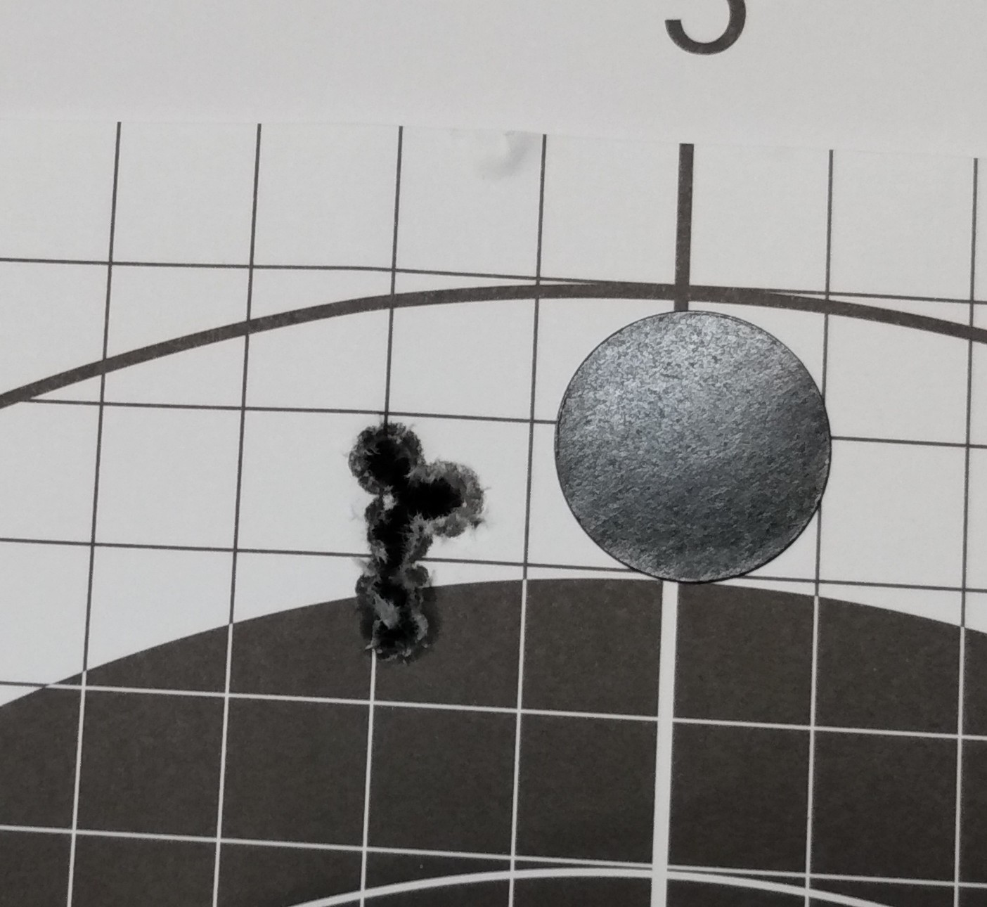

Update: here is the rifle with Eley target 5-shots 50yrds $6.50 a box. The only two groups with Target I shot and the Eley Force was pretty good too. I’ll try them at 100yrds hopefully soon.
