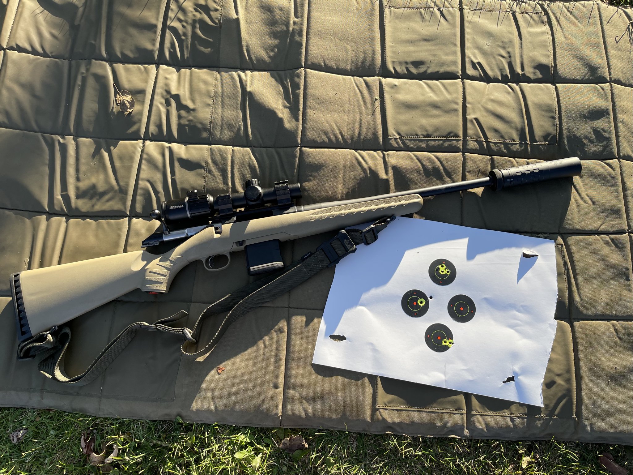

I have the Ranch 556 model. Awesome truck guns. Below is initial zeroing and two 3 shot groups at 100 yards with the RT6. Hornady steel match 55 HP
