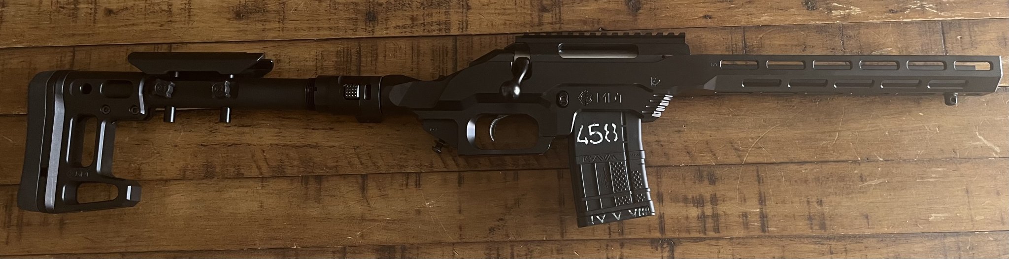

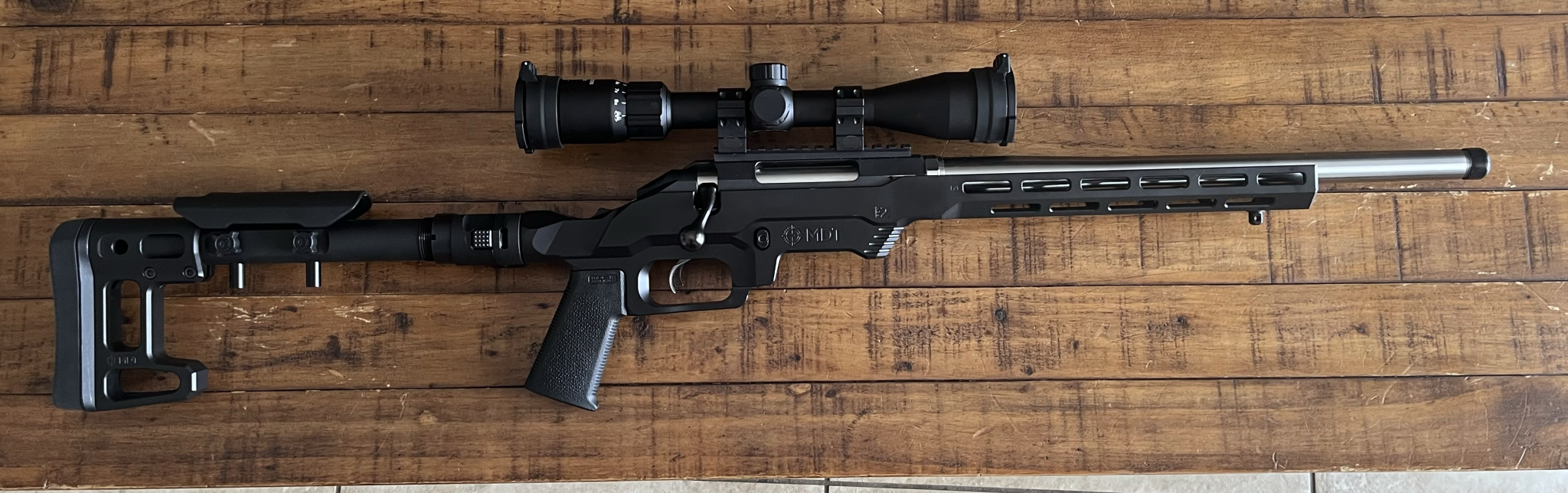

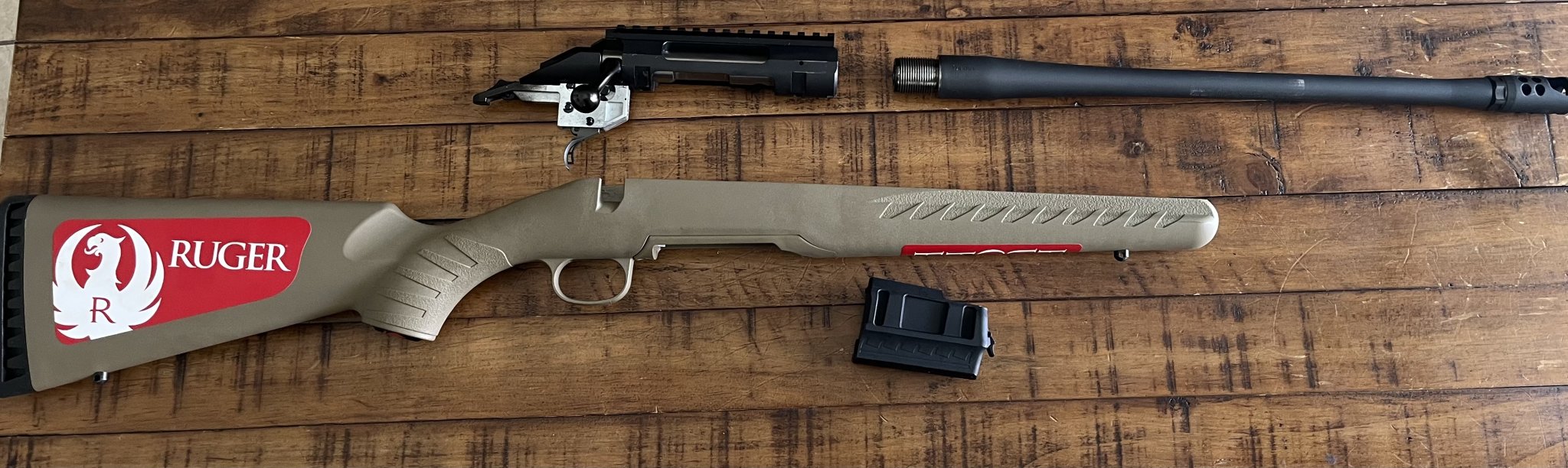

I’ve been all over the RugerForums and have seen 1 guy convert his 450b Ranch rifle to 458 AR mags in a MDT chassis. A lot on that forum have called Ruger asking to swap from the flush mags to AICS or AR mags and Ruger sells then a drop in mag well to convert it to either or. So there’s a bunch of conflicting information
I just want AR mags for this build, for simplicity. I am used to loading 458 for my AR mags and have tons of them (Lancers)
But, I could order the MDT chassis for AICS mags I guess. I ordered an X Caliber barrel already for the build. They’re 20% off currently
Here are pictures of his build going from the Ranch to the MDT with AR mags.
E8B6EEA2-6A55-44C7-8667-C3B55D1EFA6B.jpeg24BFB59F-E490-4BA6-83A4-28F4BDC1E128.jpeg3D98833F-EAB2-40FC-8706-6728B4628181.png
So I guess my question would be, why AICS over AR magazines or vice versa?

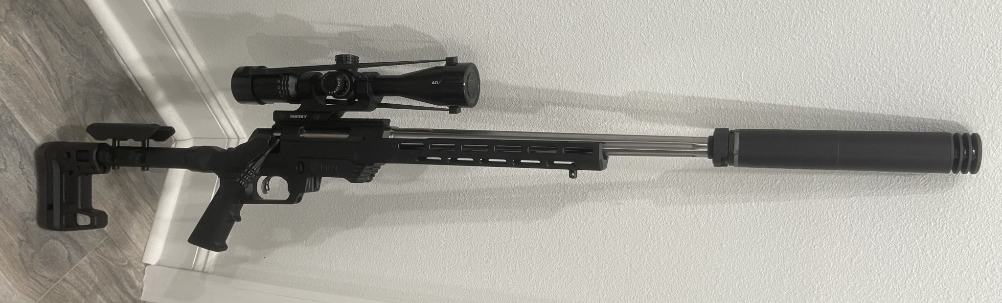

So I’ll throw the folder on a 300BLK mini fix SBR style build.
Ruger American Ranch 450 Bushmaster
16” 1:10 Stainless fluted X-Caliber barrel
MDT LSS-XL Gen 2 chassis (AR mag)
Glades Bolt handle and cover
SilencerCo Hybrid 46 with Bravo ASR mount and anchor brake
Next will be the permanent scope (still unsure of which one just yet), different grip, and possibly a Timney trigger
View attachment 8005073View attachment 8005074View attachment 8005075
