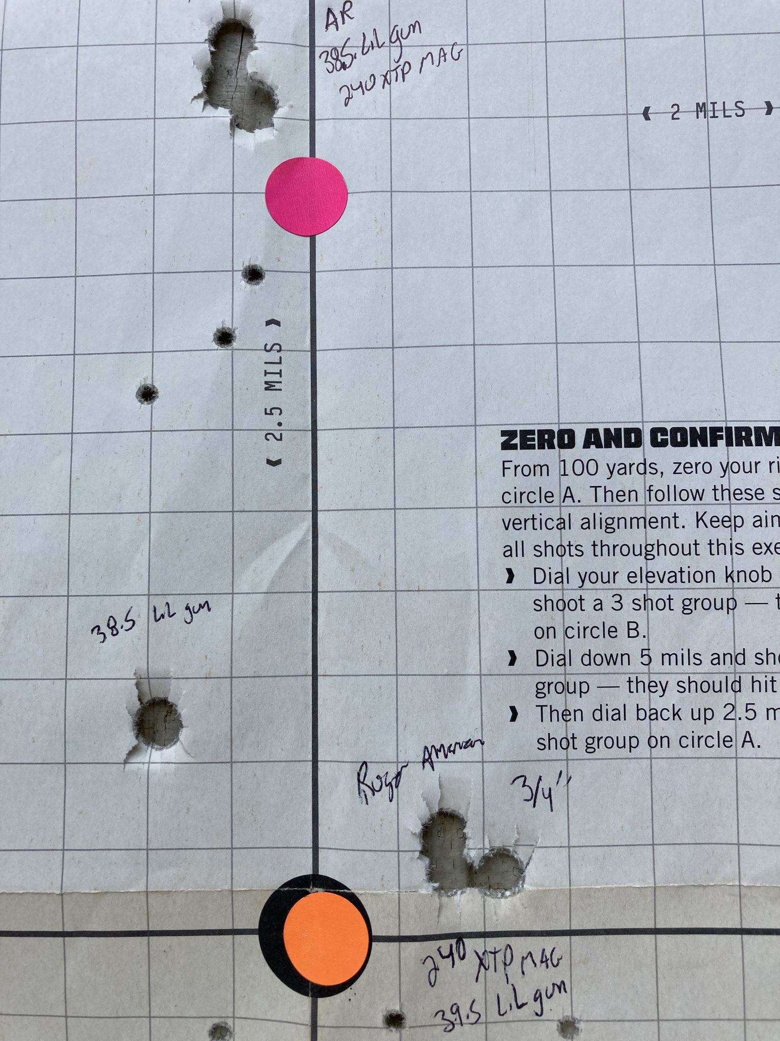

Well it can shoot sub moa groups with factory and handloads 92CFF4E2-DCCA-48DC-AB27-E98CA7F3FF15.jpeg
Pretty good for a “budget rifle” that costs about $400 new.
the hand load was Hornady 240 XTP mag over a healthy dose of LILLGUN. Deer bear and pig are the main menu- I think this may be “the” little walking around rifle .
